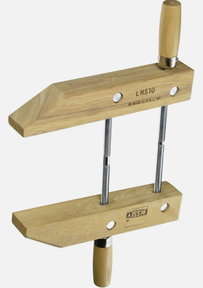

    What, no wooden clothes pins on the steel gas line ? :D
  5. Johnny Gee
    Joined: Dec 3, 2009
    Posts: 14,420
    Johnny Gee
    from Downey, Ca

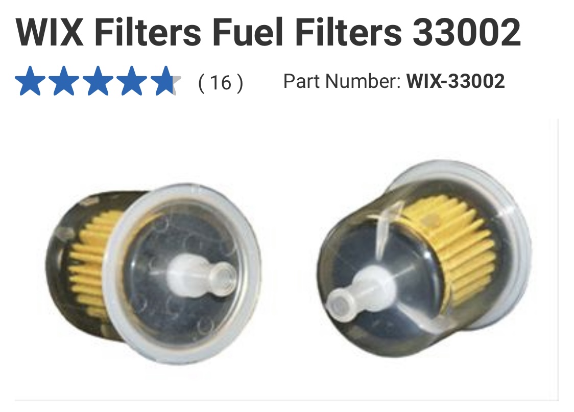

  12. Johnny Gee
    Joined: Dec 3, 2009
    Posts: 14,420
    Johnny Gee
    from Downey, Ca
    Forgot to mention. I had percolating of fuel post fuel pump. Something to look for with… IMG_1960.jpeg
    Once I knew all was doing well again I went back to an all steel filter like yours.
    bchctybob likes this.
