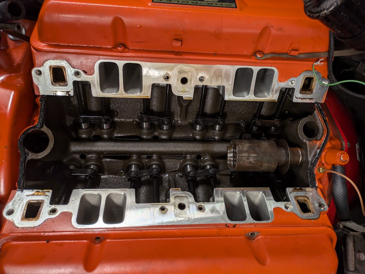

    I pulled off the intake, the gaskets were soaked with oil all around the ports. The bolts were still tight, and the gaskets have even indents showing they've been compressed.
    Very strange....

    I'm sure you did but, did you check the head to intake interface? I'd suspect intake gasket's ****ing oil at the bottom of the port's.
    F.W.I.W. I've had better luck with the Victor/Reinz hard fiber intake gaskets vs. the Felpro no-stick gasket's. Victor's seem to compress better. Felpro's have always leaked for me. :mad:
    brigrat and porkshop like this.

    The gaskets appear to be just as compressed at the bottom of the ports as the tops.
    I'll see if I can get some pics of the manifold side of the gaskets.
    porkshop and Sharpone like this.

    A few more pictures. I see oil in the intake ports in the heads, and feel it when I rub my finger in there. But dry in the manifold. So I'm pretty sure that's where it's getting in. The gaskets...one as removed, the other I wiped off the oil. The manifold is pitted all over, I don't think that's the issue, but it might be?
    I have a couple more sets of the same type of gasket, might try one with some sealer of some kind...I used Permatex Aviation on the water ports, it held the gasket on well. I didn't put it on the intake ports, I could.

    really left field - SBC oils the top end with the pushrods and rockers. Big holes in the rockers flooding the top? Oil pressure normal during driving?
    It's gotta be the rings, valve guides/seals or oil getting pulled into the intake tract. PCV and intake gaskets are the usual suspects on the tract.
    I went back and the engine was taken out and upgraded around here.
    https://www.jalopyjournal.com/forum/threads/mid-life-crisis-62-vette.1292401/page-47#post-15246016
    Heads, cam, lifters, pushrods, rockers, intake. Kind of rules out rings.
    EDIT just saw your last post.
    Even a stock engine will have some pulsing in the intake. A bigger cam will do this even more. If the intake isn't wet, it's gotta be further downstream.
    porkshop, 41 GMC K-18 and Sharpone like this.

    Screw it, ditch the fel pro blue gaskets and put a paper style gasket in with high tack or gaskacinch around the ports. See what happens.
    bchctybob, Paul, warbird1 and 11 others like this.

    Agreed. I'd try a more compressible gasket with light sealer both sides. Your discovery of a dry manifold but wet head ports is telling the story. I laughed when you said put it back the way it was before you "fixed it". Boy, been there before!:D
    bchctybob, bobss396, warbird1 and 6 others like this.

    Another possible source for oil is the intake rocker studs, they thread into the port. I put plenty of sealer on them, so they should not be leaking...but there is some oil collected on them, in the ports. I think I'll remove one or two and see how they look.
    I also want to look at the valve stem seals, to make sure I didn't damage them.

    Those appear to be 90322-1 Perma-Torque intake manifold gaskets. Those are for cast iron intake on cast iron heads.
    You need a soft gasket like Print-O-Seal or other equivalent gasket that has raised silicone O ring like sealer around the ports.

    The gaskets I used are FelPro 1204, they are not Permatorque.

    The picture you posted are Permatorque 90322-1
