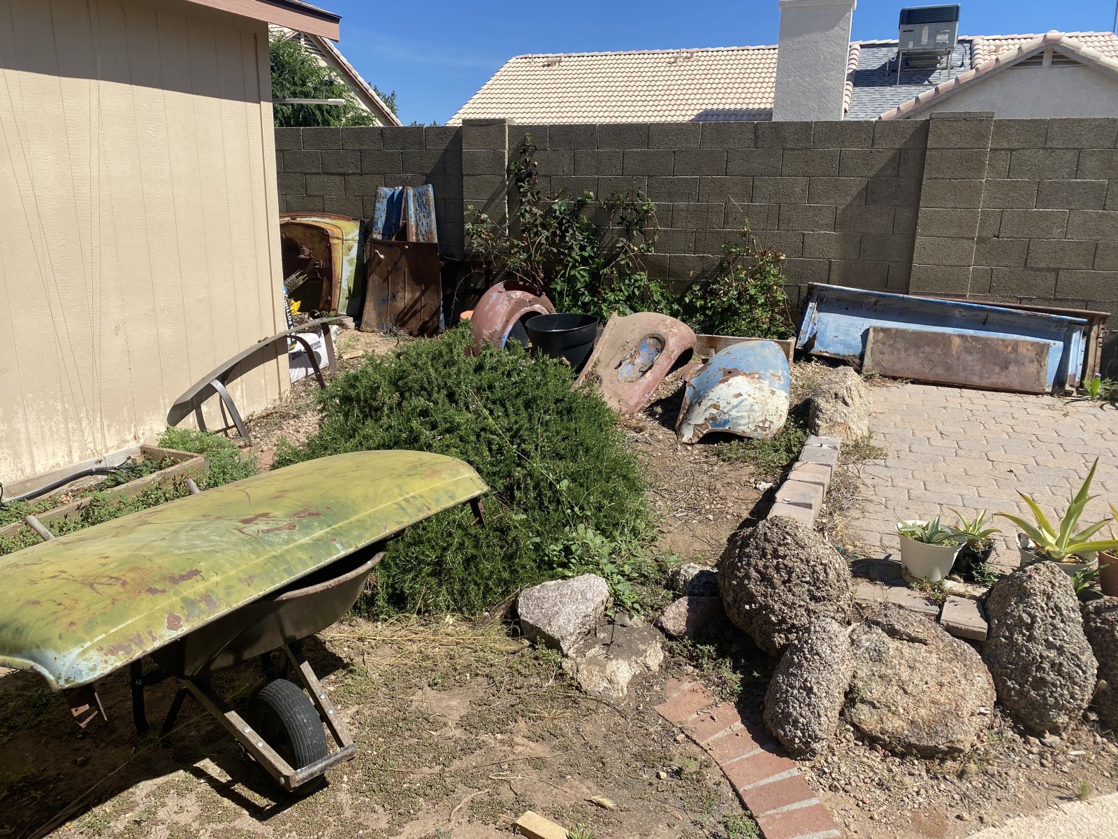

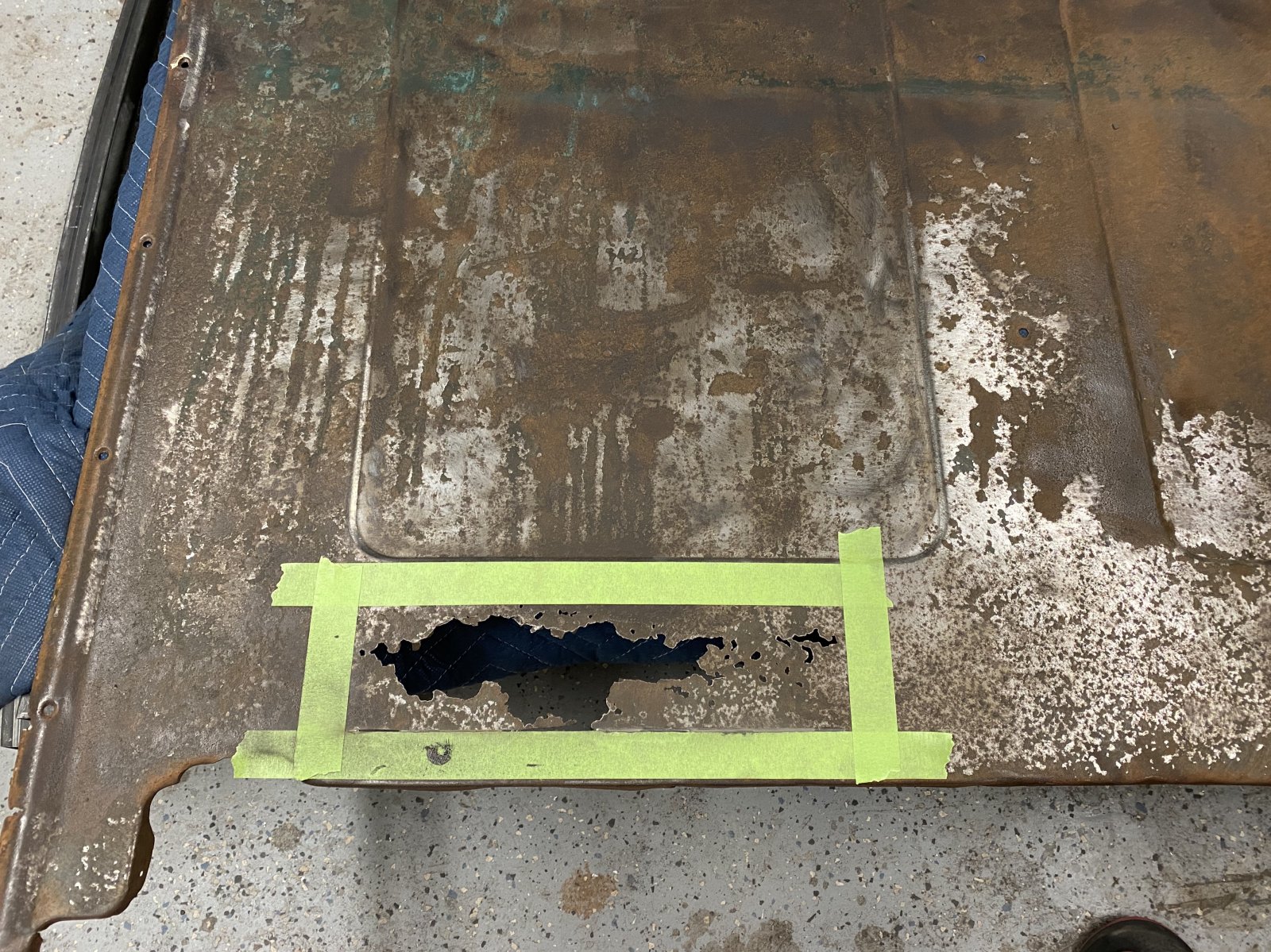

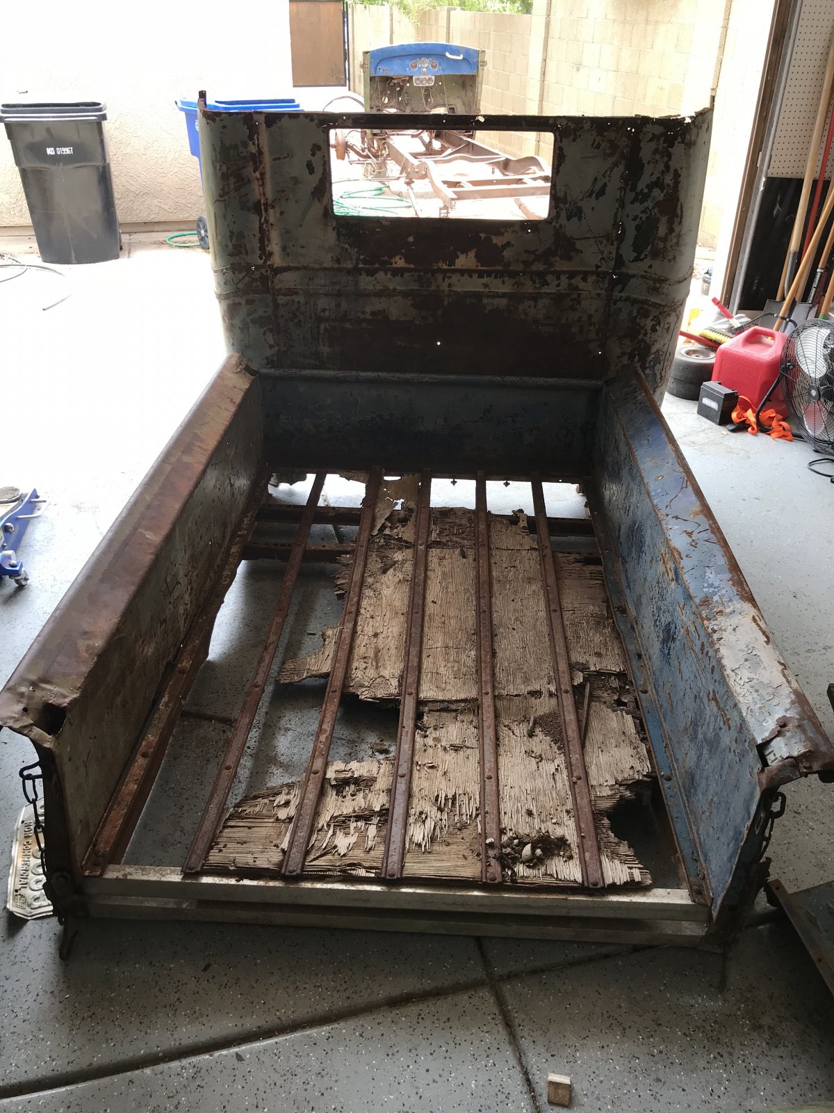

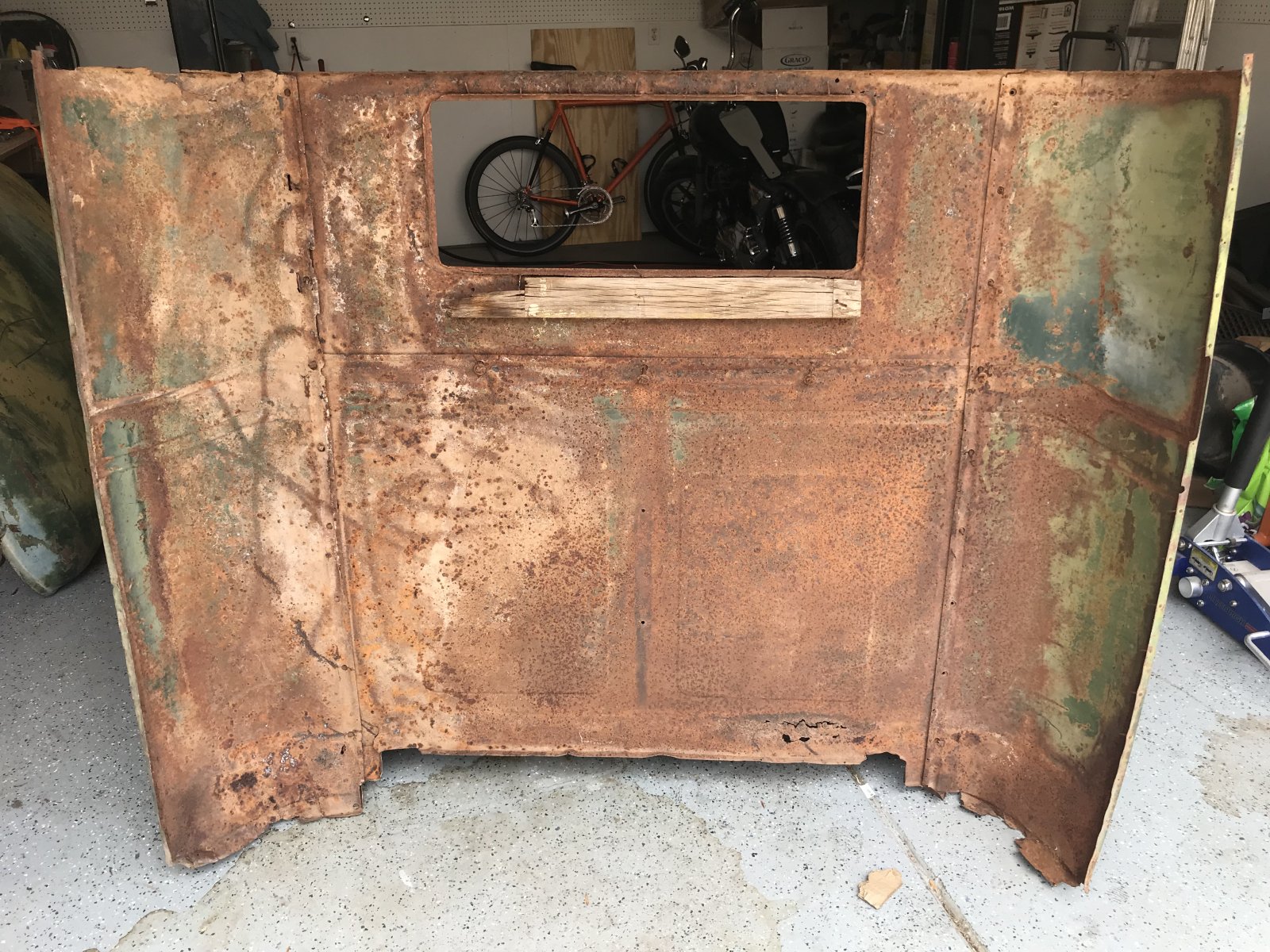

    Hello and welcome to my build thread. Having been inspired long ago by Jimmy Shine’s ‘34, I’ve always dreamed of having a cool little 30’s pickup, chopped top, low stance, and it’s gotta have a hemi. Lucky for me, My Dad had given me a ‘53 dodge 241 to rebuild long long ago, so I already knew that would be the future power plant of whatever I got.
    Well dreams took a turn towards reality in 2018 when I purchased a ‘35 Chevy pickup,(more accurately a pile of body panels and a frame) but it was all there aside from a missing grille, with a ***le, for $900. (As luck would have it there was one 35 Chevy truck grille on flEaBAY that I snagged for $280 that same week). Dragged it home with a smile on my face and a head full of dreams, but it would be 2 years before I actually started doing anything with it.
    Thanks to Project Pushing Kingfisher forward, Carl showed a excellent step by step for creating a cab frame from a pile of panels just like I had got. his thread was my single biggest inspiration for me to get off my *** and actually do something with my truck.
    My other main Chevy truck inspirations from the HAMB I must credit are Lukesters ‘35, Cactus1 and his ‘34 “Patience”, also Fern 54, and Redwelter. All awesome builds and I pulled inspiration from you all, thank you!
    Enough story time for now, let’s get to the good stuff *pics*
    Day #1
    7D256C95-9A9E-4156-B7E4-D940A5FC0B49.jpeg 2C0461D5-2243-40E4-A5D3-12B1542076AE.jpeg D0FE2596-4885-438E-AFD5-5819DF39FBA1.jpeg 144F0A42-ED53-4009-97CB-B26B2185E561.jpeg EB4BE90A-6A17-4234-A2CF-FB7B6D005F94.jpeg 30A2B9CE-18BB-4C46-AE0A-6981448F2325.jpeg

    Yeah Yeah, get after it. Plenty there to start with, and a bed.
    What's the frame and suspension plan ? Drop that hemi in for a mock up

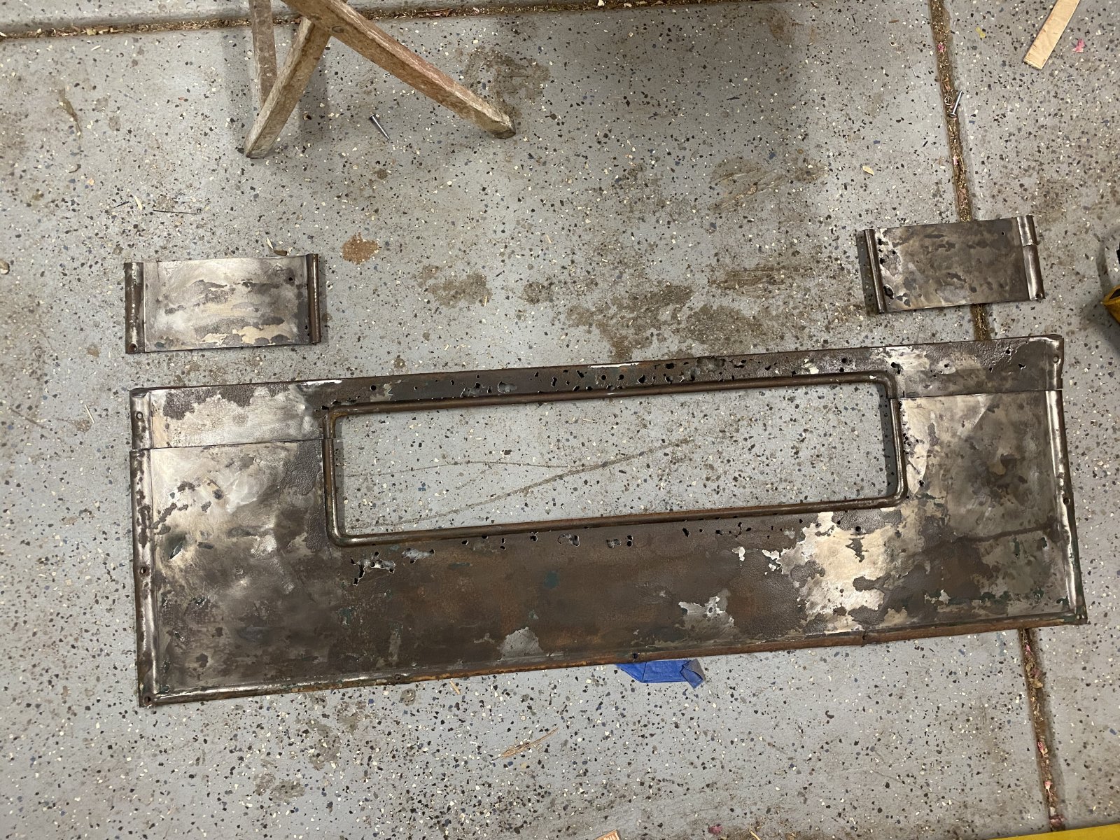

  3. Tat2Neil

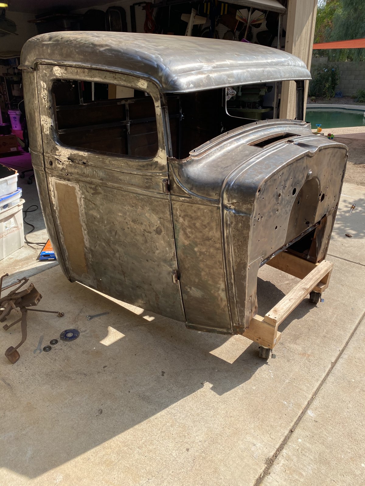

    Joined: Jul 19, 2022
    Posts: 136
    Tat2Neil
    from Mesa AZ

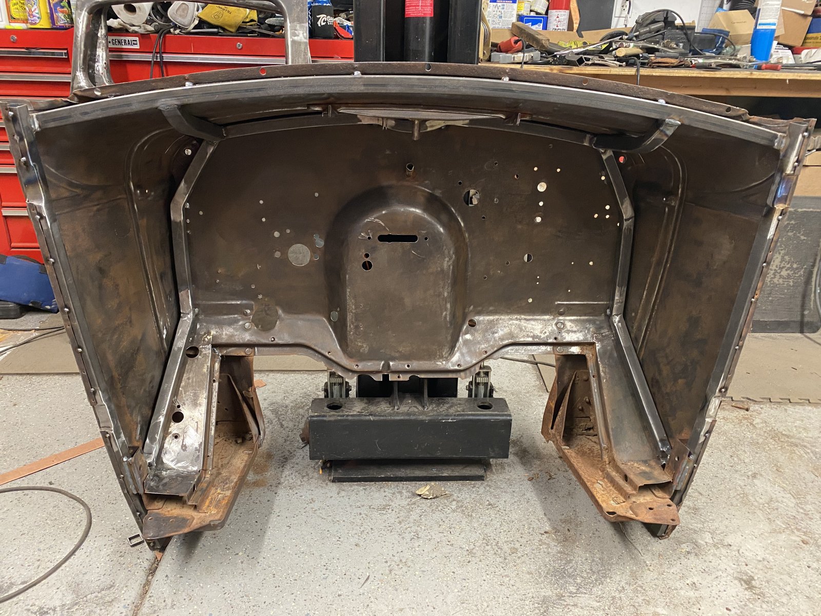

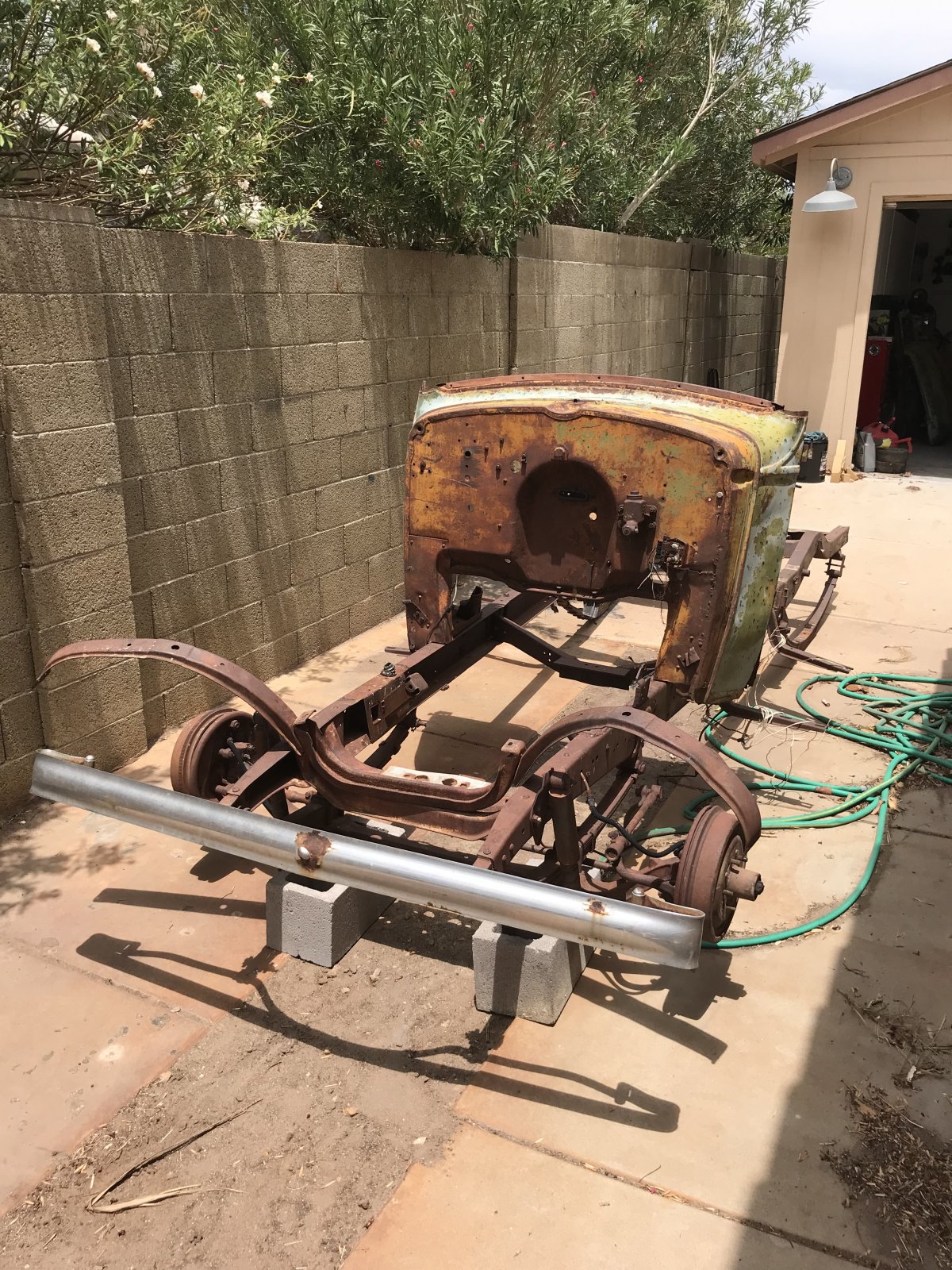

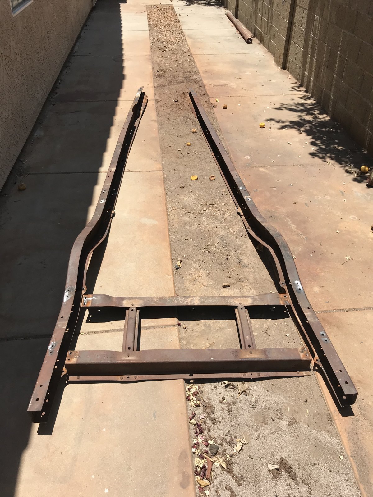

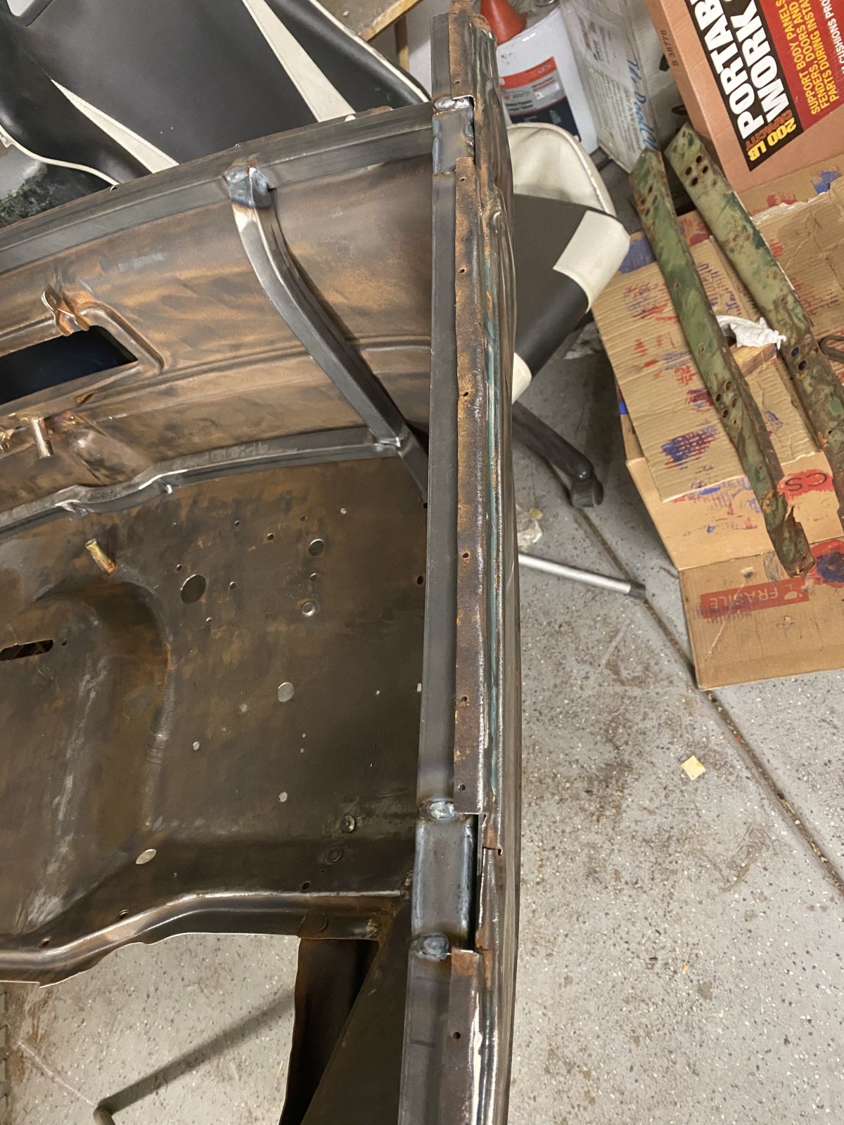

    The first 2 years didn’t see much progress aside from cutting the frame apart to the only things I planned to re-use, the side rails and rear cross member. I had considered building the frame from 2x3 tubing as a lot would do, but I really like being able to utilize as much original steel as possible, it’s been around for almost 90 years, gotta keep it goin! Plus I love the taper on a stock frame that you loose when using rectangle.
    C0AB1AFF-38AC-495B-920E-56C5A65F0F66.jpeg 605C936F-6102-424B-B6E1-5060835D8DA5.jpeg 0E0EFFF6-28CE-4E95-AFC9-611E098B498B.jpeg 73D9A003-64D4-49EF-A40A-D317380917E4.jpeg
  4. Tat2Neil
    Posts: 136
    Tat2Neil

    At that point I wanted to use ford wire wheels with a dropped Model A axle front end, and coil overs out back. Would like my frame ~1in off the ground if sitting on the wheels. Got lots more photos coming!
  5. Tat2Neil
    Posts: 136
    Tat2Neil
    from Mesa AZ
    Fathers Day 2020, just 1 month after coming out of our Covid lockdown, during which was when I found Carl’s project thread from 2008 which gave me the confidence boost to start doing work. The only thing I wanted for Father’s Day was to spend it working on my hot rod, so I spent all day taking a wire wheel to the rear cab panels and corners and doing a little hammer n dolly work. Then starting laying out my 4in chop, which was how Carl did his and might sound like putting the cart before the horse to some, but it works out in this scenario (*spoiler alert, nooo it does not, it was close but not good enough, put the roof on before chopping the doors..you’ll thank me later*). typically you would cut a section from the cab corners and re attach the top portion, but my top edges were fairly rusted and beat up, so I opted to take the 4 in out of the top instead. E85C07E8-C55A-460B-A13A-AA1C74817278.jpeg 86335879-0117-4C38-AB5C-DFEA58E87A4B.jpeg 248285EF-FCEB-4ABB-A087-02755D26F3A4.jpeg 601FF07A-7589-4B27-BAC4-393580D19097.jpeg 1D40CE7B-12DB-4D99-A77F-A8F1A153F4D0.jpeg 6DC348EB-4F08-4C25-BCEE-2ABD04C451F0.jpeg EBE23A8B-7B24-49B8-8C8E-EDF40B694E6C.jpeg E0BF5EA5-3BA8-4EC7-9727-E26C857580F3.jpeg

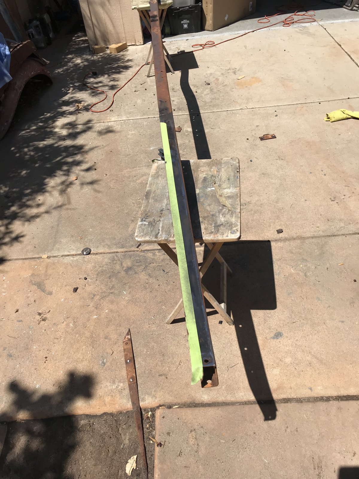

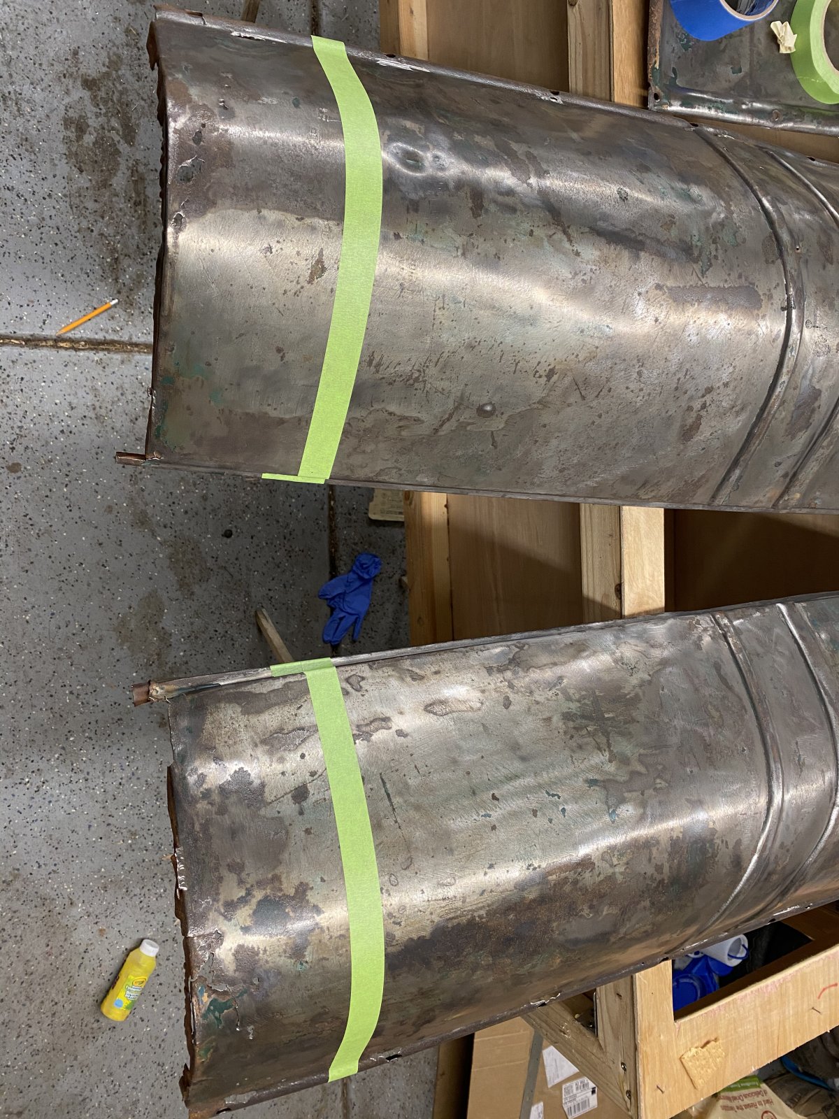

    What was the reason for the masking tape along the top of the right hand side rail in the pic following the cross member removal?

    I think that's the bottom side (upside-down)? If you look at the photo ABOVE that one, the rails appear wider on the bottom at the front. Looks to me like he trimmed that part off, you can see it lying on the ground in that shot with the tape.

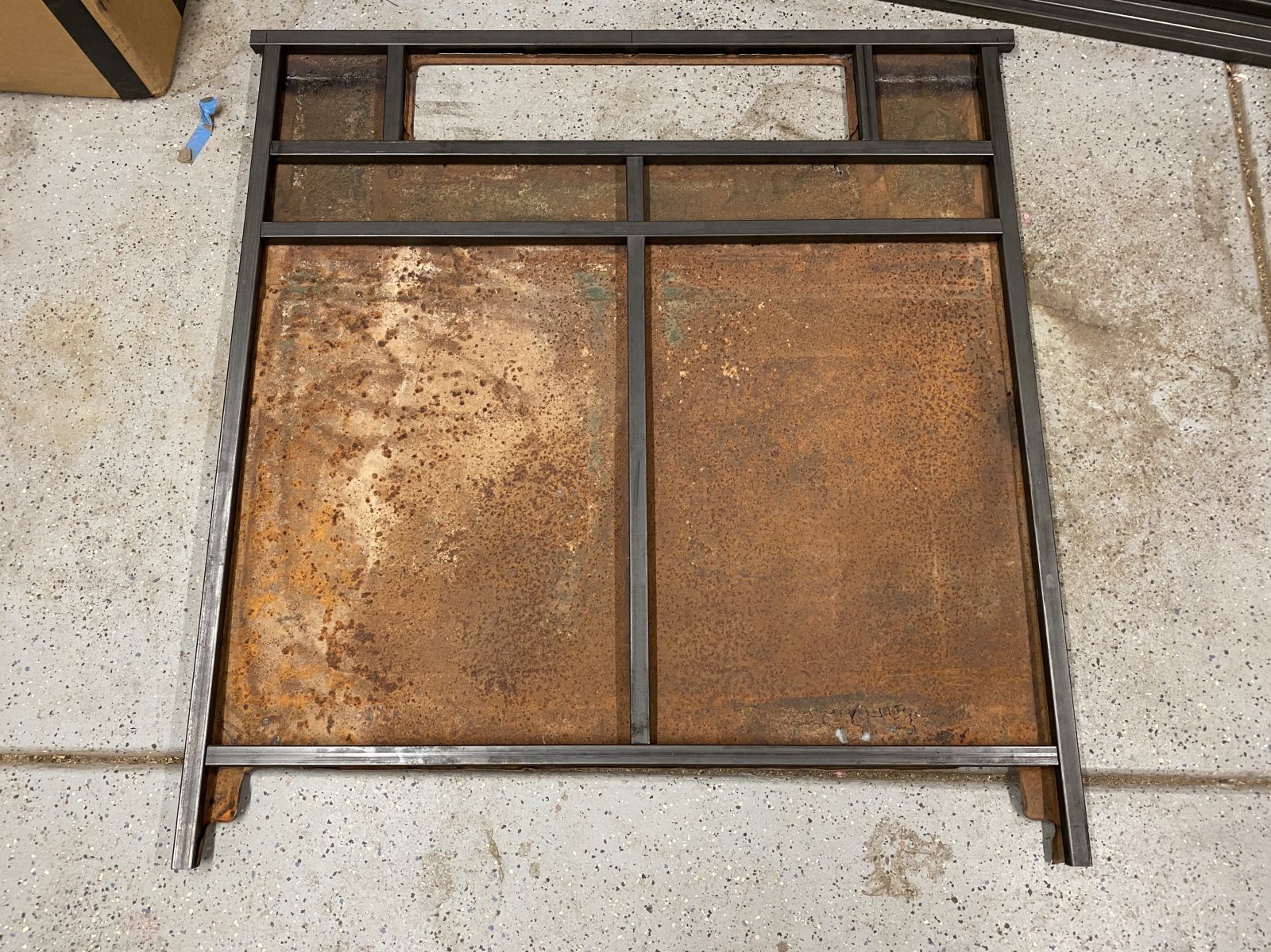

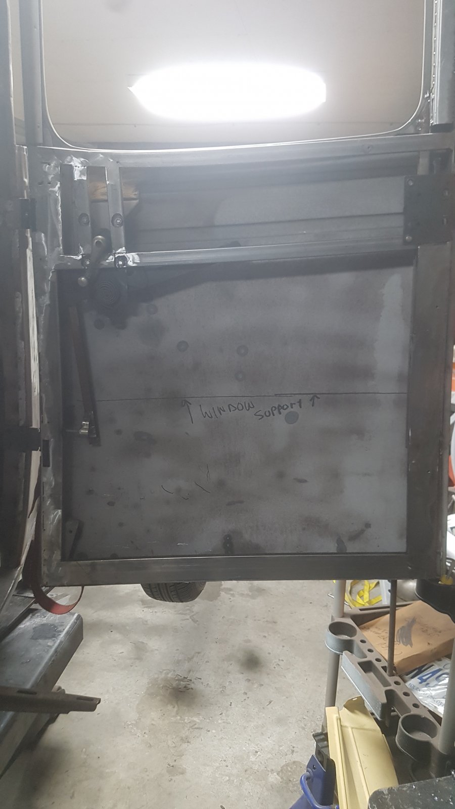

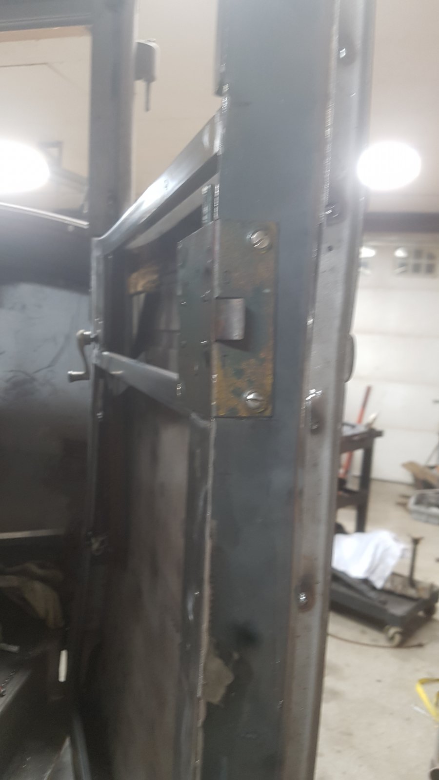

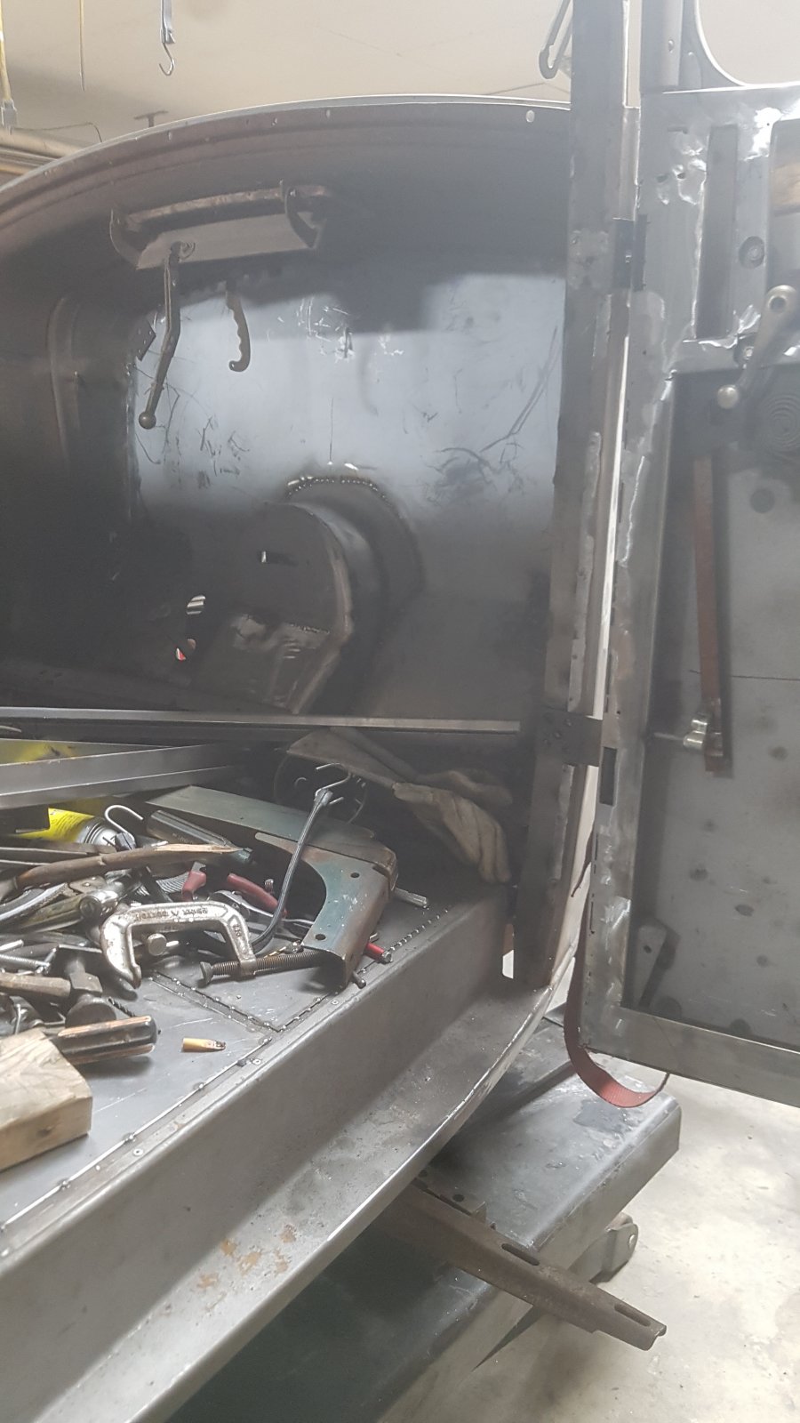

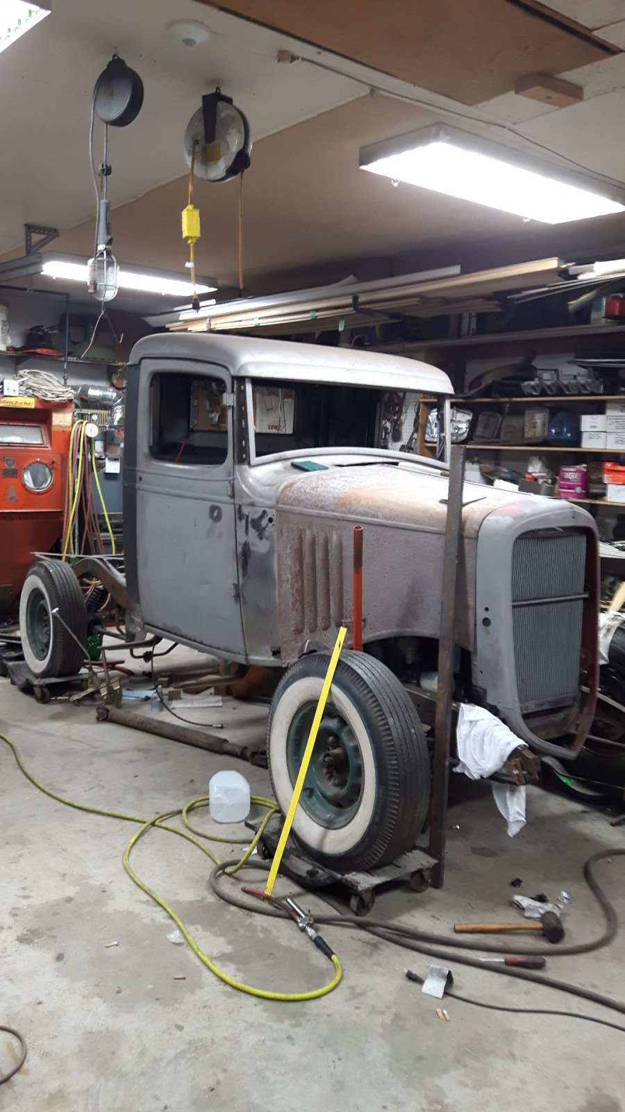

  14. Here are few of the door pictures ,mostly used 1/2 x3 tubing 20170929_213243.jpg 20190227_153248.jpg 20190313_211814.jpg 20190313_211823.jpg 20190313_211906.jpg 20190313_211914.jpg 20190313_211924.jpg 20190313_211949.jpg 20190313_211952.jpg 20190313_211927(0).jpg 20190313_211927.jpg 20190313_211937.jpg
    hfh, rod1, Six Ball and 15 others like this.

    I agree I think the rails are a great starting place and I really like that they kept em nice and straight! Sancho hit the nail on the head, I was just removing the excess material off the bottom that created the factory cross member mount, Which I wasn’t going to use.

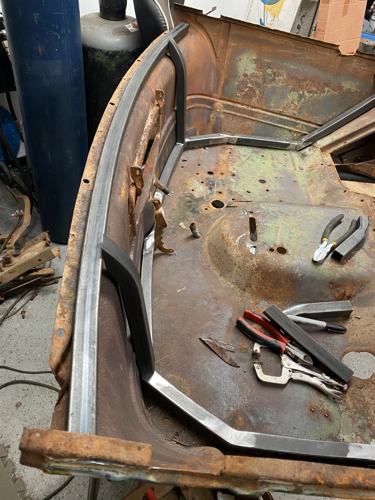

  18. Tat2Neil
    Posts: 136
    Tat2Neil
    from Mesa AZ

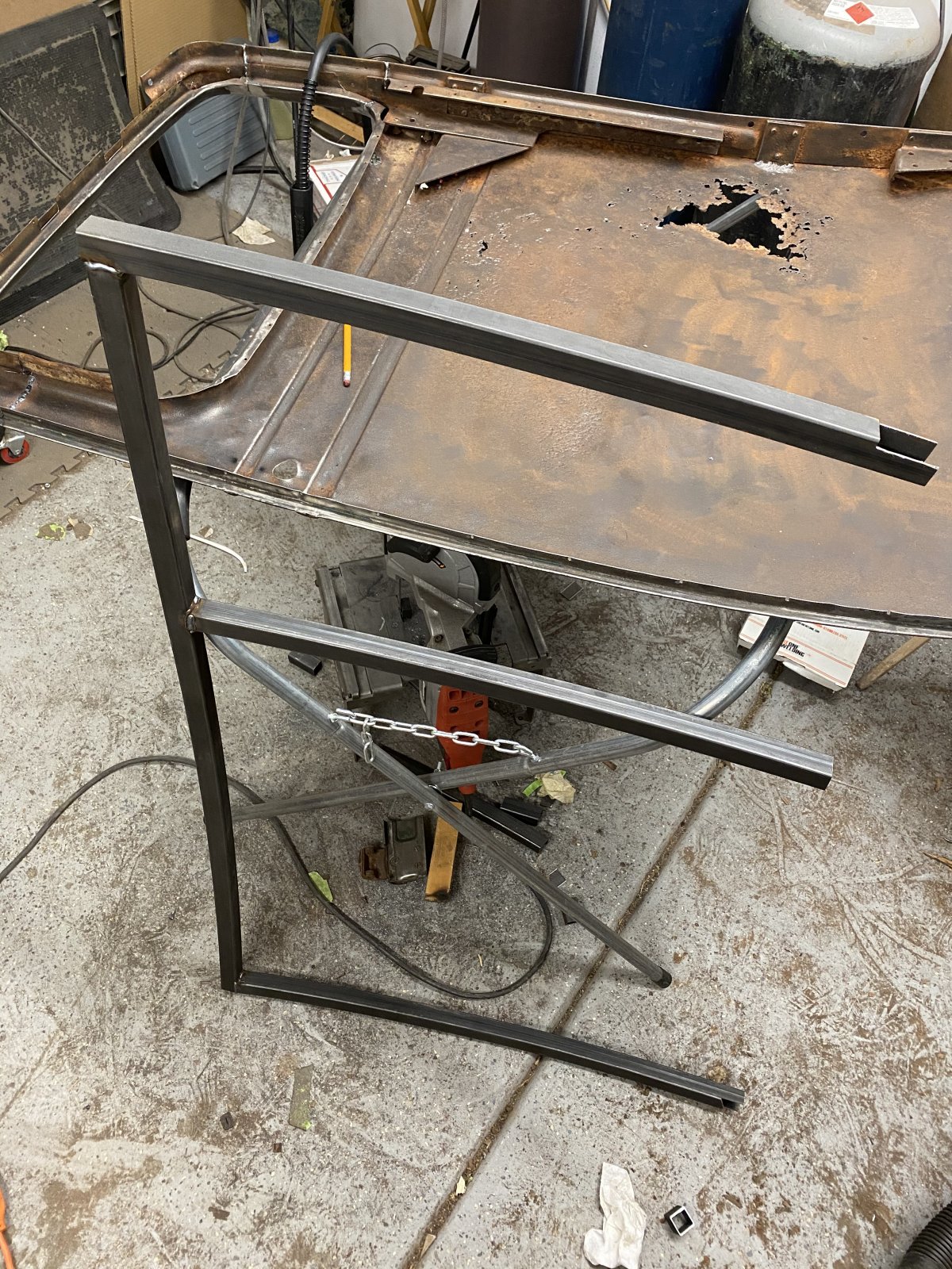

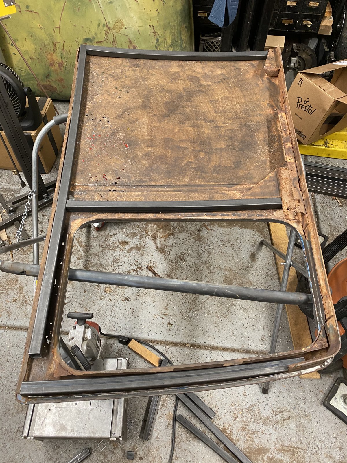

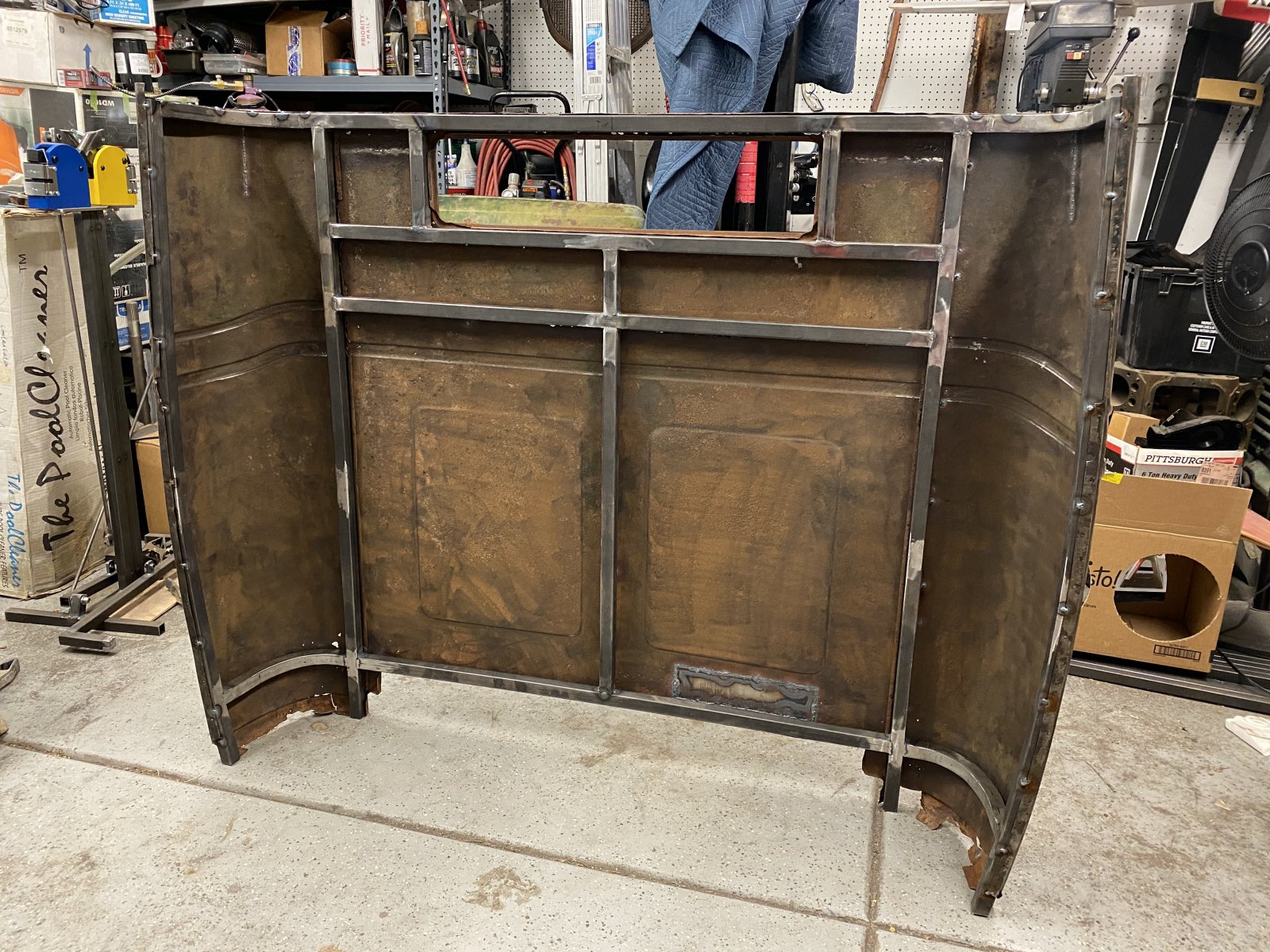

    Next it was time to start building my cab frame. Again, following Carl’s example, I used 1x1 steel tubing and started cutting and fitting starting from the rear panel and moving forward.
    I had Cut out a new top edge for the cab corners that I made to match the top edge I had just cut off, and had to make a small relief cut to fit the new top edge
    5A0C89DB-380F-4D58-9A21-E4C1AC73AA51.jpeg 688603B5-04FF-4E5C-8868-9E53E4501672.jpeg 3D5EAE8A-15B0-4B8F-BEA5-36303C49BD85.jpeg 6E33AE5D-9ABA-45B0-818A-D0C38881B86C.jpeg 51A721D3-F677-48E5-AAE0-DC624F0568AB.jpeg EF0B0B34-C6D0-4EB4-86F6-A99350DAD121.jpeg F0361294-2008-46AE-AC04-9A34C61C750E.jpeg 211406A2-CFB1-432F-A38C-37EBC3A7EC08.jpeg

  20. Tat2Neil
    Posts: 136
    Tat2Neil
    from Mesa AZ

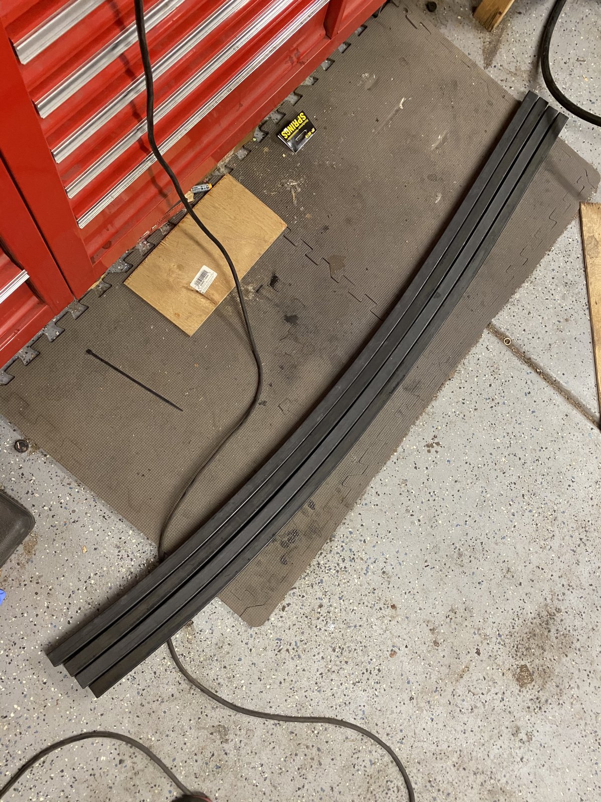

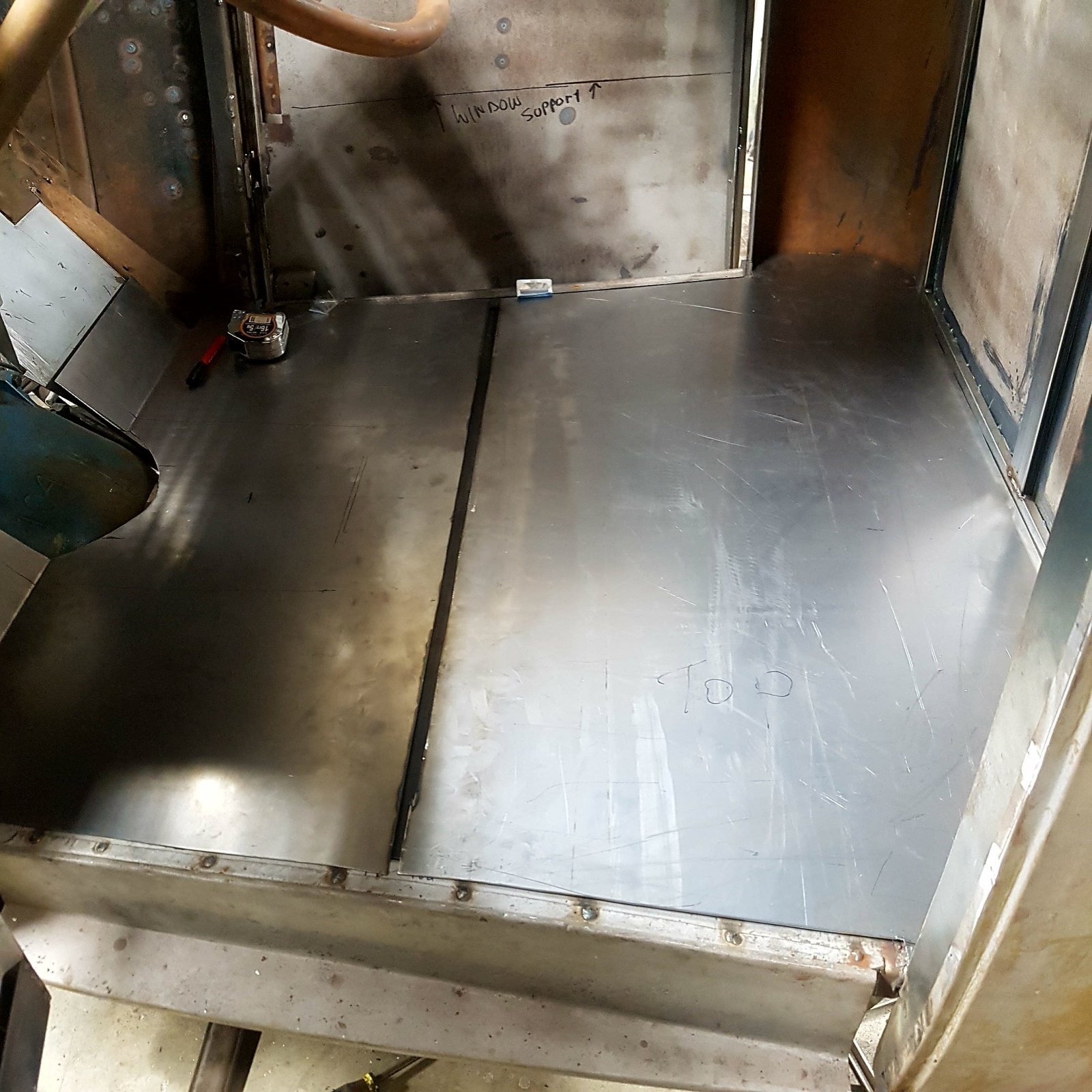

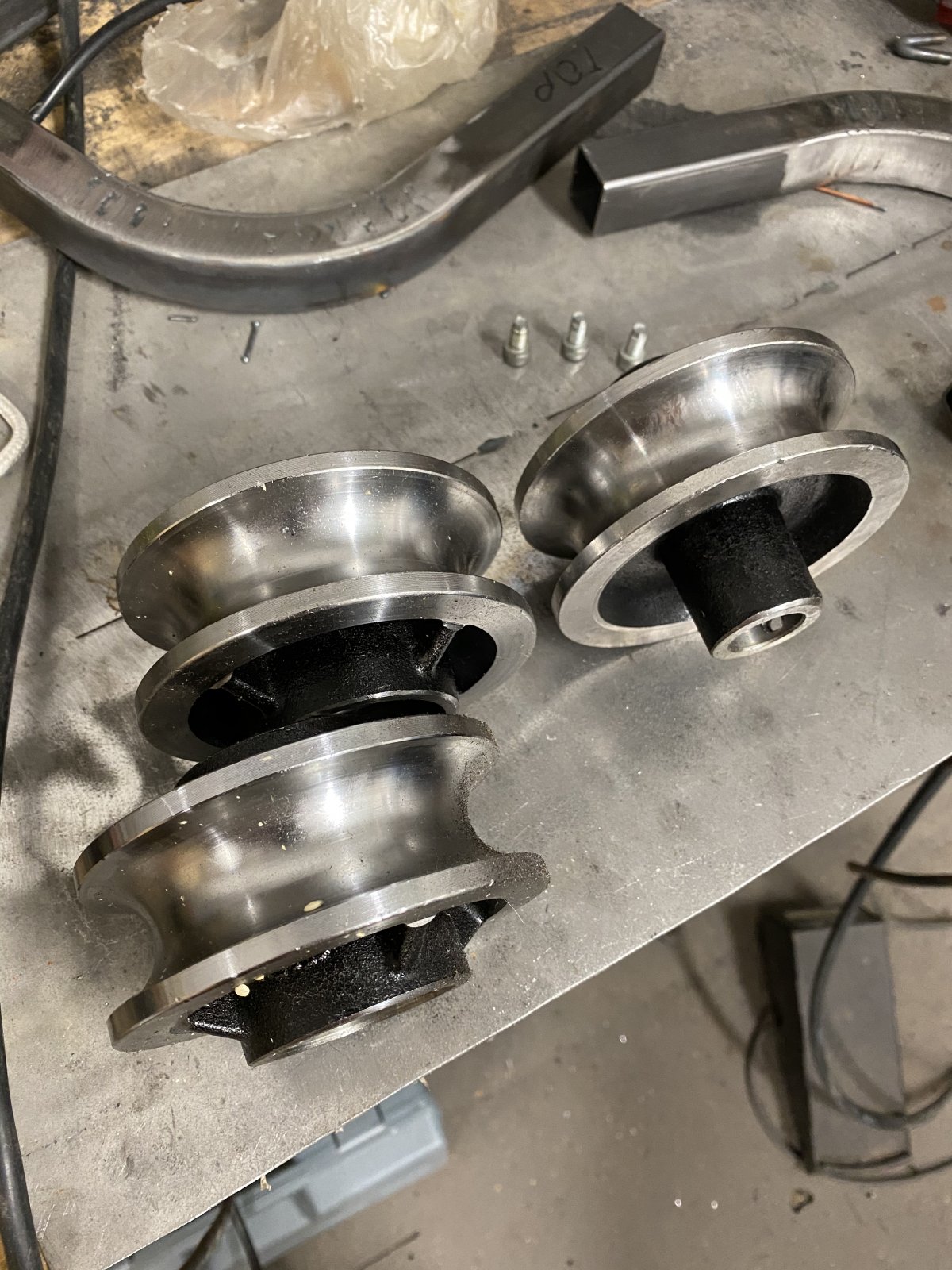

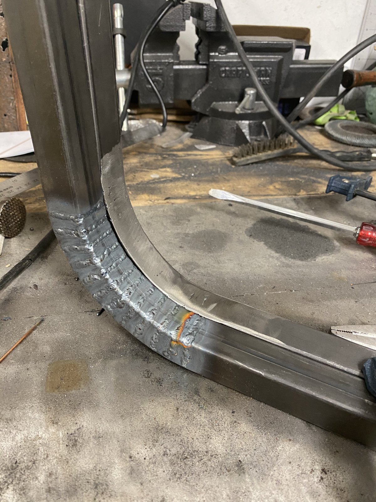

    In order to make the curved pieces that make up the B-pillar, I bought a harbor freight tubing roller, that came with 3 dies for 1” 1.5” and 2” round. So I took the 1” dies and chucked em up in my little 1939 atlas lathe and turned down the inside to allow me to use it with my square tubing. Then I just made a template off the best cab corner edge and made 4 pieces to match. (2 for the cab corners and 2 for the back edge of the door) then it was just matter of making the lower corners and fitting everything together and trying to match it up with the back edge of the roof. And after a bit of welding and grinding I had myself a rear cab frame.
    Also got my first taste at making a patch panel. I thought it would be cool if I did mostly TIG welding, but it was extremely difficult when trying to make my patch, so I hooked up the MIG and never looked back.
    AC61BCAD-0A06-4406-BDA9-EEA12C2D851E.jpeg C24FF58A-068E-45B9-AF19-9193B03D56A0.jpeg 67DB428B-AE86-4F2C-9AE6-F18C22A9AE14.jpeg 005621E2-366B-4D05-B6F8-FB155DB0EE34.jpeg F5B49AE7-6E2F-48EA-B7EC-7074C0F08C9F.jpeg FCF85AE7-A678-4497-AB2A-FA3E77B06BF2.jpeg 260B96EA-4CB5-4DAC-B9E3-6A8BAF2DC257.jpeg 28D46649-B8A0-458D-BCFB-C2FF25C515B9.jpeg 3574FFD4-0D44-4EFA-AE0C-BFC4AFBE8E58.jpeg

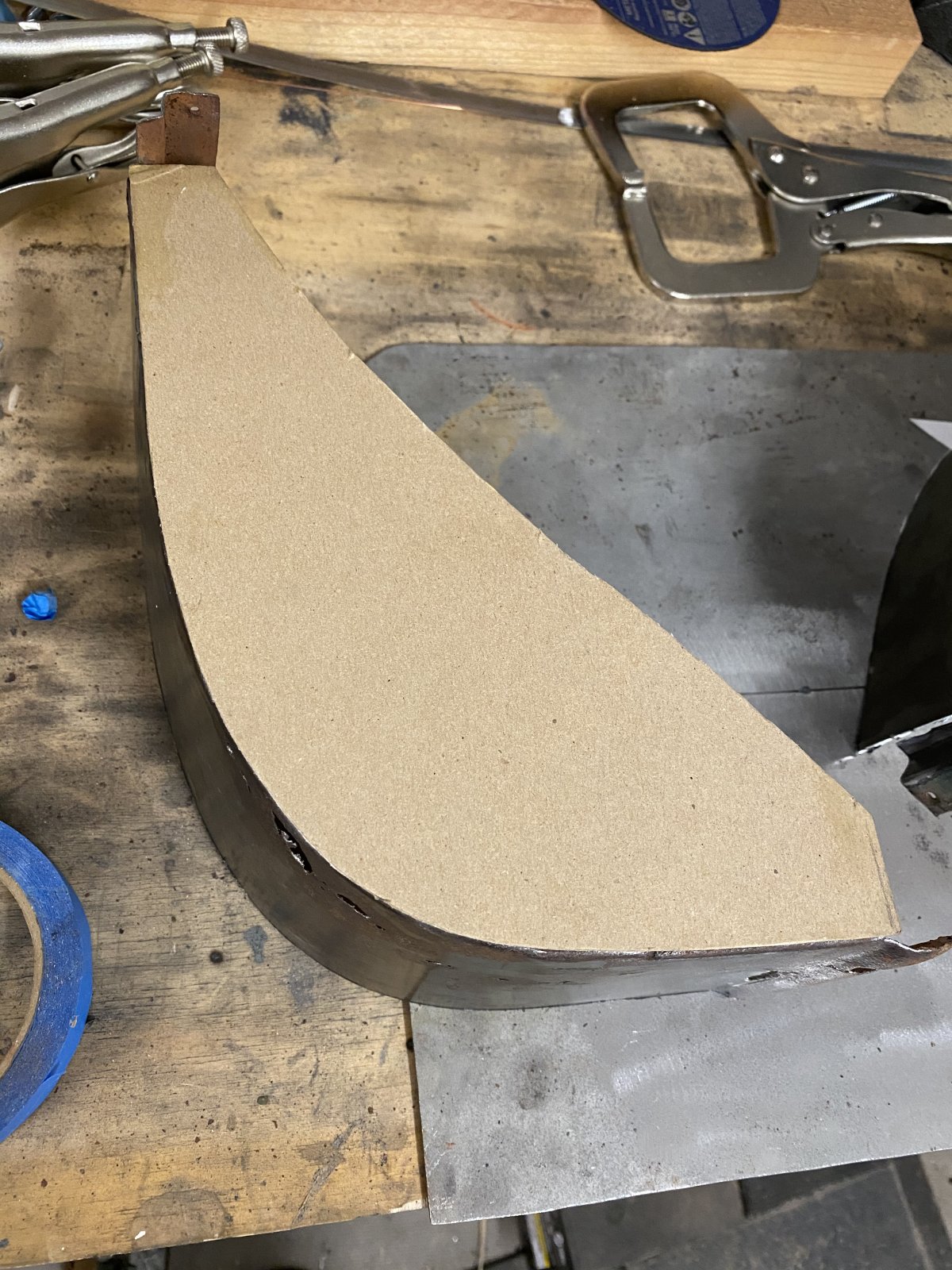

  22. Tat2Neil
    Posts: 136
    Tat2Neil
    from Mesa AZ

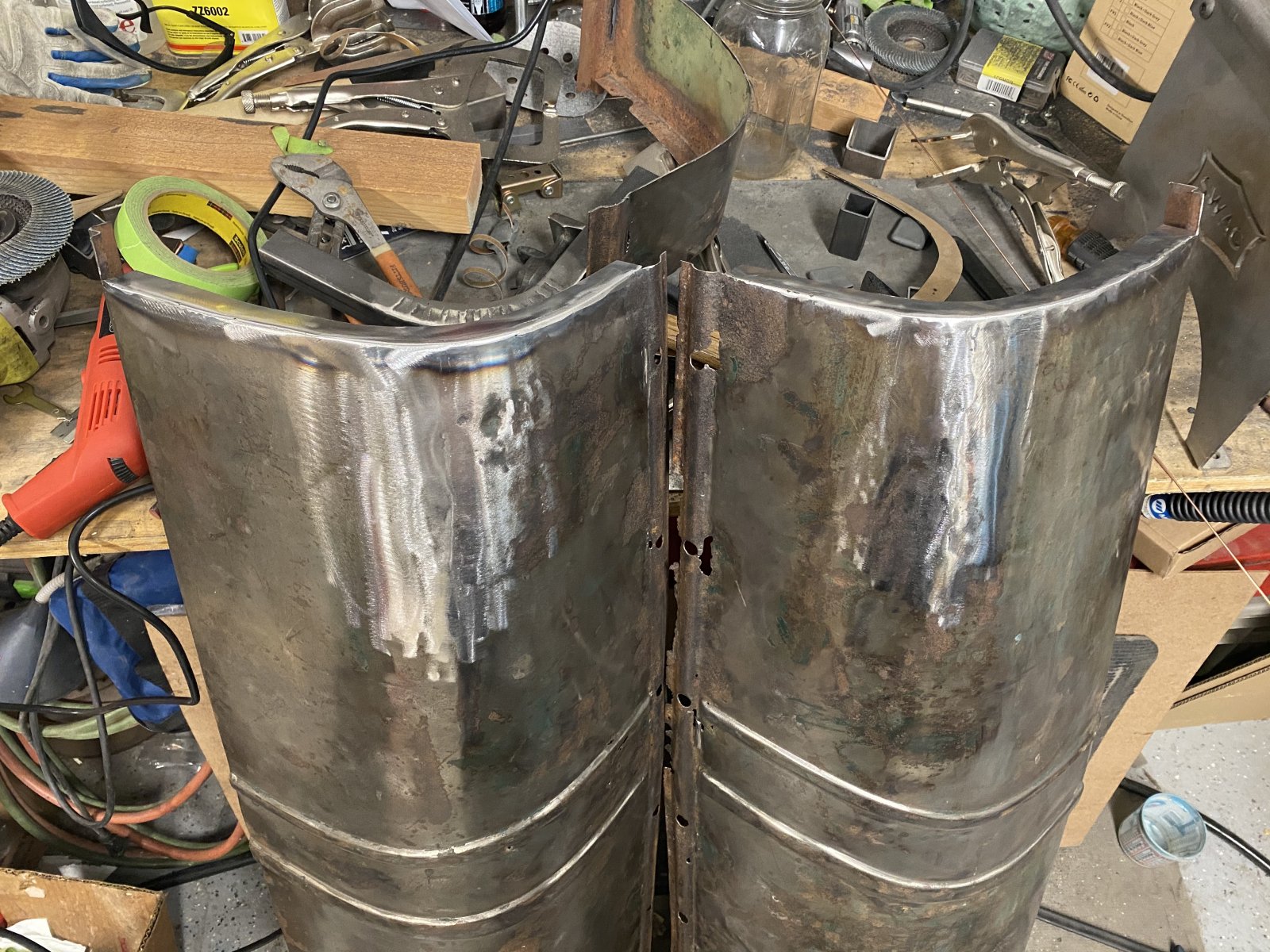

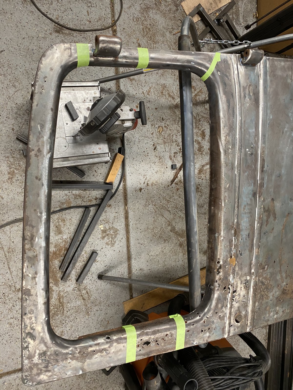

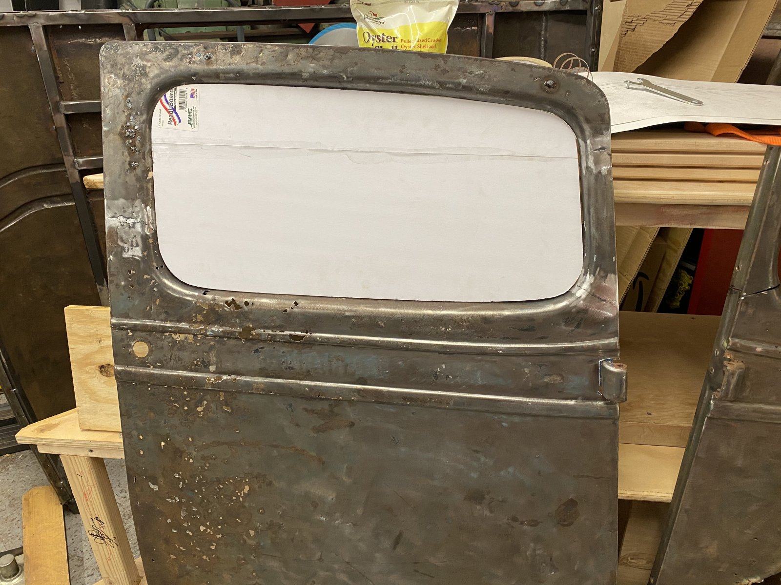

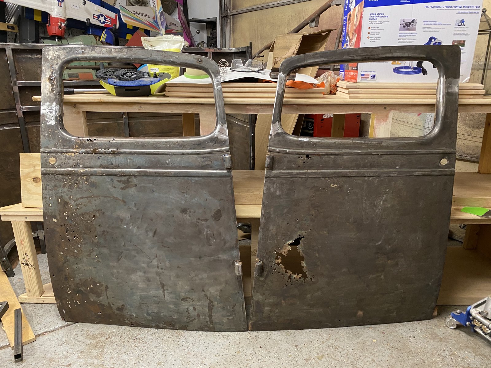

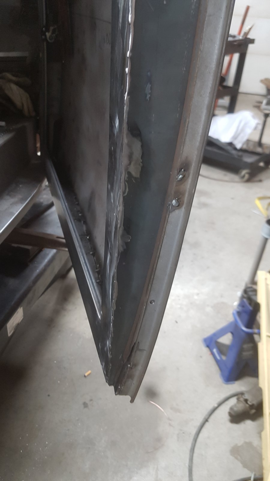

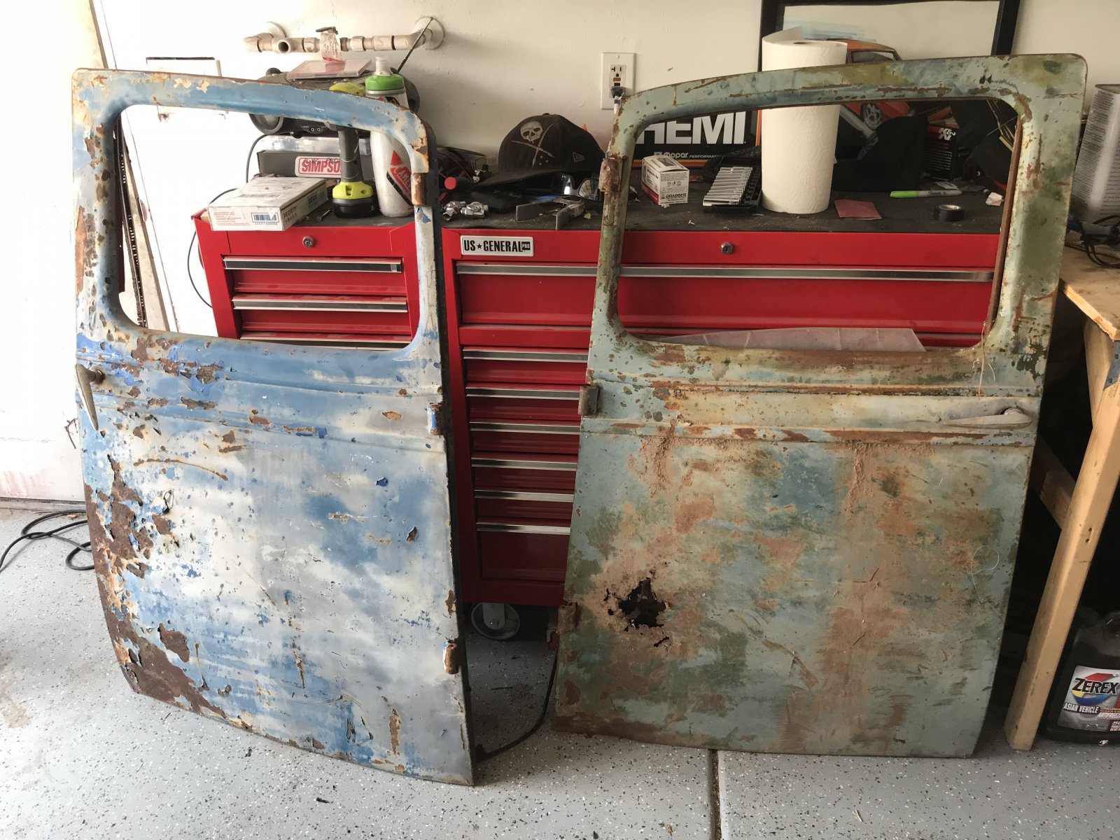

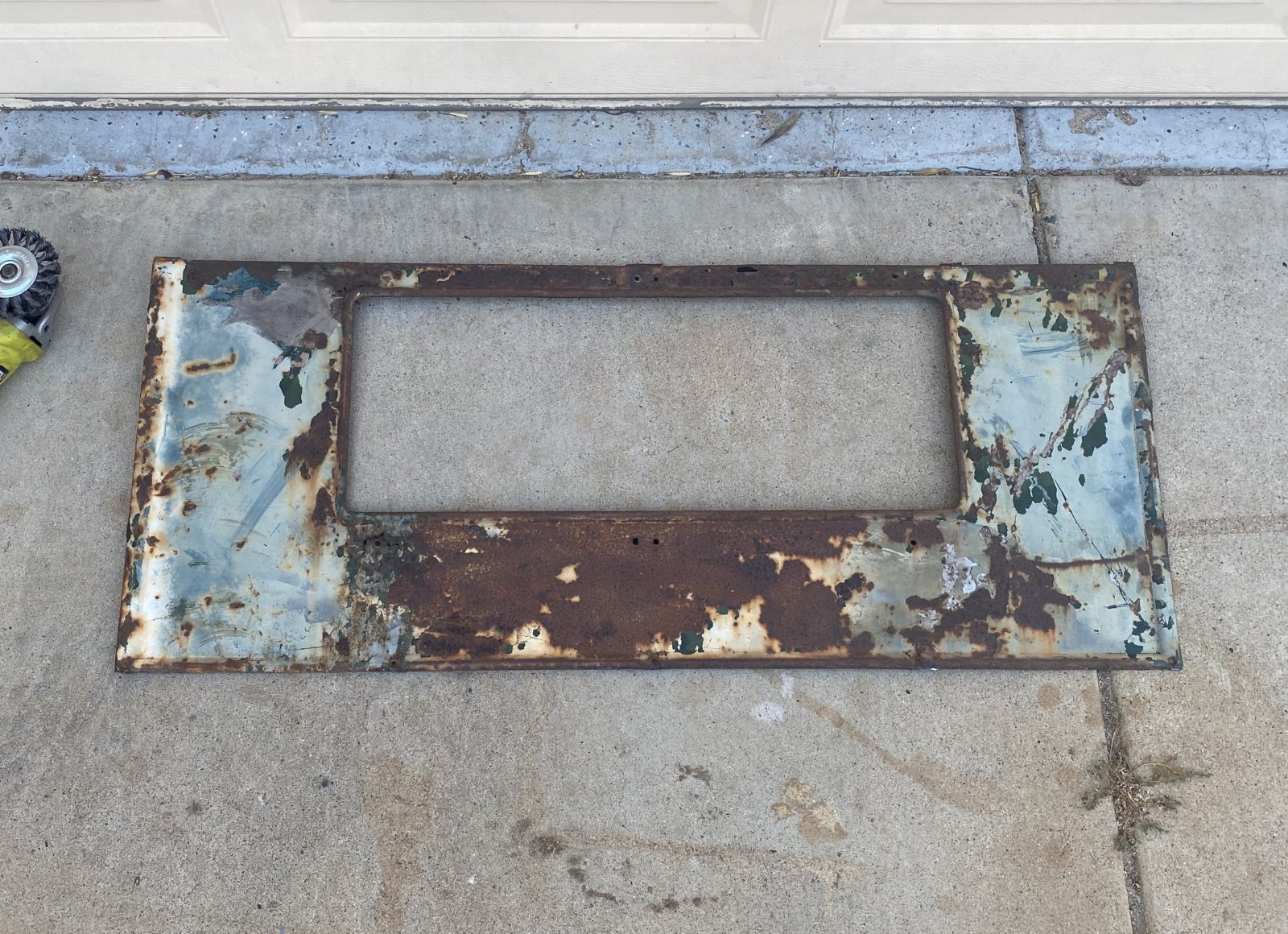

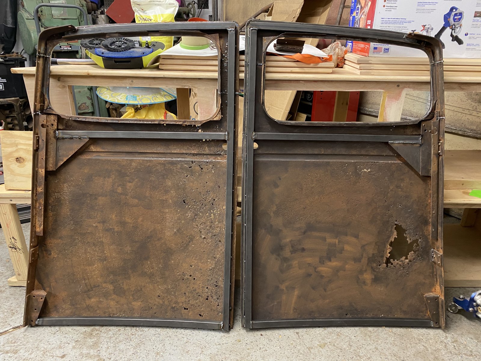

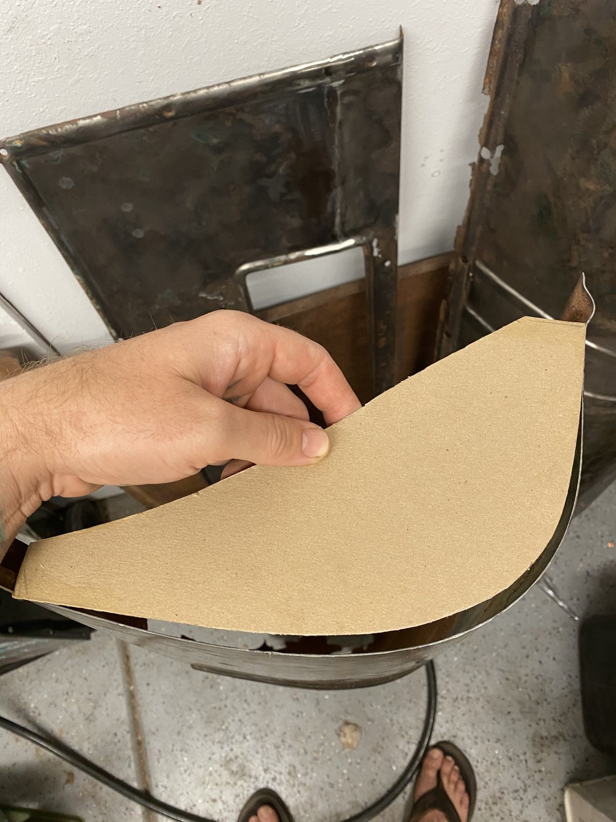

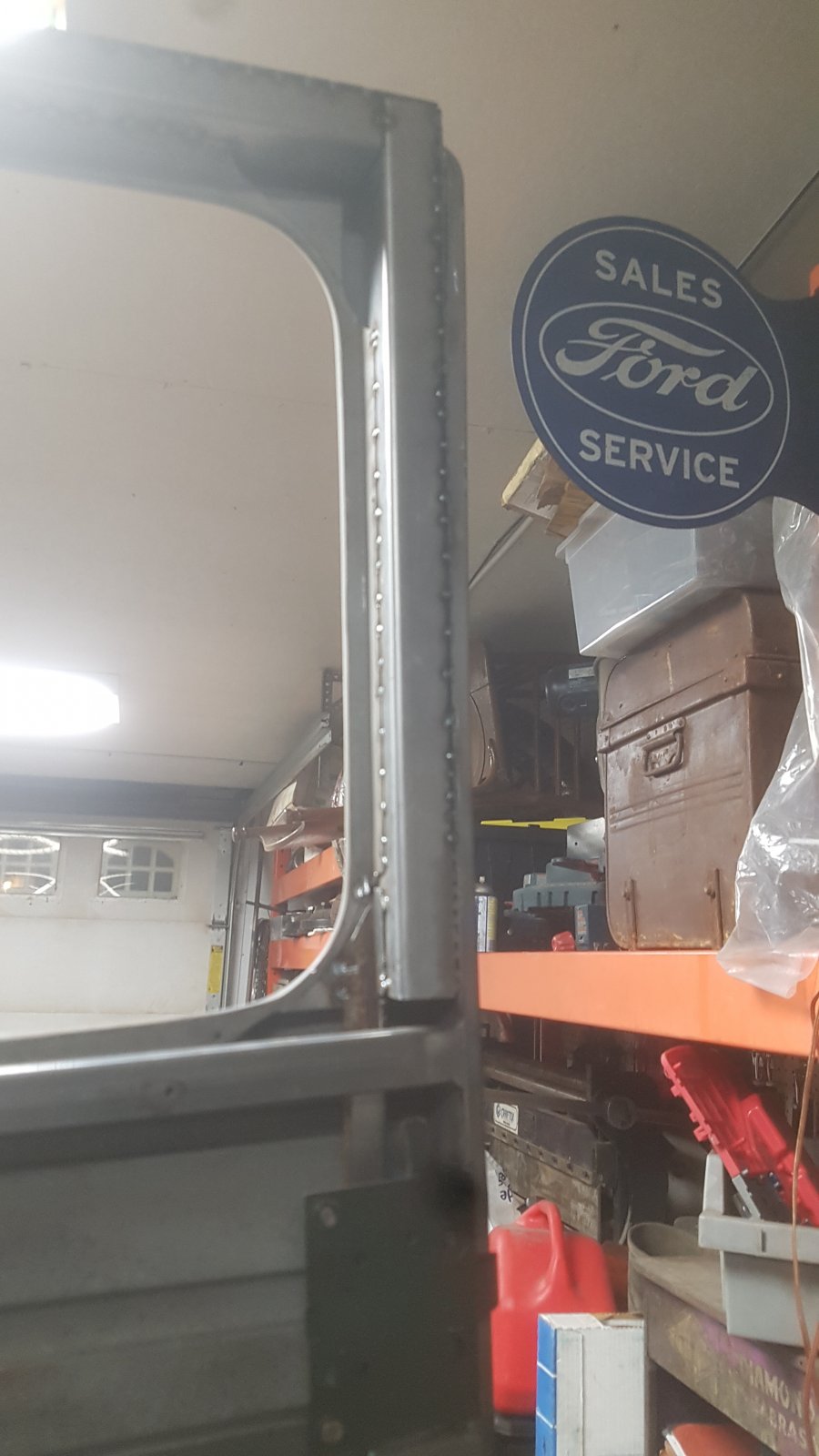

    Next it was onto the doors, I stripped the rest of the splinters out that were the original door frames and got em down to just the outer skin. Then did some more tube rolling to make my frame pieces fit nice n tight. Then it was time to chop.
    I made a foam board template of my window opening, and then cut out a 4in section and made a new window template. which was helpful because it showed me how much the front edge of the door pillar would need to lean back and that it was best to cut just past the top radius so you don’t have a ‘kink’ where the different angles would meet.
    I know you would typically just match it to the roof line, but my thought process was if it fit from the factory and I’m bringing everything down 4 inches and keep the exact same shape, it should still fit when it goes back together. (Spoiler repeat: it doesn’t, I had to cut the p***enger door and raise it 1/4” during final ***embly to fix the gap. So pro tip, first get the roof on, then match the door to the roof)
    After cutting down both windows to match my template I finished fitting the frame pieces and welded em all up 31067F89-70A5-423A-A4A8-5A03645247B5.jpeg 11F4F421-17C0-4181-AB20-8DE795EAF6B8.jpeg CF057280-454B-4034-B7CB-920C7BA7B0B3.jpeg F4D79907-A357-42B9-8C9F-5E76C6A44D7A.jpeg 537C7428-0D8B-40EF-A2D9-D322FC9A0FF8.jpeg F9290C9D-E8B7-4B98-A3E7-DE8B694FDAB9.jpeg 54DEBC6E-9B67-4F50-9D4D-536777AD8DF6.jpeg DCC7C0AC-C981-49D1-9EAD-391969446281.jpeg 8F80CF6C-B2C5-4CAE-8958-04060F3A02F1.jpeg 9973D5C8-4AC3-4B29-8208-6A9EF8497F57.jpeg

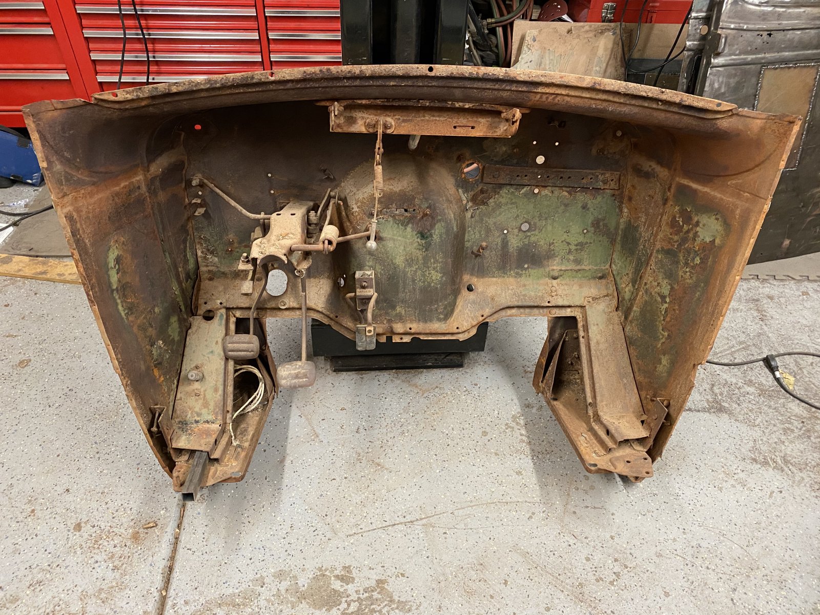

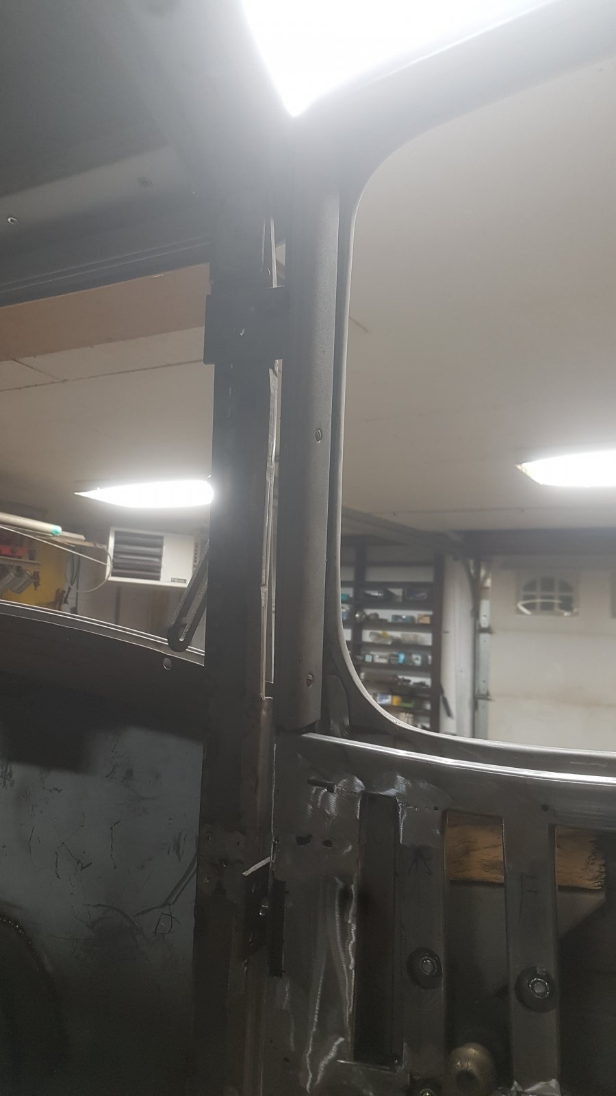

    Next it was onto the cowl, more of the same process. I rolled the A pillar pieces so match the front edge of the door and made myself some hinge reliefs that will hopefully make life a lot easier down the line when I start hanging the doors, I’ll also be adding another piece of tubing to make it 2” wide eventually. 57F76695-2BEC-4F1A-8203-F5033DC49C8B.jpeg 7FF6C2BD-3C6C-41B8-BE02-7E3E53DBE283.jpeg 12DBF70B-E60C-48E6-B02B-3DA3C1260330.jpeg 2BDCCF7C-2E8B-4D7A-B6D4-BC072F78A97C.jpeg 09BD72A1-CBEF-4F82-896B-703C9E3F005B.jpeg 4B1258D5-5D93-4D46-9ACA-34749AB84975.jpeg F1172D5D-DCFE-4524-974C-2F8108E554E6.jpeg 7F365338-9ABF-4AEC-9001-3FB828765345.jpeg

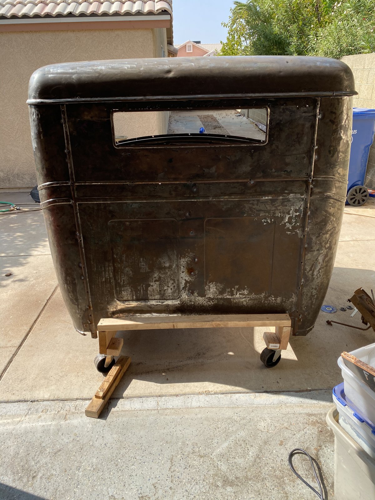

    At this point I received some great advice from a good friend of mine who builds some amazing hot rods out in Colorado, (Justin Brunmeier, if you don’t know of him, you should), he told me not to finish the cab until I had the truck frame to build it on.

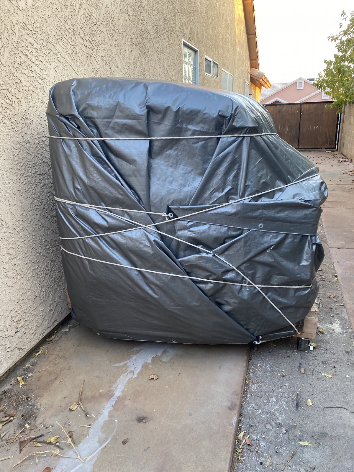

    So, I made a simple wooden cart to hold the cab and tacked all the pieces together, it felt great to see my cab together for the first time in probably 30+ years. Rolled her outside and took the wire wheel to the rest of the cowl and roof paint, snapped some photos and wrapped her up.
    It’s funny that before I started this project I thought it would be years of work before I saw my cab together, and it was only 4 months after Father’s Day to get it to this point, nothing to it but to do it.
    44A8CE97-3445-4E50-AC2D-88B2B6A25D1D.jpeg 705E28E7-6578-4E8A-A6B7-892F219CBCB4.jpeg 1DA398B7-2458-4484-BA58-3365FC83535F.jpeg 4755BA13-A055-4FAC-AC1A-E79CEFEA7566.jpeg D6AFA4C2-CE98-4392-A420-09661566D4C5.jpeg 857E65A4-A6A9-411C-A44B-CCAC8C21016D.jpeg

  25. ronzmtrwrx
    Joined: Sep 9, 2008
    Posts: 1,891
    ronzmtrwrx
    The proportions of your cab look great. Nice work. You must be in a very dry climate if you can get by with wrapping up a bare metal cab and letting it sit outside. We could not do that here in the southern part of Missouri. :cool:
    Six Ball, 31chevymike and Tat2Neil like this.
  26. Tat2Neil
    Posts: 136
    Tat2Neil
    from Mesa AZ
    Thank you! And yes we’re very spoiled here in the southwest, you’d have to really work to make something rust away out here.
