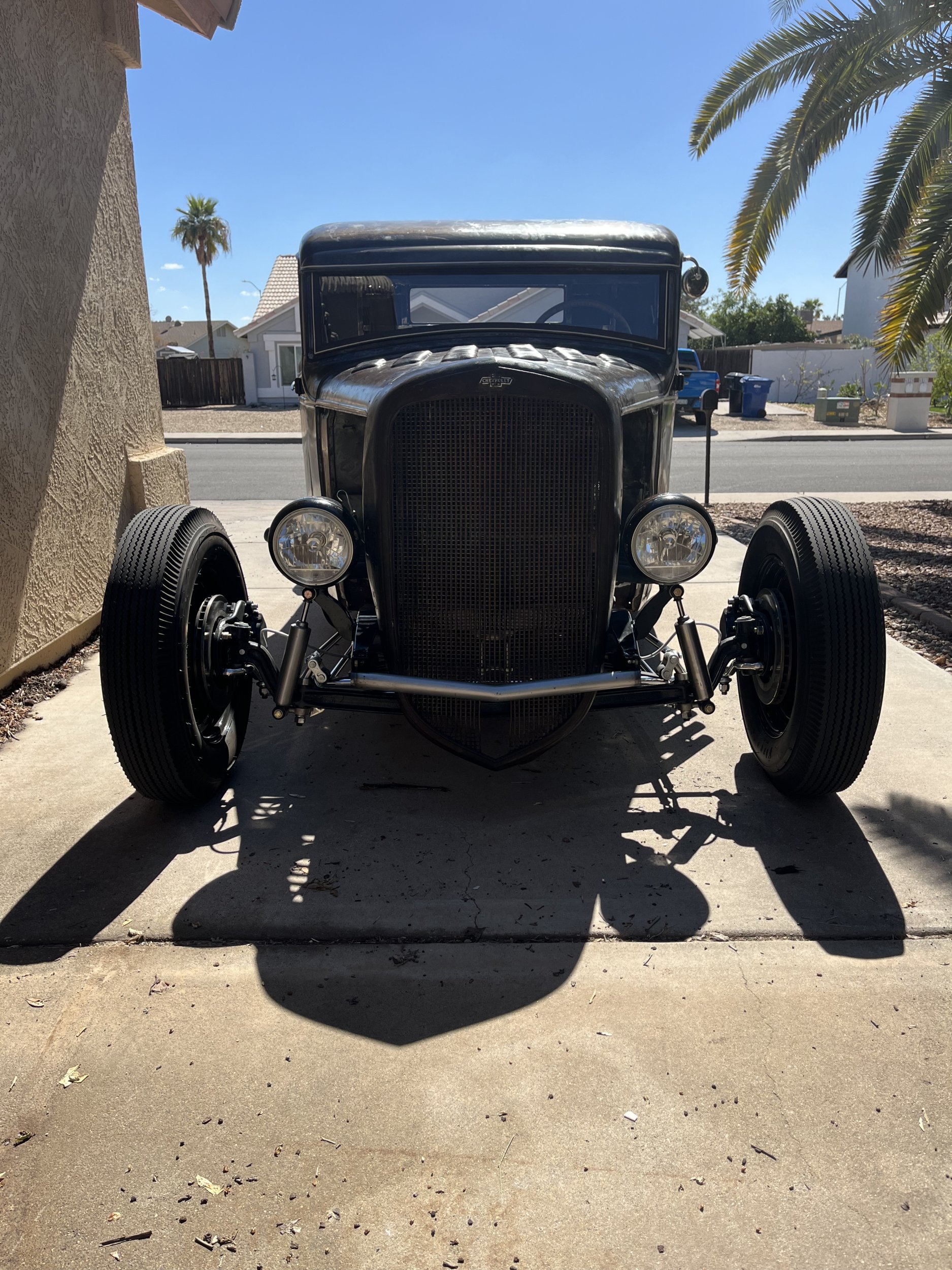

    Thank you everyone who followed along and liked or left a comment on my first lil hotrod project, what an adventure it’s been! This will probably be the last build post outside of maybe some longevity updates.

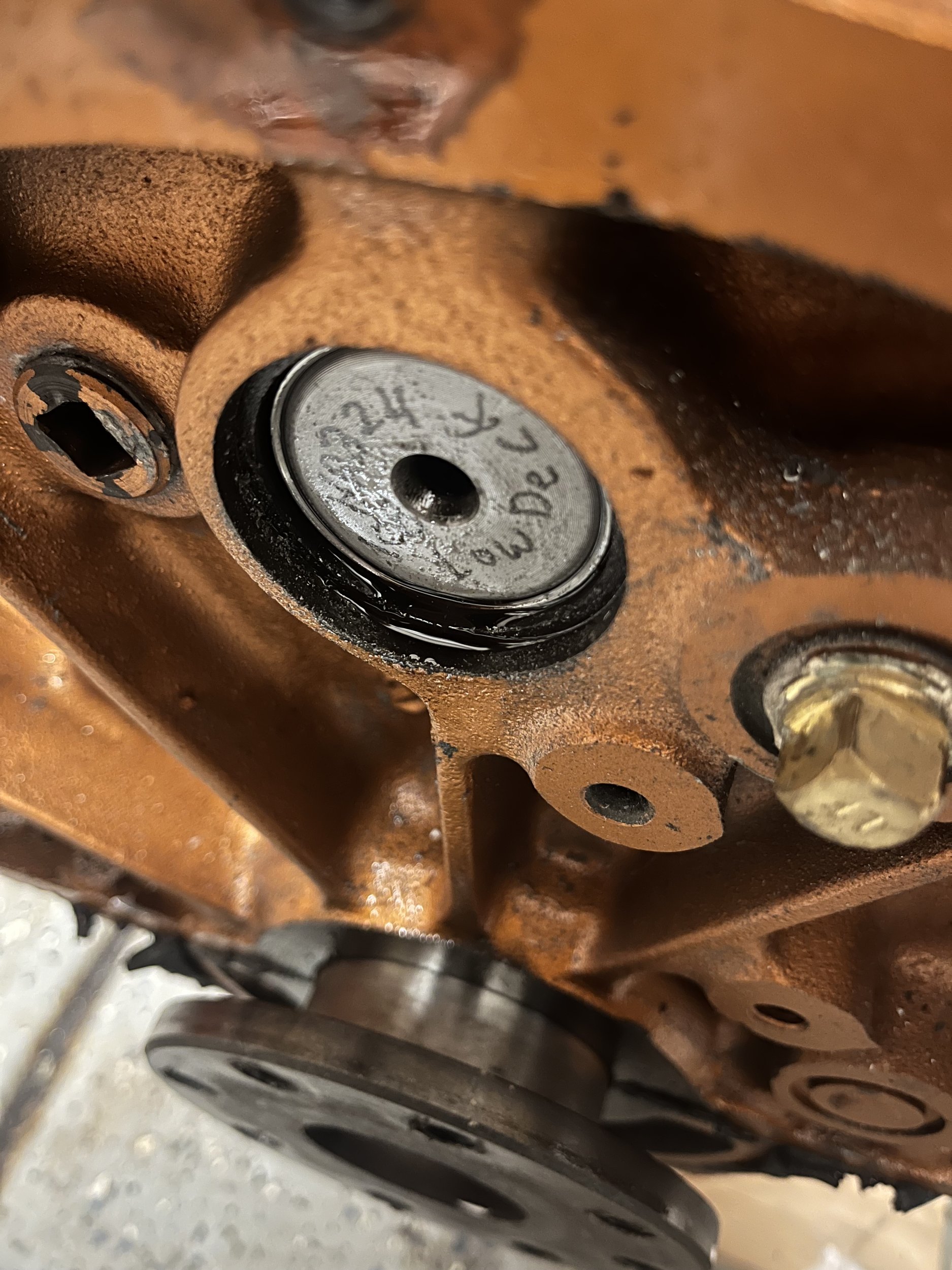

    Just as I was trying to enjoy the victory of ‘the first drive’ I soon discovered there was a slow but constant oil drip coming from the back of my motor which was a bit of a gut punch. I was thinking faulty oil galley plug and only then did I realize I should have hooked up a drill to the oil pump and primed everything and checked for leaks BEFORE stabbing the motor in the frame, doh! So out came the motor and trans.
    Which honestly was so much easier than I expected, one night of disconnecting a few wires and unbolting a few things and the motor was out the next day. I pulled the dizzy and hooked up my priming shaft and got oil pressure and found my leak straight away. Get ready for a face palm ‍
    all I can say is I don’t know what I don’t know, and before that moment, I didn’t know there was supposed to be a plug seal behind the camshaft. Hard to believe in all the hours of reading I’ve done around these motors, not once did this particular plug come up in discussion, but guess what I’ll never make that mistake again. After a good cleaning I installed a freeze plug with a layer of sealant and now I guarantee it won’t leak.
    Another positive to pulling the motor was to address my transmission. Had to change out the drive gear on the tail shaft to keep my speedometer from saying I’m going 75mph in 3rd, which was also making my mileage way off. I checked the inside for any obvious reason why it won’t stay in reverse but everything looked and functioned perfectly on the bench (of course) so I’m just going to run it for now and find a unit to rebuild or a low enough mileage one I can swap them out and see if it changes anything.
    a week later everything was back together. Which just left me to track down my non working turn signals issues, ended up being a loose connection in the steering column wire connector. I also got it ***led/registered/insured, that was a very VERY happy day!

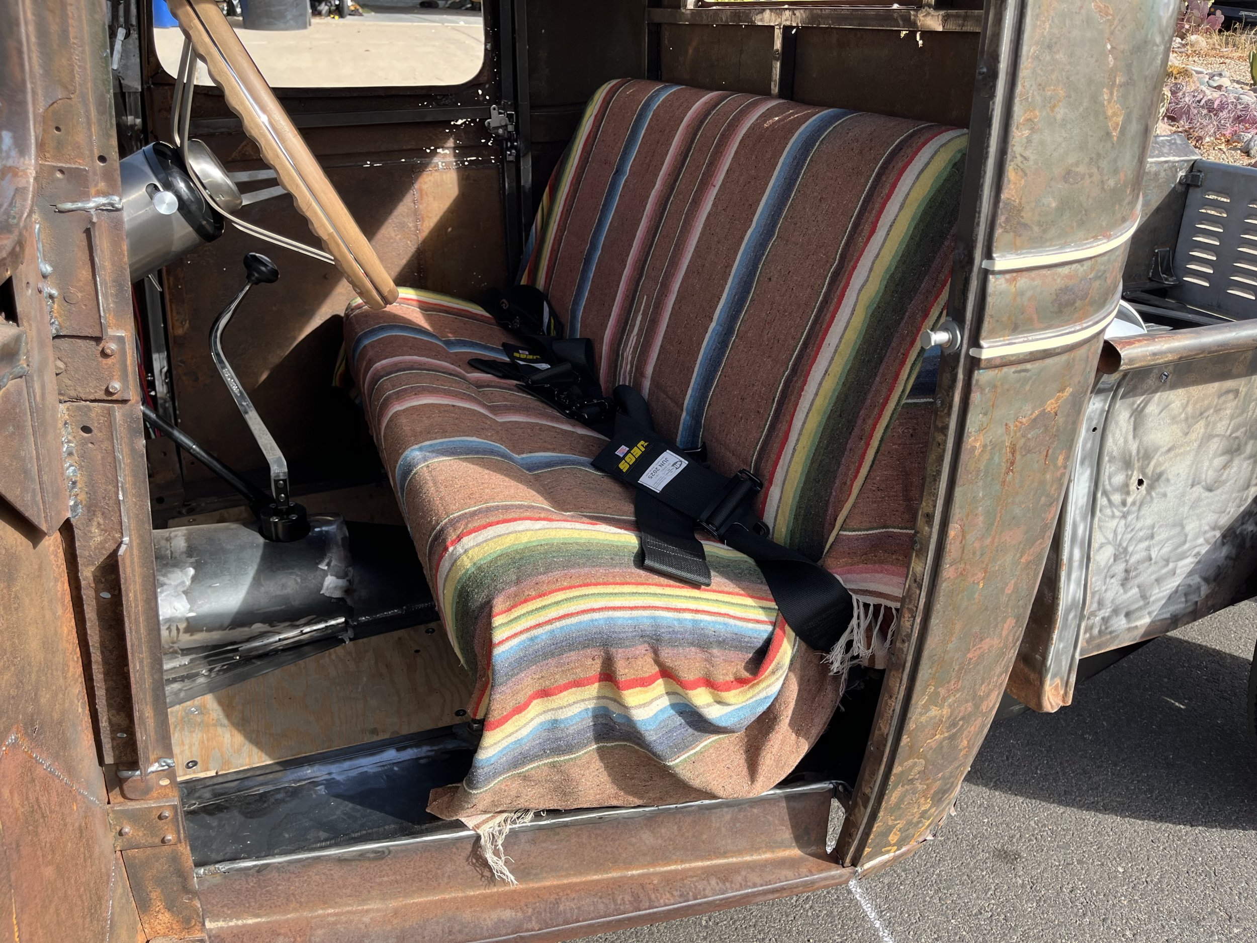

    Lastly I finished off a couple pinstripe lines and used 3m upholstery adhesive (aka yellow death) to glue my Mexican blanket to my bench seat, and a coat of boiled linseed oil to give the body a little sheen.
    On that note I am calling this project officially ‘un’finished. I’m nearing the 500mi mark with zero leaks, instant cold starts, and no other real issues outside of it not staying in reverse. But man, what an absolute BLAST this lil truck is to drive! Plenty of power out of my baby hemi, I definitely wouldn’t want to go any faster in this glorified tin can ha!
    I will probably make a set of lakester headers with block off plates and route to some mufflers as the zoomies look and sound great but they’re gonna make me go deaf by 45. Here’s the last couple shots I got on my phone, gonna have the wife take some photos with her professional setup that I’ll post as soon as I get em.
    Thanks again for following along my wild journey!

    Usually none of the plugs in the back are removed.

    No kidding? that would make sense as to why it doesn’t come up that often. I had to go back to the only photo I had showing the back of my motor during dis***embly and sure enough, there it was. IMG_8640.jpeg

    Looks like someone used Quaker State....
