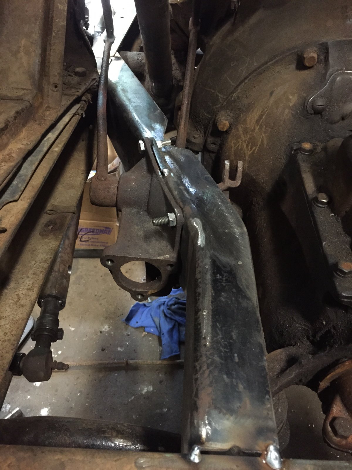

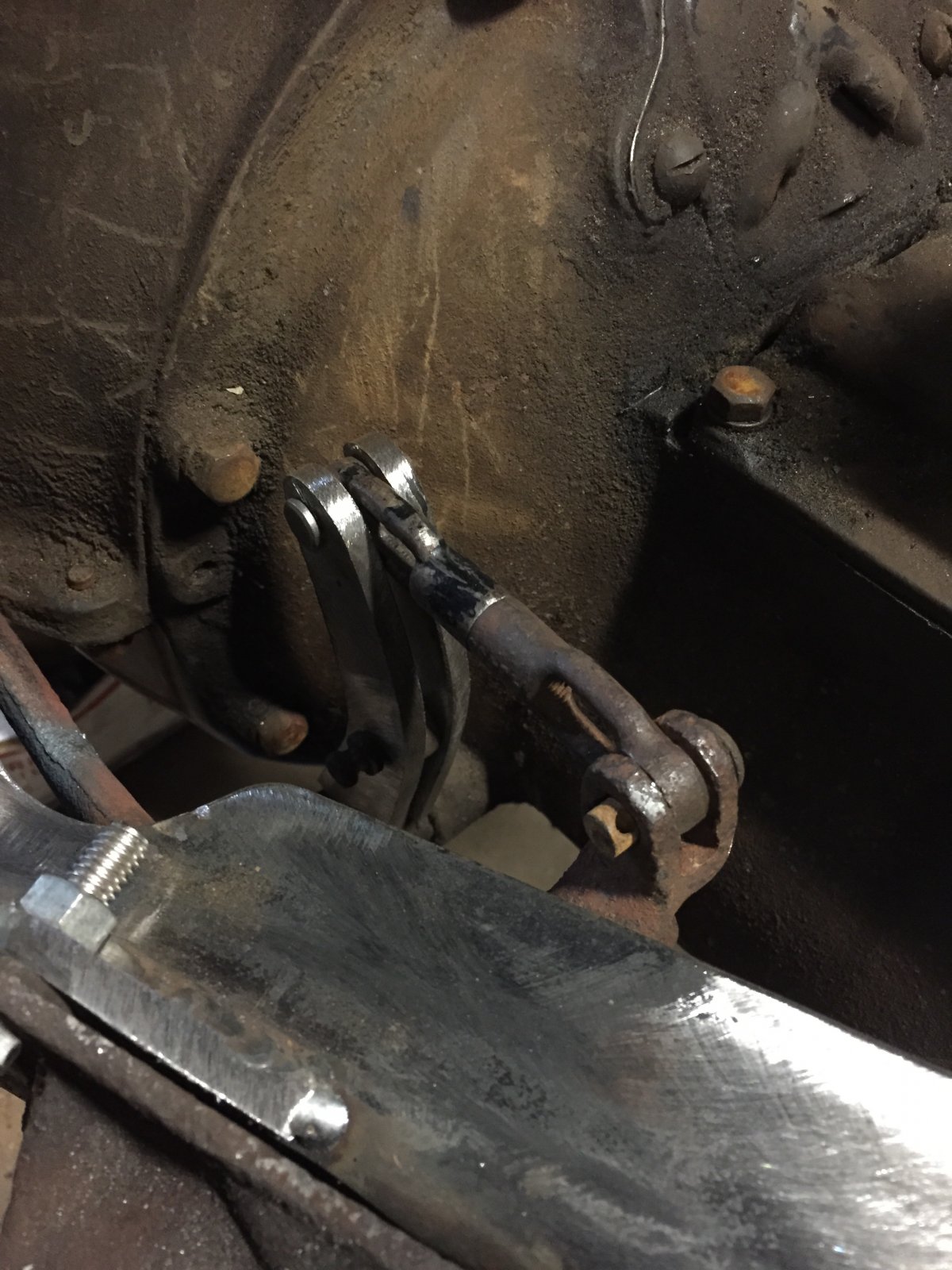

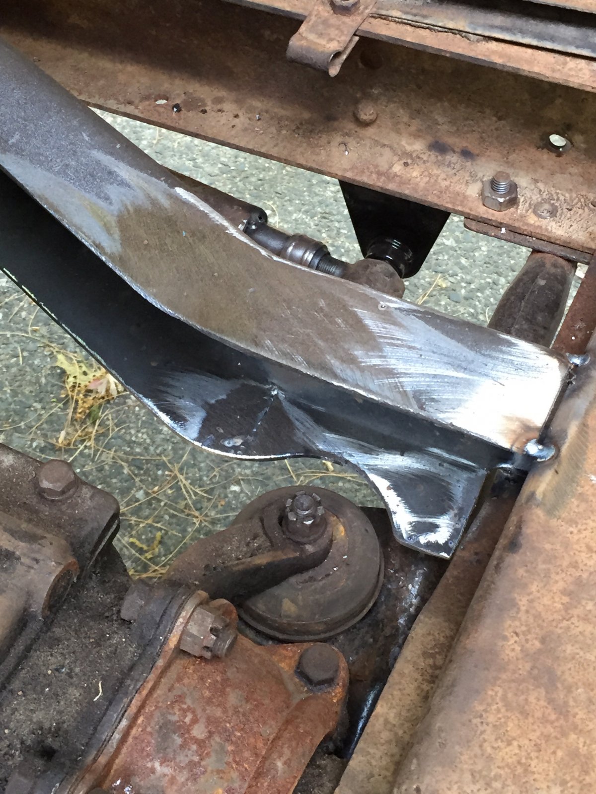

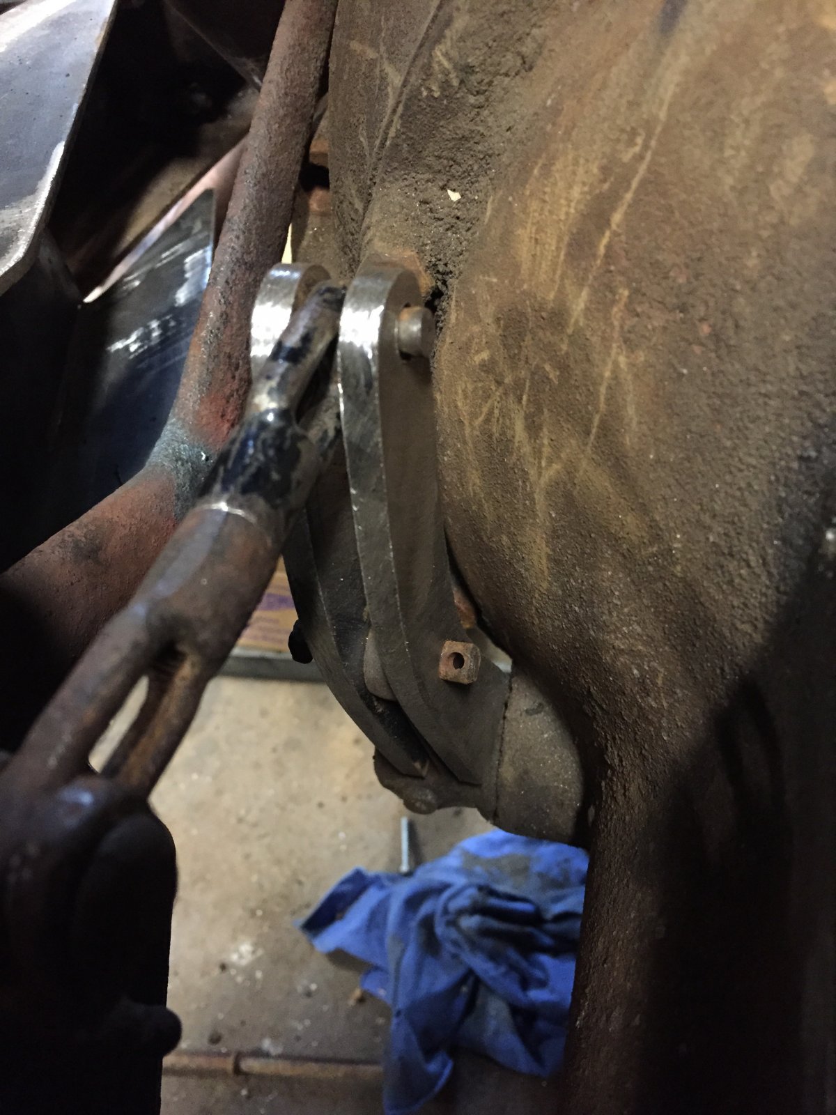

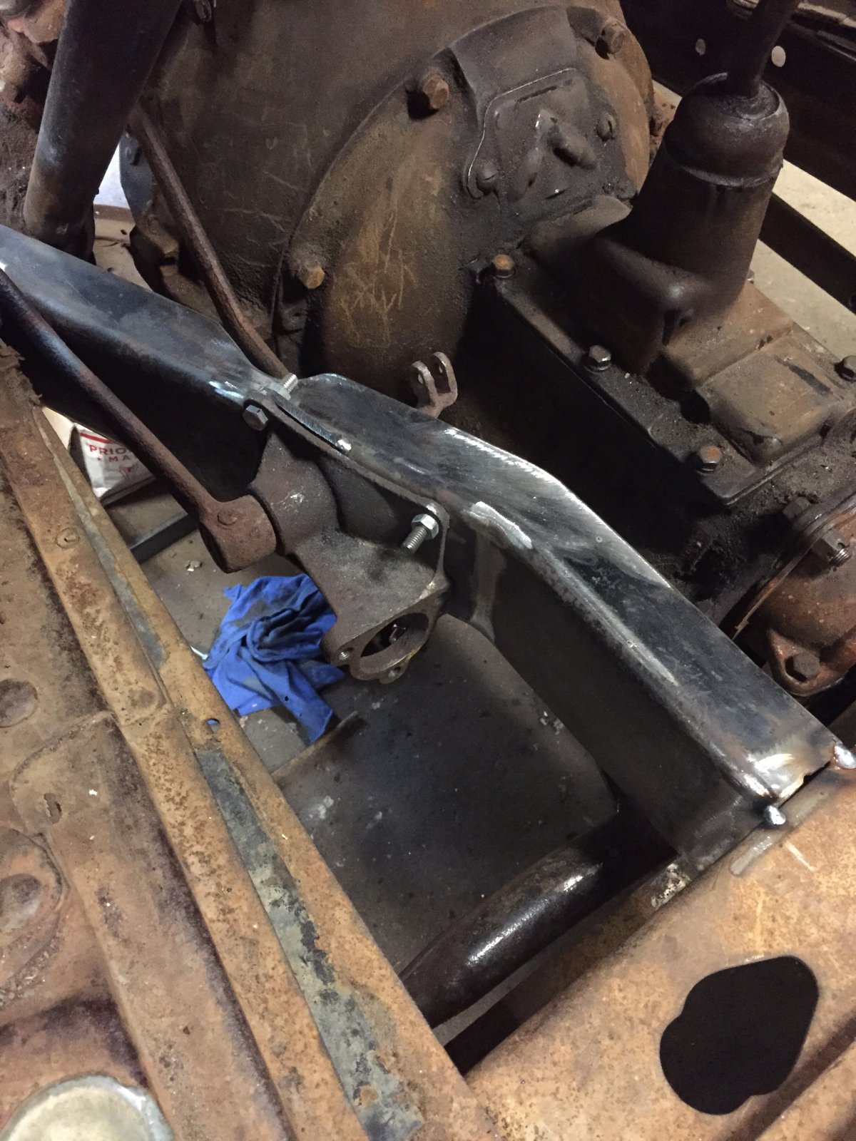

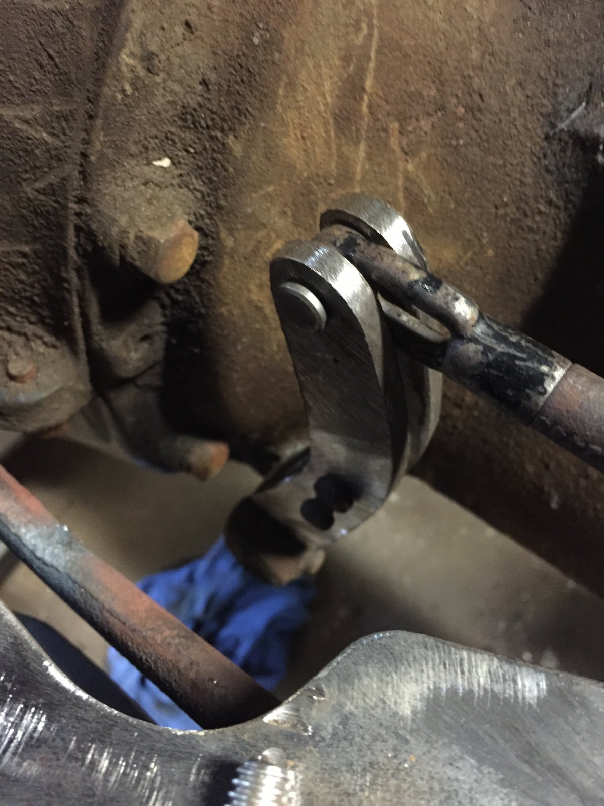

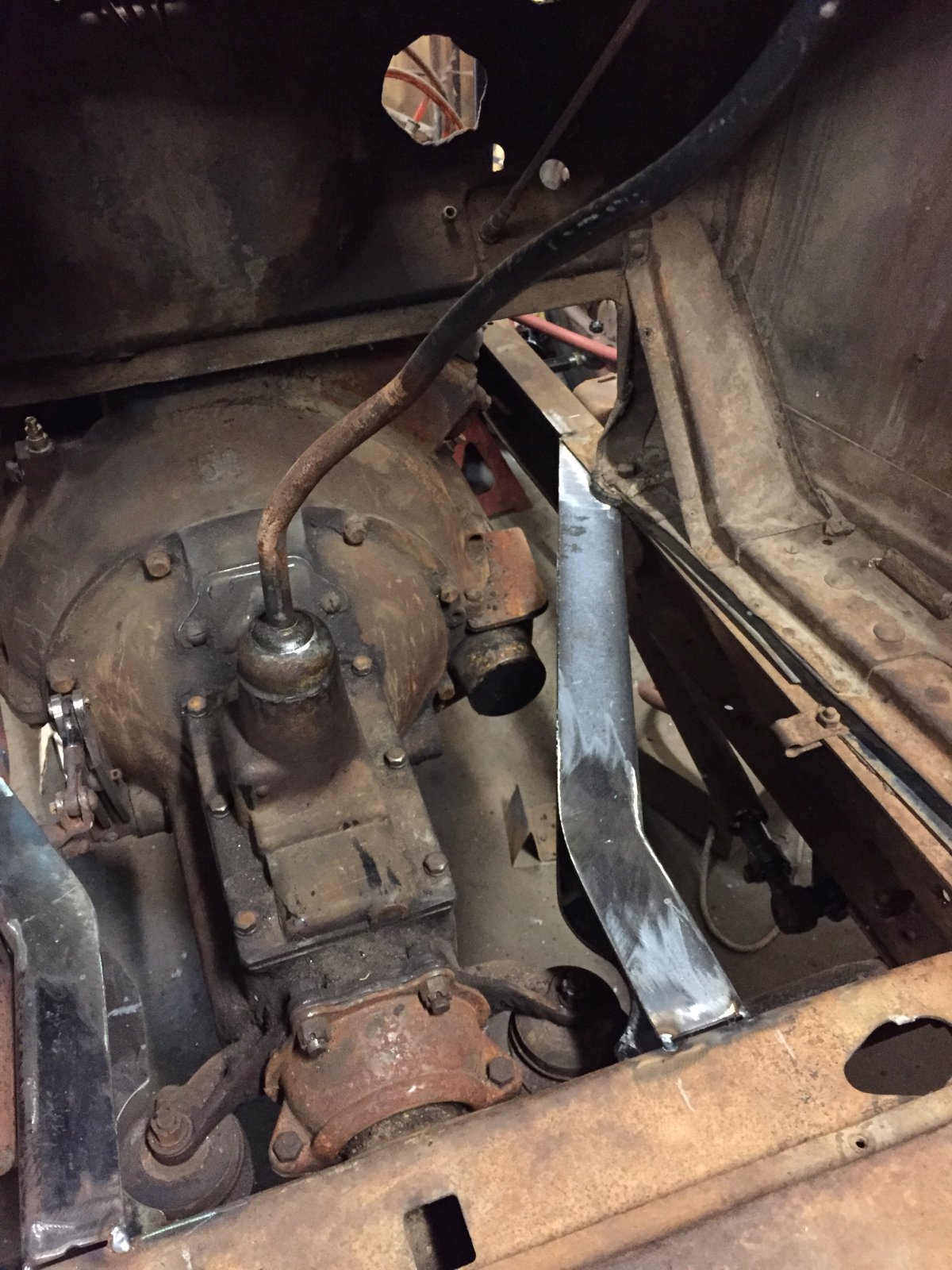

    Worked on the pedals today. Horse traded a pair of '39 pedals with pal josh. Made a K-member to mount the pedals, had to make a few clearance slots here and there.
    Due to the height difference of the clutch arm and cross shaft arm, I extended the arm... Rather than cut it I made an extension arm that Slides over the original and puts the linkage on a parallel plane.

    Got the other side done.

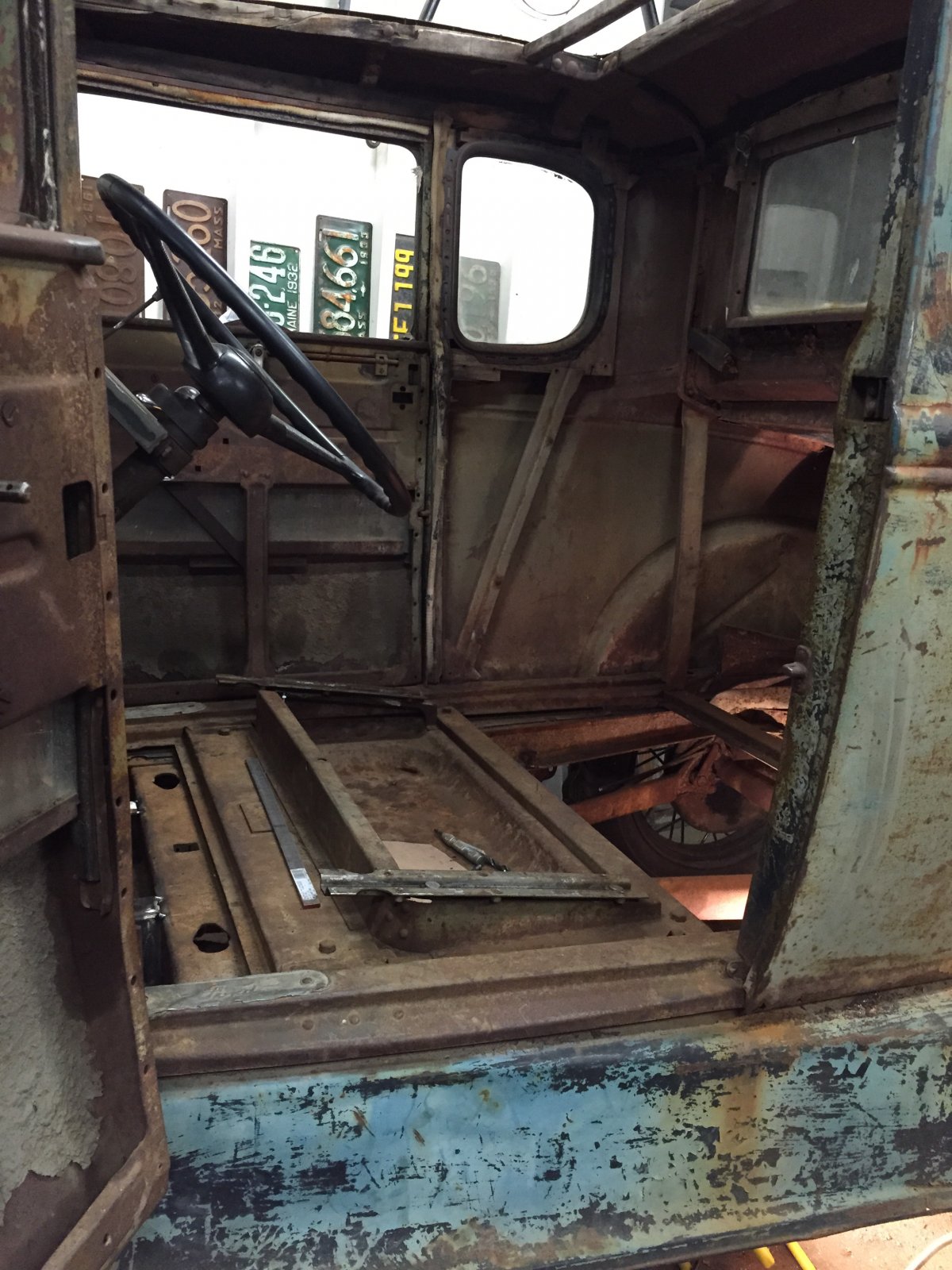

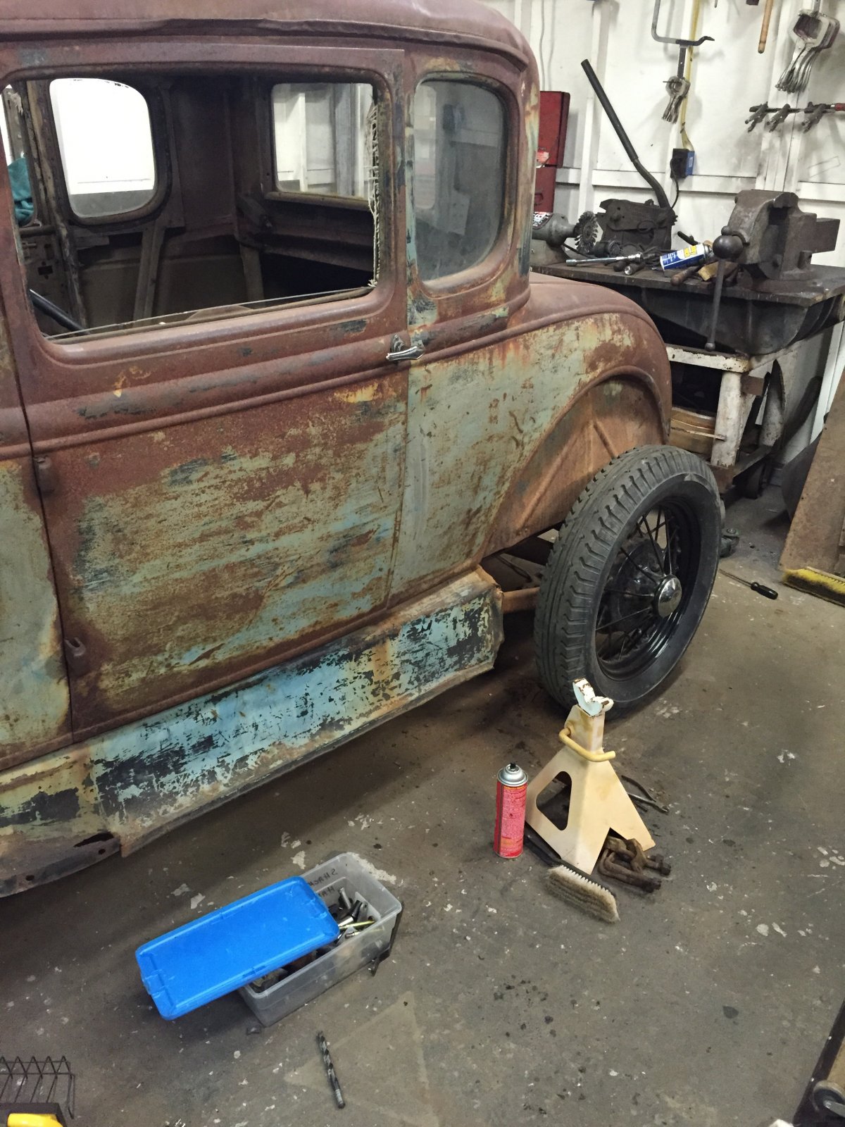

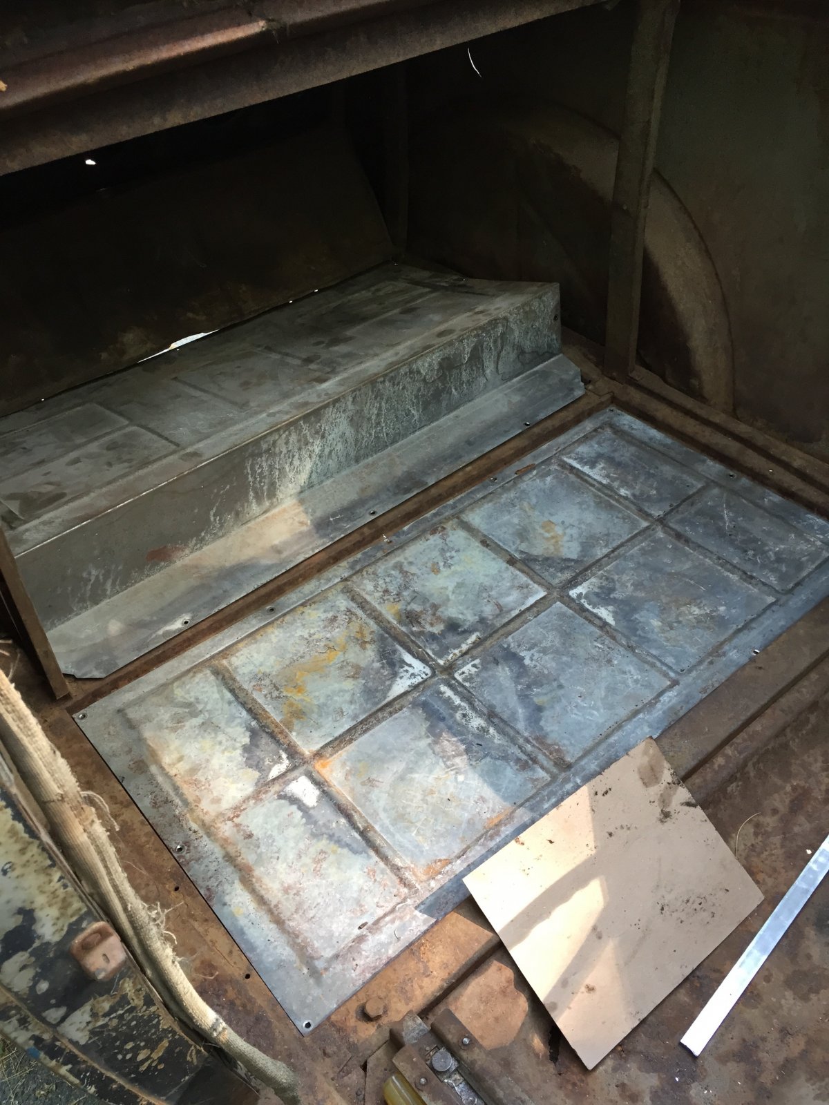

    The floor pans had no holes but we're super thin..? So I removed them and will replace them with new ones or wood.

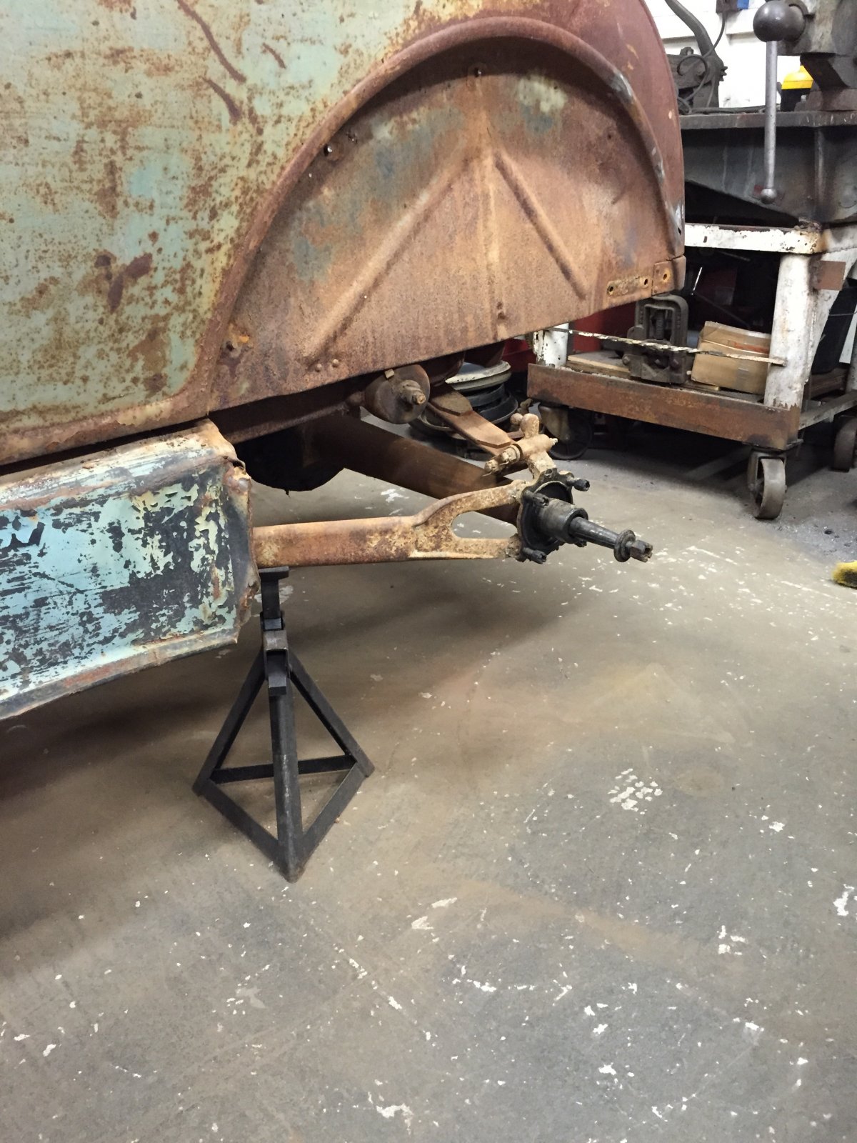

    T spring and new shackles installed,,,, so much better! Thanks for the spring Ray!
    Lowered the car about 4 inches and softened the rear.

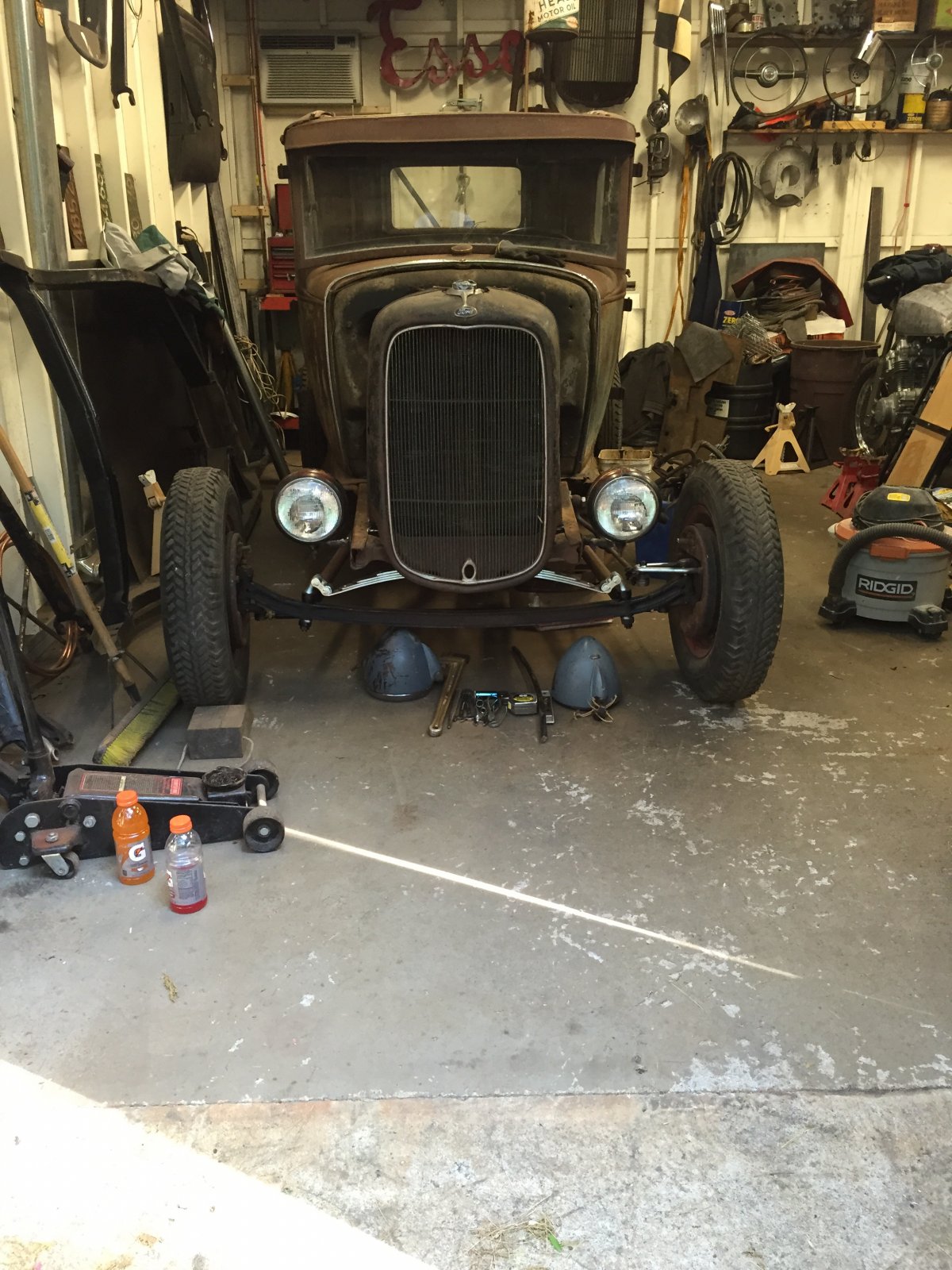

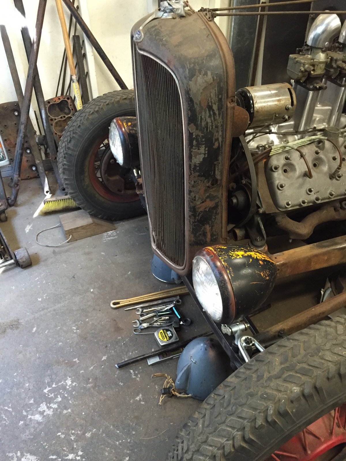

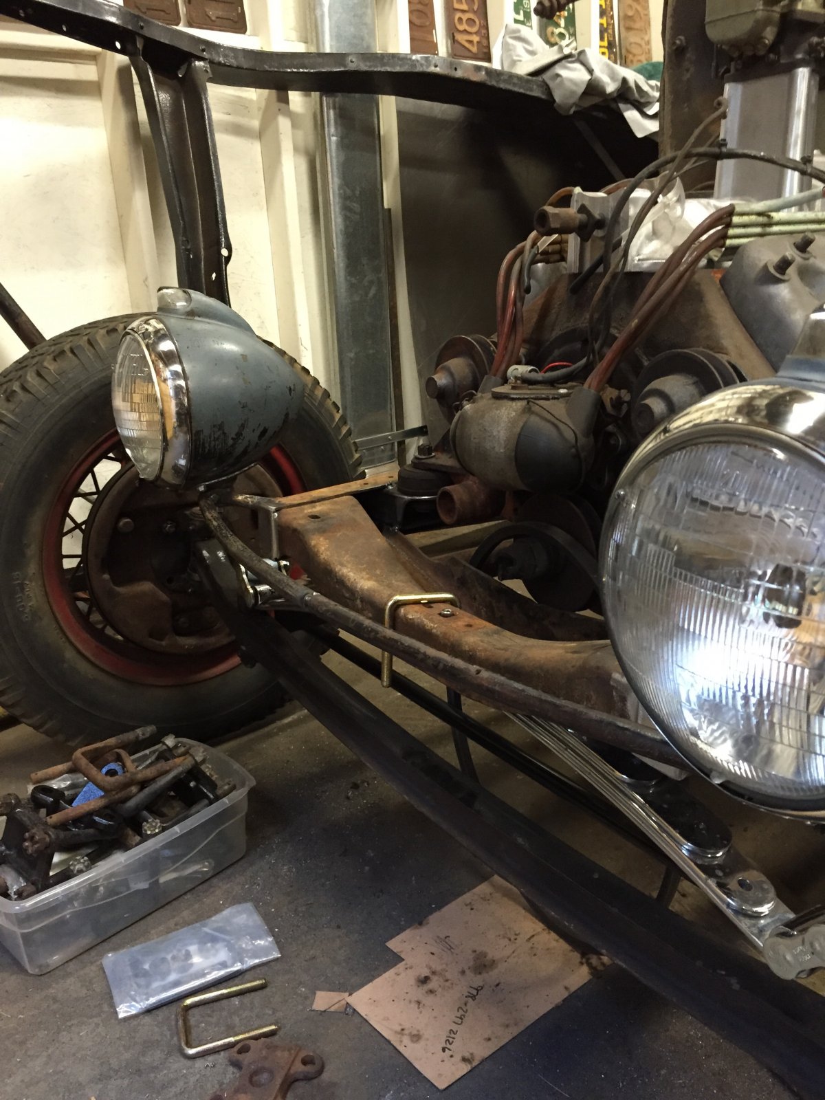

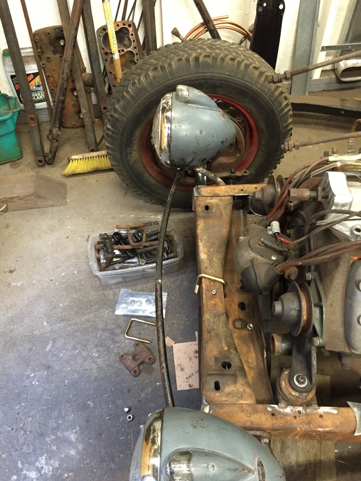

    Headlights.
    I'm going to make a nerf bar with the center section of the bar.

    Floors had no holes or rot but were super this and flymsy. My brother gave me the floors out of his roadster...

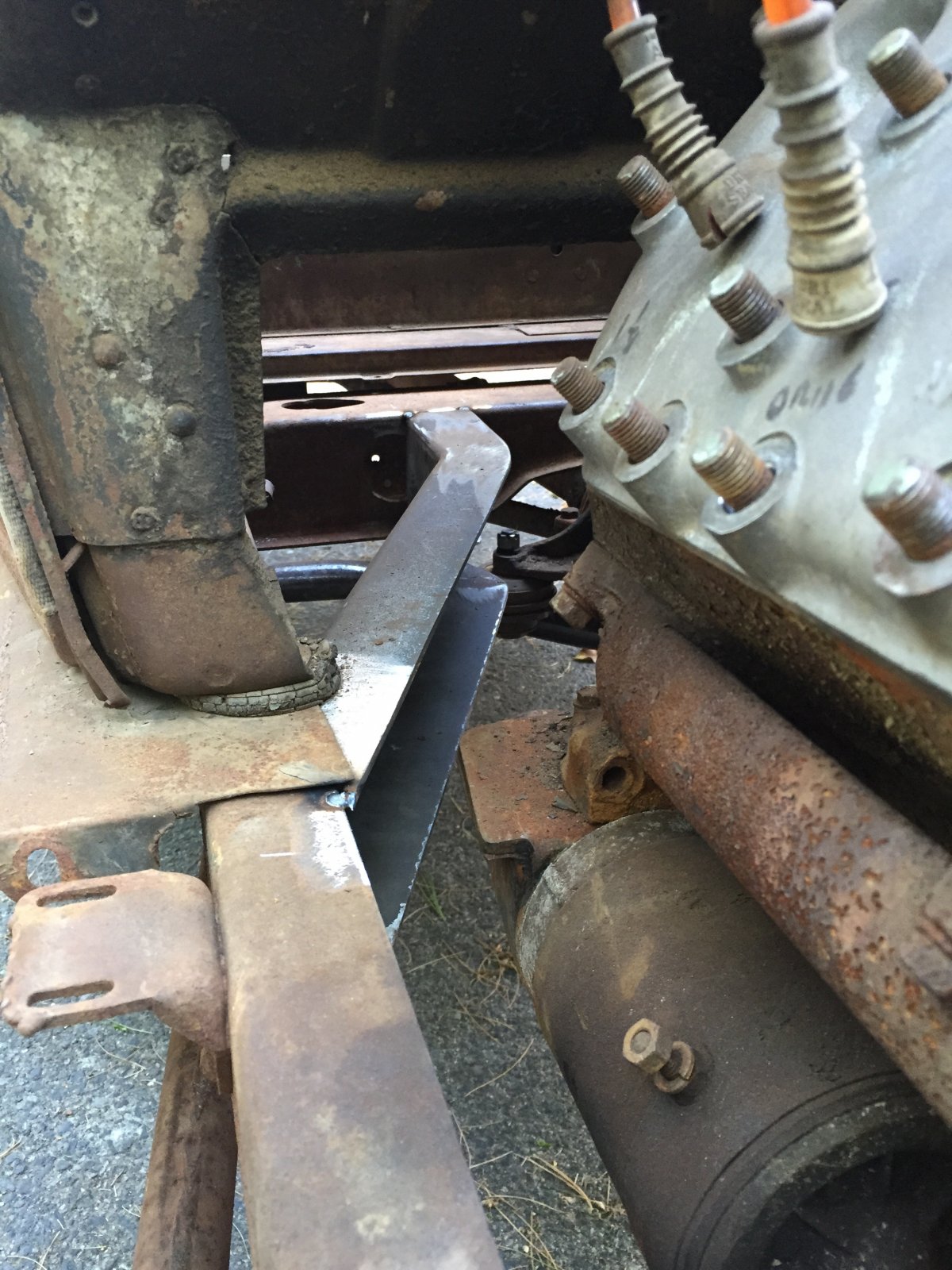

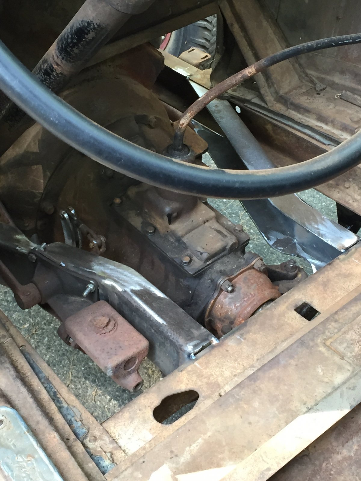

    Finished the K member and pedals. Made the linkage and arms.

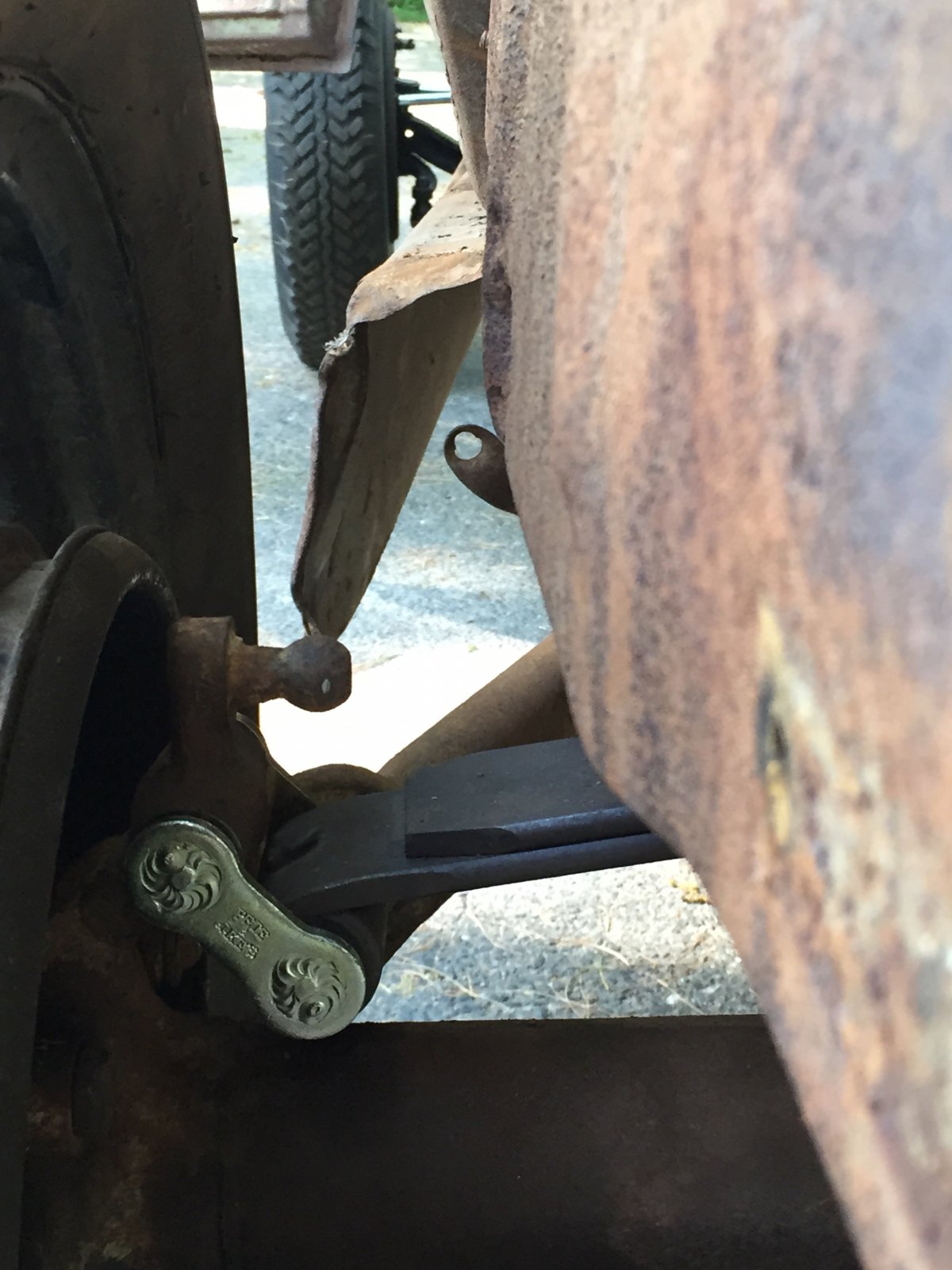

    Shackles

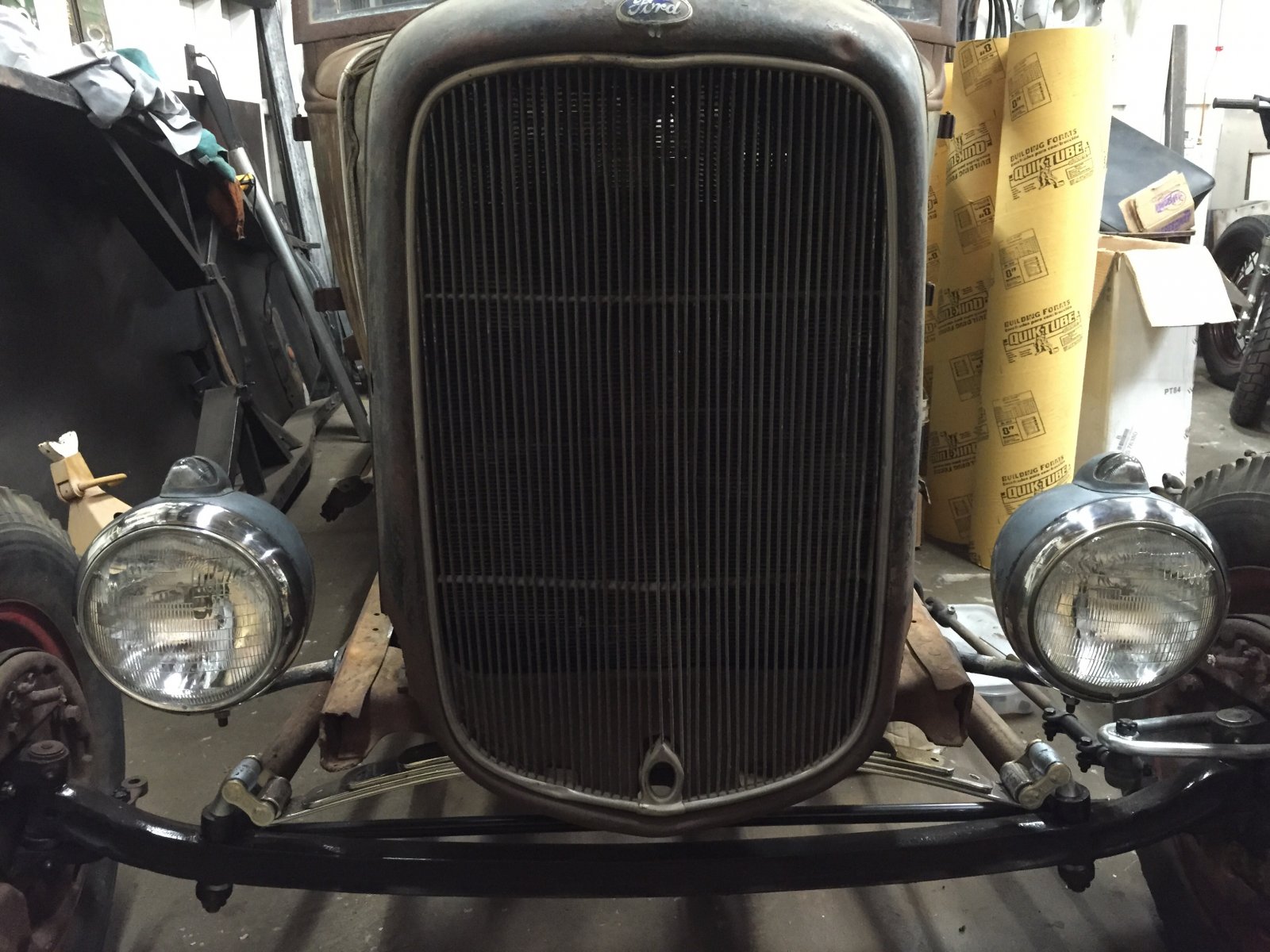

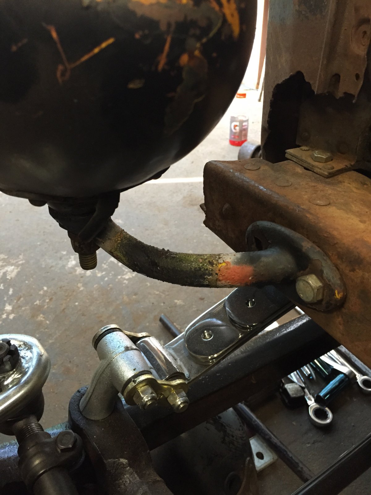

    Modified a model A headlight bar, got the headlights and cross bar made. Lots of small things to finish
