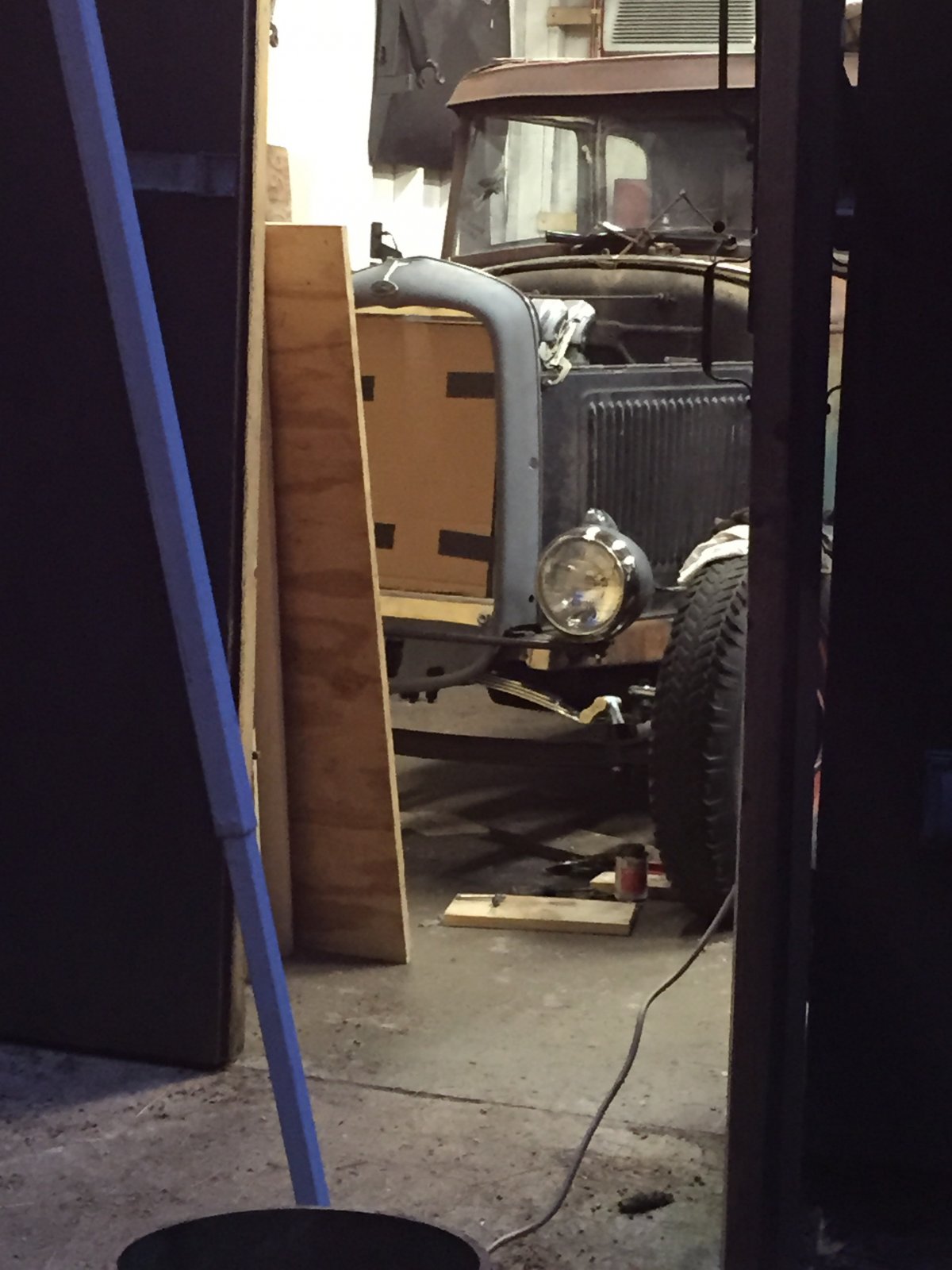

    Messing with the hoodZzzz

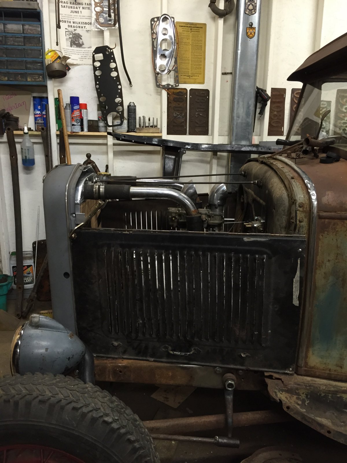

    Pete

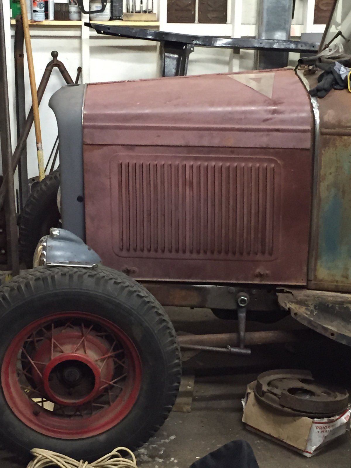

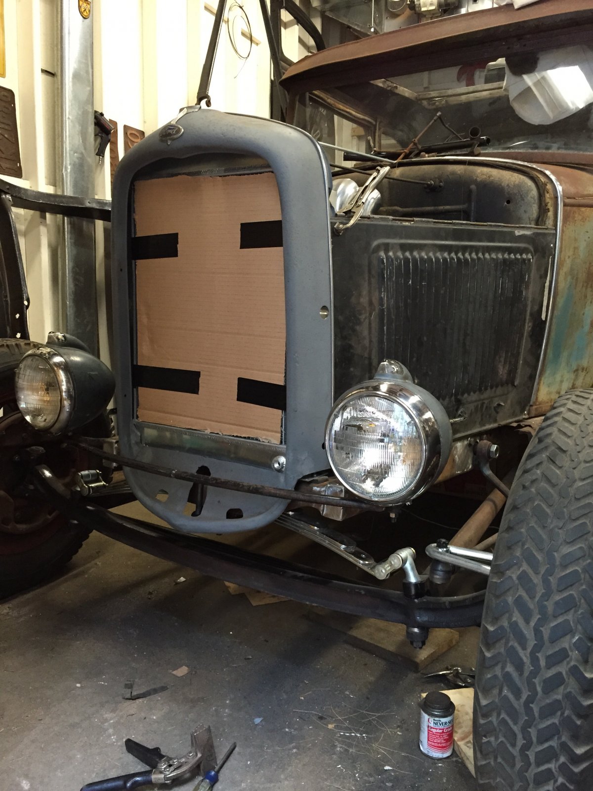

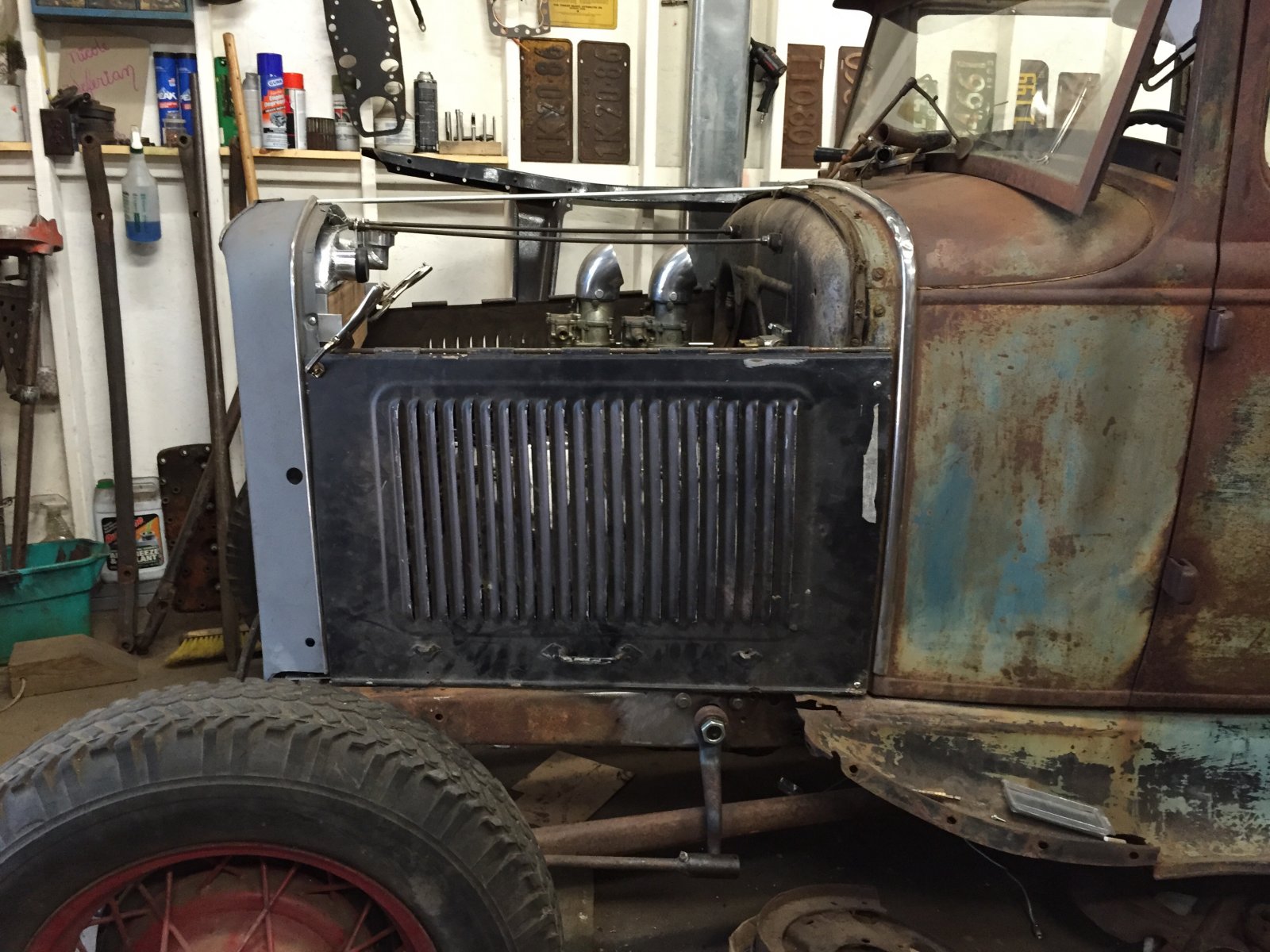

    Got the radiator fitted and the '32 shell bolted on,,,,think I'm kinda diggin just the hood sides.

    Lookin' good! I dig the '32 grille with just the hood sides.....

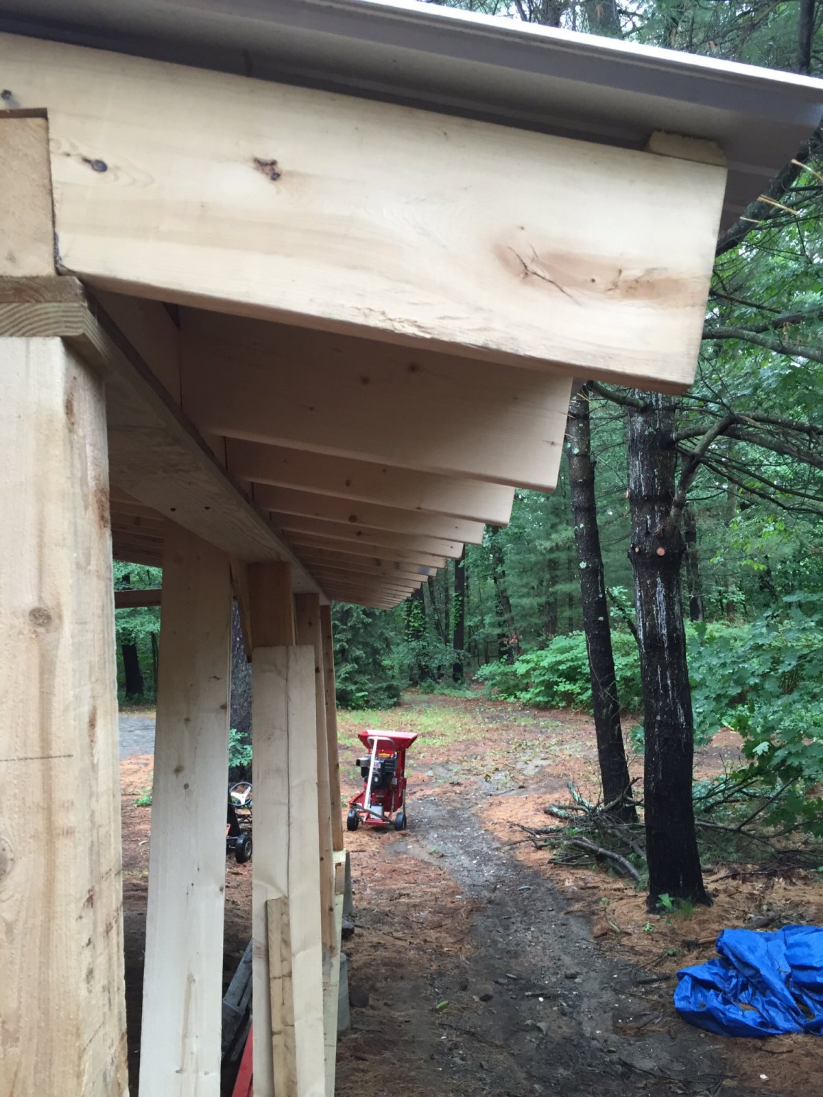

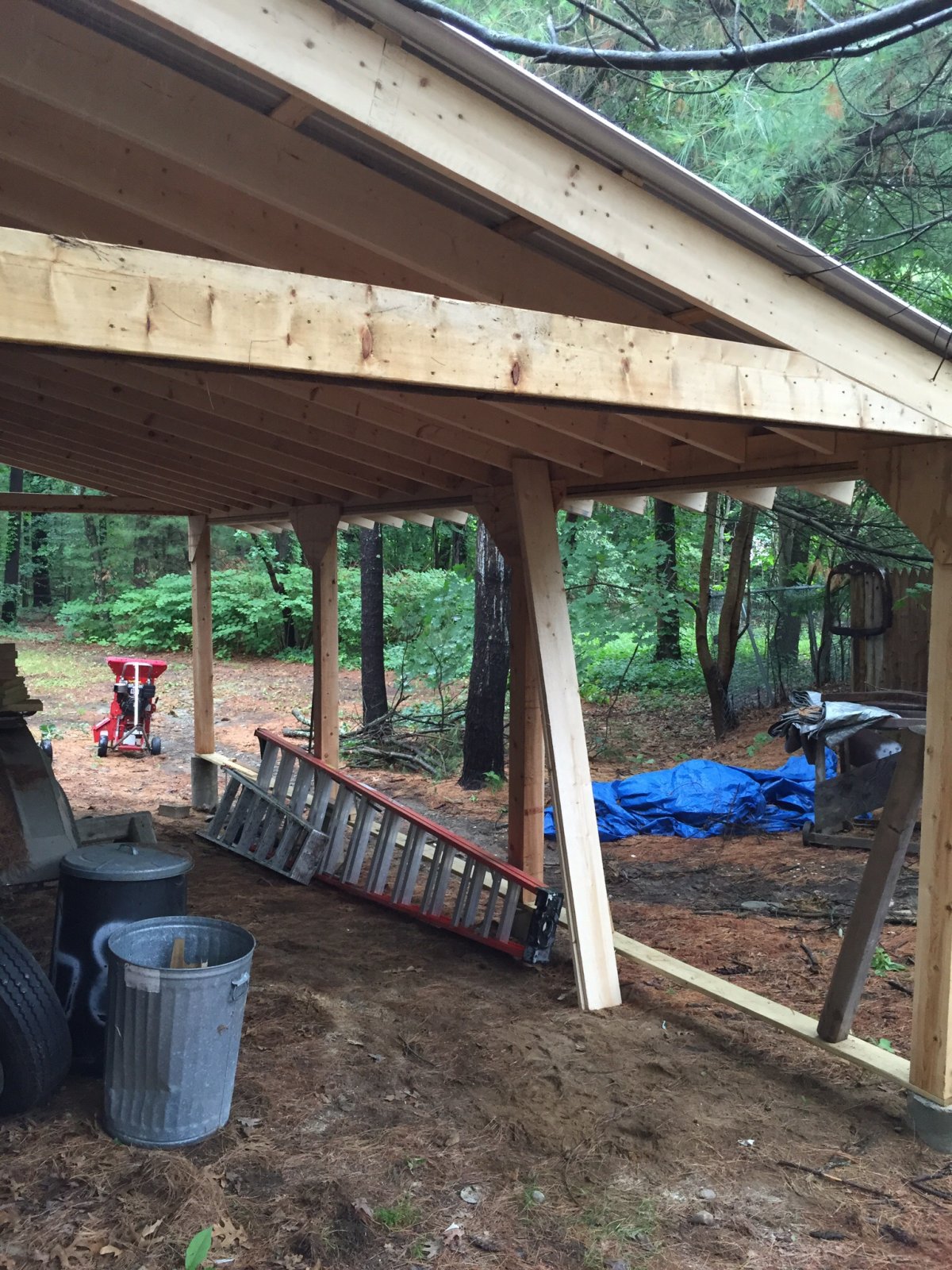

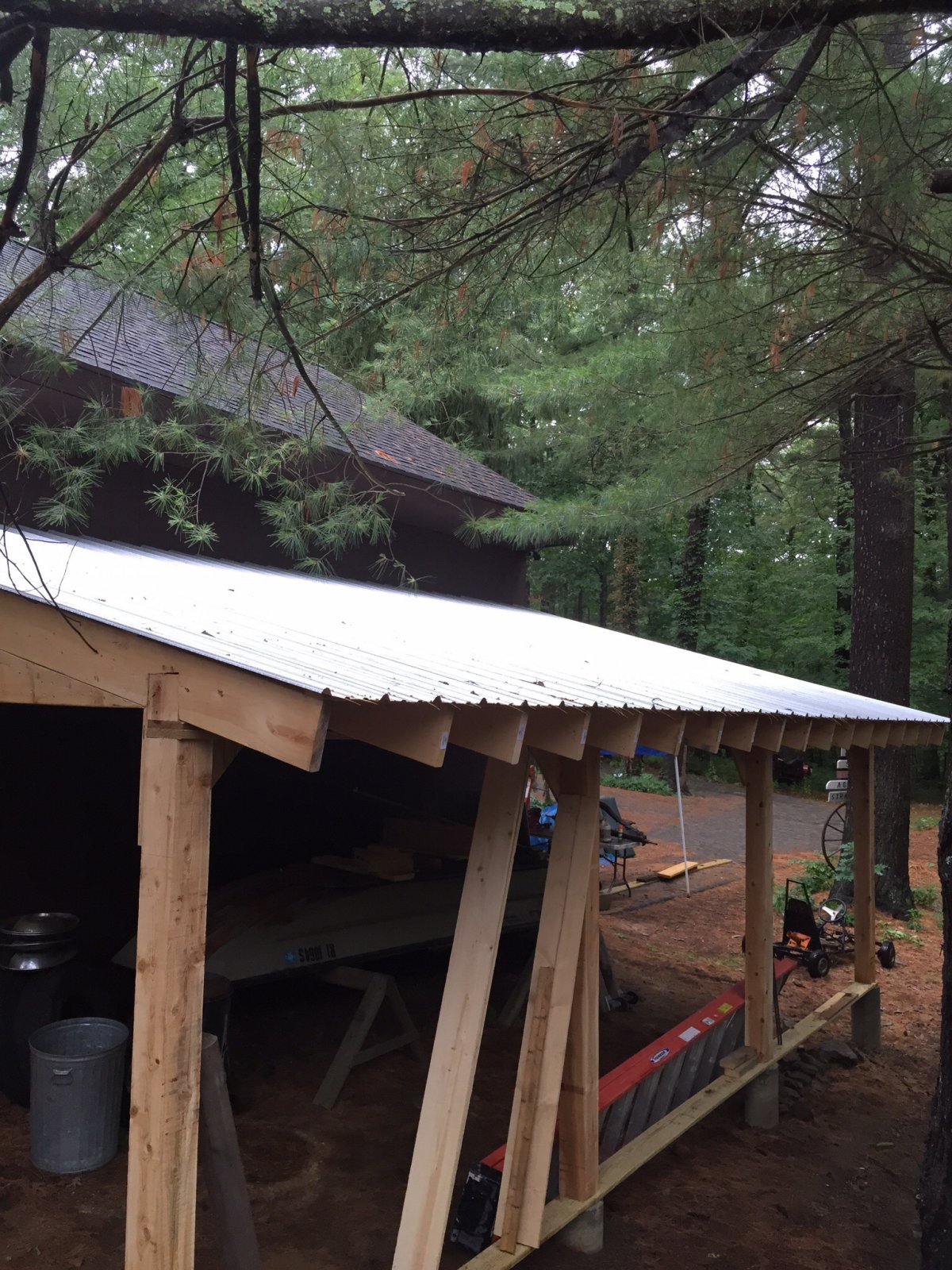

    Got a little sidetracked on the model A, decided to put a 12x24 foot addition on my shop, I'm in need of space...

    Pete
    Now I should have enough space.... For now.

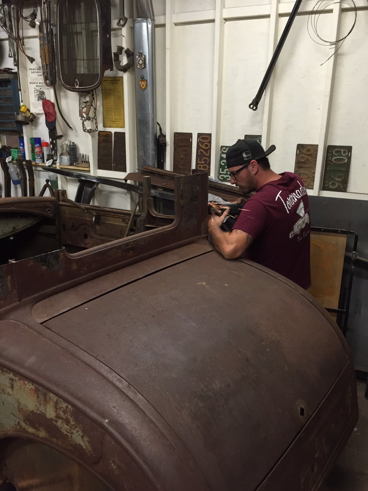

    Pete

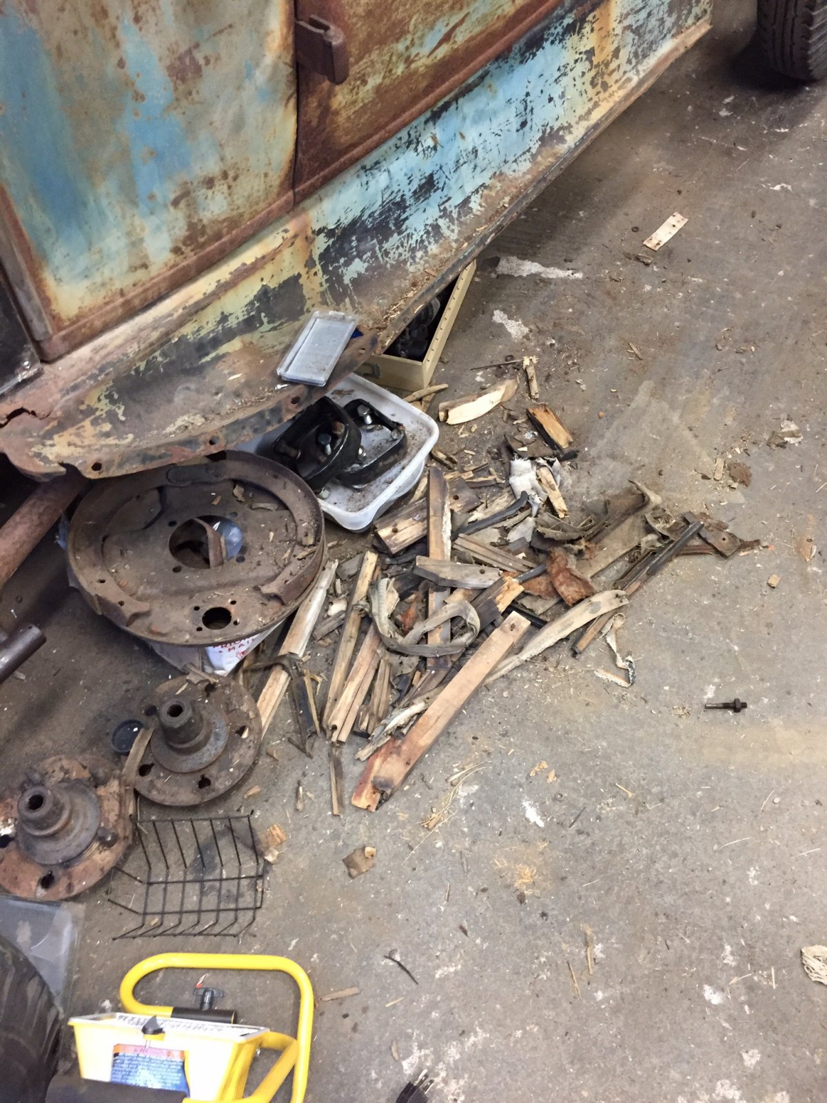

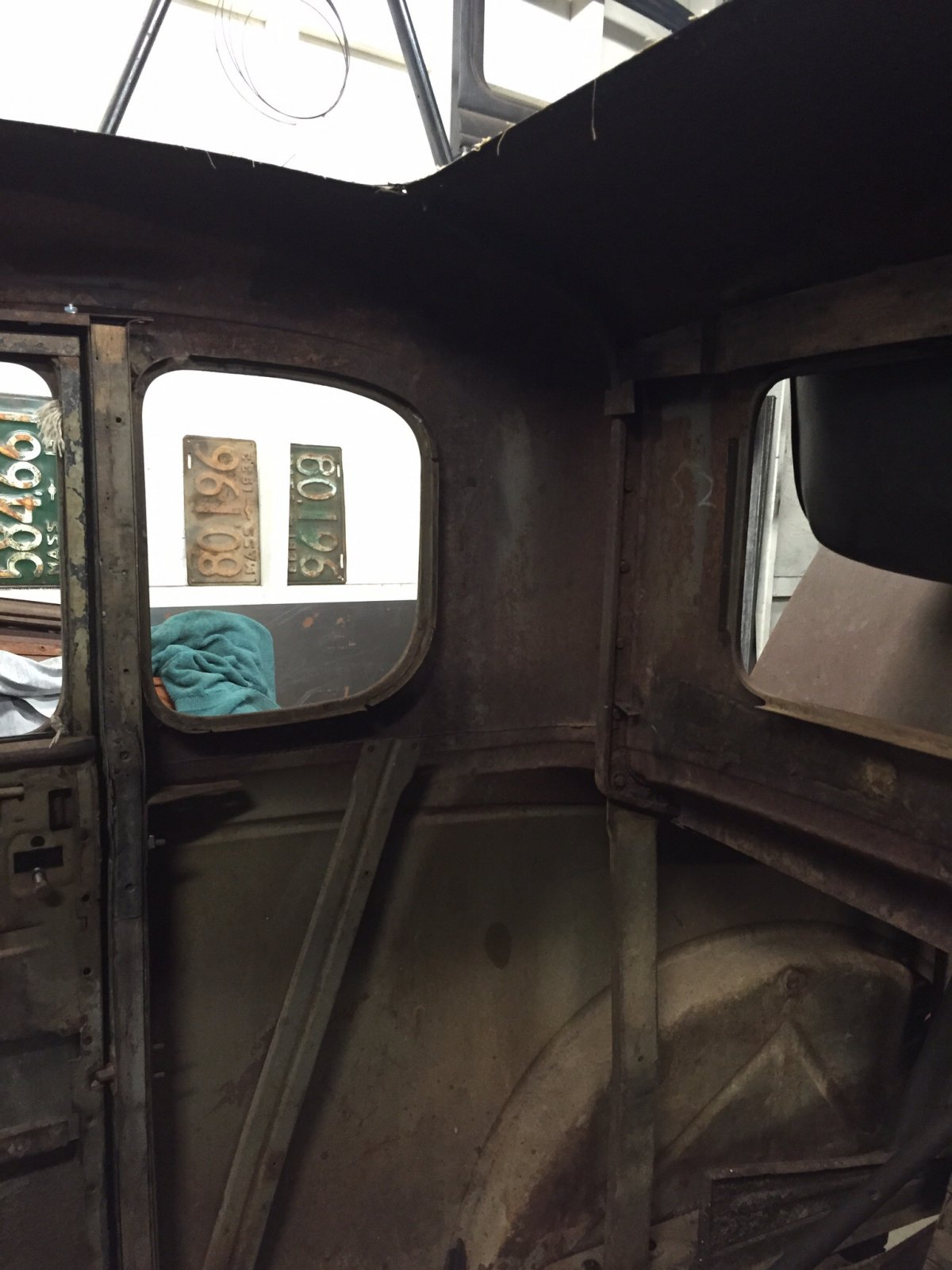

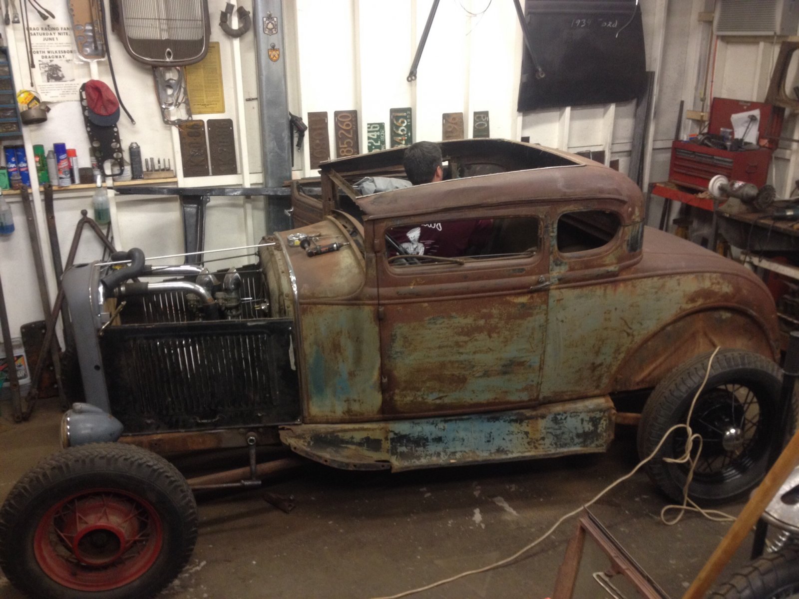

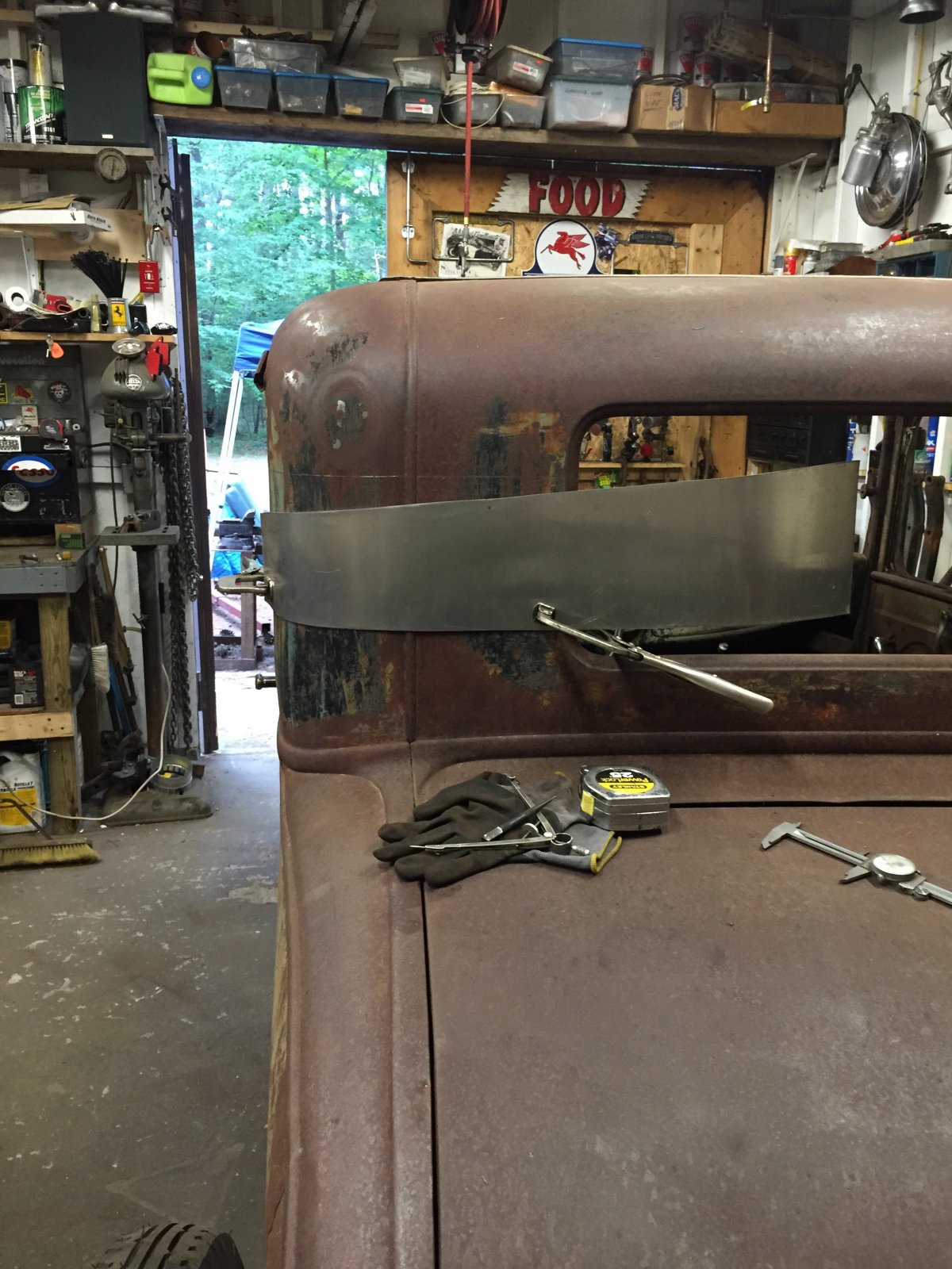

    Getting ready for the chop, removed the gl*** and pretty much all of the wood... Most of it was rotted anyways. Tomorrow I'll mark out the chop and start cutting.

    Pete

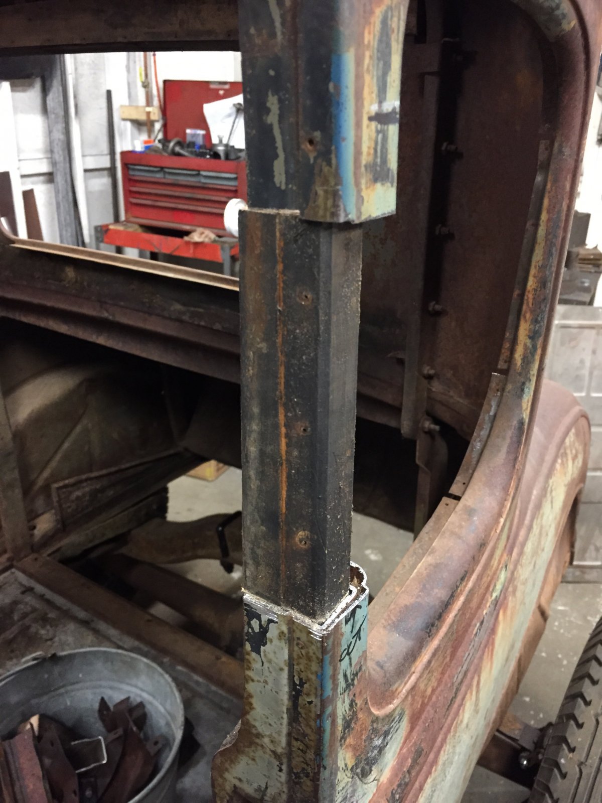

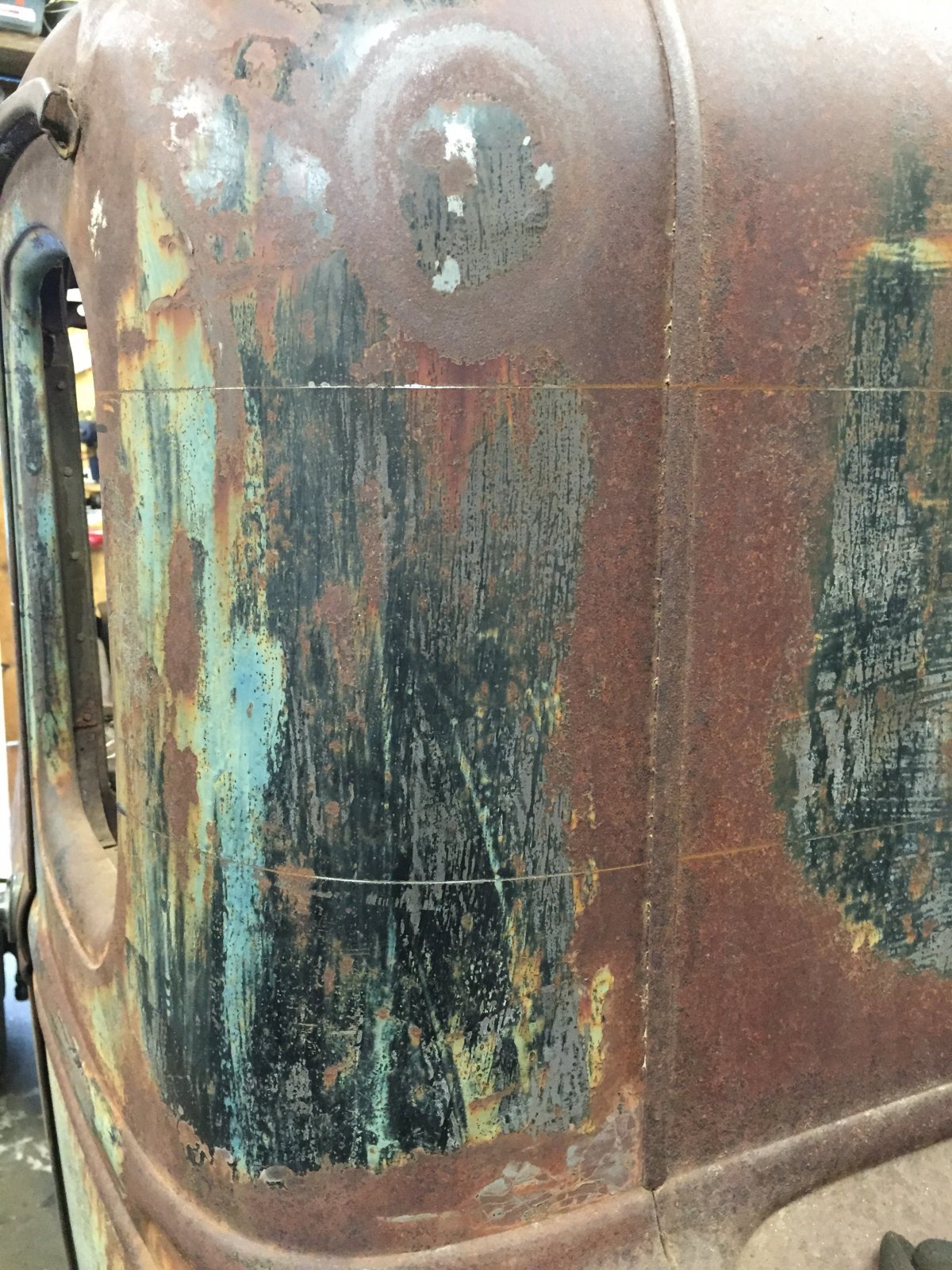

    Got home late from work tonight.... Started laying out the chop, 6-1/2" s
  21. Pete
    Joined: Mar 8, 2001
    Posts: 4,792

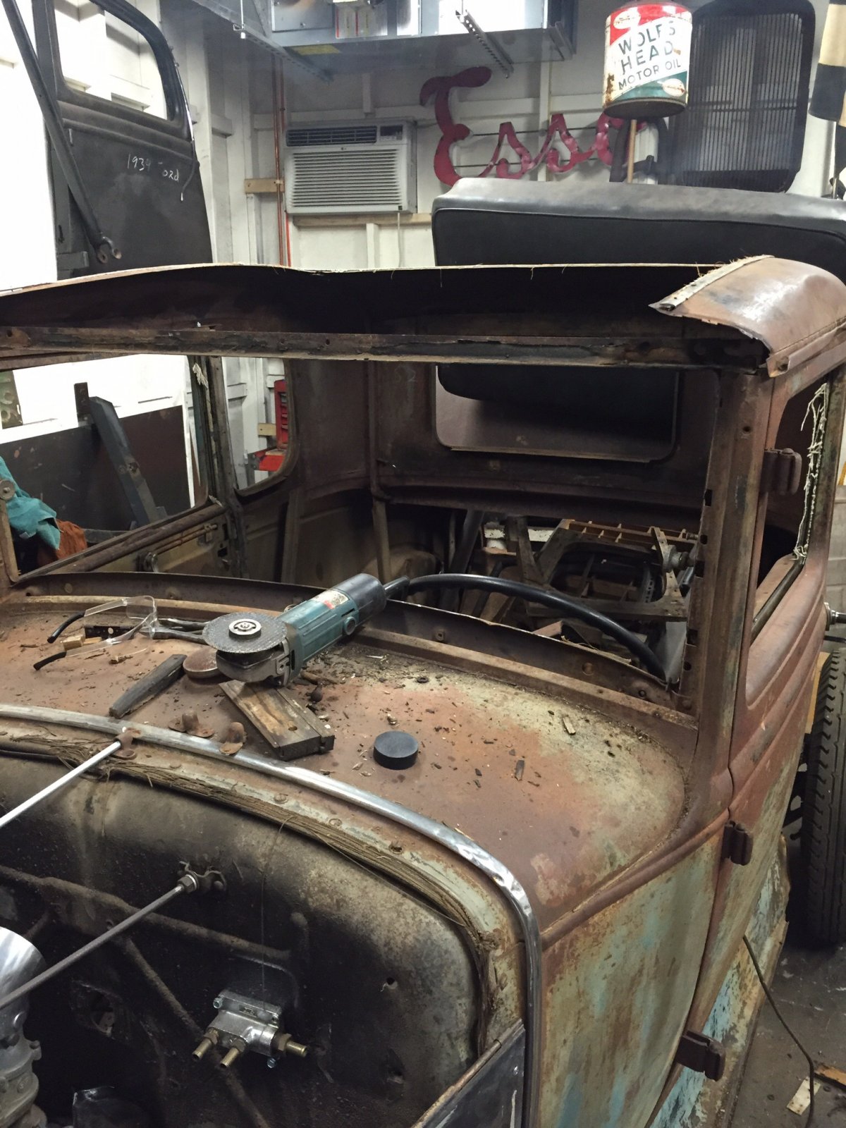

    Pete

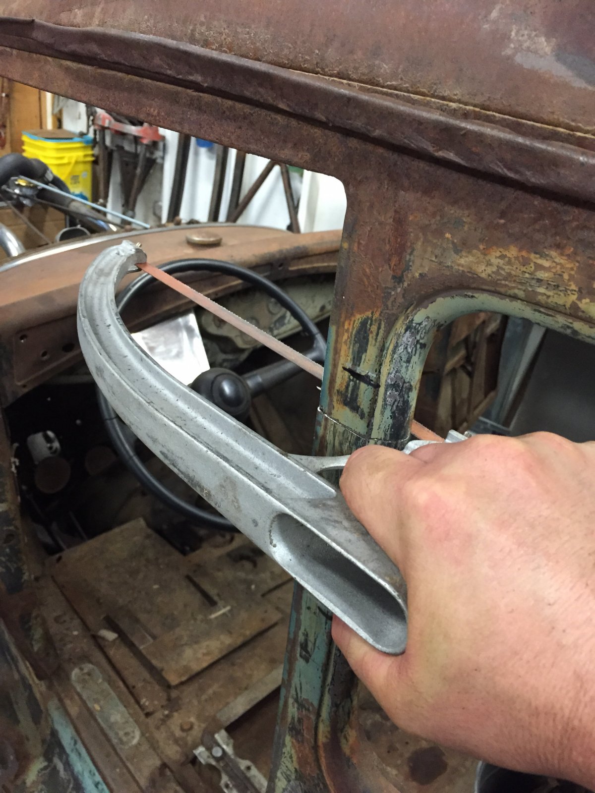

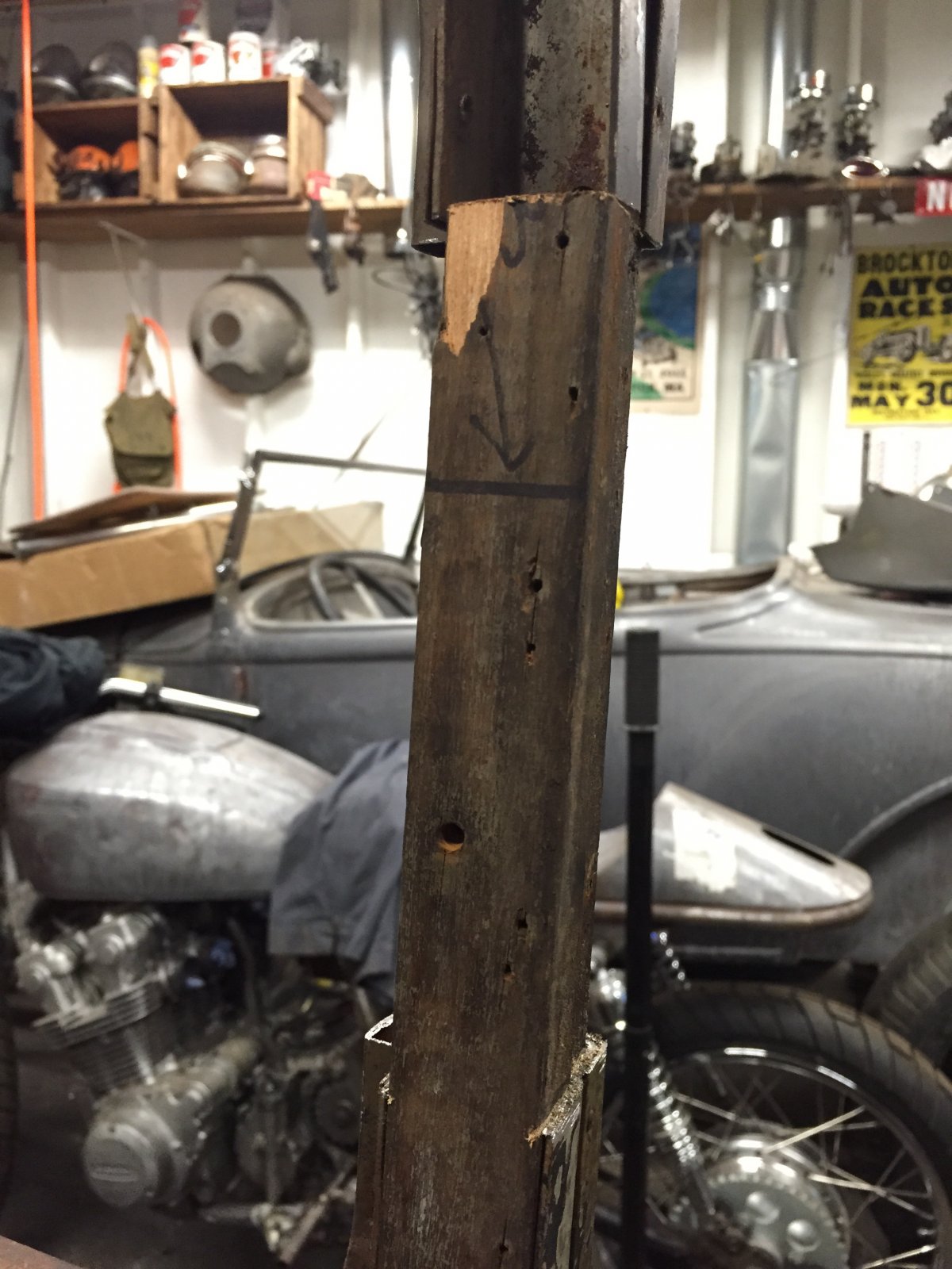

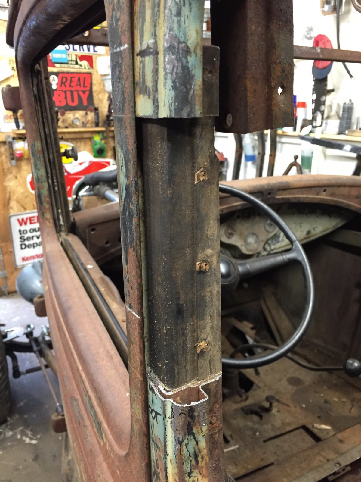

    Rather than cut right thru the wood I decided to use a hand saw and cut just thru the tin, remove the nails and screws and slide the pieces out. This way I can remove the 6-1/2"s from the wood and slide the roof back over the b pillars.
  22. Pete
    Joined: Mar 8, 2001
    Posts: 4,792
    Pete

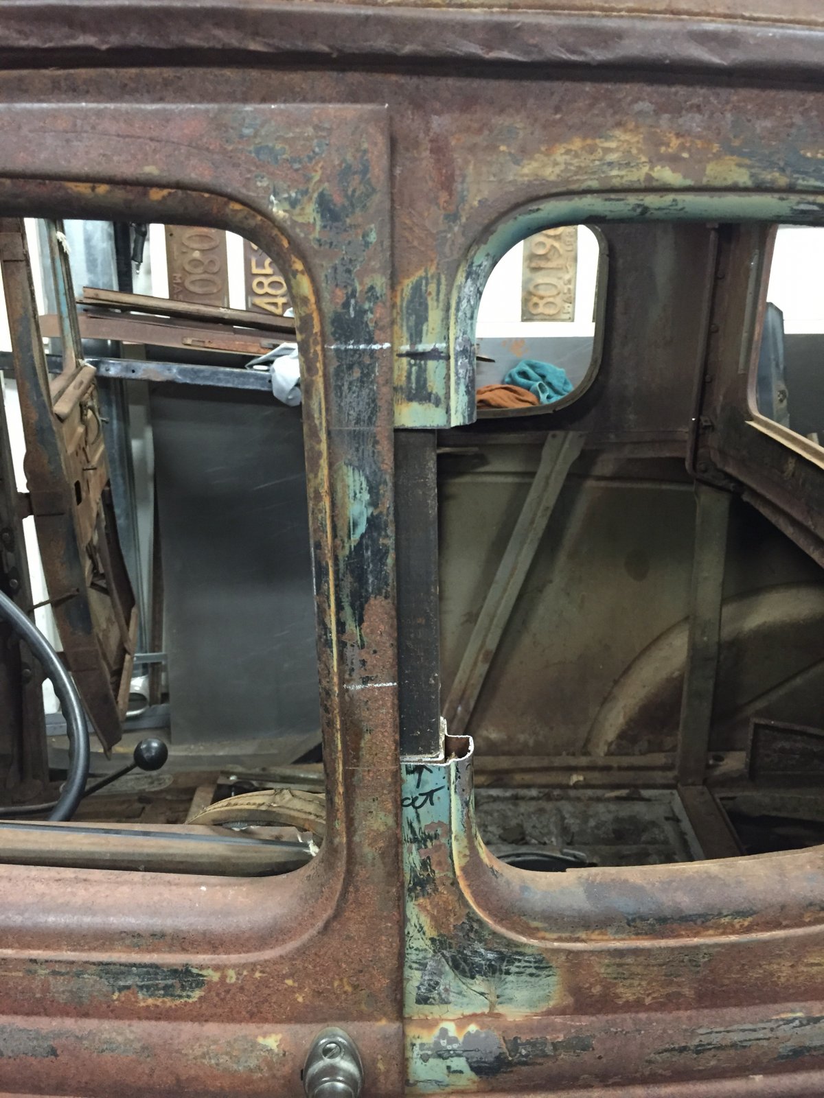

    6-1/2"s removed.
  23. Bugsy

    Oh ****!!! Here it goes! Good idea with the hand saw and saving the wood like that! 6 and a half chop with no channel is going to be sweet! I'm a highboy freak! Keep cuttin' bro!!!!!
