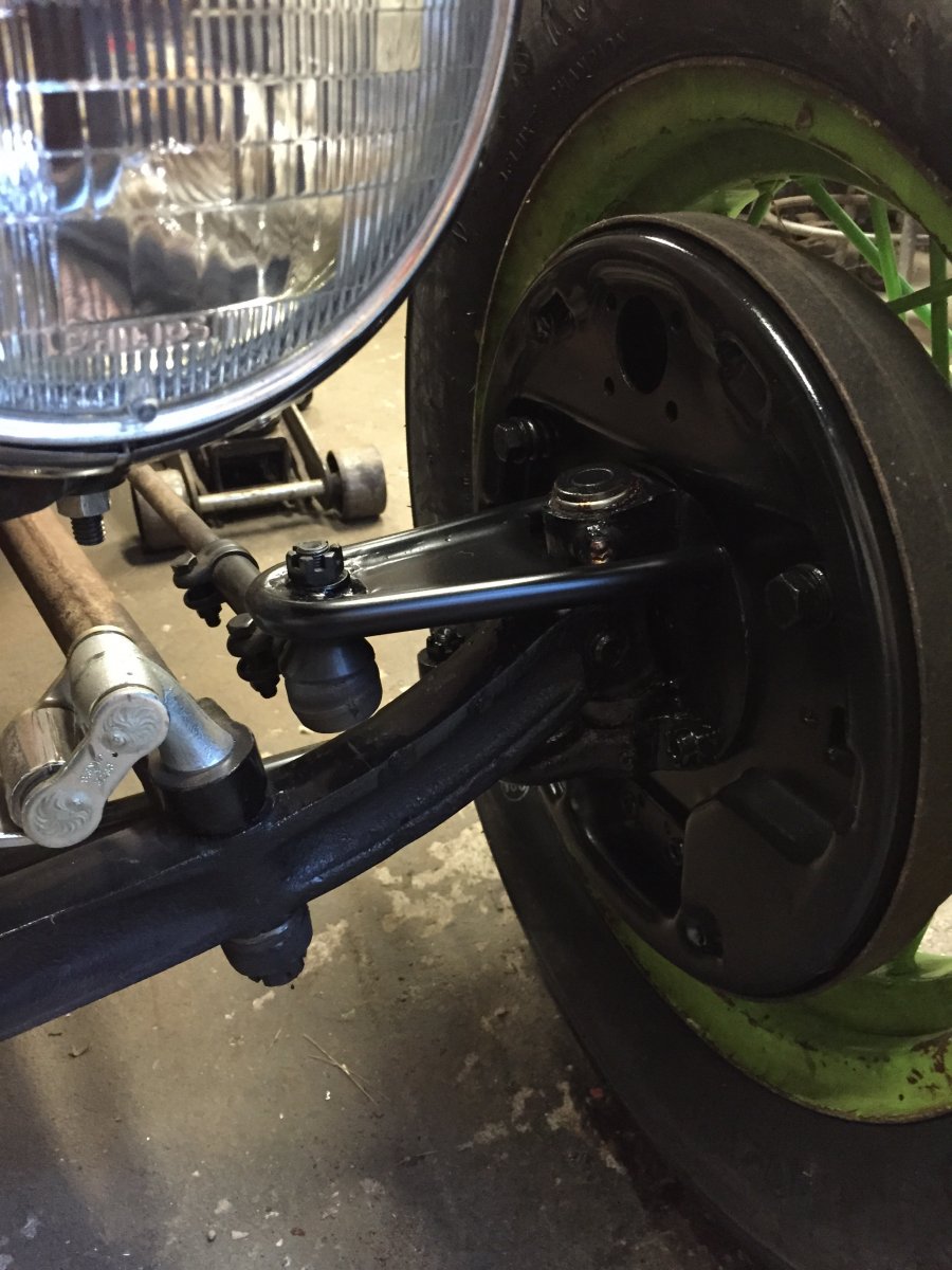

    Got front end ****oned up tonight. Blasted and painted the backing plates and hardware. Installed new king pins....

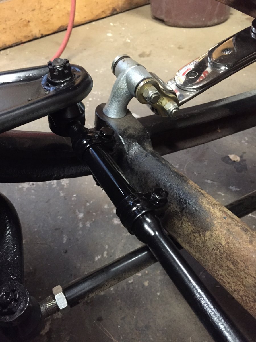

    Finished the drag link tonight.

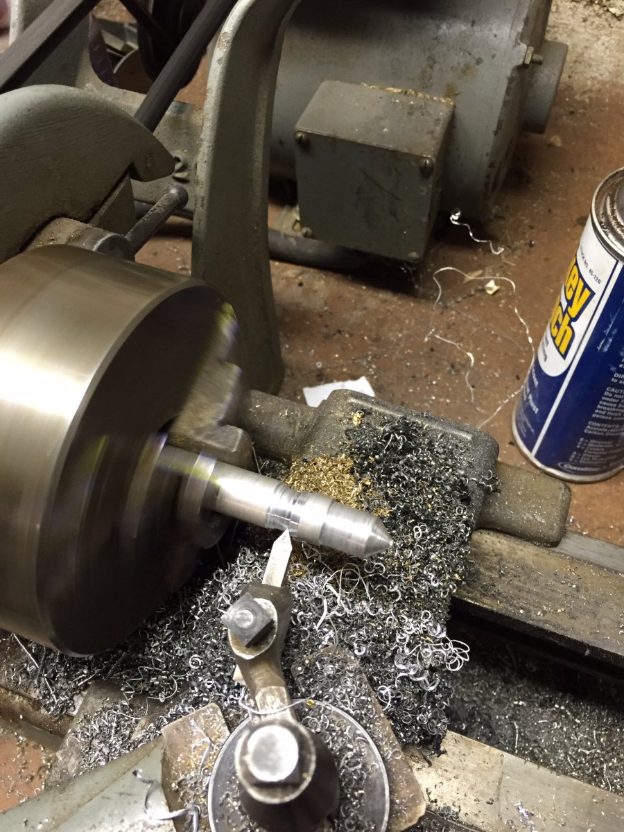

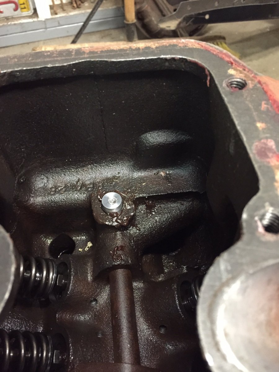

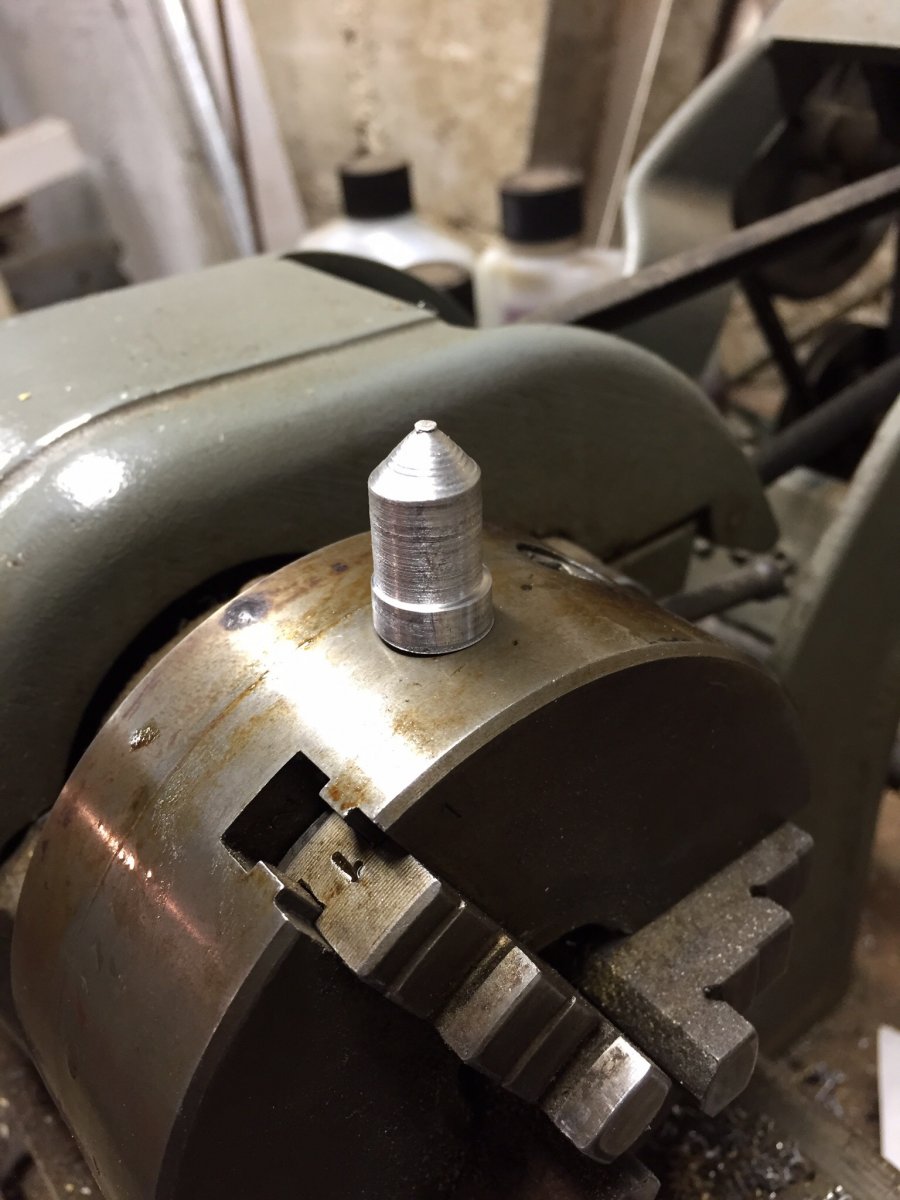

    Machined an aluminum fuel pump rod plug, now I'll bolt on the early intake.

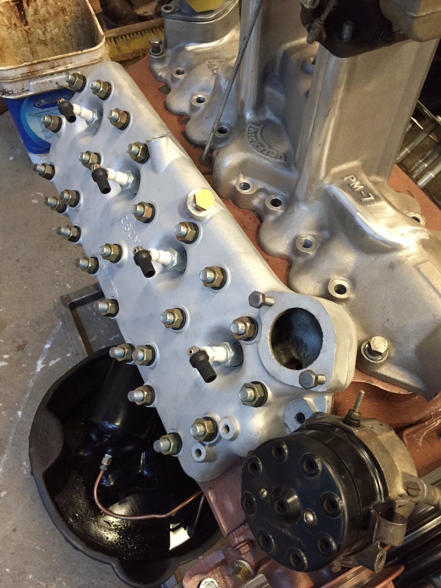

    Bolted the Canadian heads on....

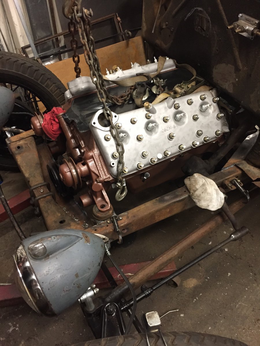

    After much wrestling and learning as I go about the technicalities of which flywheel fits what..... The Motor is in!
    John Scholes spent all of his afternoon and night helping me.
    We pulled the old 59a motor and thought we'd just drop the 8ba in... Wrong..... Side note, I'm literally sitting on my shop floor surrounded by what looks like a roadside bomb.... Absolute friggin mess!!
    Turns out the flywheel I had accepted a 9 inch clutch.... But the holes were drilled slightly off thus not allowing all the pressure plate bolts to enter....we tried the 59a flywheel but it's slightly different, it rubs the block... No go.
    A phone call was made to the flathead GURU Tommy Caruso.... We sifted thru his collection of flywheels, pressure plates and discs.. Came up with a complete 11" 8ba set up....
    A huge thank you to Tommy and John for the help today..
