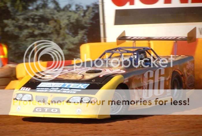

  8. I hope the photo of my car makes the thread. I love this thread.
    I had a long winded post, but I'll condense the idea.
    Not many people are able or willing to fabricate a complete car like the one I have built here. We race these things out in Nevada and the cl*** is dying for lack of participation.
    A real popular cl*** here is the Dwarf. It's a ready built car, but the engines are expensive.
    A ready built car is the answer, but who is going to build one in quan***y with no guarantee of sales? I like a car that looks like a race car: sprint, midget, old time supermodified.
    I was raised in MO and watched the supers run at Olympic Stadium, Sedalia, Marshall, Knoxville, Lakeside, etc. Bring 'em back!
    By the way my car is only 5 races old and won the last 3 going away. Why? We have 2000lb wt rule; I weigh 2380 and am still at least 300 lbs lighter than anyone.

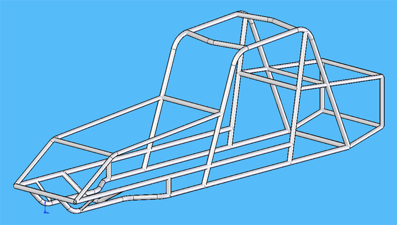

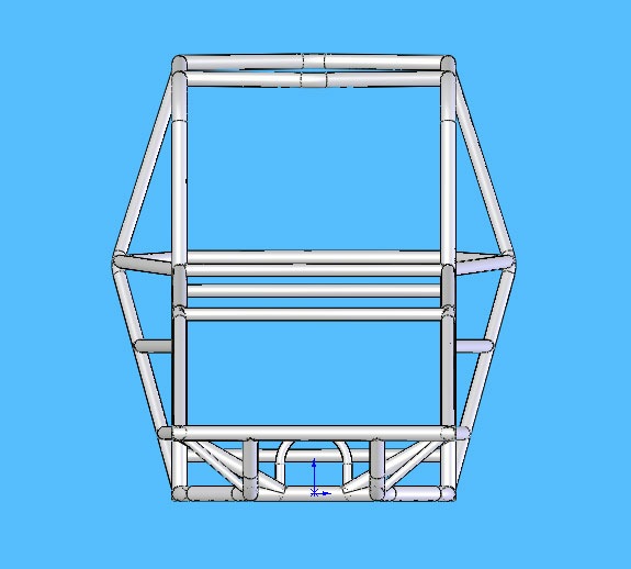

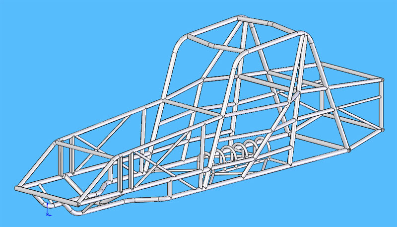

    OK, here's a teaser of what I'm thinking ch***is wise:
    104" wheebase, 90" max width, 11" IMCA Late Model Spec Tires
    I have a rule set that I'm working on, but this is a side side deal, so paying work comes first, and I haven't spent a lot of time on them yet.
    Just putting that out there to show you guys what I'm thinking.
    No roofs, no wings, no fenders, no scoops, no aero, period.
    Whatcha think?
    :D
  18. Sit in the middle with the driveshaft between your legs ? If so, I like it.
    Now just put an axle and buggy spring across the front.....and rear.

    Yes, center steer, open drive line between the legs (inside an appropriate cage like device, of course).
    This one is IFS, but a solid axle with a buggy spring or coil overs would be an easy change. Just don't pinch the lower rails in the front like I did.
    I want guys to be able to buy and strip an older Late Model roller, and those are all IFS, so that's what I went with (IFS will be faster too, and this is a race car, so style only counts for so much).
    That model isn't finished, obviously, but I got it to the point where you could tell what it's supposed to look like, so I thought I'd throw it up and bump the thread at the same time.
    I'm a ninja like that. :D

  22. The white 4 car was one of mine. It ended up in Indiana. All of our races were on 1/4 and 1/3 mile dirt tracks.

    Alrighty, I got the ch***is model as far as I'm going to take it.
    This model shows me that my drawings are good enough to build from and that the ch***is cuts the lines I'm after, so I'm not going any farther.
    As it sets there, the weight is ~350 lbs, but there are a few brace bars missing. I'd estimate the completed weight at ~400-425 lbs, with the center of gravity directly under the dash bar, ~14" above the CL of the lower frame rail tubes.
    Here's the pics:
    Still looking for anyone who knows a friendly promoter.
    I'm still working on typing up the rule set. I'll post that up when it's done.
