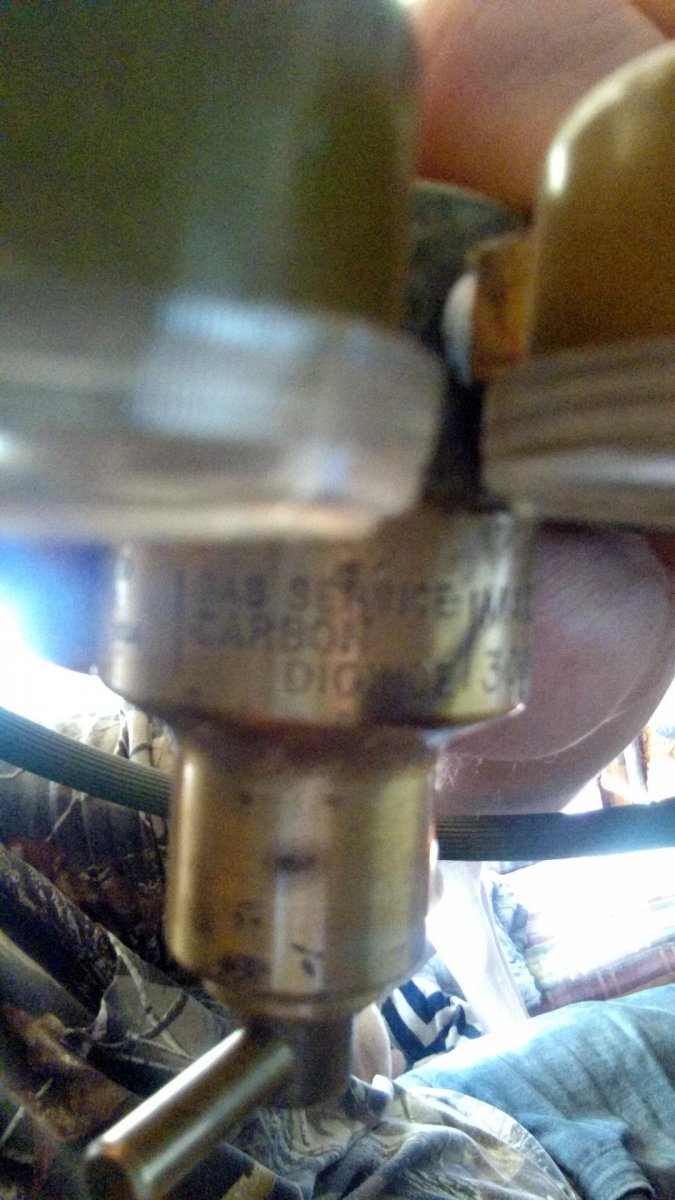

    I bought a used Miller Sidekick a while back, and the guy I got it from gave me a Victor CF153 with the purchase. I was looking at the regulator yesterday and its stamped for CO2 does this make a difference in which bottle, or gas I get?

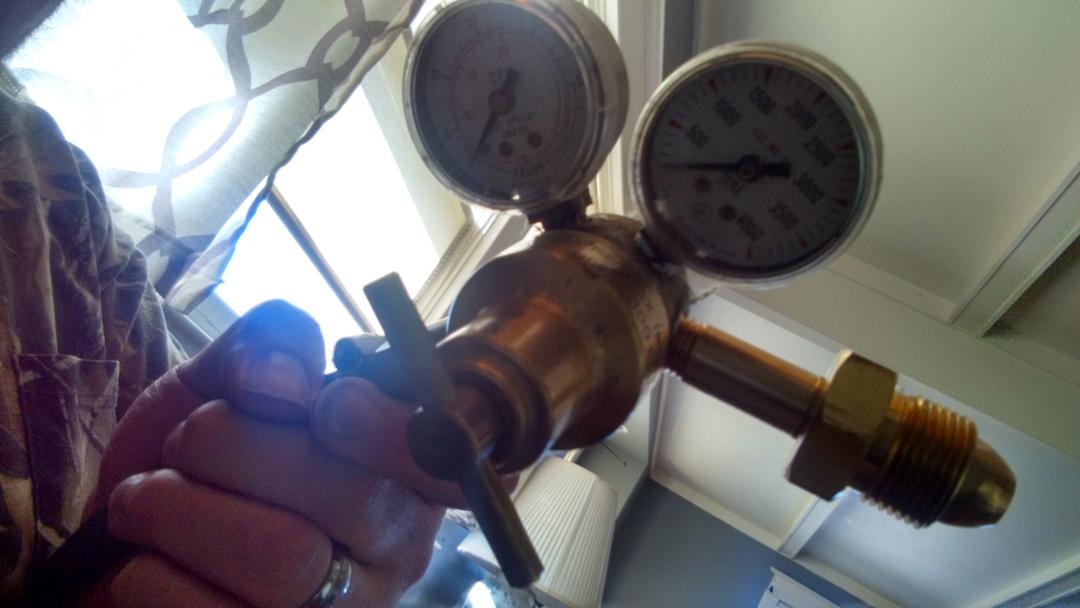

  9. topher5150
    Joined: Feb 10, 2017
    Posts: 3,800
    topher5150
    I have a male end
  10. sunbeam
    Joined: Oct 22, 2010
    Posts: 6,408
    sunbeam
    It will work OK. They both just flow a shielding gas if it fits the bottle go with it.
