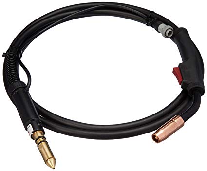

    I’ve had a similar problem with the Miller I use. The gun housing body attachment that plugs into the welder moved slightly from being loose. As you can see there are a couple o rings on the male end. That caused a pressure loss.

    FIRST I want to THANK EVERYONE for trying to help me with this frustrating problem. When you have been welding just fine and suddenly it turns to ****.......its frustrating. I tried many of the suggestions you guys made. Got up this morning and tried a few more things. Loaded it in my truck and took it to a pro. He had it fixed in ten minutes. Apparently I had managed to pull the welding lead connection down slightly by probably stepping on the cord (more likely stumbling over it). Anyway, where it slips into the machine there is an O-ring seal that keeps the gas flowing to the gun. You could not tell it was pulled down slightly causing the o-ring not to seat....so all my gas was exiting there, and little to none was making it to the nozzle. Dumb mistake on my part, and certainly not the fault of the machine. So now I'm fat dumb and happy again and my welds look muuuucccchhhh better. Thanks again to everyone for trying to help me solve this problem.

    I did take the gun apart and clean it as you suggested, but didn't remove the lead from the machine. I had called Miller's customer service and talked to a technician this morning. He had me go through the setup program to insure factory settings. I told him that I had tried to get the factory settings per my instruction manual and it didn't do anything. Turns out you have to press/hold the reset ****on in BEFORE you turn the machine on. Never heard of doing that before. Anyway as he walked me thru the setup, a couple of expected things did not happen.
    He then suggested that I take to a local service center to be checked out. The guy started at the back of the machine and decided the flow valve was working. A couple more quick checks and he found the leak. Everything seemed to be working normal when he tested it. Offered not to charge me, but ,.........
