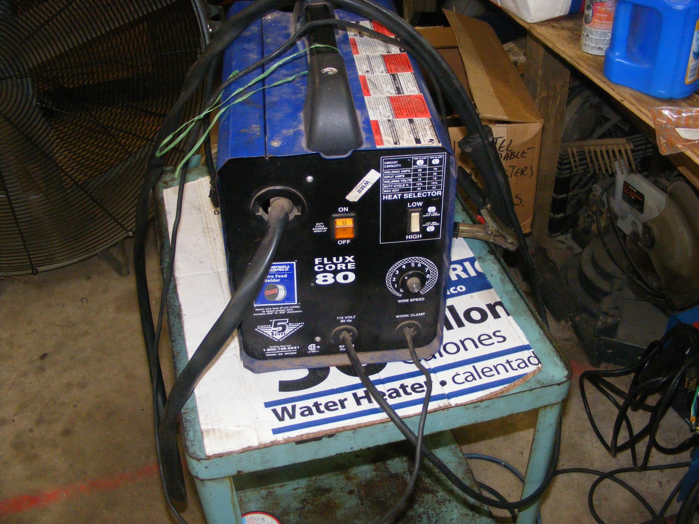

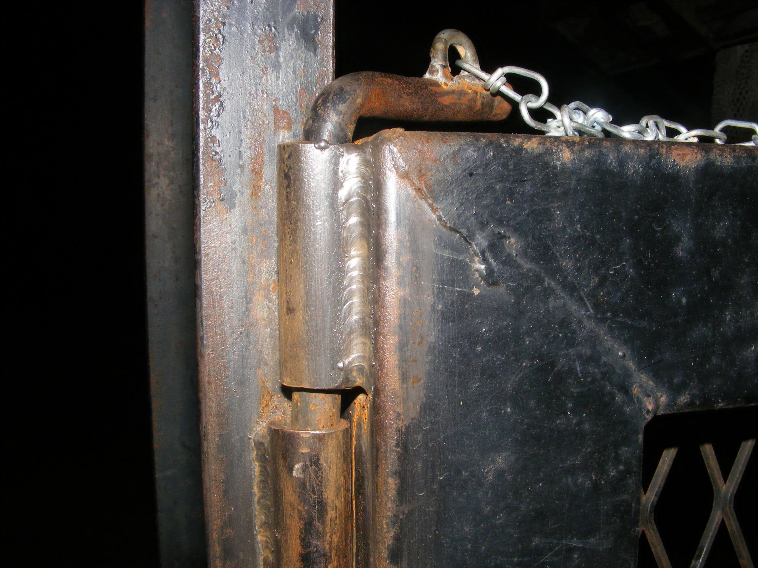

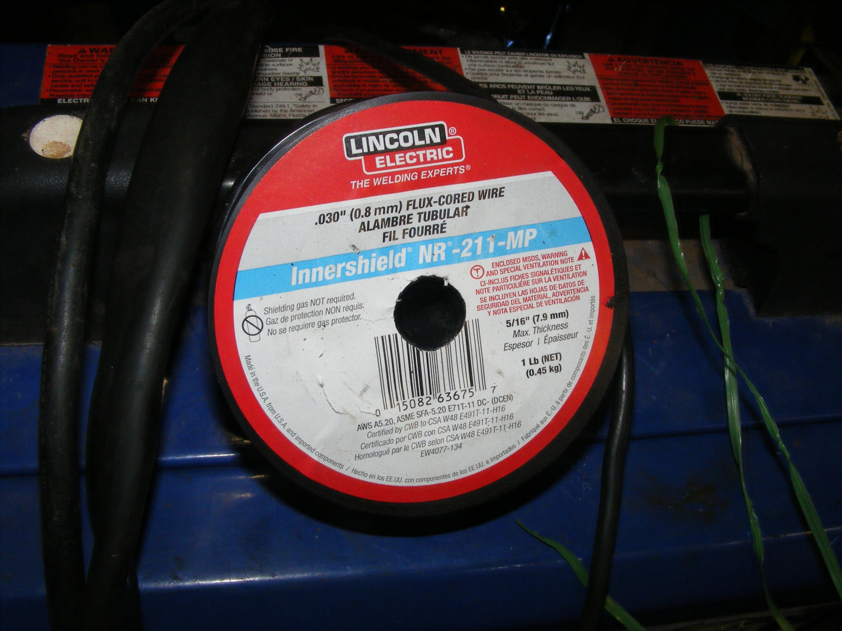

    I have heard and read for a long time that flux core wire welders were POS..... well I found one that seems to do a very good job.....
    This is the welder and the wire that I used ,the weld is on a rusty drop ramp trailer.
