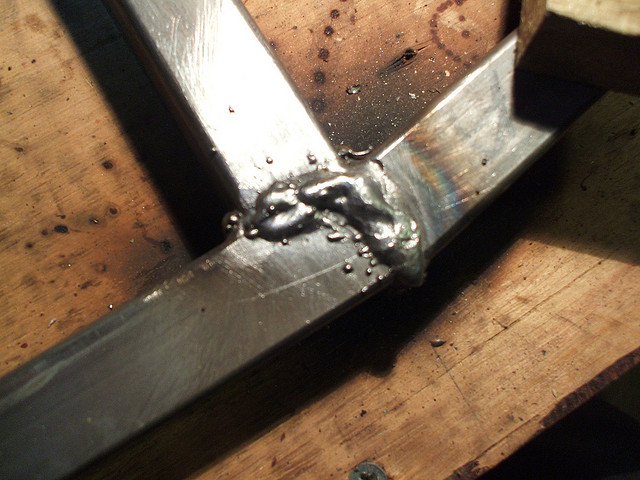

  3. Heres a couple of mine i use the C method when MIG welding.
    Justin

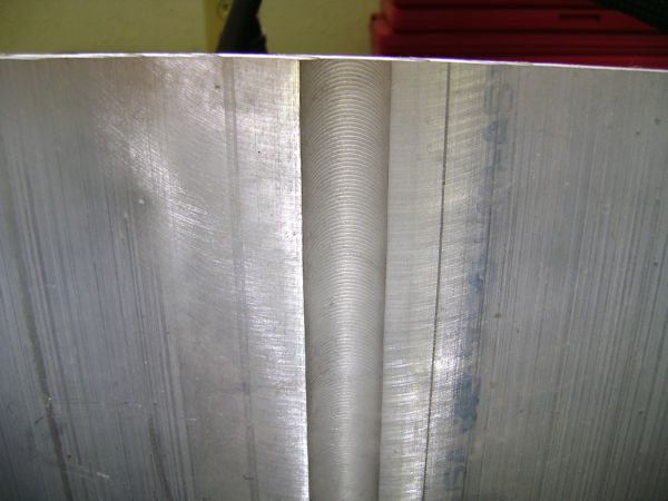

    Not picking on you Gimp but since you offered the challenge I accept.
    For the metal I choose 5083 aluminum 5 millimeters thick.
    Position will be flat, I know easy huh?
    Location will be my shop in Slidell Louisiana
    Process will be FSW (Friction Stir Welding)
    Joint will be square ****, no gap, full penetration.
    You set up the parameters you want to use and we will go from there. I will provide everything you need, welding machine, tensile tester, bend tester, RT, PT, VT whatever you want to test it with. You can also clean it anyway you desire.
    The pic below is what I am looking for.
    Come on down and let's have some fun!

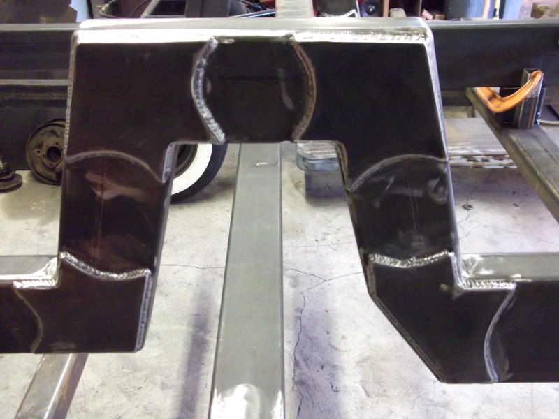

    Just some reminders of what we're NOT trying to do.
  26. 64Cyclone
    Joined: Aug 30, 2009
    Posts: 1,496
    64Cyclone
    ^^That second picture made me cringe!

    Friction Stir welding is a solid state process utilizing zero filler metal and no shielding gas.
    This type of welding does not melt the metal, instead it creates plastic flow by "stirring" the metal creating a defect free weld that is stronger than an arc weld with an almost non-existent HAZ. In many alloys the FSW is stronger than the base metal but still retains the ductility of the base metal.
    Below I have attached a photo of a ship that was friction stir welded by us.
