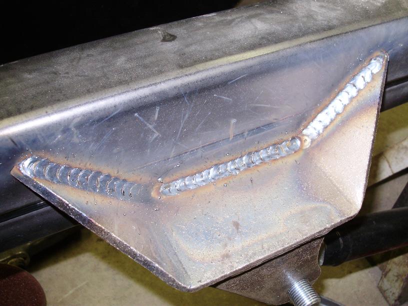

    Yes, friction stir welding, is "non" traditional. So is tig, some may say stick, gas welding then is all us "trad" guys should use ( maybe hammer welding for you "real " horse power guys). I ,personally, love to hear about these new techniques, techkneeks, tecknics.........oh, whatever...you all know what I mean.
  10. kevin mac
    Joined: Feb 21, 2007
    Posts: 106
    kevin mac
    from toledo,oh
    shure looks like he downhilled it!! yes puddle ,step to the right, puddle step to the right ect,ect. nice welds!! clearly mig welder...see the spatter!! lots of practice,makes it perfect... heat settings important with the mig.weld machine manufacturer recommendations to start... or go to your friendly night school for couple weeks.. good luck guys..k

    It was welded with the frame upside down.

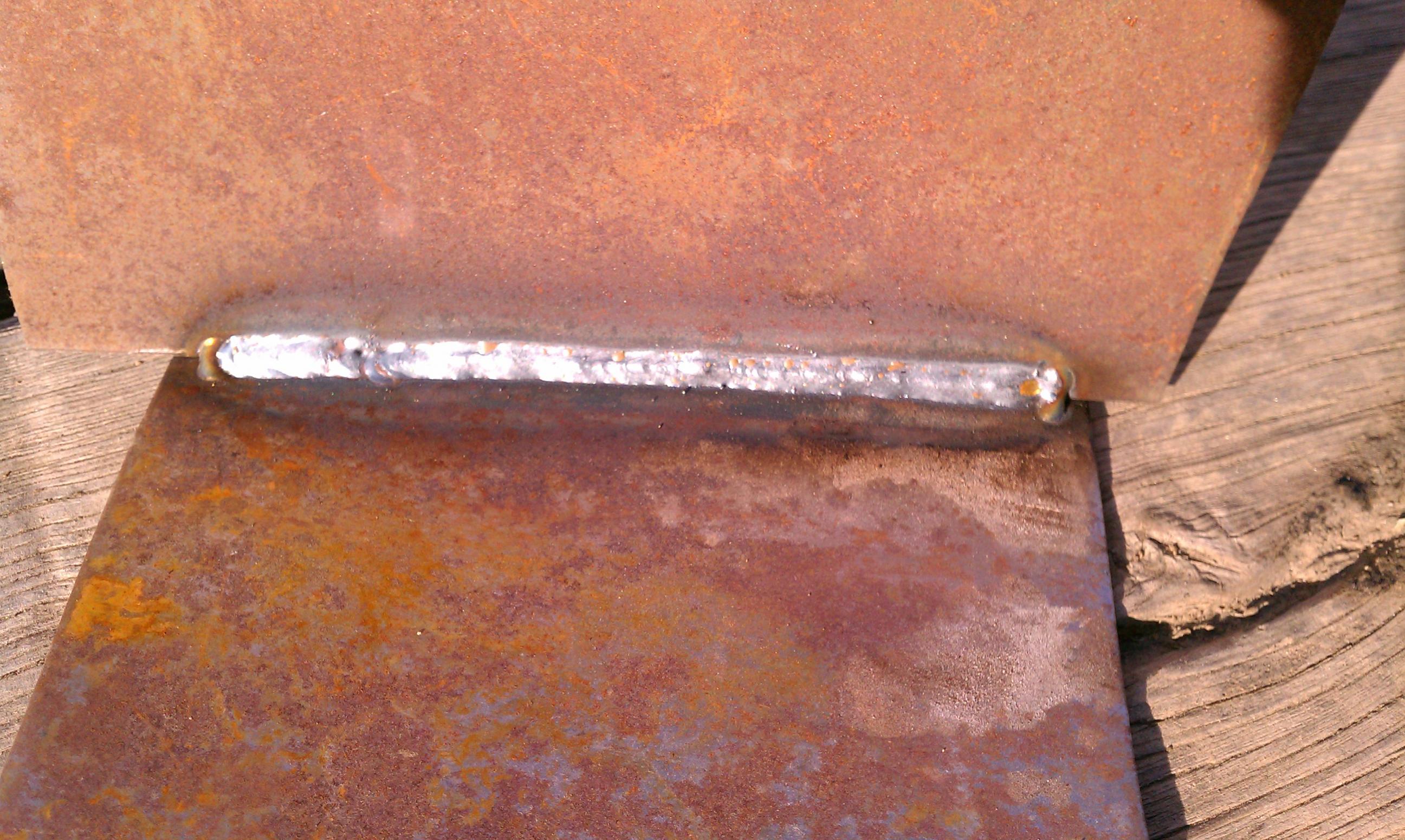

    Here are a few o' mine utilizing the same technique.

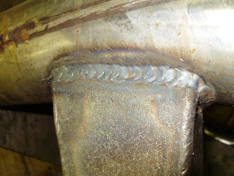

    Then I came across these welds and automatically thought they were Tig only to find out they weren't. Does anyone know the technique on making your Mig welds look like this? I have an understanding in my head but would like to hear your thoughts to see if I'm far off. Do you think it'll be as strong as welding the regular way?
    Huge Kudos to who welded that motor mount/suspension mount!
    To get my s***ch welds to come out even and ***y, I pull the trigger & weld & count to 3-release and instantly move the cherry of the mig wire to the leading edge of the cooling mig puddle. Let it go dark in the lens (count to 5) and then repeat.
