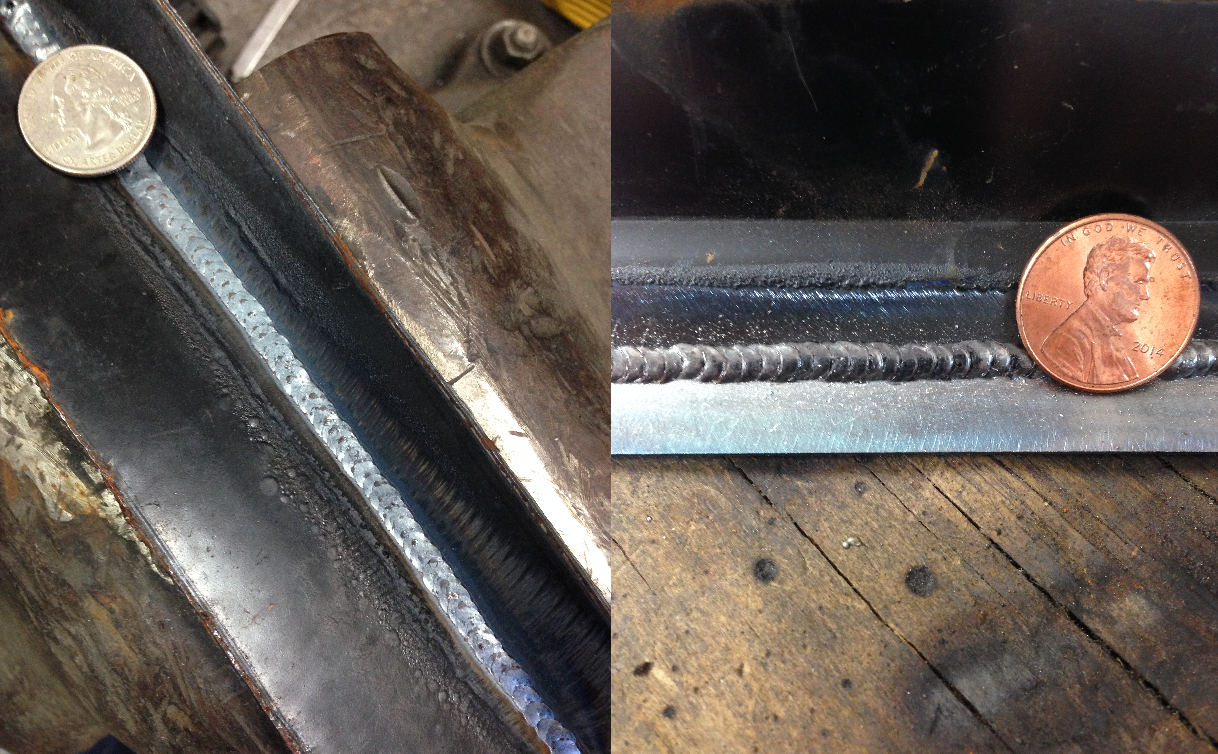

    That pic on page one looks great to most and its not bad by all means but its not a 100 percent great weld either. With experience you learn how to carry a solid core bead and make it look like a closer set of as called "stacked dimes" which should lay down flat and not really stack and pull apart (thin) as pictured. I am referring to this mig weld post.

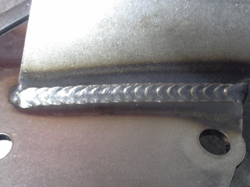

    Some of my mig from work today

    Looking good
    Not bad for a first post either.

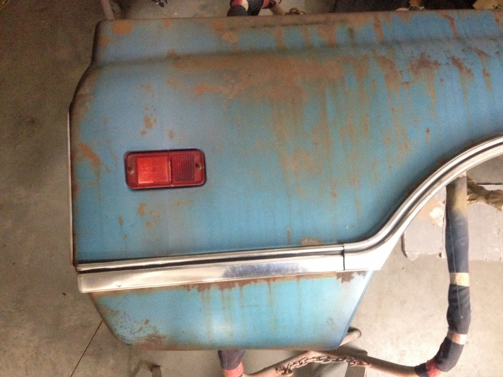

    IMG_3506.JPG In my shop we have to learn to mig weld on nasty sheetmetal because people want us to do stuff like shorten bedsides and not disturb the patina ( that means rust) So we just pick up **** off the floor and get things going. Here is a bedside with 8 inches removed and mig welded back together so it was not so noticeable and keep the patina ( rust) No bondo or filler just a dusting of color close to the old finish over the joint. migLiketig.png

    I work for a company that makes suspension for muscle cars n hot rods

    Thats pretty amazing! Are you pushing or pulling to do those ?

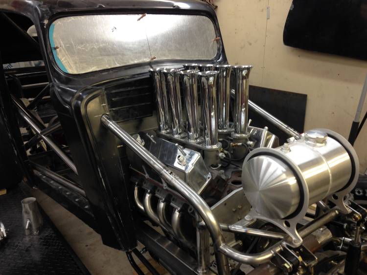

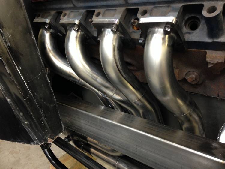

    The photo's are a 33 my buddy and I are building we used mig to tack it and tig welded the rest. The headers were welded with mig wire using tig E-70s-6. IMG_0413.JPG IMG_0409.JPG
