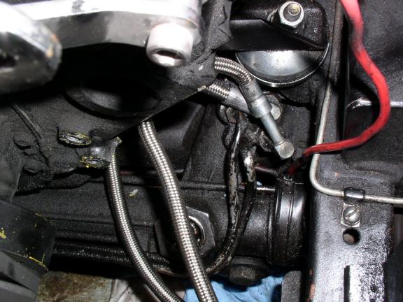

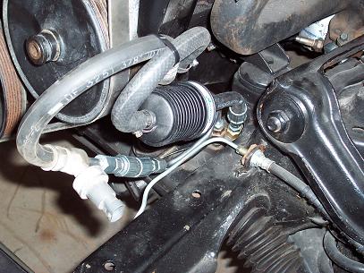

    WZ, thanks for the pics. Did you have those lines custom built?. I am using angle (90 degree) fittings out of the rack (see pic) as that is what the kit came with. In the pic I have pulled the lines from out under the motor mount and engine to allow me to remove the pump and undo the lines from the back. You can see how tight of a fit it is using an early GM PS pump being that it connection pouints sit at the leading edge of the motor.. i.e.. no room.

    WZ, thanks for the tip. Just got my new Speedway catalog in so I am set.
