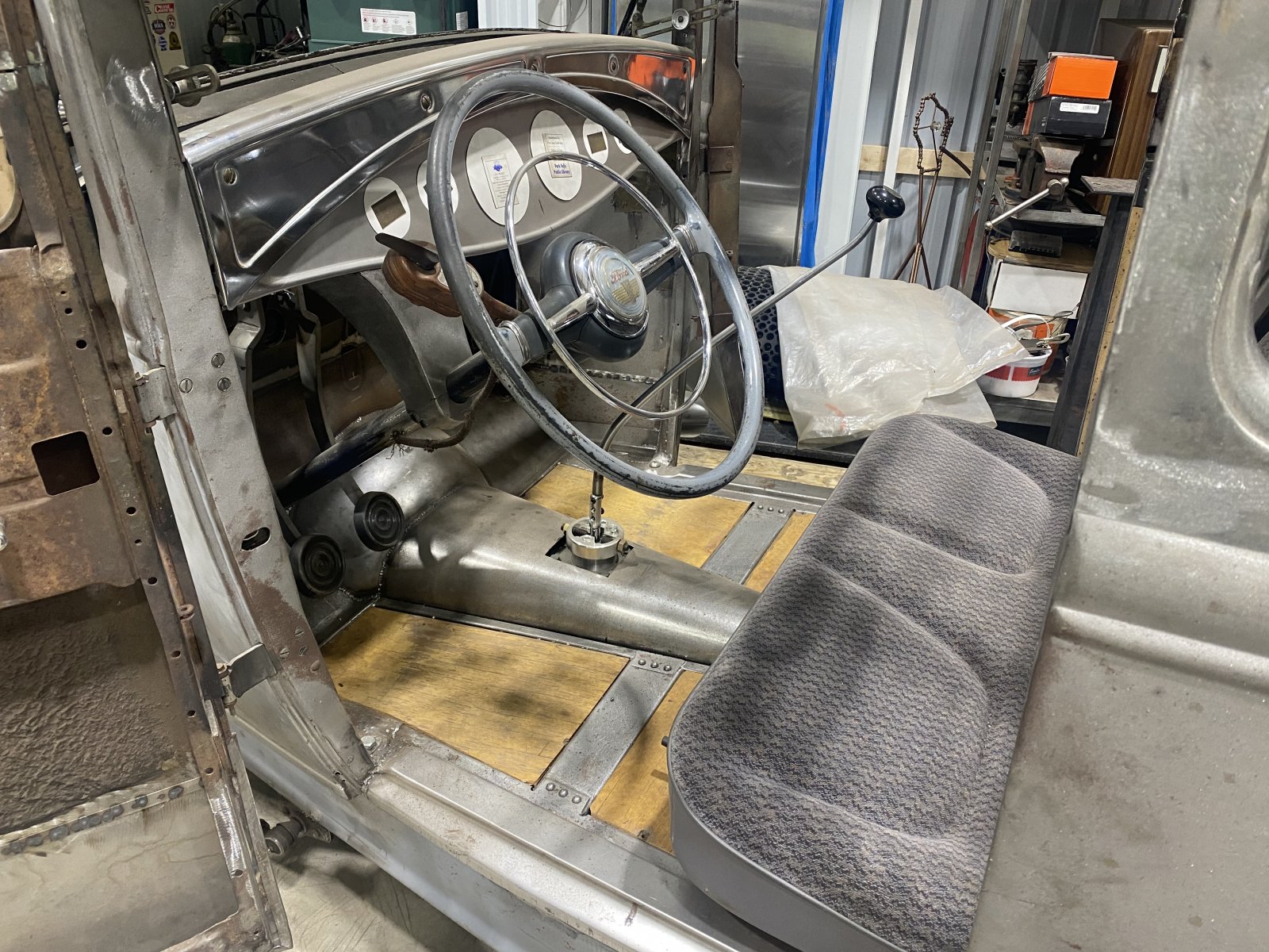

    Looks awesome and congrats on the House. I know the pressure there. What’s the seat from. It fits great. Wondering because I’m at that point.
  2. Mike Paul
    Joined: Oct 10, 2003
    Posts: 1,038
    Mike Paul
    It’s a Dodge Caravan middle seat

    Sweet build so far sir. Mine's in the home stretch on the build side as it's in paint right now then on to final ***embly. used the caravan seat as well, they just fit perfect. Here's the finished product. IMG_4379.JPG
  5. Vanness
    Joined: Aug 5, 2017
    Posts: 411
    Vanness
    Heard they do. Guess I’m going that route. Like a 90s or mid 2000s?
  6. Fitnessguy
    Joined: Sep 28, 2015
    Posts: 2,044
    Fitnessguy
    2000's

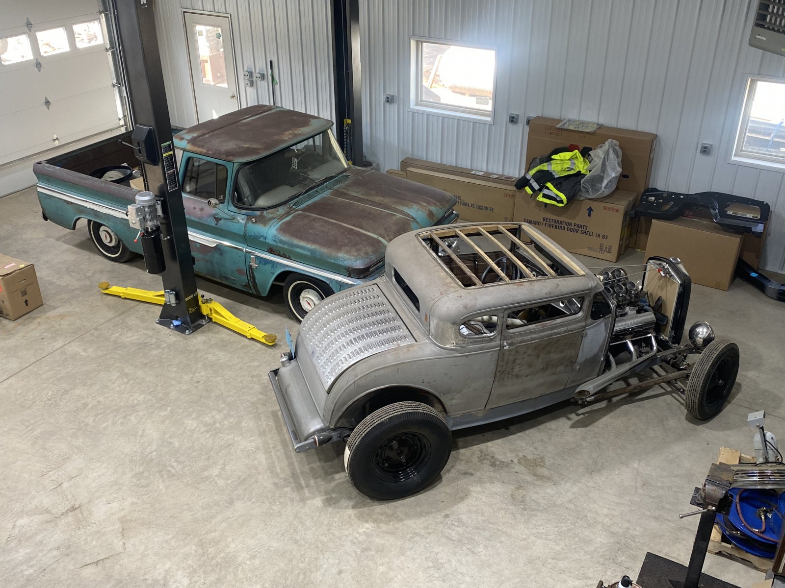

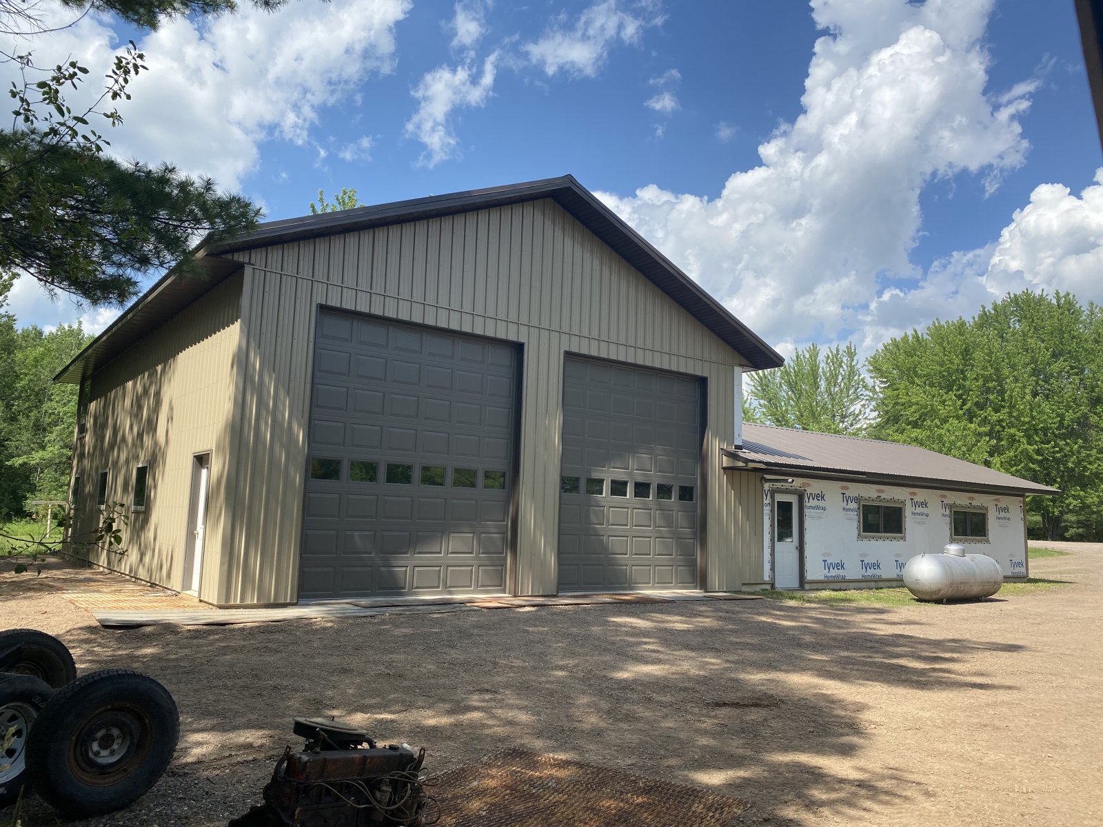

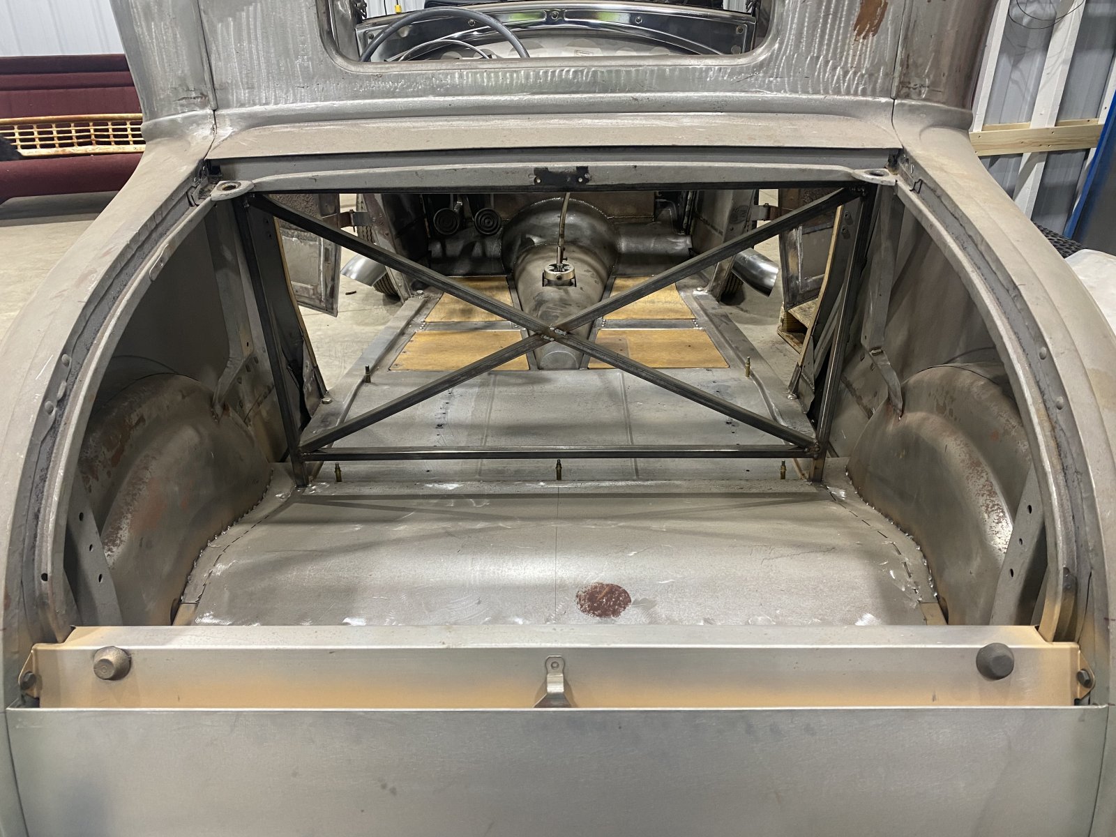

    55D831E6-46BA-4D0C-8364-462577D7E99F.jpeg ECBCB828-CF15-4C99-892C-D086BD2D4CDB.jpeg 2F16BC46-F12E-4100-93C3-C3F801191D17.jpeg D2D58F6A-EC35-40DB-88DF-057C0AEBF9C1.jpeg 907DAD83-FEE4-4362-A0CD-0D668DAD3C23.jpeg 5E3F6D48-1FD3-4786-BAFF-8BF2AD639B6B.jpeg I’ve only been able to work on the coupe here and there over the last couple years. My job got busy, I built a new shop, and did a bunch of work on my ‘63 C10. On the coupe I was able to get the floors done and the pedals hung. I’ll get some more pics today of the floors

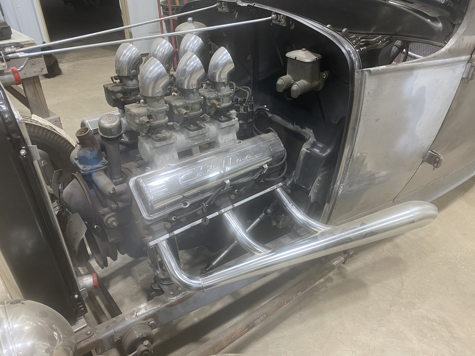

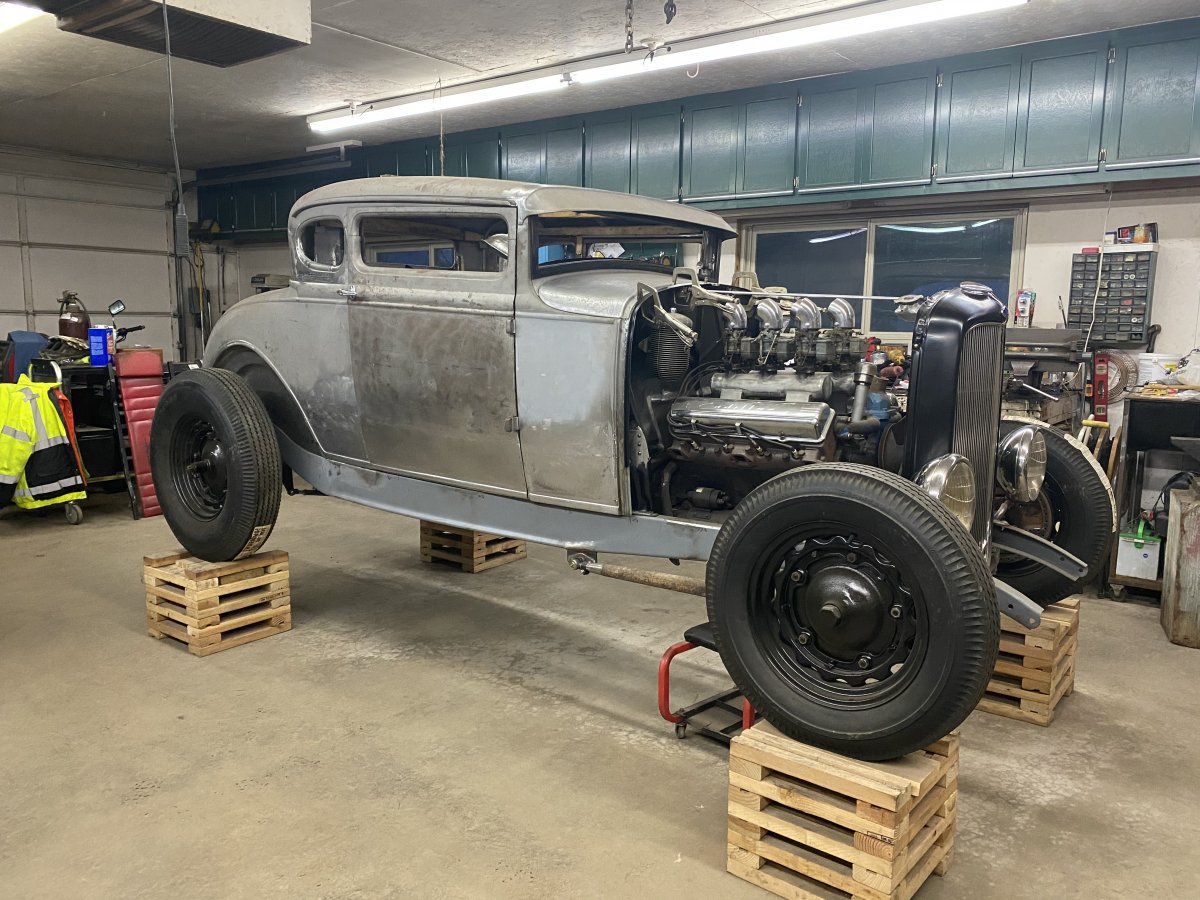

    244B2A89-B8F7-44D5-AA3F-82B021D1F41E.jpeg 0AD1137D-BACC-49AE-9FD0-6F8B8E640BB9.jpeg 97892F46-15EF-406C-91E3-19858B5D6920.jpeg 0AD1137D-BACC-49AE-9FD0-6F8B8E640BB9.jpeg 244B2A89-B8F7-44D5-AA3F-82B021D1F41E.jpeg I also tore down the 331 Cadillac and got it sent off to the machine shop. Ordered a cam from Schneider yesterday. Will probably be ordering the pistons soon.

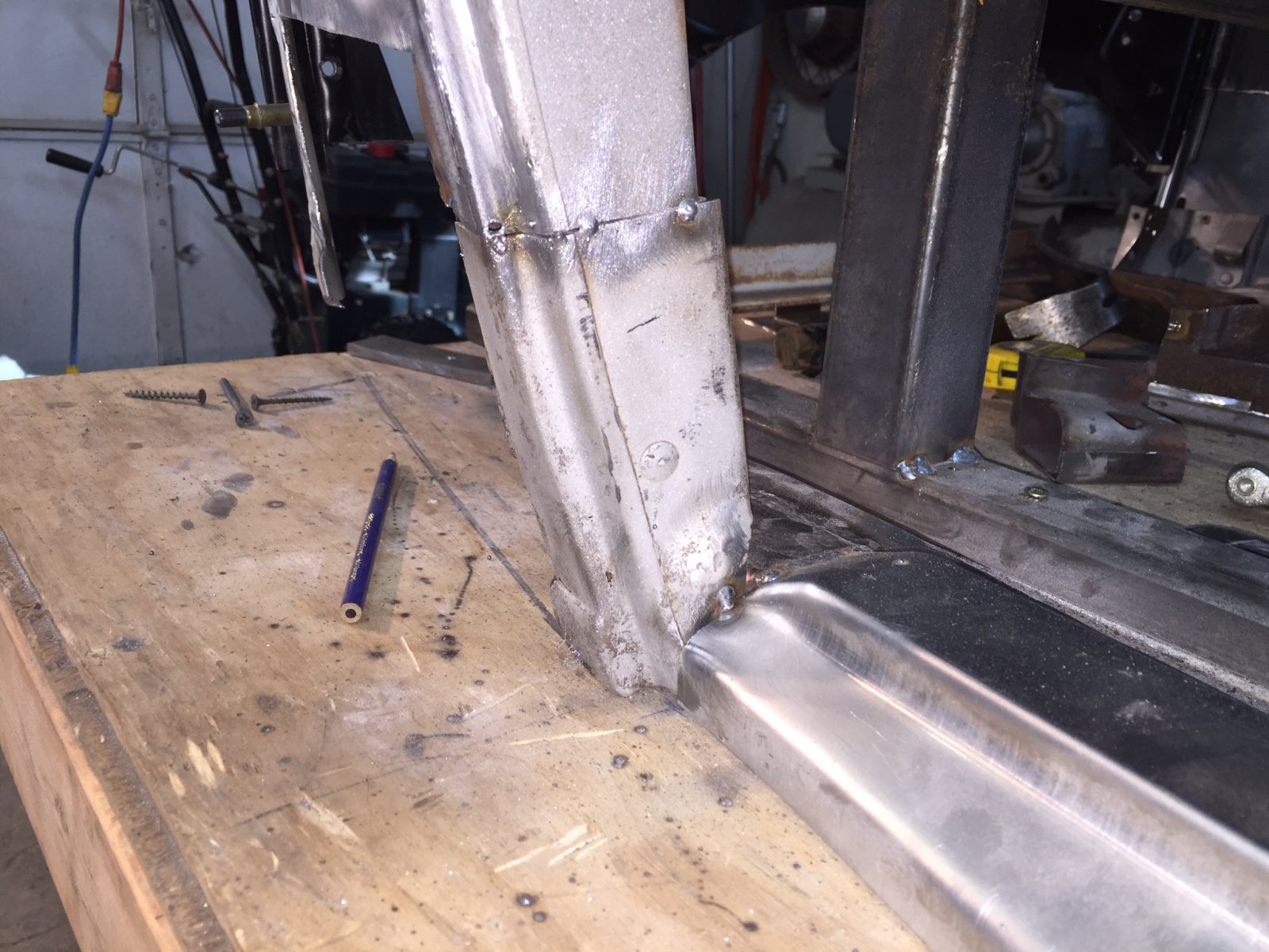

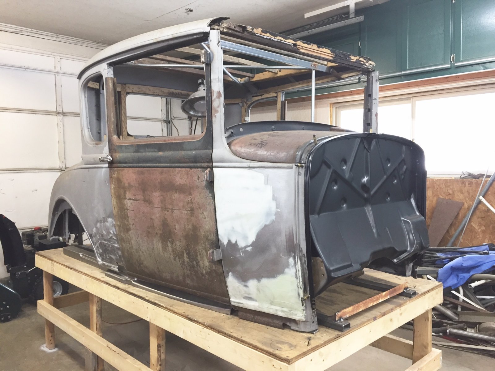

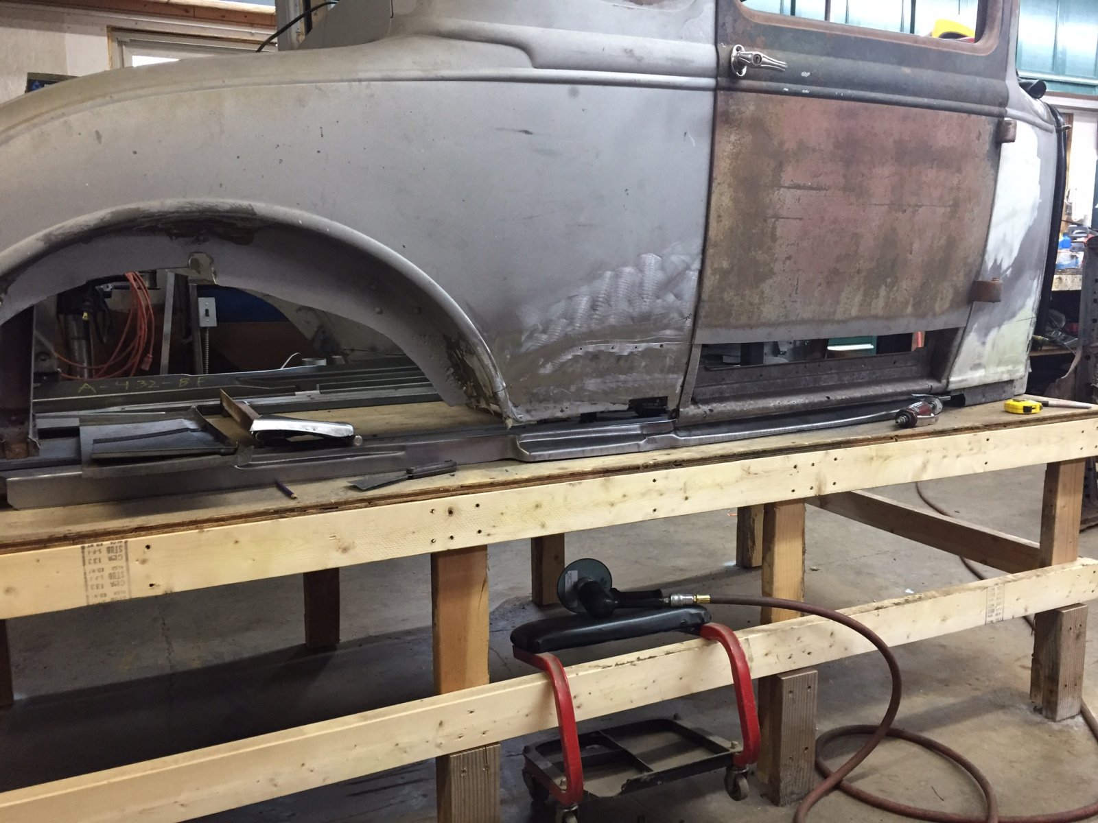

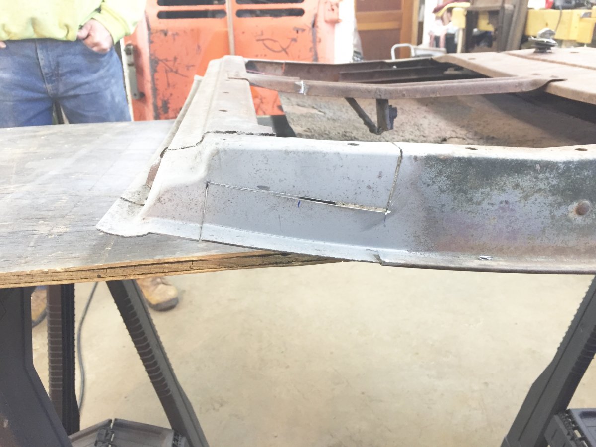

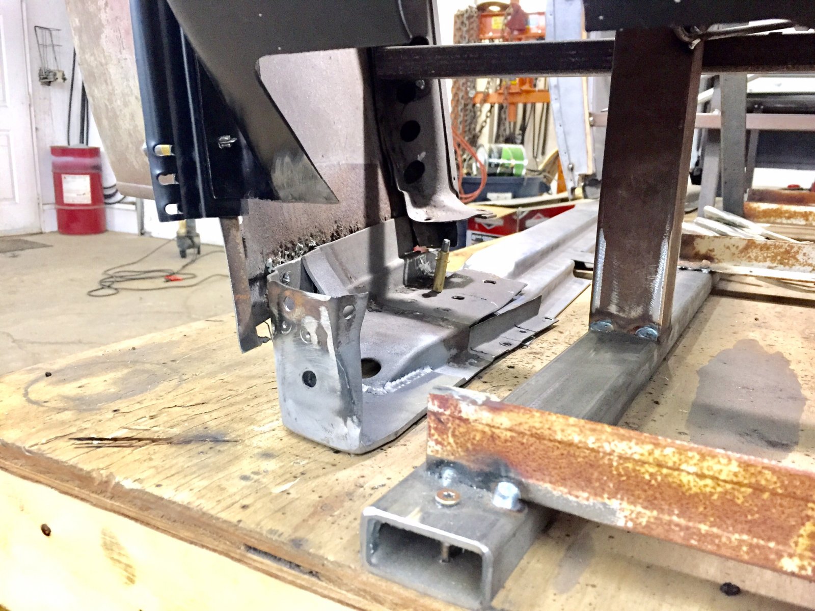

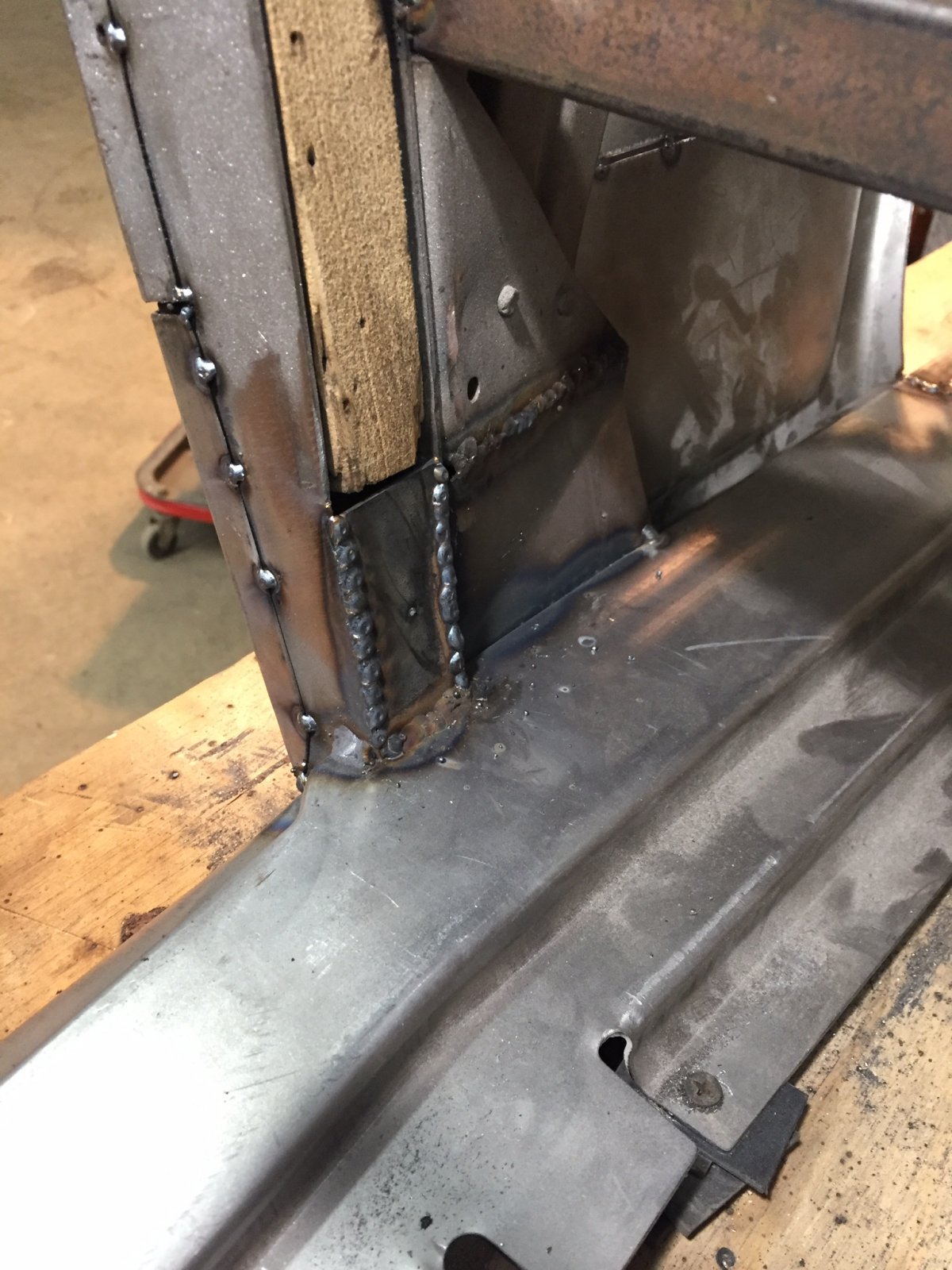

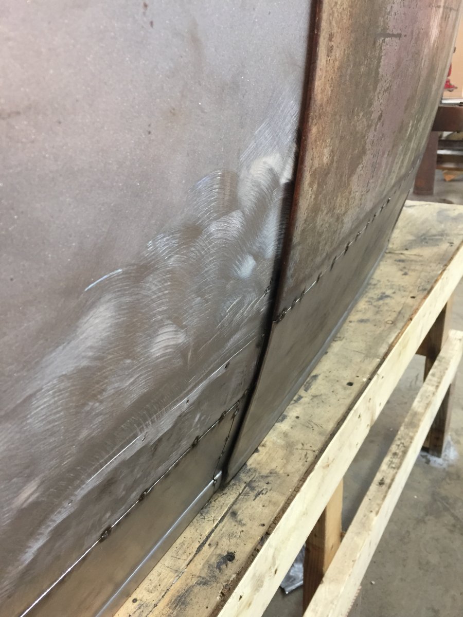

    Ok, the Tudor doors are longer than Coupe, is there a contour change? I don't fully understand the inner door frame getting notched. quarters and cowl stay the same and the body is now longer because the doors are longer, I don't see the over door section getting lengthened. Will a stock A hood now work on the '32 frame? I'm a big fan of subtle changes. Bob
  29. Mike Paul
    Posts: 1,038
    Mike Paul

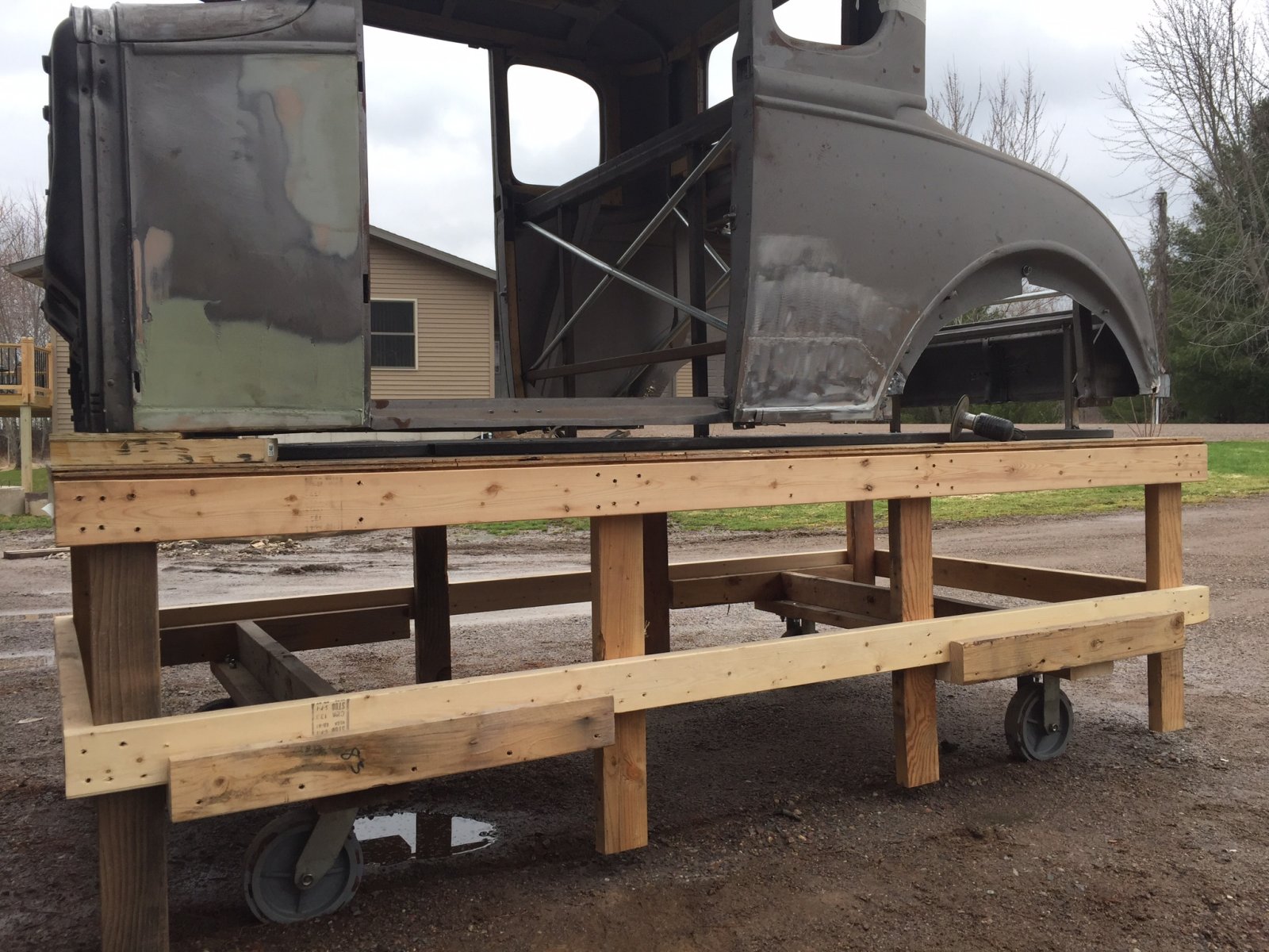

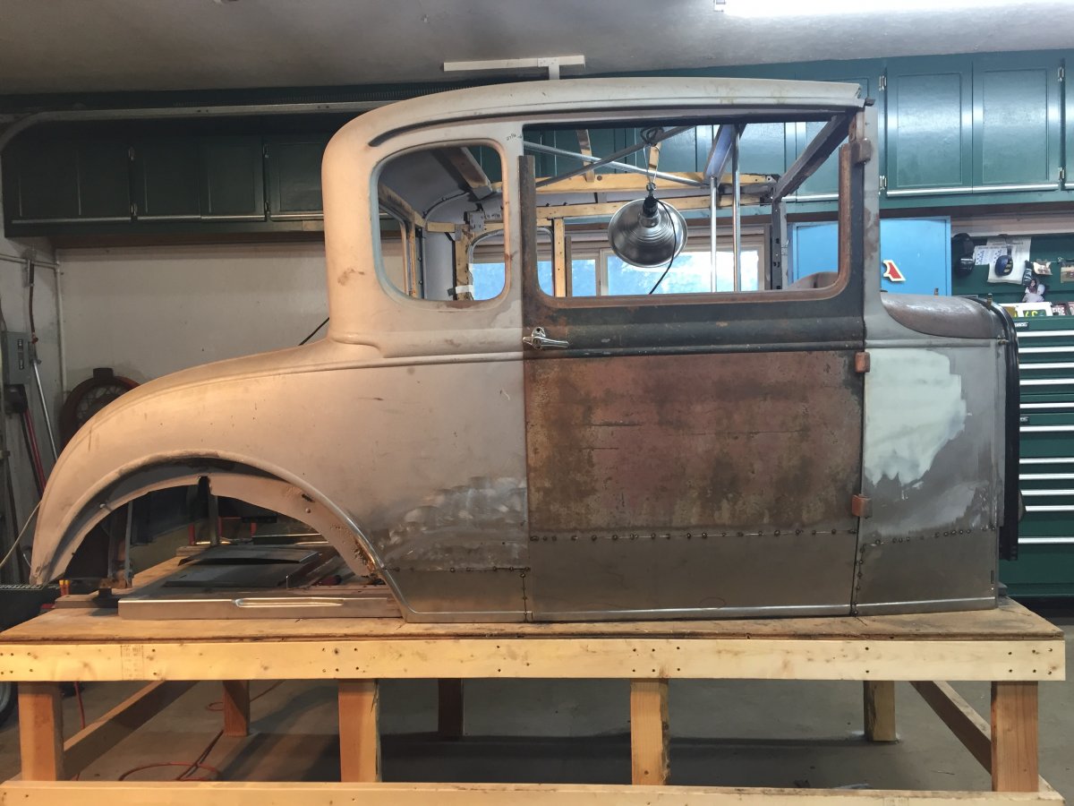

    98DE95BD-6558-40E4-9619-719335883984.jpeg EE68C1AF-A6D5-4FD9-909A-423E0BEF2A4A.jpeg B286FB9F-5839-49E5-B30B-DE9086FC7C2A.jpeg 38DDDFEA-4E4A-41FA-BDE5-FFCFCEE5222C.jpeg BF765F5F-3611-496F-9323-38E7F5B53E66.jpeg BD80EC1F-DBC4-4761-8104-031E0280D744.jpeg 51F4E411-CE0D-4FB0-8217-06A4E92124FD.jpeg E2BBF127-11A2-4610-8DD2-D3ED6470A5BB.jpeg 3C647536-45BD-45B1-9E26-AD57DCEEAD83.jpeg 8C87BD39-98C3-4FC5-BCE4-A74F65D2413C.jpeg EE68C1AF-A6D5-4FD9-909A-423E0BEF2A4A.jpeg B286FB9F-5839-49E5-B30B-DE9086FC7C2A.jpeg
    here’s a couple pictures of the quarters and cowl
    I braced the inside of the body and kind of levitated it 2” above the table. Then I used Tudor sedan subrails to stretch the door opening. I also had to add to the length of the roof by where the visor attaches.
