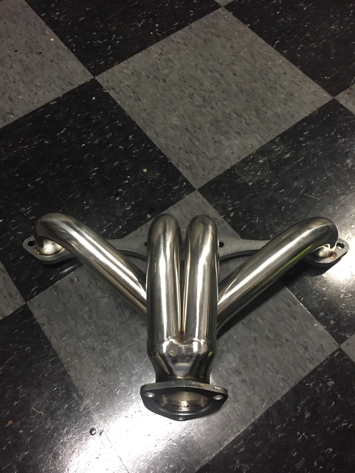

    Didn't see a picture of the headers you're running but depending on how much the headers hit the linkage you might be able to use spacers on the engine mounts to lift the engine a little to clear.
    I had to cut my motor mounts and raise my engine up for the block huggers to clear the steering.

    [​IMG][​IMG]
    Here they are, we'll see what happens tomorrow when I get up to my car

    Same exact ones in the 51 ha.
    the 3rd and 4th tubes were hitting on mine.

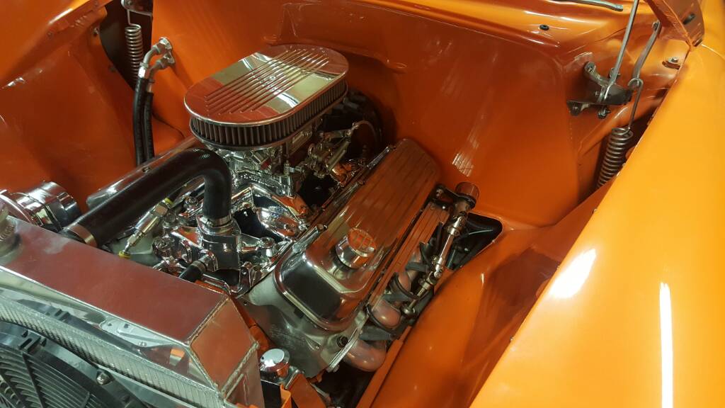

    Here's a couple pics of the big block in mine that I mentioned earlier
  16. Tyler Brewer
    Joined: Jul 7, 2016
    Posts: 53
    Tyler Brewer
    That's a big ol' motor in there! Looks good!

    I got the headers in, had to bang on the drivers side quite a bit to get the steering to clear. One of the set screws still bumps it if you are jerky with the steering wheel... I might end up grinding it down to have zero interference. Brake lines are up next.
