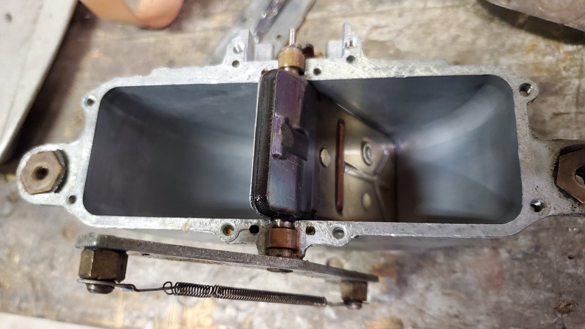

    Not that our local Napa is unhelpful; but that was a "we might be able to order it" item, asked about on the off chance they had it on the shelf. It's only a very small store.
    I made a better seal on the pipe sending vacuum to the washer jar (the jar union doesn't have a flare and is an odd size) which resulted in being able to pull a slightly better vacuum (with my little hand pump I could get it to about 4-5" Hg) and managed to liberate a slight dribble from the nozzles when operated from the car.
    I took it all to bits again. I took a look but I don't have any brake fluid so took both the seals off (vacuum and also water pump) and set them under a weight whilst covered in Marvel oil in an attempt to swell them up and spread them back out again.
    I shredded a pencil and applied the graphite dust to the wiper blades. They move quite well now but I can hear the motor hissing quite heavily along the center of the sweep.
    We'll see if I can make any improvement without resorting to a rebuild kit...

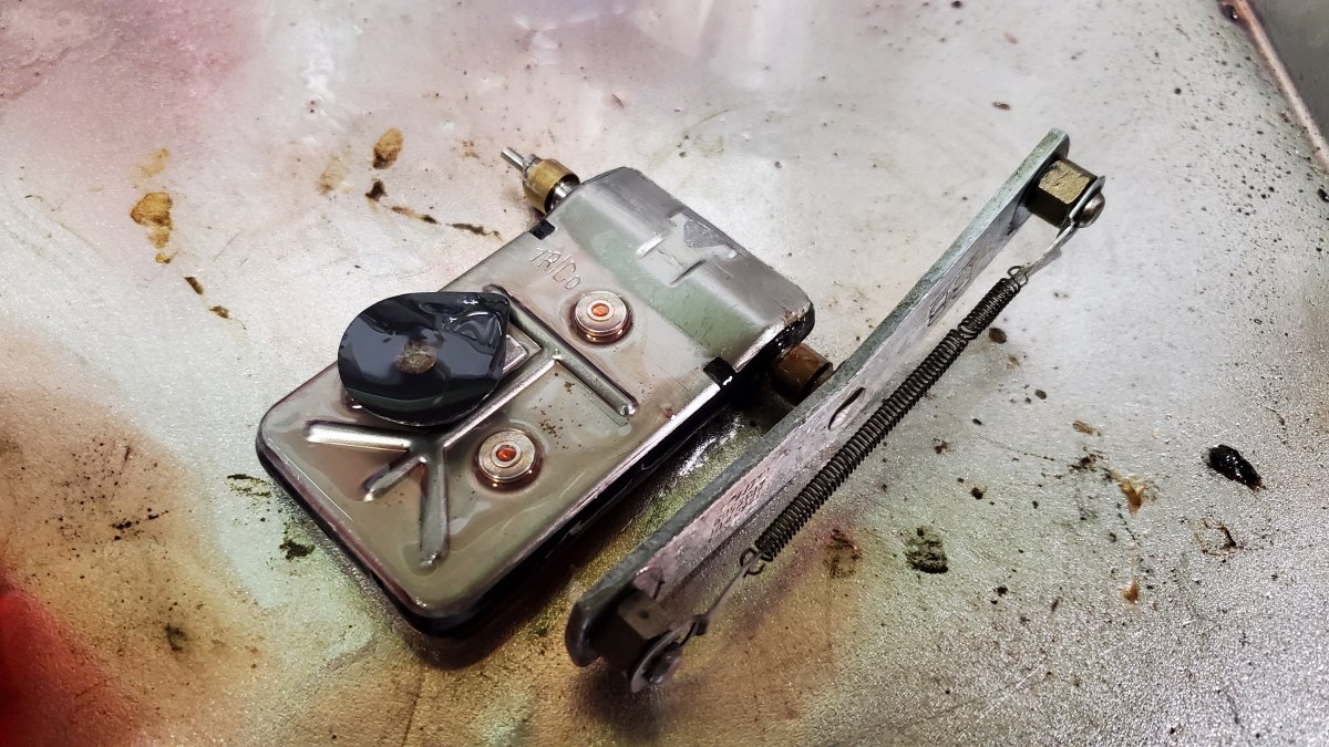

    Edit: He only rebuilds. Right now I'm trying to see if the rather worn out rubber can be encouraged to swell up a little to take up for where it's all worn away.

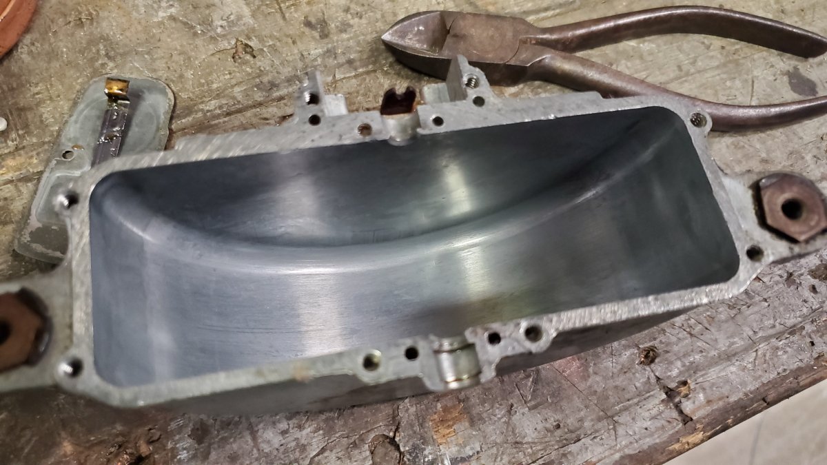

    That seems to be having an effect so it can stay sat in that overnight.
    It's gotten cooler out, too. We'll see how that all behaves in the morning. I put some 2000 grit paper on a sheet of gl*** and rubbed the valve down so it's again flat, hopefully that helps a little also.

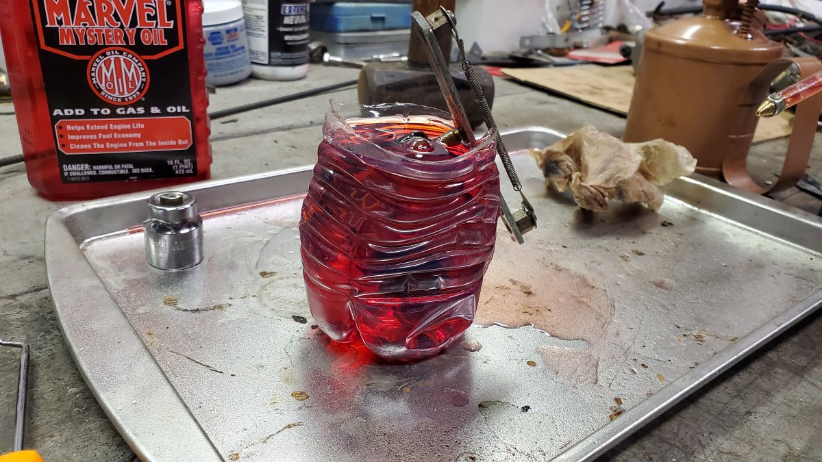

    Rubber parts continue to soak, it is having an effect.
    Phil

    Anyhow. I cleaned the wiper motor out.
    I cleaned the silicone grease out and oiled up with mineral oil.
    Top valve was cleaned the same.
    The paddle fitted a little more snugly but ultimately not as well as it needed to.
    Firm to push in but not forming a particularly good seal.
    Re***embled it moves well without load but gets really badly hung up with the wipers attached to the spindles.
    Rebuild calls.

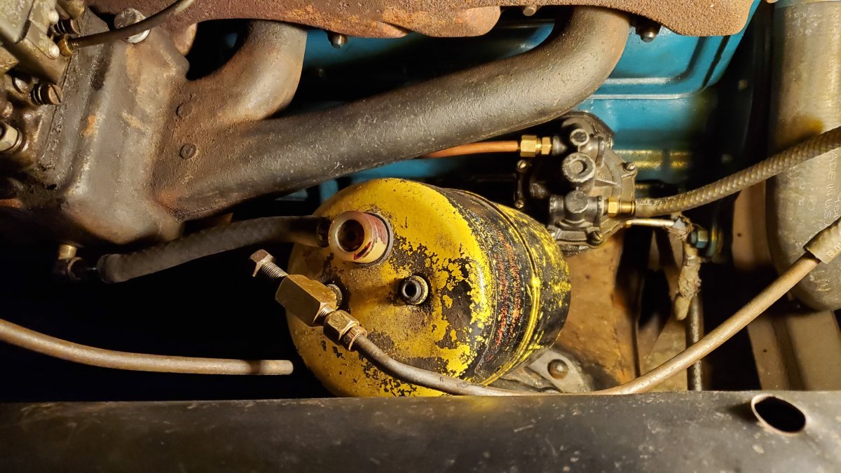

    I figured I would add a vacuum canister to see if the added volume would help. Nope. (Yes, I know it's before the pump)

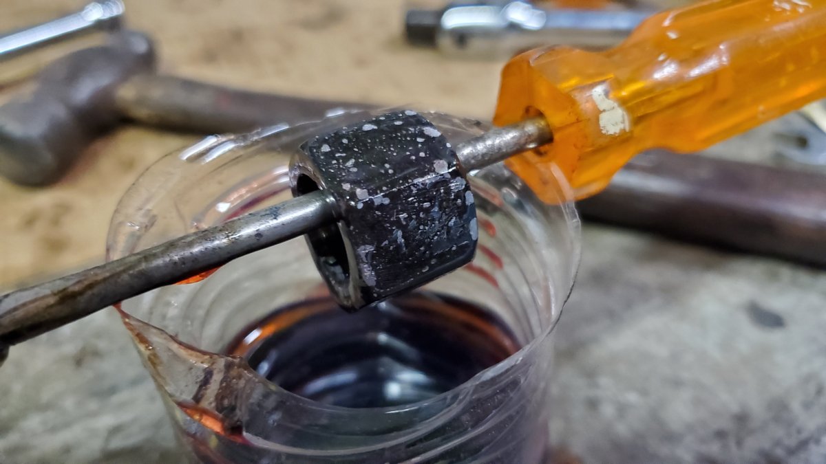

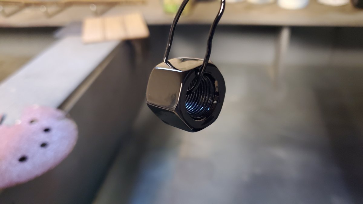

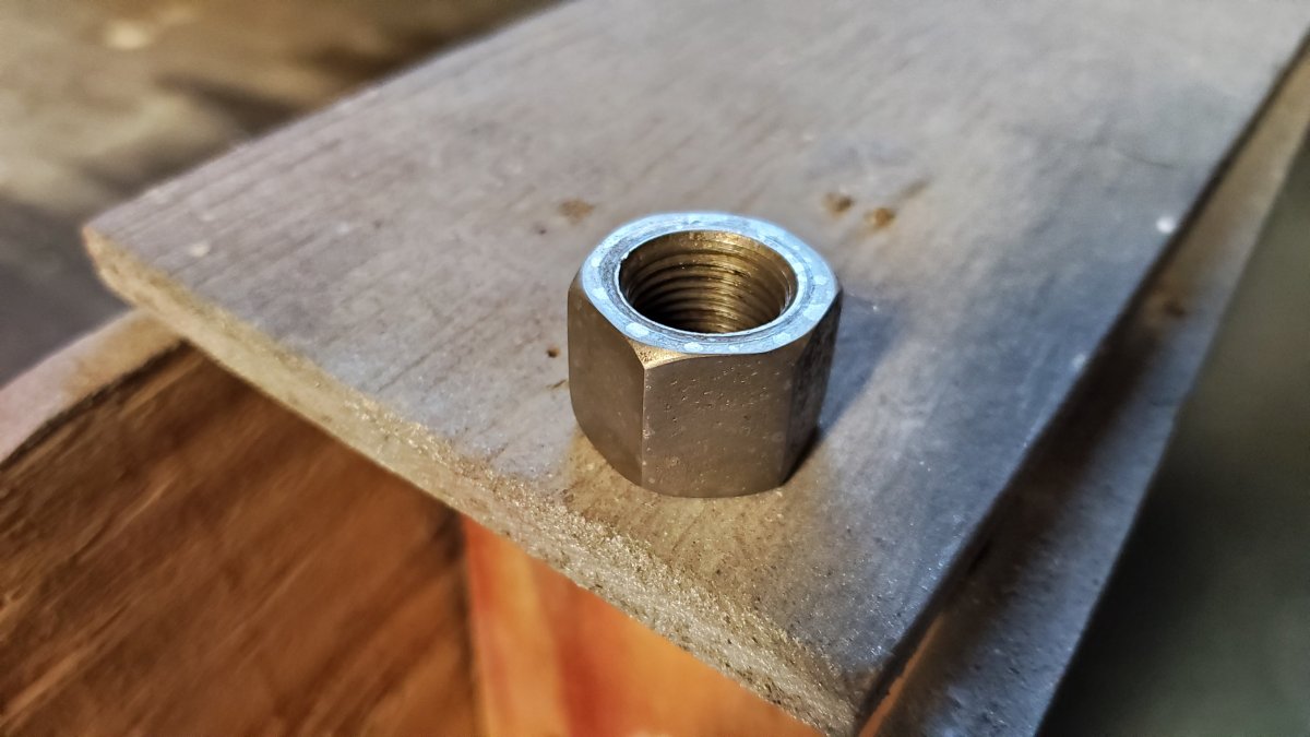

    Small things right now.
    The top brake adjuster locknut on the driver's side didn't put up much of a fight.
    Scrubbed it down and dunked it in some funny gunk.
    From there it came out clean.
    Finally given a protective coat.
    I think I could be allowed to advertise this as "nut and bolt restoration".
    Ha!
    Phil
