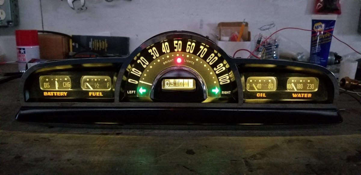

    A little more cosmetic work from in the cabin. This time the gauge cluster.
    Overall not bad- I had cleaned the haze off the inside of the lenses prior to the photo above. The 12 Volt conversion had overheated and ruined the gauge electrical components and the resulting fire had left smoke damage.
    As with all Lucite/acrylic/polymethylmethacrylate, a buffing wheel and some fine polish generally brings back a nice luster.
    I tested the mechanical gauge- it reads well, needed a little bit of adjustment because it was not reading zero at zero.
    The ammeter also responded when connecting a headlight through it, so that was checked off the list. The fuel gauge and water gauges did not work, however.
    I stripped everything down. I only cleaned the face panels that go in front of the gauges because they looked fine and had a nice patina that matched the gauges themselves, which I had no replacement faces for. I didn't want to bring that up all new and fresh and have sun-faded dials behind.
    With the gauges removed from the buckets, the overheating damage was evident. The buckets were only ever very hastily sprayed at the factory, so I used a little carburetor cleaner to remove the paint.
    Masked off the originally masked areas and put on a new coat of the same shade white- Heirloom White, Krylon, from Walmart.
    The paint on the bezel was also rather tired so I stripped it all off.
    I then masked off the areas to remain chrome with fine-line tape.
    That got it looking all a little bit better. Still a few pits visible in the paint but I don't think there's anything on the vehicle that is 100% perfect. I'll settle for 95% in this case.

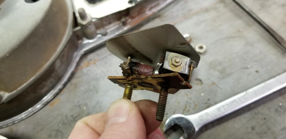

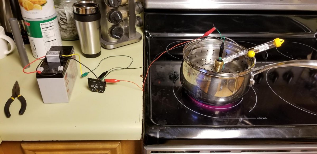

    More work on the gauges. The electrical gauges in this dash work on a fairly simple principle- apply a constant current to one coil and it'll center it to zero. Apply a variable current to the other, mounted at right angles and it'll affect the flux and make the core move, and in turn, the needle.
    post-5454-0-79139900-1543029760.jpg Unfortunately these are six volt gauges. Hook 'em up to 12 volts and the coil connected across the battery really won't last very long. Neither did, they both caught fire.

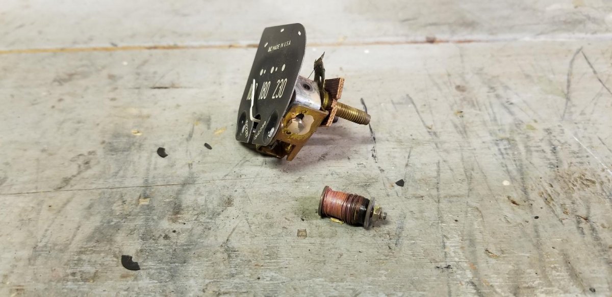

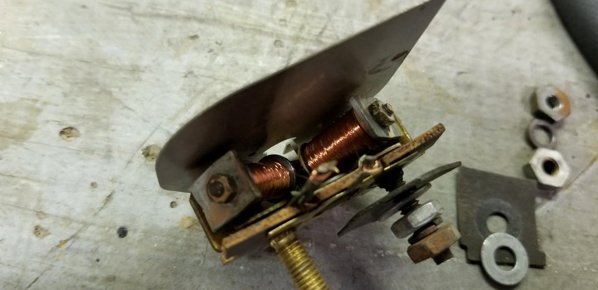

    Looking at the construction, I decided to have a go at pulling the coils out of the frame. They undid, and the original crimped joints just pulled off.
    Doesn't look too happy right there. Tested, it was open circuit.

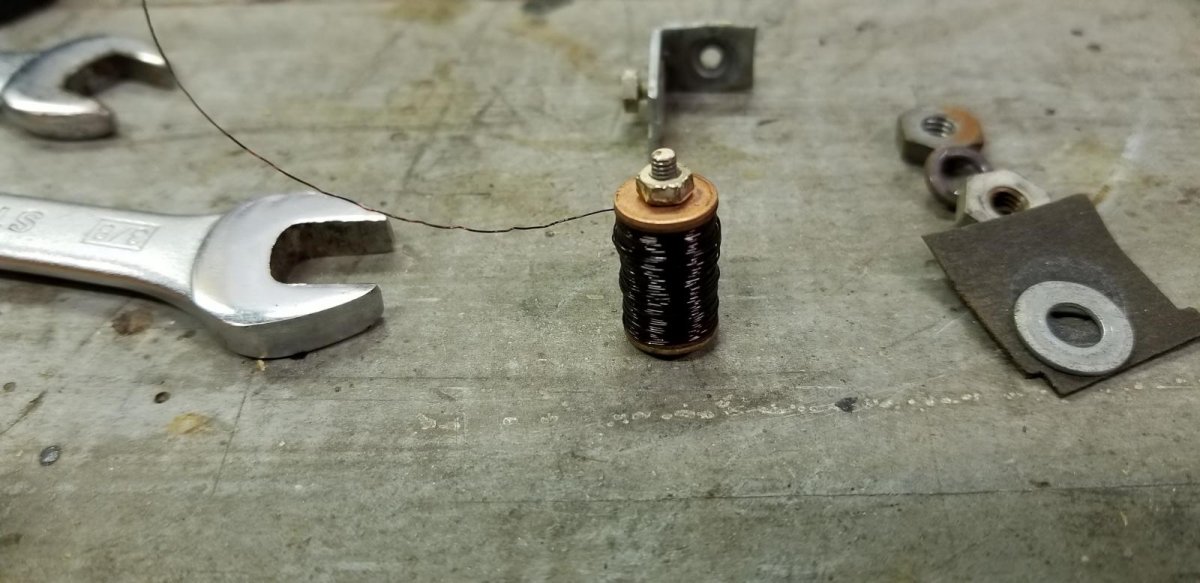

    This one was worse and all broke up as it was unwound. The heat had made the copper very brittle.

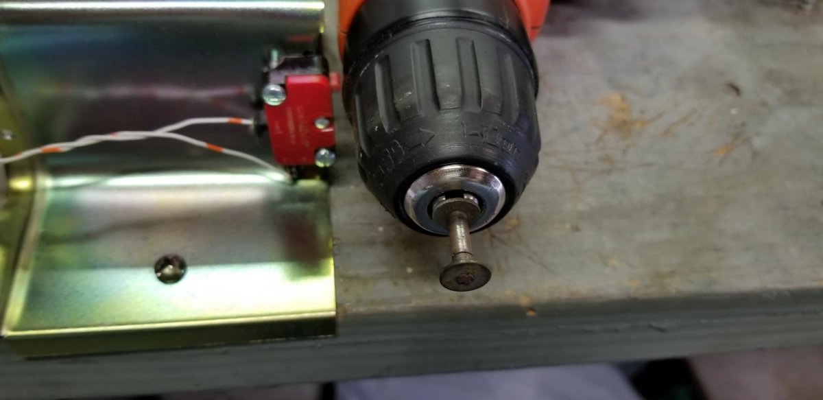

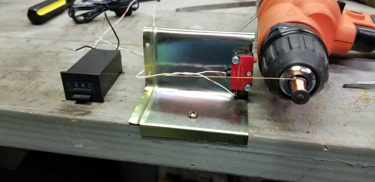

    I Heath-Robinsonned a contraption together on my bench. I made a cam out of tape that went around the chuck of my twist drill, which operated a micro-switch. This activated a counter to count up how many turns of wire were wrapped around the form.

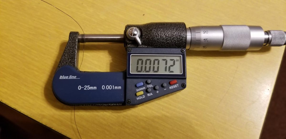

    The entire length was burned to a crisp. I pulled out my micrometer and measured the thickness of the wire. 0.0072" or 33 AWG.
    I did a bit of research on fine wire.
    33 gauge is 206 ohms per 1000'
    36 gauge is 416 ohms per 1000'
    Thinking on that, 518 turns of 36AWG should see the coils working again, but for 12V instead of 6V.
    That's all just rather loose theory because in practise, winding coils is more of guesswork combined with trial and error.
    As it turns out I had to be corrected by someone who rewinds motors for a living- you double the resistance by halfing the wire cross-section but also then require double the turns to create the same magnetic flux.

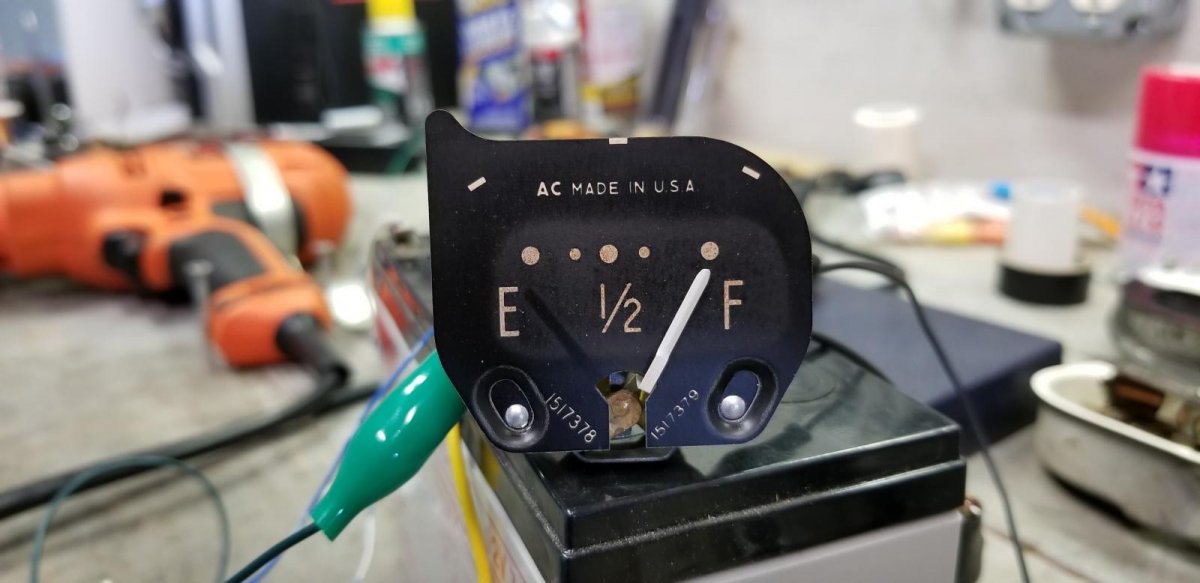

    I ordered some wire and carefully wound it back onto the form, having first stripped about the first 5 inches of its' insulating lacquer with sandpaper, where it wrapped around the form and made an electrical contact.
    Tested the resistance- about double the original wire (once it was all unwound and not shorting out). Good deal. Rinse and repeat for the other coil, and get it all connected up.
    Much better. Both coils are adjustable in relation to each other, to allow the gauge to be calibrated. That's a fun task, as adjusting one puts the other off balance. Applying a voltage and putting a variable resistor across the gauge made it move. Success!

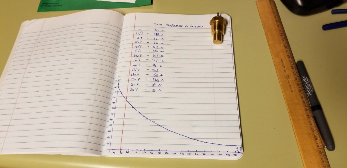

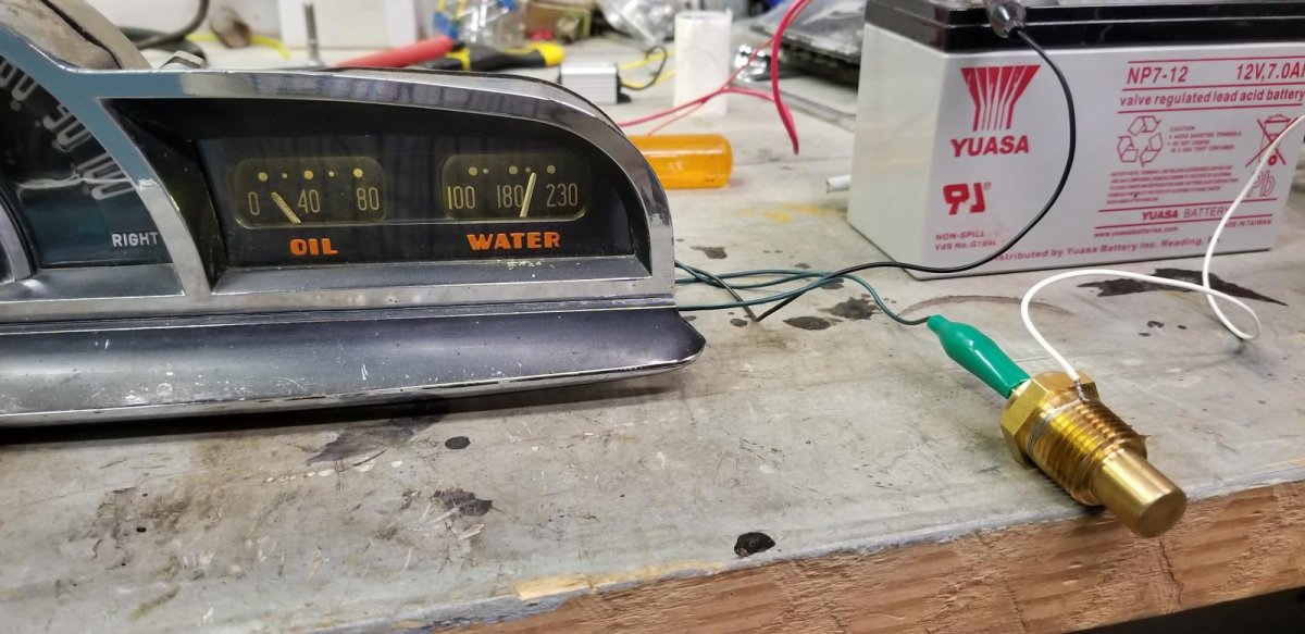

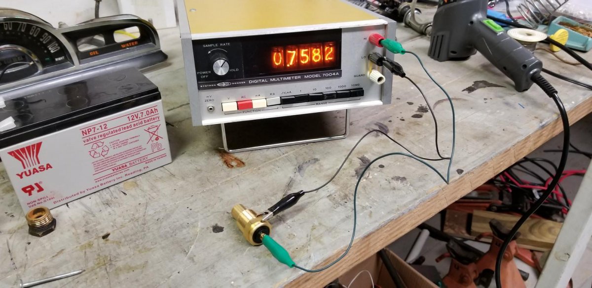

    I then went shopping for a replacement sender unit. That turned out to be fruitless as the early 50's GM senders have a very small range of resistance, were prone to failure and as such had all but vanished from stock.
    130 Ohms for cold
    60 for 180F
    5 Ohms for "it's overheated, friend".

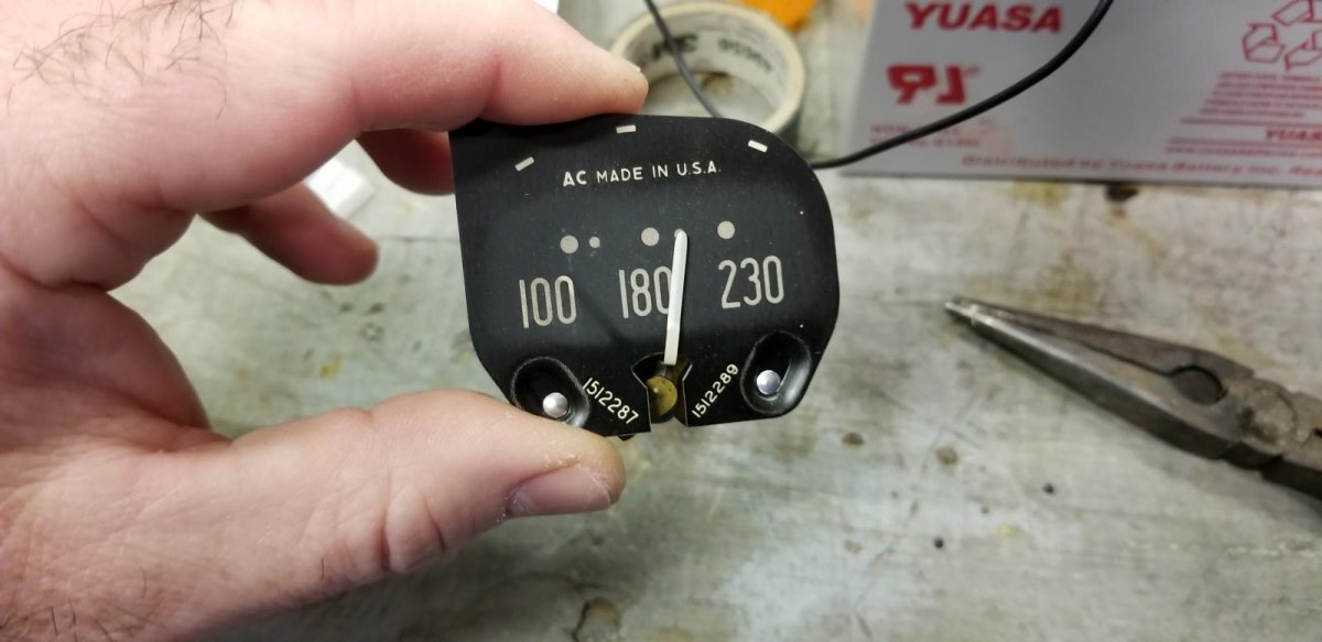

    I went in search of the next best thing- a sender that is physically the same size, but more commonly available.
    Cue the 1972 Chevrolet C10 pickup truck temperature sender unit. Physically the same size, with a moderately aesthetically pleasing bullet connector.

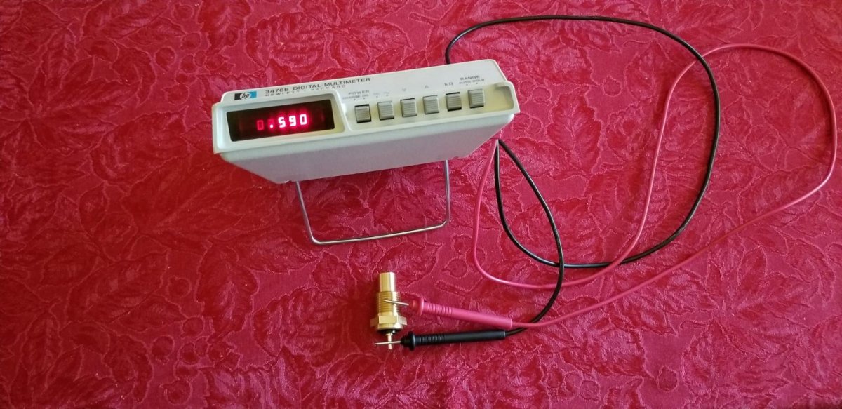

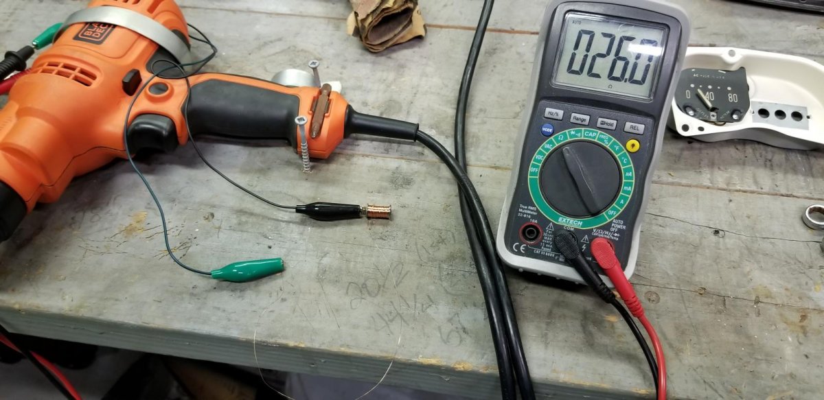

    I knew it was about 1000 Ohms frigid cold, so figured I might be able to re-wind the coils to match.
    At 72F room temperature it was reading about 600 Ohms. Not too bad.
    Outside in the cold, about 35F it was reading 750 Ohms. That's all the way off the bottom of the scale of the gauge anyway, so I decided to see if I could first simply physically adjust the position of the coils to account for the different resistance range.
    Trying with 6 volts to begin with I had little in the way of luck.
    I ended up doing it properly and simply measuring the resistance versus temperature as the water heated up.
    In the end, I had to rewind the coils again but got it set up natively for 12 Volts and the new sender unit... which, off the shelf for $7 at Auto Zone was a significantly better option.
    Across 12 Volts, with the sender unit heated with my heat gun, a good reading was acceptable. It over-reads by about 10F at 100, but by the time it gets to 140 it's accurate all the way to 230. That's as accurate as the things ever were from the factory so I'm happy.
    I rewound the fuel gauge and carefully calibrated it to the factory marks. That was simpler, but I left it at 6 Volts because the resistance wire in the gas tank can't really take twice the current through it. They're quite fragile, low resistance items. Plus, the 6V converter has an over-current protection and will shut down if a short circuit occurs so will protect the sender from being burned out if that happens.
    I re***embled everything and tested it- all good to go. Much better than 4 dead gauges and a tin plate with 3 duplicates.
    --Phil
