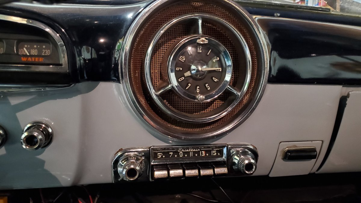

  15. PhilA
    Joined: Sep 6, 2018
    Posts: 2,107
    PhilA
    The sound is really very good. AM is as you'd expect, static and the occasional good reception station; Bluetooth is as good as the loudspeaker can be. The power output stage is an excellent design, capable of producing Hi-Fi sound.
    The limitation is normally the AM reception. I will make a little video later today.
    Phil

    Sure does, if you turn the volume up right at the beginning of the video you can hear it ticking away.

    Just went eye the 1950 Sonomatic schematic- the front end of the receiver is identical to this, the differences lay in the detector and output stages- they use both diode plates in the detector for two stages but that can introduce crosstalk, and Buick's design always went with a transformer-based phase inverter. Either way with the 6V6 push-pull and a decent superhet front end you've got a recipe for a good radio set. what amuses me is this set uses plunger cores to alter the resonant frequency of the coil with a fixed capacitor rather than the other way round with a fixed coil and overlapping metal plate ganged variable air capacitor.
