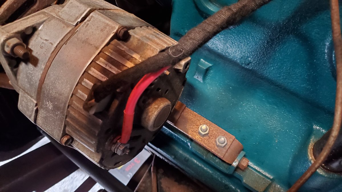

    I cleaned up all the old wiring I had pulled from the car and generally cleaned up. Picture doesn't do it justice but it is a lot nicer in there now.
    Earlier today I bought a length of 8ga wire to hook up the alternator- I had used 12ga because that's all I had at the time, but that is woefully inadequate for a 63A generator. It's under 5 feet from the alternator to the fusebox busbar so that will be good.
    The only other thing I'm thinking about is the ammeter. It's calibrated in Charge/Discharge but full deflection appears to be about 40-45 Amps.
    I'm thinking about putting a diode to shunt the charging current- discharge is about 35 amps total with everything on so that's fine.
    That would take the gauge from reading 40-0-40 to 40-0-60+.
    Thoughts?
    Phil

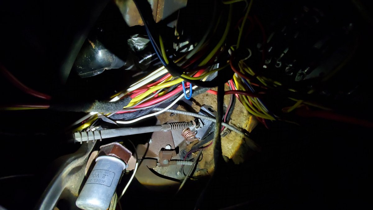

    Spent an hour of my life that I'll never get back, laying upside down under the dash working out how I'm going to tidy this lot up.
    Conclusion is I need to get the heater back in first, then run the new heavy gauge primaries for battery and alternator before looming it all up tidily.
    I'll get there, but ugh. I hate working under the dash.

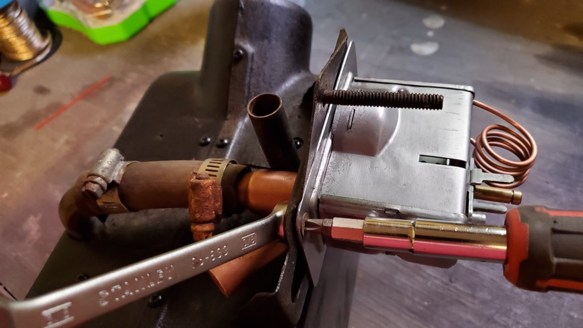

    Found the screws, washers and nuts for the heater valve and re-attached it to the demister body.
    The old gaskets were no more good so I cut some replacements from some foam sheet.

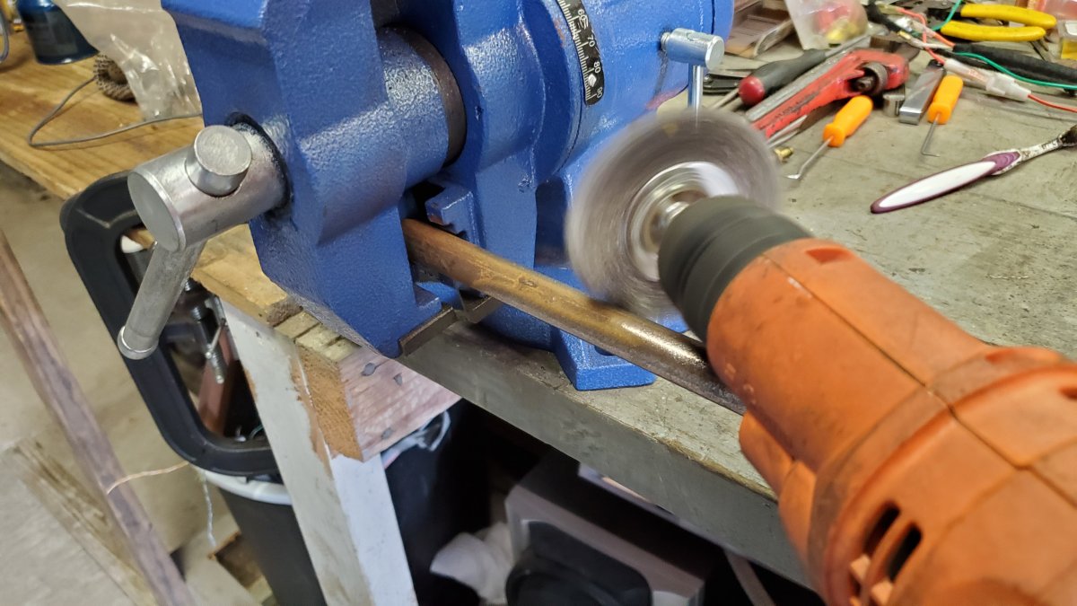

    Dug up the demister to floor heater interconnect pipe and cleaned it up with a wire wheel.
    Ran out of black paint so painted it the same color as the car. That'll work well enough.
    Need to get some 5/8" heater hose to connect the pieces together and a length of solid pipe to join the return to the radiator.
    Then, some air ducting pipe for the screen vents and it'll be set.
    Phil

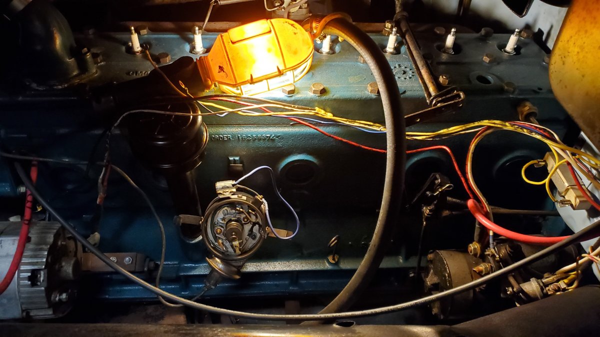

    Unraveled all the tape off the wiring along the engine. I'm going to put in the correct gauge wire to replace the hastily added stuff from before (just to get it working).
    Phil

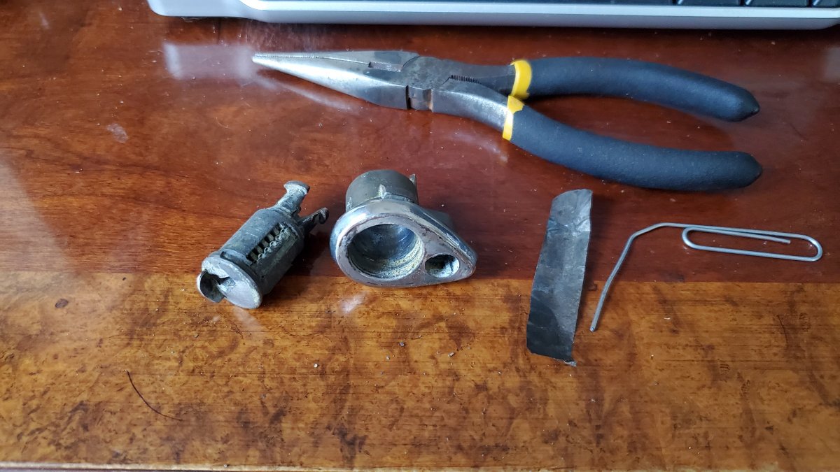

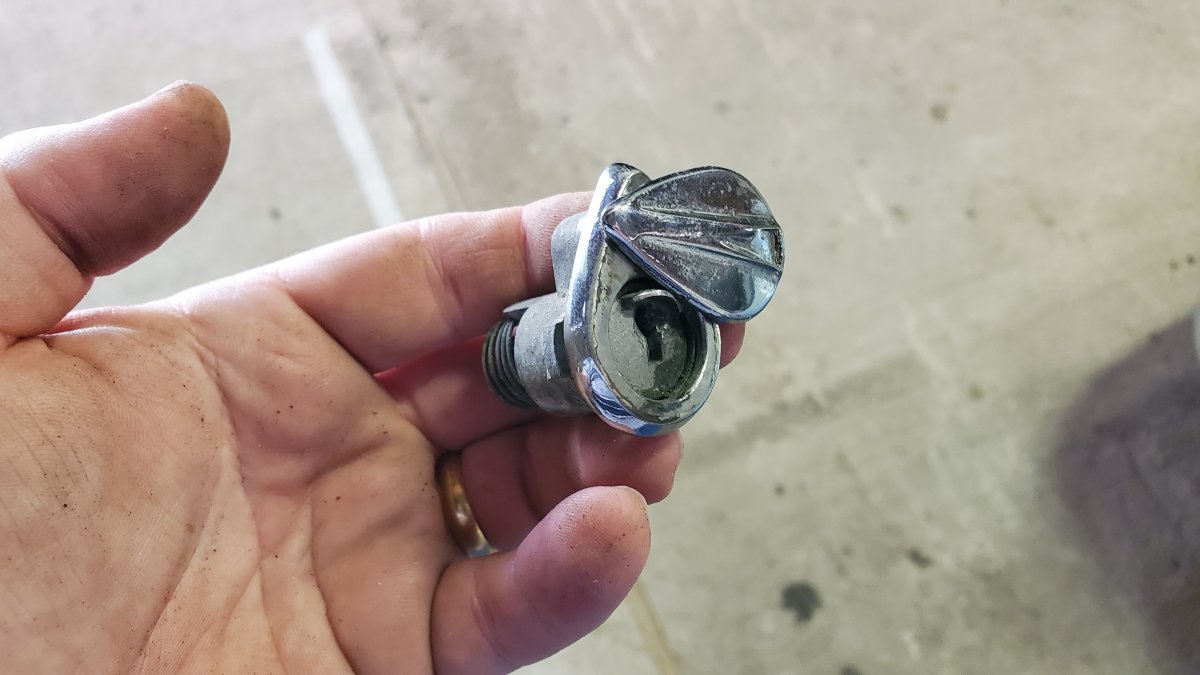

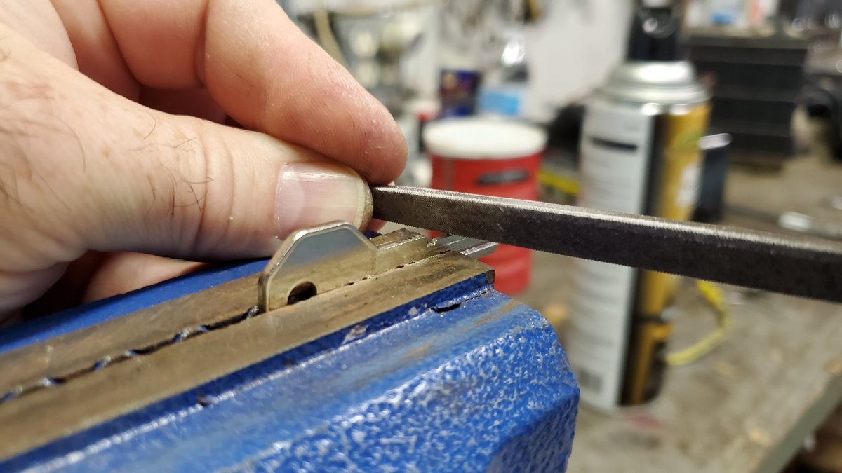

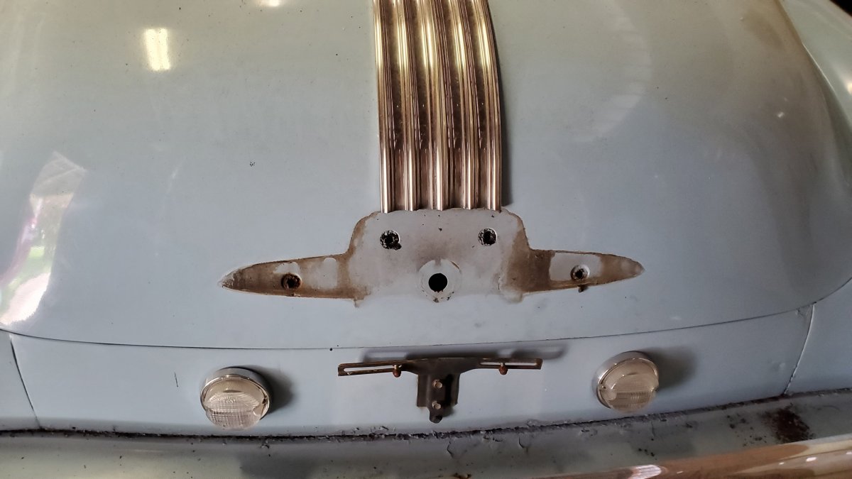

    A while back I had lost the keys to the trunk of this car. Thankfully the trunk was open so I removed the catch and just left it closed by gravity. I got the urge to remedy that today. Went look at lock sets, didn't like the price so decided to see if I could find a cheaper solution.
    I removed the handle from the trunk lid. That's more than whoever repainted the car did... It's only 4 nuts that hold it in place!
    With that removed, I pulled the lock out. I went do a little research on how it works. It's a "side bar", which is meant to be harder to pick- the sliders do not directly lock the barrel. They lock a sprung bar at 90 degrees to their travel. That way, you can't apply a torque to the barrel and "stroke" the sliders to feel where they click past the edge of the locking face. Apparently this design cannot be picked with conventional lock picks.
    I picked it with an old feeler gauge and a paperclip.
    I decoded the barrel by measuring the "unlocked" position with my vernier caliper. I went to the hardware store and bought a key blank. After a little calculation I marked the cut depth on the key.
    Carefully filed it down to profile. Checked operation, lubricated it and re***embled the lot back on to the trunk. I now have a key that opens the trunk and glove box. I'll get a spare cut from it. Total outlay $2, a better price.
    Next up will be pulling one of the door handles off and taking it to the store to find which blank it takes- it's not this one! I think perhaps the door ****ons are newer. We'll see. This was an interesting thing to learn.
    Phil

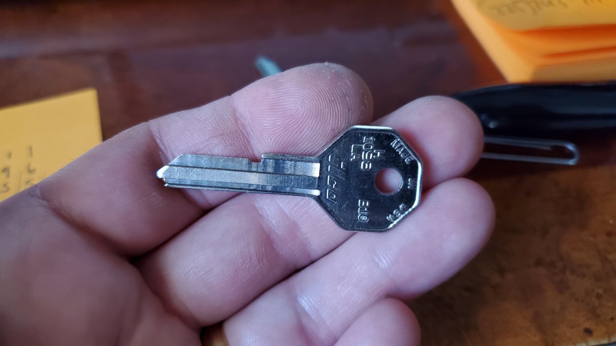

    ...it is this shape key. It fits if you put it in the correct way up.

    The original ignition barrel was gone, as was the key for it. New, the car was supplied with two keys. One did the doors and ignition and the other the trunk and glovebox (so you could lock the glovebox and trunk with your stuff in, give only the door/ignition to the valet so all they could do was drive it and lock the doors).
    When I got the car, it had some auto parts store ignition switch and the original trunk/glovebox key with it.
    I had that set in my pocket with my regular keys, when I pulled my regular keys out in the grocery store parking lot I must've pulled the Pontiac keys with it and dumped them on the floor. Naturally nobody turned them in, they just took them.
    So, I bought a replacement GM ignition barrel, the doors are coded to a key I don't have and I've now made the key that opens the trunk.
    I've got two options right now, one is more viable than the other.
    1: Pull the door lock, pick it, decode and create a key
    2: Pull the door lock, pick it, pull apart and see if I have the correct tumblers to match the ignition key
    Option 1 is the most likely, and that's if I can pick the door locks. They aren't easy. This was the first lock I've ever picked...
    Necessity is the mother of invention.
