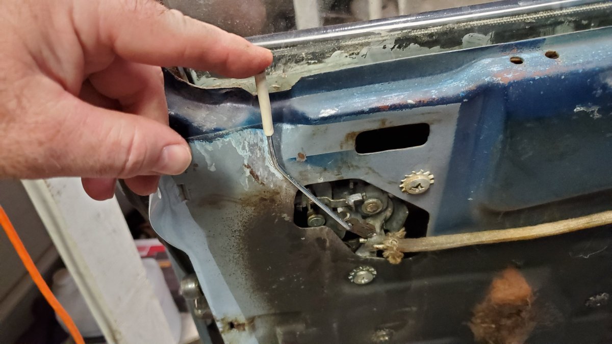

    I pulled the door card off the driver's door. It's horrible. I've been advised to use the dimpled plastic shower sheet from Lowe's-it's the correct thickness, it cuts easily and the damp doesn't affect it.
    I removed the handle and dismantled the lock.
    The lock itself is the same as the trunk. However, I did not have enough combination pieces in common to key either alike so I'll just have 3 keys.
    Cut a key to fit the lock, re***embled it but need a new rubber o-ring to space the position of the ****on correctly for the lock to engage.
    I'll pull the p***enger side door card off too, I need to remove the rod for the lock pin and copy it. The driver's side one is missing.
    P***enger side jams, needs lubrication but it does lock. Driver's side clunks nicely locked.
    Net result is I have a full set of working keys for all the locks on the car now. That makes me happier than I was. Total outlay $9.

    I was wrong. I squeezed in half an hour tonight. Went raid the closet for a plastic coat hanger with a metal hanging hook because to my calibrated eyeball it looked about the right diameter and length to make a lock pin rod.
    So I heated and bent it up into shape.
    Stripped a piece of wire insulation and shoved it over the end to bring the diameter up a bit.
    Cleaned up the pin and pushed it on. Unlocked...
    ...and locked.
    I need to glue the plastic to the rod to stop it shifting but that'll work.

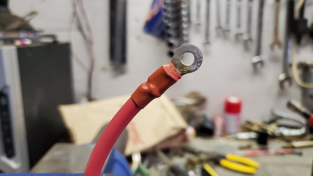

    Today was a crimp,
    solder,
    insulate kind of day.
    Phil

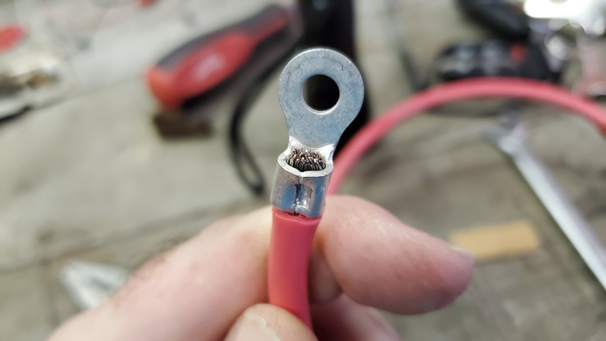

    Alrighty. Barring the wire for the under-hood lamp and the ignition run correctly to the switch, the wiring in the car is done.
    I made a short hoop of 10ga wire and bridged the terminals of the Ammeter.
    Now, the current load will be roughly half and half across the wire and Ammeter. It's a (roughly) 40A meter and the alternator is capable of putting out 63A- all of which theoretically could be absorbed by a dead battery so now that had turned the gauge into being able to read 80A (or thereabouts).
    I left the lights and fan on for 5 minutes then started the engine and brought the RPM up with the lights and fan off. It moved to read about half deflection to CHG which makes me a lot happier, before it would peg it off the end of the scale. With everything switched on it shows about half deflection to DIS so that's still useable. I do have the no-charge light too which glows when the needle is in the DIS portion of the gauge.
    That makes me happier that I'm not going to have a red-hot Ammeter.
    8ga now for the parts of wire that will carry over 20A on a regular basis (not a lot of it) so I am good with that. Lights, fan, radio all on is about 30 Amps total so that works for me.

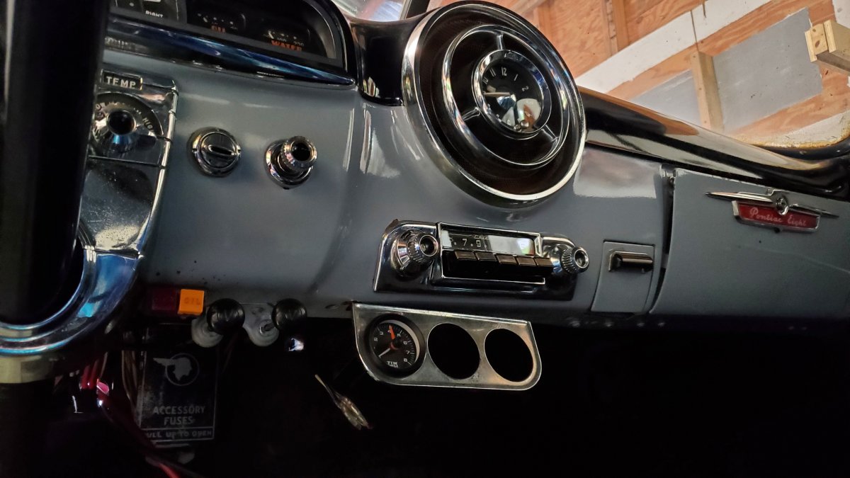

    Calling that good enough. Put the radio back in too.
    Last thing for the cabin will be to get a new piece of air hose for the p***enger side defog and put the glove box back in.
    Tach below the radio is temporary.
    Phil

    There we go. I'm happy with that.

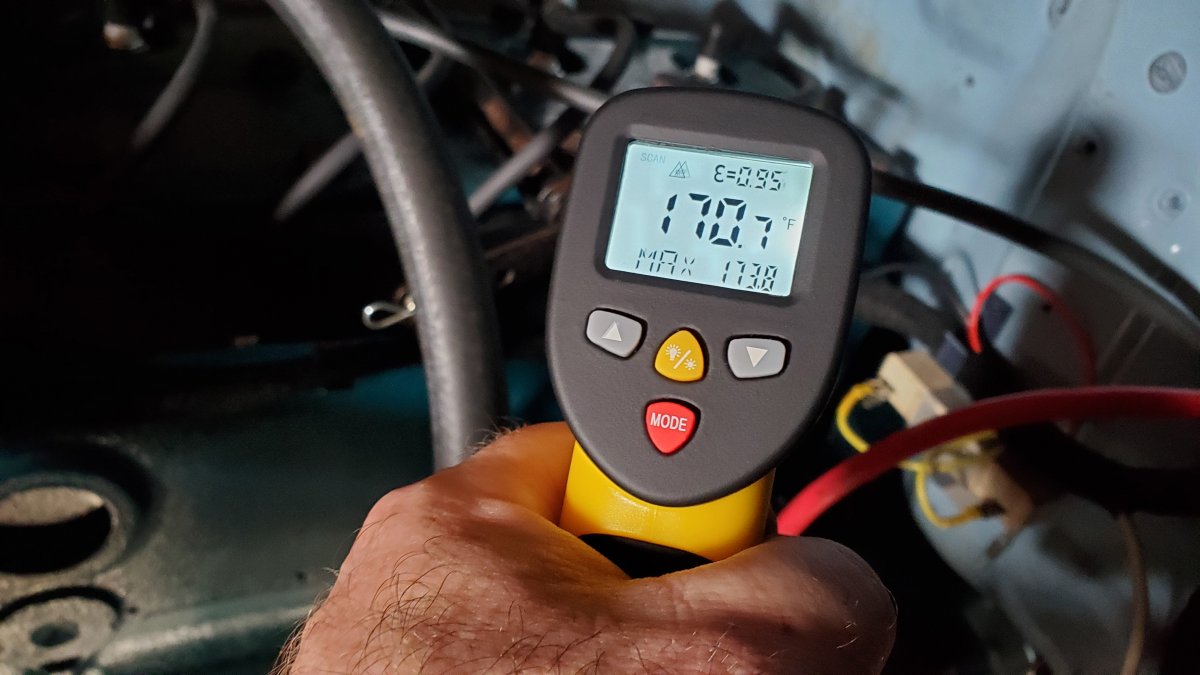

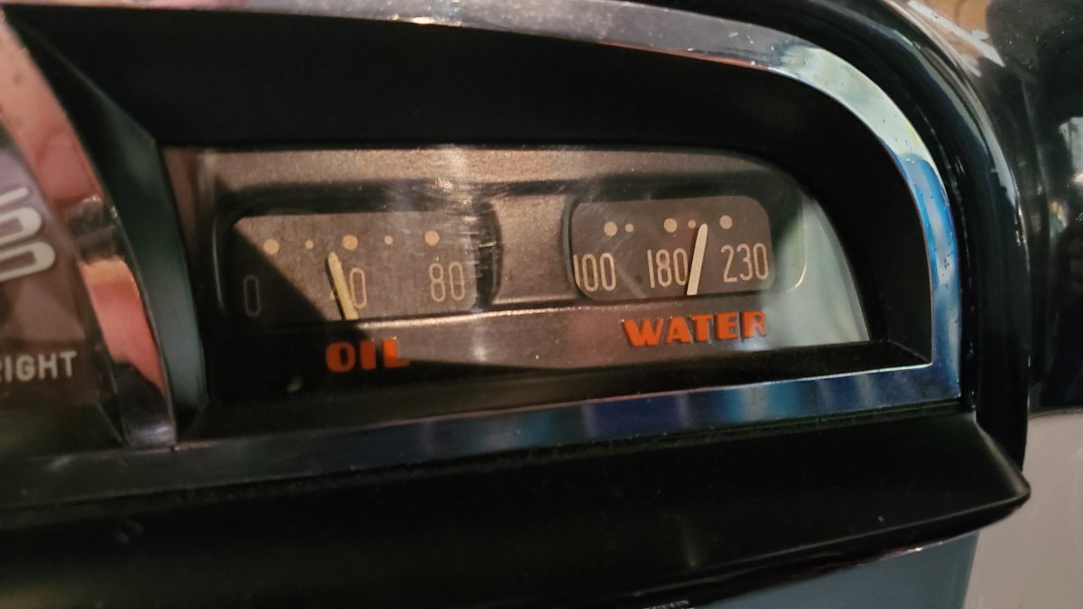

    Sat with the car idling and the temp gauge went up a fair bit, higher than I was happy with.
    Revving the engine up a bit to get flow and fan going didn't do much.
    Went grab my IR thermometer. Head, block, radiator all within 3 degrees of each other. So the gauge is over-reading. I can deal with that, moreover I can fix it.
    I calibrated it at about 12 Volts- now it is charging right it reads too high. Voltage regulator time!

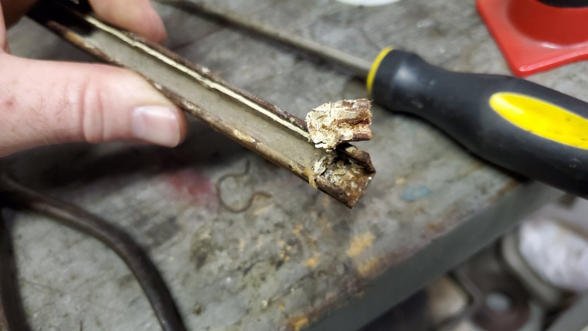

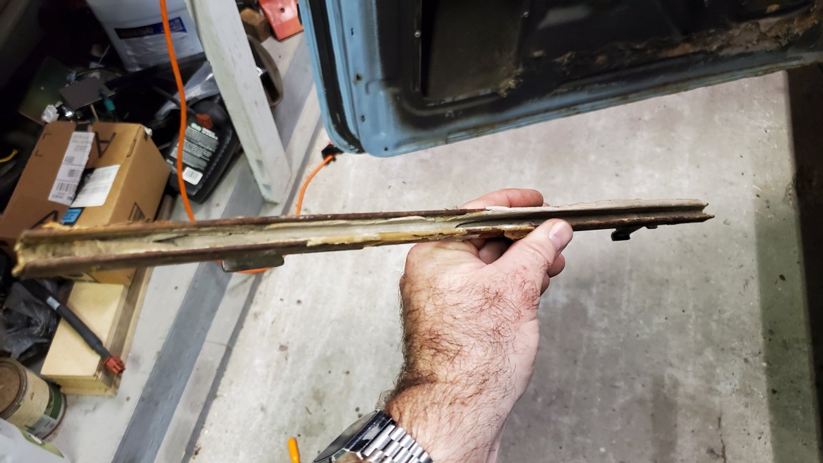

    Oh boy.
    I just pulled this out of the driver's side door.
    Yup, someone has attempted to use window putty to hold this gl*** in.
    Started to pick it out but it was getting a little late and hot in the garage so gave up for tonight.
    The front window channel is gone. That's why the gl*** is broken on this side.
    *sigh*
    All good fun and games. I think. The channel is also not screwed in, the window runner is seemingly still attached at the bottom which is a start. From what I can see the correct rubber grip is still available to hold the gl*** into the sash channel but the channels themselves aren't in the door correctly. I think I need to get the gl*** out, channels out and try start over from scratch on this door.
