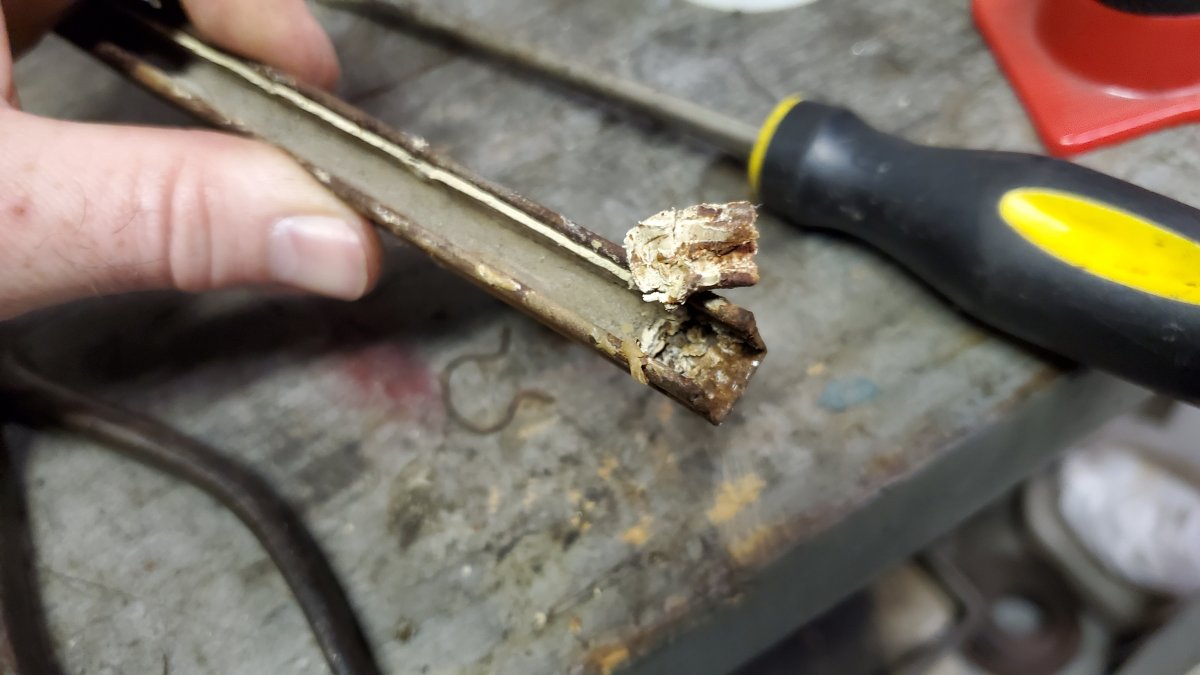

    I use windshield urethane Phil. Run about a 5/16 bead in the sash channel. Sometimes I put the channel on the gl*** when it's out of the door, sometimes I put the gl*** in the run channel and slide it to the top, run a piece of tape over the top to hold the gl*** up, then roll the sash up onto the gl*** and let it set overnight. But a tube of urethane will easily do all of the doors and it's affordable.

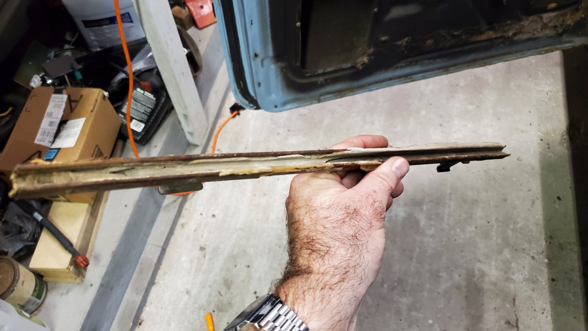

    I was thinking about that but the proper rubber U-section is available for it, so I'm going to do that. Before then though I need to find the front gl*** channel; without that the gl*** cannot go up and down and stay in line and not break again.

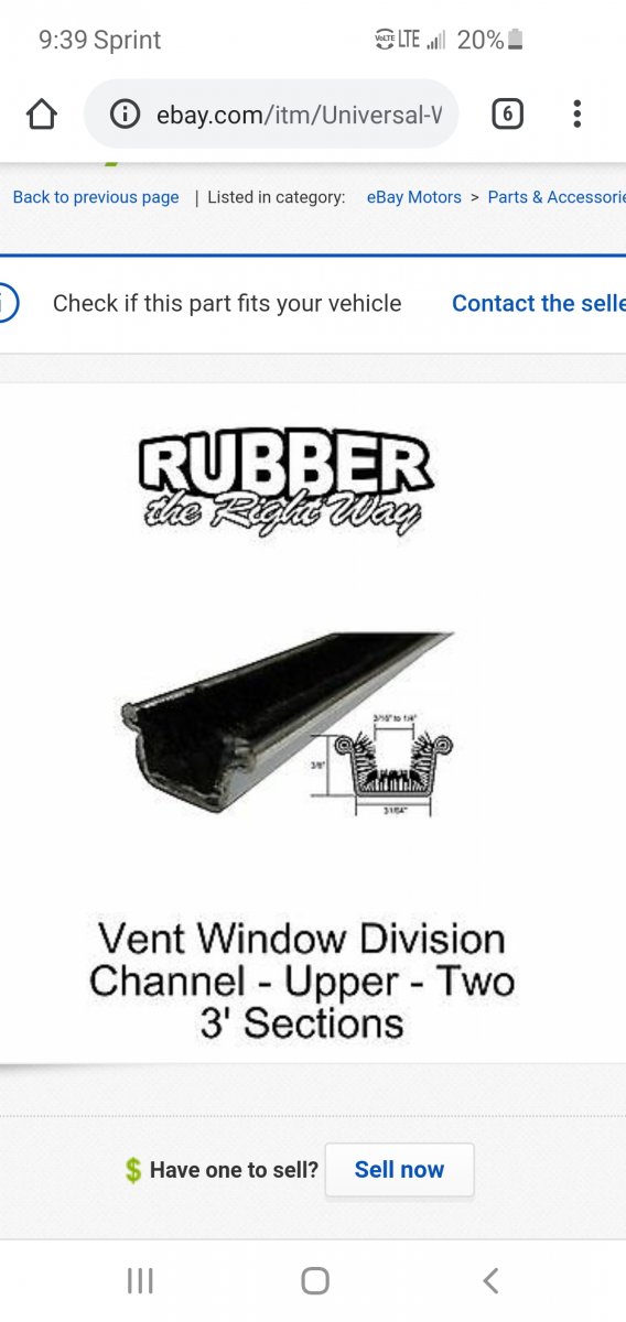

  6. Lloyd's paint & glass
    Joined: Nov 16, 2019
    Posts: 10,882
    I've used urethane, and I've used 1/8" rivets.
    loudbang and PhilA like this.
  7. PhilA
    Joined: Sep 6, 2018
    Posts: 2,107
    PhilA
    Found the stuff
    On my shopping list. I think it's correct, shall double check but it looks right.
    Phil

    Probably not, I need the full runner section from top to bottom. I'll grab this and try fit it. I need to figure out what's wrong with the rear channel too. It's buckled in the middle.

    Phil, a little heat on that window putty should soften it up so it will come out easier.

    Fire and wire wheels later, it's now painted. Straightened it out too, where one edge had become bent down because the window channel is gone.

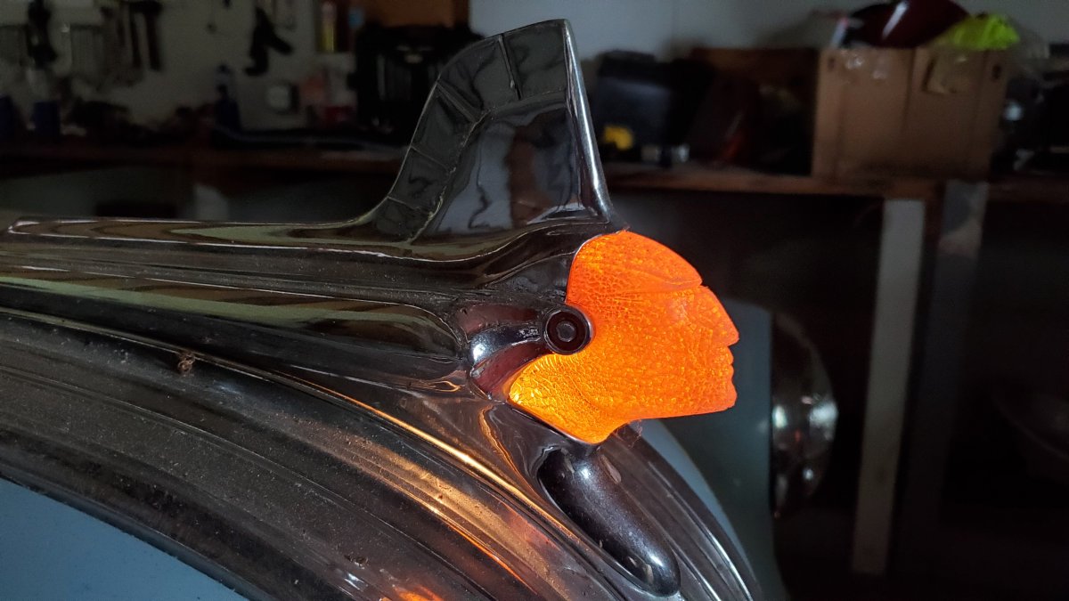

  13. PhilA
    Joined: Sep 6, 2018
    Posts: 2,107
    PhilA
    Nothing really happened today because it was too hot.
    So, have a Chief as consolation. There's a nice insert that's not all crazed on that there bidding site right now, $219.
    I am quite happy to pull him out, store him safely with the rest of the bits from the car and put a reproduction one in for less than half that price.
    Would be nice to have him not look like Clint in G, B & U.
    Phil

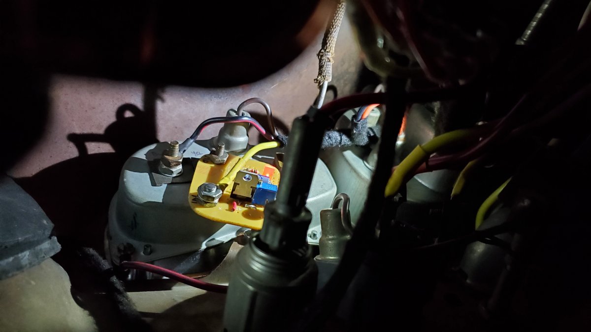

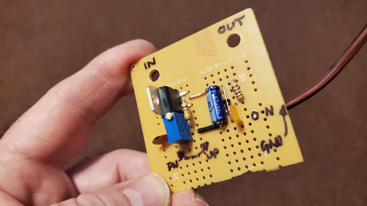

    I built this little doohickey to put on the back of the temperature gauge. Forgot I had the parts to make it on the shelf.
    This will keep the voltage stable (or rather what it does is gives a ceiling maximum the voltage is allowed to go up to, adjustable) so the temperature gauge won't over-read when the engine is running.
    (Would also work to run 6V gauges on a 12V converted vehicle, it's a versatile doohickey).
    Phil
    Woogeroo, bchctybob, brEad and 4 others like this.

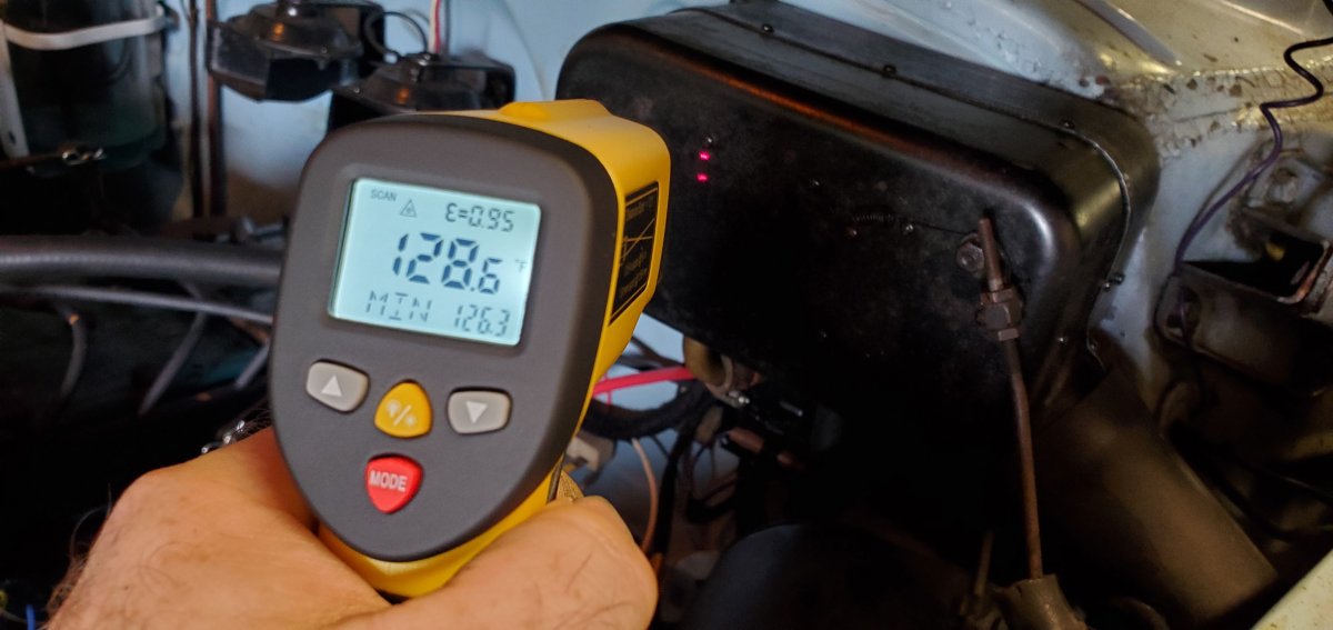

  15. PhilA
    Joined: Sep 6, 2018
    Posts: 2,107
    PhilA

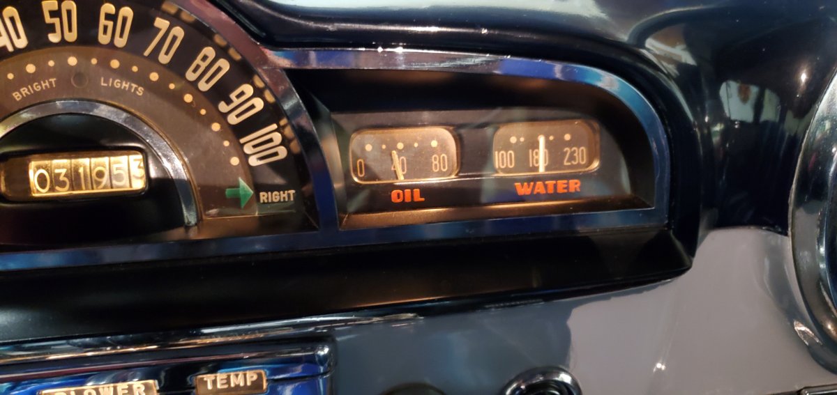

    Installed board.
    Ran up to temperature.
    Adjusted gauge.
    That's better.
    Phil

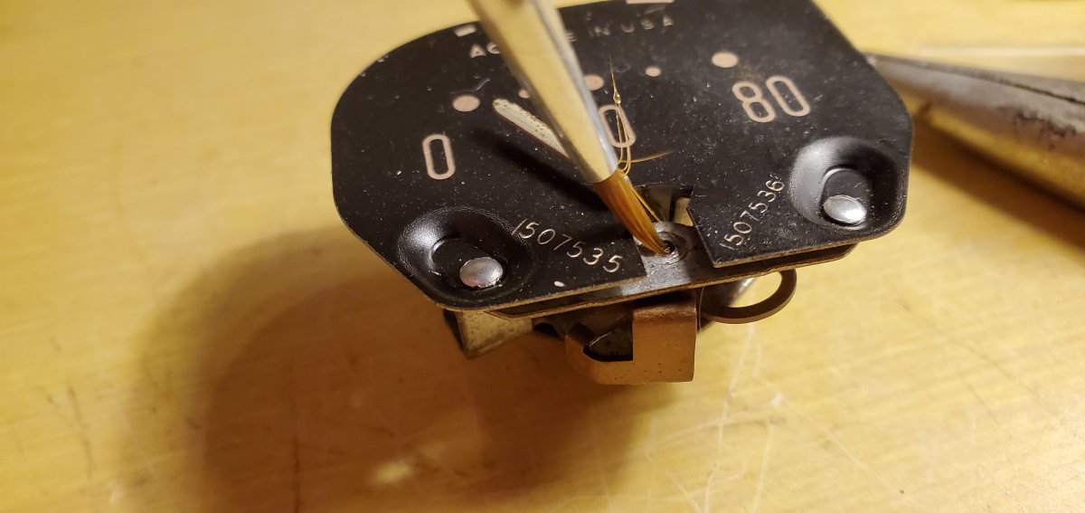

    Patience like taking the gauges apart, adjusting the alignment of the clockwork, testing and re***embly?
    Found why the temperature gauge was getting stuck. Undone it worked fine, tightened into the bucket twisted it slightly, so I tweaked the alignment of the armature and now it moves freely.
    Phil
    Woogeroo, brEad, loudbang and 2 others like this.
  19. PhilA
    Joined: Sep 6, 2018
    Posts: 2,107
    PhilA
    There we go. Doesn't get stuck in the middle now.
    Phil

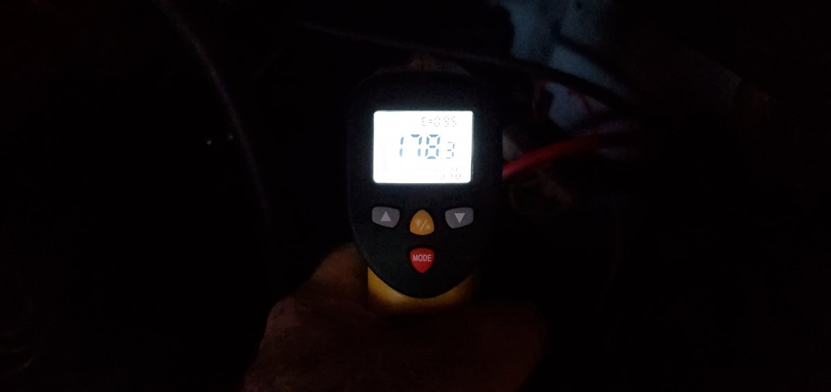

  20. PhilA
    Joined: Sep 6, 2018
    Posts: 2,107
    PhilA

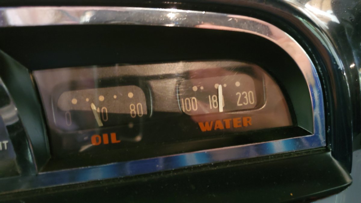

    Re***embled it all.
    Idle idle idle
    Normal running temperature.
    Bang on the money. Now I'm hot, the car makes the garage like a furnace and stinky even with the big fan running. But, it's all back together and it works. Hopefully that's the last time for a while I have to do that.
    Phil

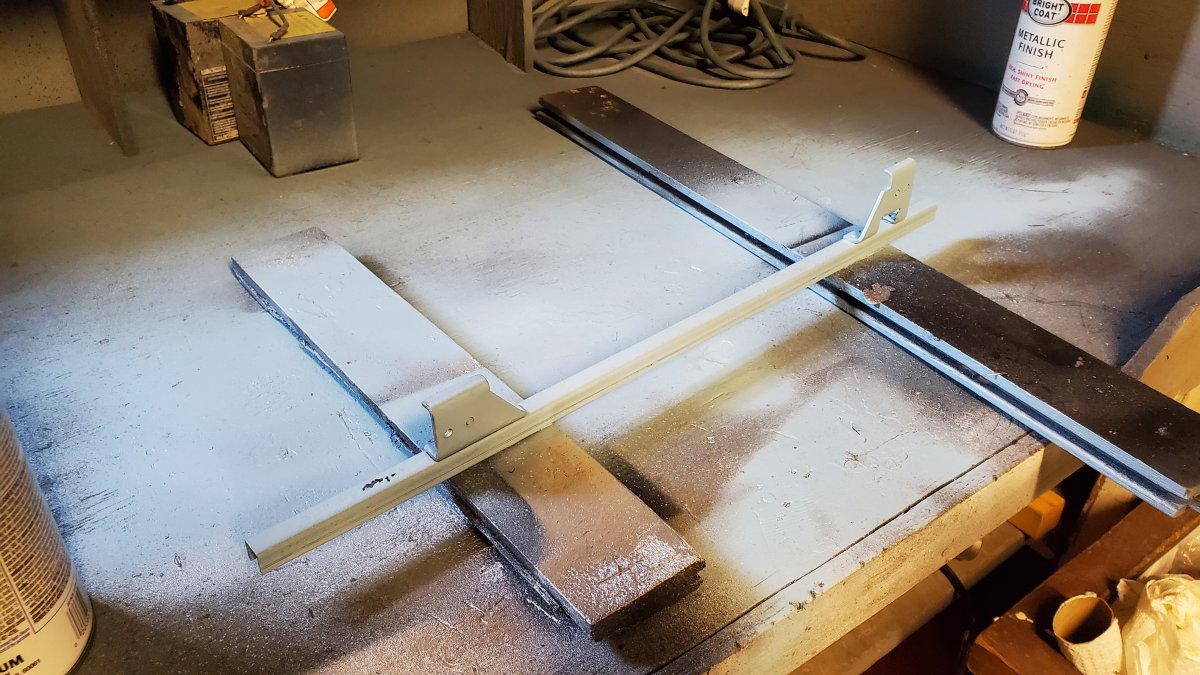

  28. PhilA
    Joined: Sep 6, 2018
    Posts: 2,107
    PhilA
    No sooner do I say pause, and a few things fall into place. So, a few things occurred.
    I finagled the screen defrost to lower heater pipe back into place.
    I made a lower heater return pipe.
    Fire was used in a constructive manner.
    A dual pipe clamp is in the making.
    More to come.
    Phil
  29. PhilA
    Joined: Sep 6, 2018
    Posts: 2,107
    PhilA

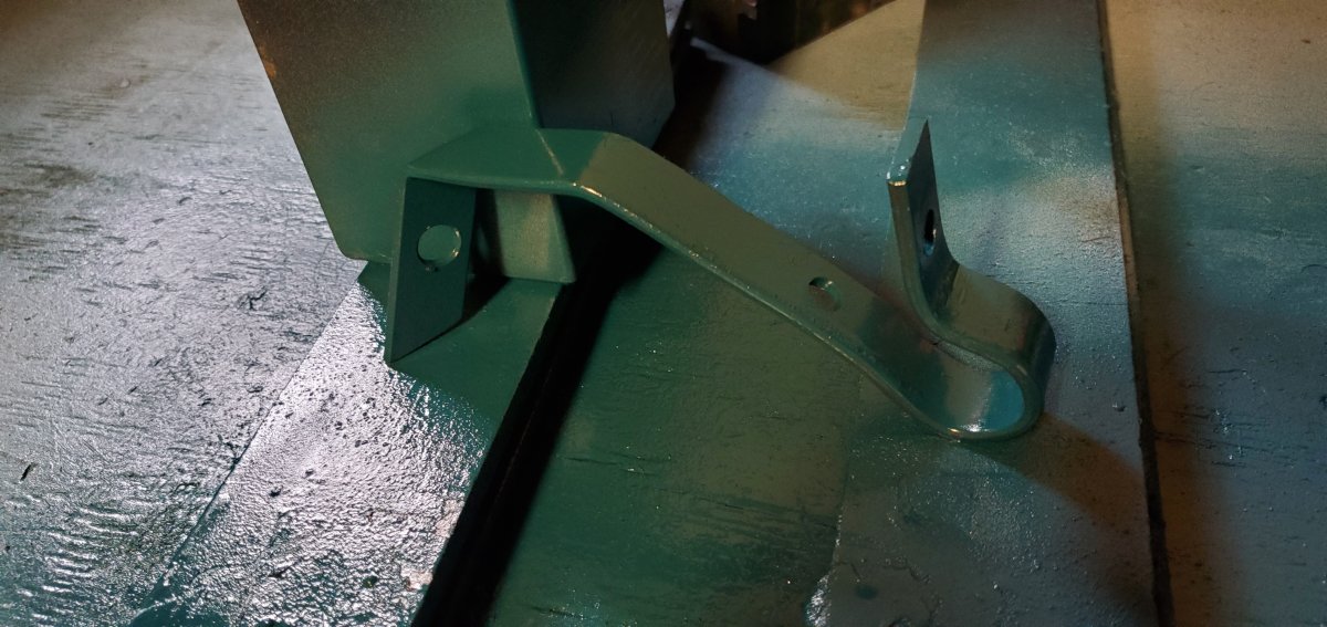

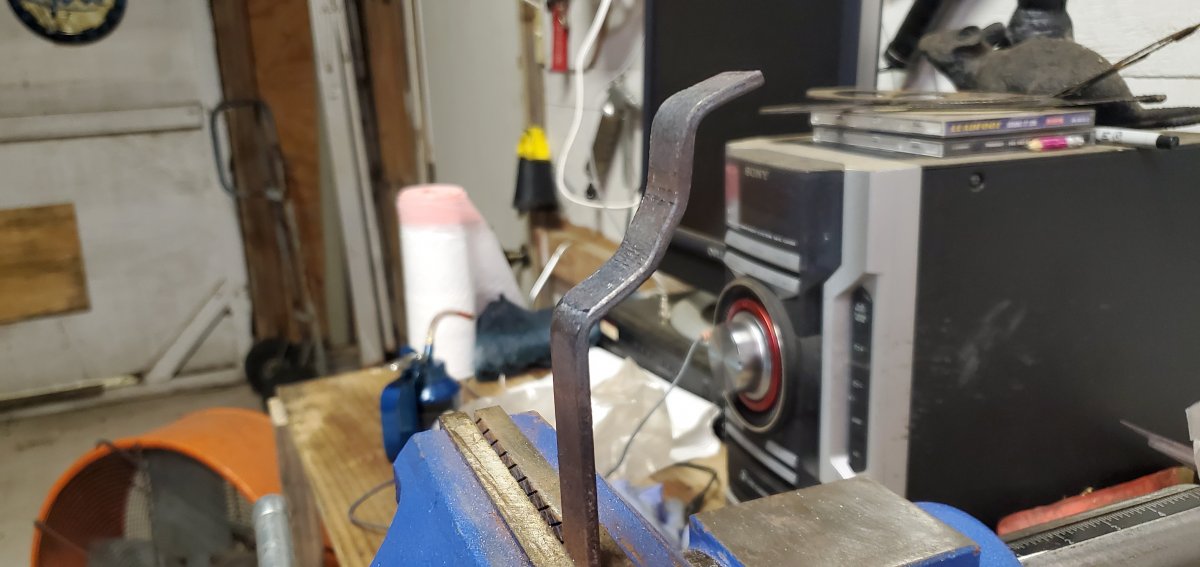

    Completed that bracket and used it to clamp the pipes to the ch***is where they go through it, prevents them from rattling.
  30. PhilA
    Joined: Sep 6, 2018
    Posts: 2,107
    PhilA
    More fire, more metal.
    Created another bracket. Fairly simple affair but the long metal pipe had no support other than being attached at either end to the radiator and the heater lower pipe.
    This gives it a little more support about 2/3 the way along its length. Bolted in through one of the old battery tray bolt holes.
    Filled the cooling system back up and started the engine. Everything got nice and warm, the defrost and under seat heater; the valve functions as expected.
    One more thing off the list.
