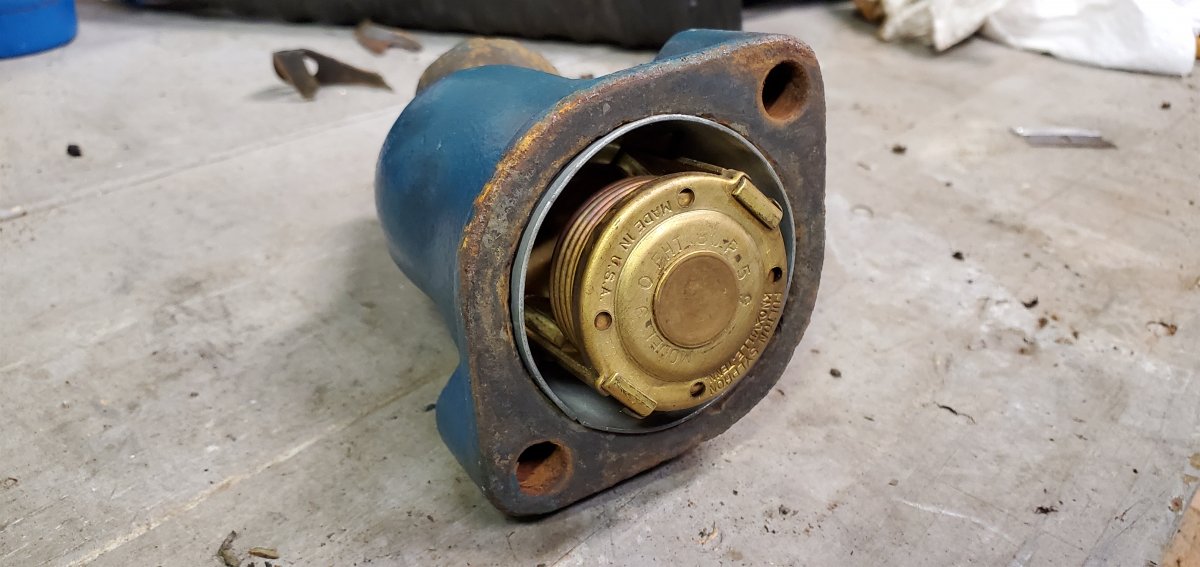

    Next up I need to find a thermostat to fit. I had a looksee and some larger diesel engines use a similar device to what was originally fitted- a big cage style thermostat that fits up into the housing.
    There are adapter plates that allow a regular waxstat thermostat to be fitted but I am not sure if those will flow adequately, particularly at highway speeds and also stuck idling in traffic.
    I think I will drain down and bring the housing to the parts place and see if they have anything that fits.
    Then, I am gonna flush it out because it's been sitting with straight water in and there's a lot of rusty sediment, before filling back up with proper antifreeze with corrosion inhibitors in.
    Phil
  2. PhilA
    Joined: Sep 6, 2018
    Posts: 2,107
    PhilA
    Just spoke to Kurt Kelsey in Iowa, and he's got me the correct thermostat, which should be here soon.
    Saves trying to hack something to fit because it's a very non-standard design hosting compared to what I'm used to.
  3. PhilA
    Joined: Sep 6, 2018
    Posts: 2,107
    PhilA
    Thermostat arrived today, well ahead of schedule.
    Nice new old stock parts.
    Strange contraption.
    All pushed together to form an ***embly.
    Cut a new gasket, applied a little sealant and bolted it all together, filled it up and ran it to temperature. Opens up at 180 and holds at about 190; heater blows red hot. Happy with that.

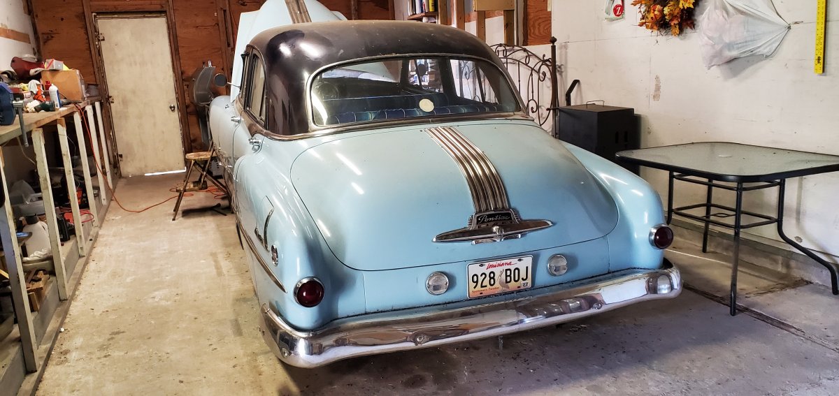

    Today, rain. So, before it got too hot I decided to put in a little "free" garage time.
    Previous owner decided to polish the chrome with a wire wheel. Naturally the best choice for a good finish.
    They've gone through to the nickel in a lot of places but I had a go at buffing it out. Looks a little bit better.
    It also has a very large number of nooks and crannies. Small buffing wheel broken out to try and get into the corners better.
    Plenty more to do, but it got too warm even with the big drum fan running. Improvement there, at least. Need to put all the screws back in the grille, it's only held on with a couple right now.
    Phil

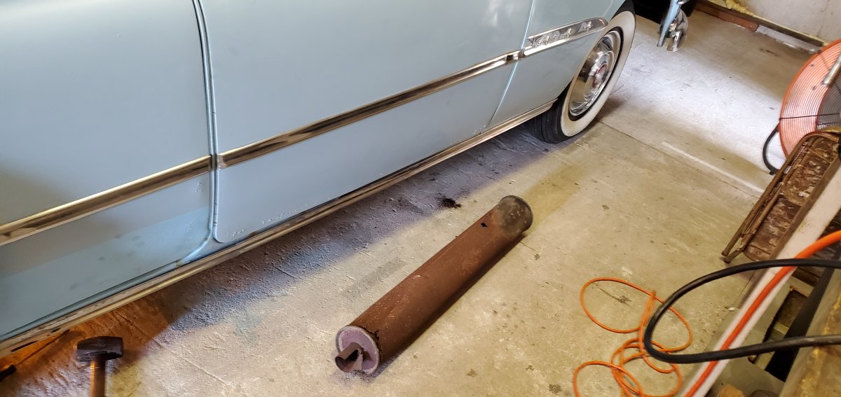

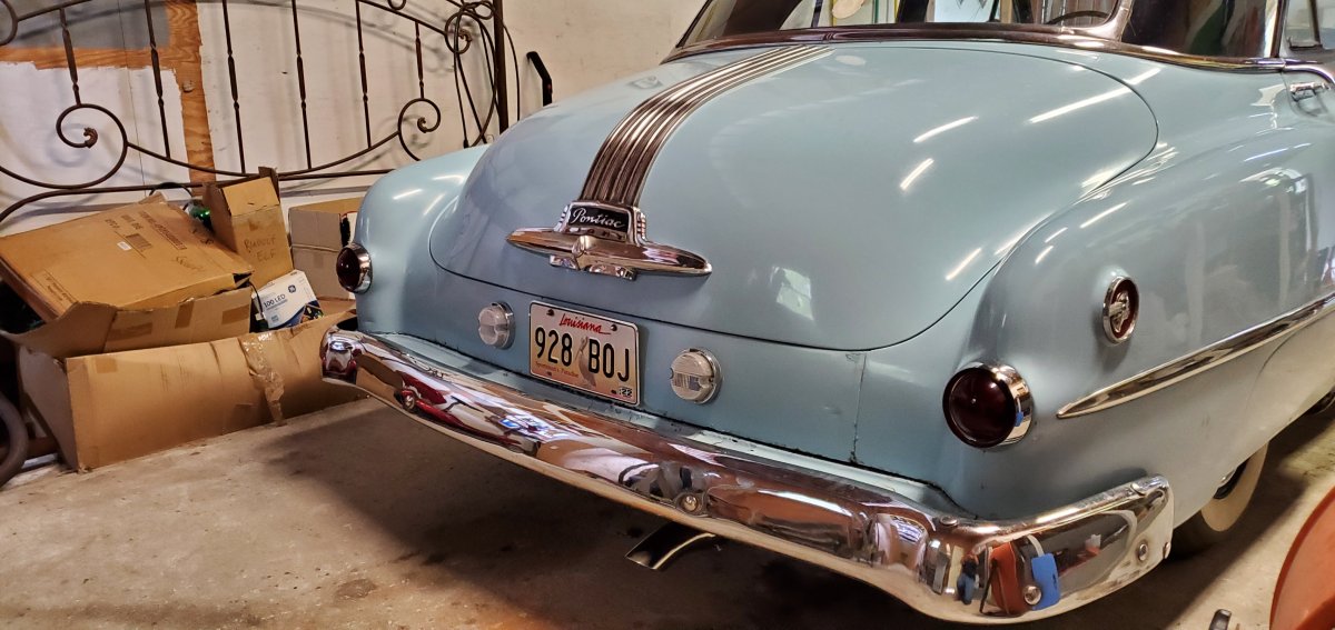

    Tonight's task- remove old muffler, which was full of holes and just plain junk.
    Did the right thing.
    That'll do. Need to rebuild the rest of the system, going 2¼" all the way back instead of 1⅞".
    Phil
  14. PhilA
    Joined: Sep 6, 2018
    Posts: 2,107
    PhilA
    Slight change of plan, going 2" all the way back which is fine because that's the size from the manifold from the factory.
    I found a place that does mandrel bending not too far from here (25 minute drive) so they have the old pipe and are going to copy it, mostly. I asked for a joint in the back so I can actually get it over the axle. The stock design would come out if it wasn't on lowering blocks...
  15. PhilA
    Joined: Sep 6, 2018
    Posts: 2,107
    PhilA

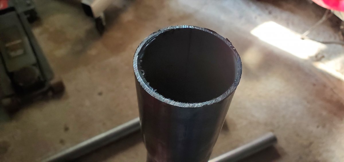

    Change of plan back! They found some 2 1/4" offcuts that were long enough and bent them up to fit.
    Surprisingly good tube, too. I was expecting really thin stuff. All done by a Napa not too far from here for $55 including 3 clamps for it. It needed to be in 3 pieces to be able to get up over the axle. That was my request.
    There we go, all in nice and snug.
    Still cold there, sounds nice. Has a decent b*** note to it also with no drone. Going to finish it off with a chrome turn down tip.

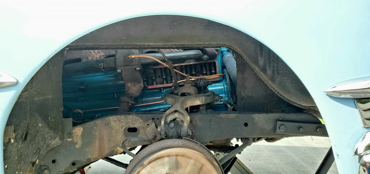

    Today the weather turned pleasant after work so I did something I've been putting off- namely getting burned hands!
    The car ***umed the position, I pulled the wheel off and got cracking after driving it up and down the street a little to get it up to temperature.
    Required tools gathered (3x 9/16" wrenches, a 1/2" wrench and an 11-13 thou' go-no-go feeler).
    Access could be worse, I guess.
    Most of the valves were too tight, the rest were too loose. One was just right. Got them all set now and it's got that proper note back again to the exhaust. Pops and sneezes a little because I was getting fuel vapor lock from it idling so long and getting heat soak into the fuel line where it runs under the oil pan.
    Really smooth to drive now, glad I did it. Nursing a few burns between my thumb and index finger on both hands, which appears to be par for the course doing this job.
