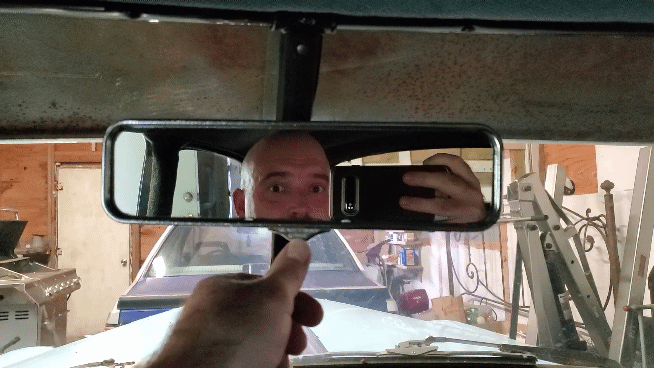

    New wing mirrors, to replace the broken ones.
    Phil

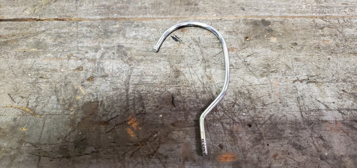

    Tonight started with a coat hanger stolen from the wardrobe.
    Liberated the nice chromed pot metal wire.
    Using the other side as a template, it was bent to shape.
    Why? That on the left was the p***enger side lock pin. Floppy and useless, plus it was causing the mechanism to get all hung up.
    Slotted the new one in place, put the door frame back on and now it locks with a smooth clunk. Enough for today.
    Phil

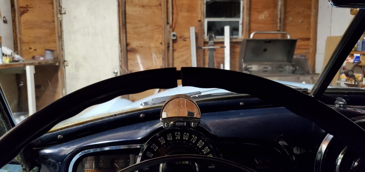

    I got inspired by Chrysler's electroluminescent dashboards of the late fifties tonight.
    So now, we are leaving the jet age and entering the space-age with turquoise.
    Still waiting on brakes.
    Phil
