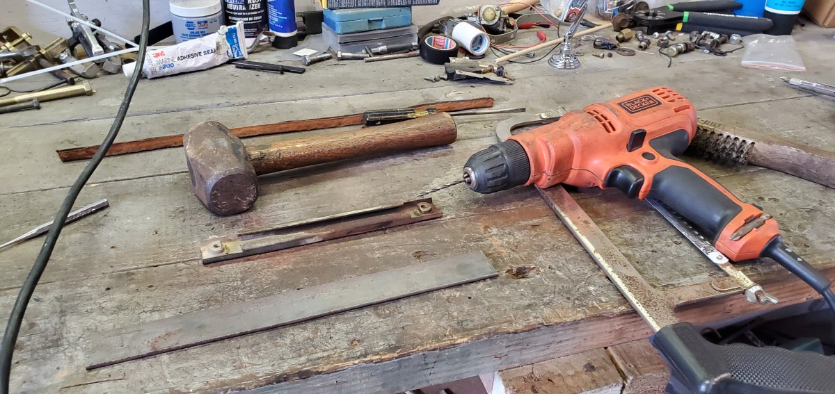

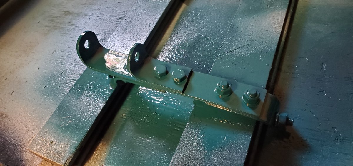

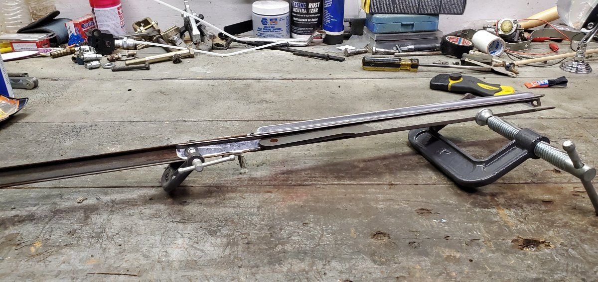

    Little bit of improvisation tonight.
    The window mechanism would fall off the runner because the lower stop is missing.
    I made a piece of metal to fit in the runner and prevent the arm going too far.
    It's held in place by the bolt and stopped from falling off by a longer screw with a nut on.
    Now the window winds all the way down and doesn't get stuck!
    One thing off the list, I can put the door card back on now.

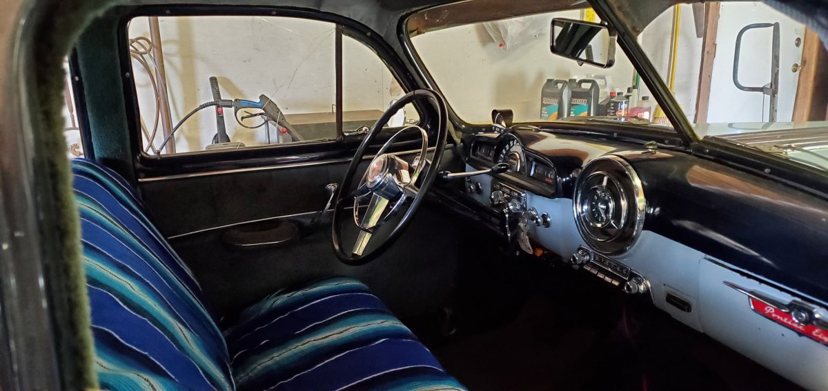

    That's as good as it gets.
    The gl*** rolls up and down remarkably well considering that pane is broken; the spring ***ist works nicely, it takes more effort to put the gl*** down than it does up, which means it should keep itself closed on the road.
    Quarterlight opens, closes and latches.
    Door latches on both positions.
    Lock works.
    First time all the functions of that door have worked since I got the car.
    Phil

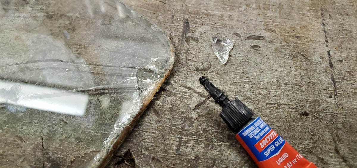

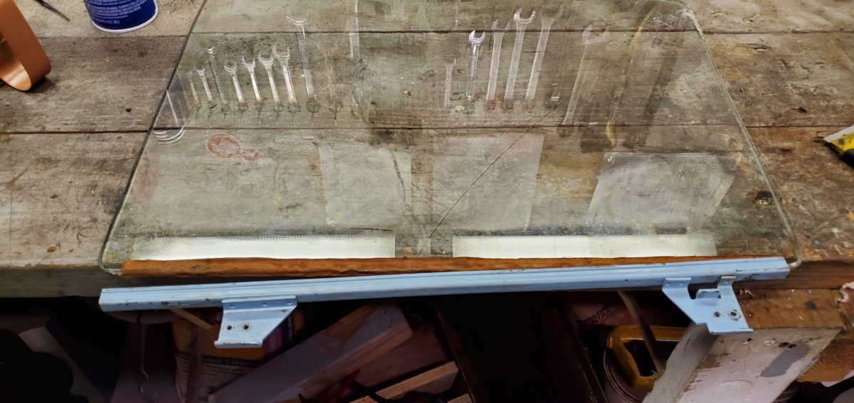

    Tonight I decided to address the driver's door gl***. First, a new chunk had fallen out of where it broke. Glued that back in, for what it's worth.
    I found a spare rubber sash grip in a very rusted sash channel in the bottom of the rear p***enger door. Cleaned it up and fitted it to the gl***, then knocked the sash channel on. That gripped nicely.
    Typically this is a replacement gl***, it's etched 2004 and whoever cut it wasn't overly proficient in the art of cutting gl***.
    I cut a length of sheet steel with an L bend in, to fit over the section of channel where the clips are, which are what caught the gl*** and fractured it. Applied some polyurethane sealant to the back edge.
    Clamped that all up and left it to set overnight.
    Phil

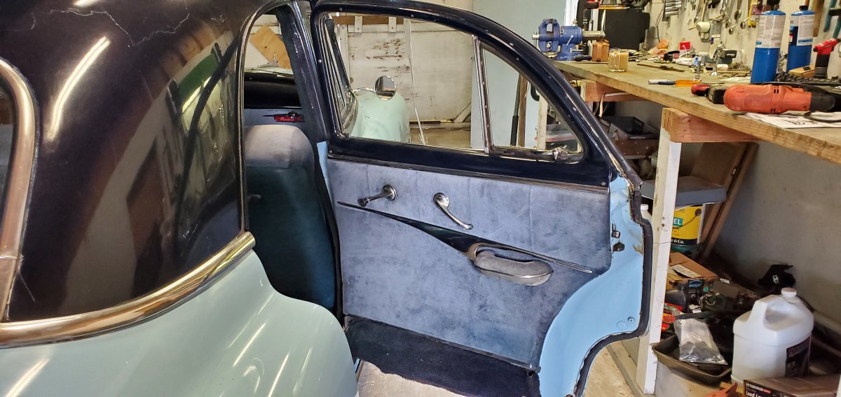

    Got the door card on, handles and window trim. The door closes with a nice clunk now.
    Today, some firsts- first time all the doors work properly, all windows operational and locks work. I just locked the car with the key, and it's now as secure as it gets.
