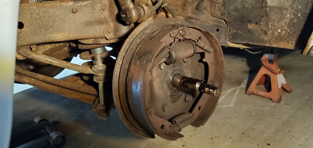

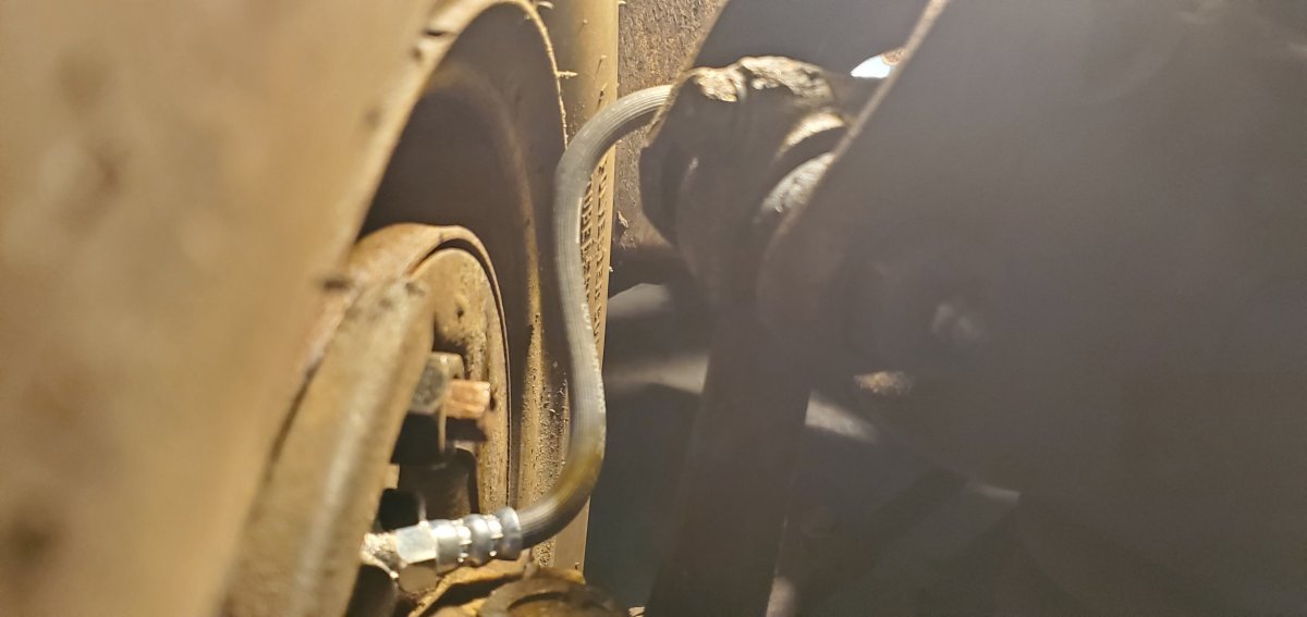

    Not many pictures tonight because this is dirty work.
    Put the car back up on stands. Pulled the front p***enger brake off.
    Removed the old flexi pipe, cylinder. Removing the cylinder showed it had been leaking too.
    New hoses checked; they don't catch on the wheel at any steering position on full droop. I'll check again on full bump when it's down on its wheels. There's a bit of adjustment available.

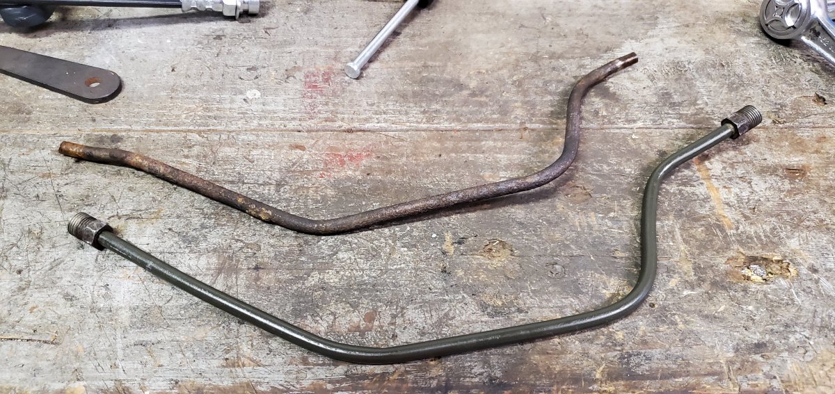

  14. PhilA
    Joined: Sep 6, 2018
    Posts: 2,107
    PhilA

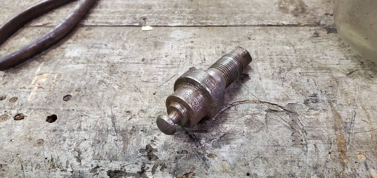

    Old. Faulty. Missing parts.
    New, greased, all good.
    Need some 1/4" brake line and a flaring tool, then.
    This was "all new" in 2015, according to the advert...
    Phil

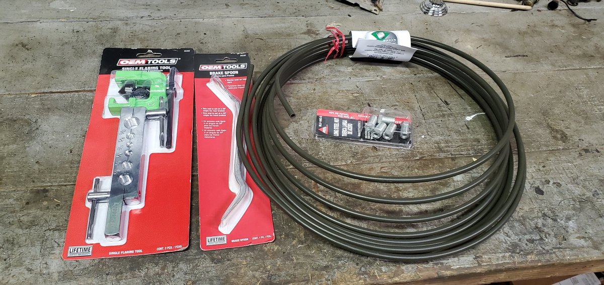

  17. PhilA
    Joined: Sep 6, 2018
    Posts: 2,107
    PhilA

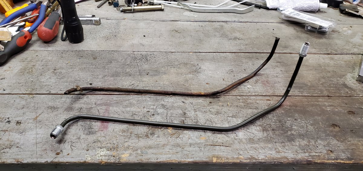

    Went shopping. Ready for tomorrow.
    Brake line to front right looks pretty new.
    Front left.. ropey. To the rear, also ropey. Should have enough on the spool to redo to the back.
    Phil

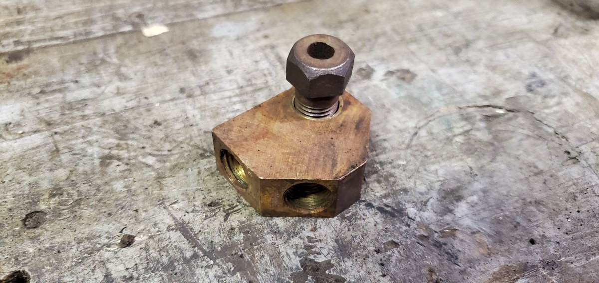

  21. PhilA
    Joined: Sep 6, 2018
    Posts: 2,107
    PhilA
    "New".
    ... I don't think so.
    David Gersic and loudbang like this.

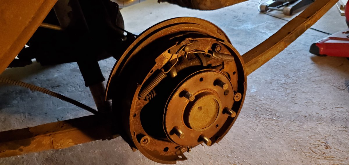

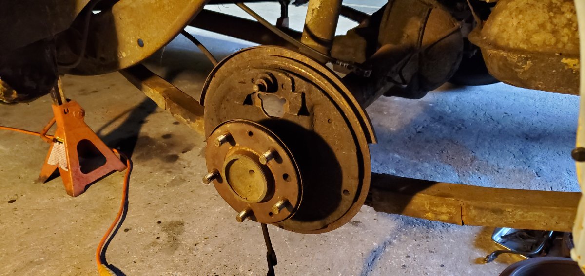

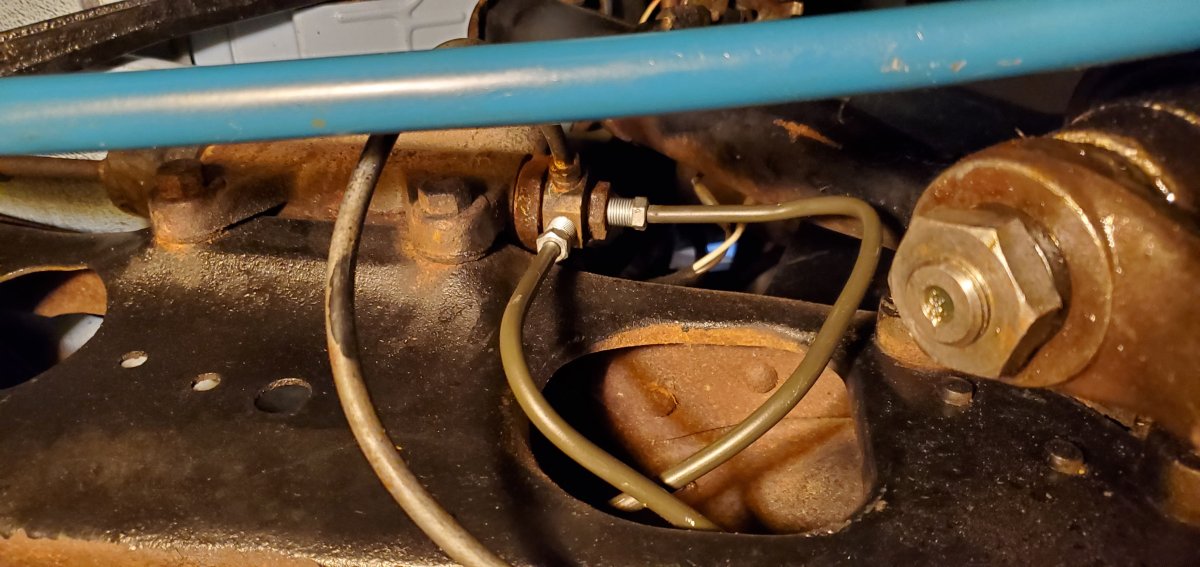

    Still, got the car jacked up, the front to rear line put in, front left pipe done.
    Looks a bit better coming off the master cylinder now.
    I cleaned up the rear tee block, that was just a wad of gunge with a few pipes coming out.
    Made up a new pipe for the rear left wheel.
    Got the wheel off. The shoes didn't look that old but they were falling apart, the top bias adjuster took a good leg-heave on a 8' breaker bar to free off.
    Cleaned it up, greased it and now it rotates correctly.
    Got the lot stripped down to the backplate, re***embled it all and forgot to take a picture before putting the drum and wheel back on.
    Rear right is left to do. I'll call California Pontiac Restoration on Monday and see if they have an expected due date for the right rear cylinder.
    That's definitely enough for today. I hate brakes.

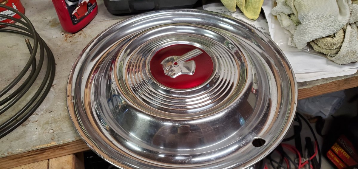

    Just to say I did something today, I cleaned my hubcaps.
    Grubby, and I hadn't polished the red after painting it.
    They're old and hazy but at least now they're clean, and the red has a bit of a sheen to it.
