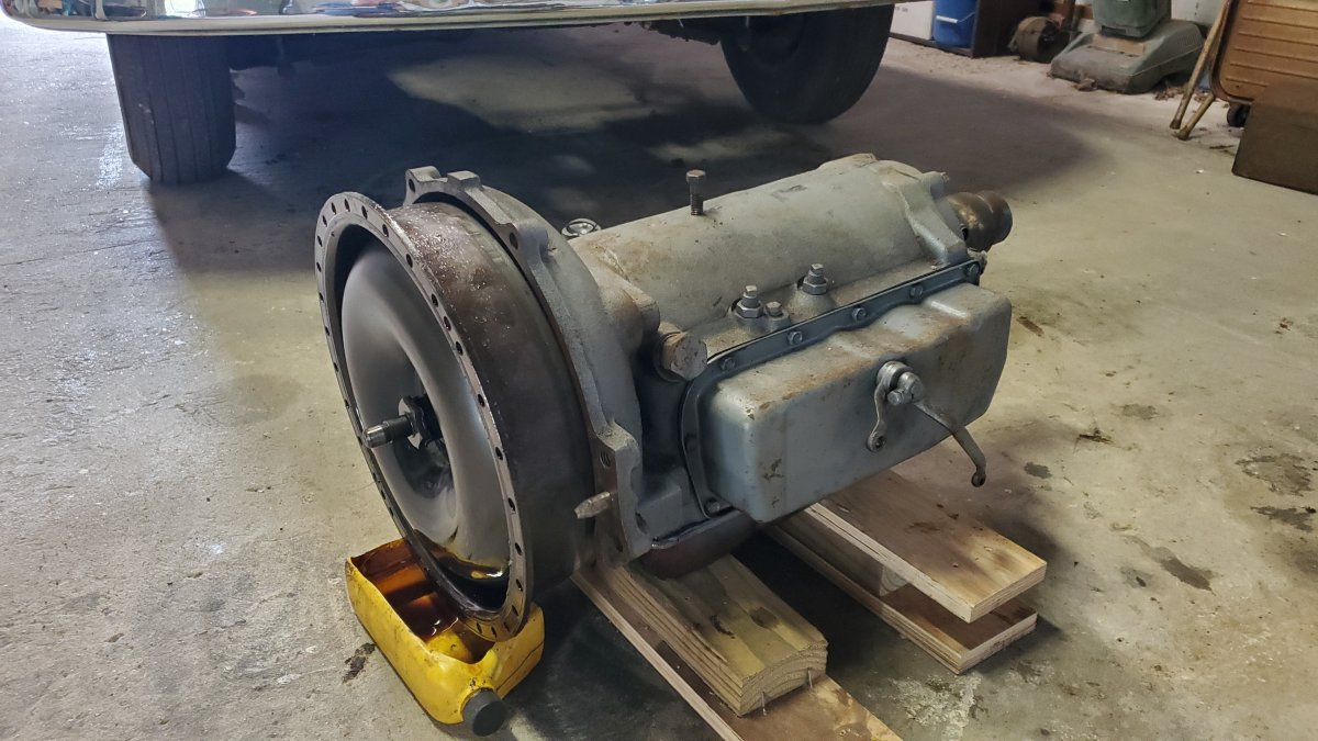

    There are 30 bolts around the periphery of the housing. You have to rotate the engine and gearbox together to access all the bolts around the periphery.
    If you cannot get the drain plug out (mine was stuck fast) then expect a lot of fluid to come out between the flywheel and torus when you split it open.
    The i-8 engine comes from an era before the art of thin-wall casting had been perfected. This gearbox is the same and is a heavy old beast. Note the bolt in the top? That's the lifting point, usually just a threaded hole. I used my engine crane to lift the gearbox out- my guess is about 300-320 lbs.

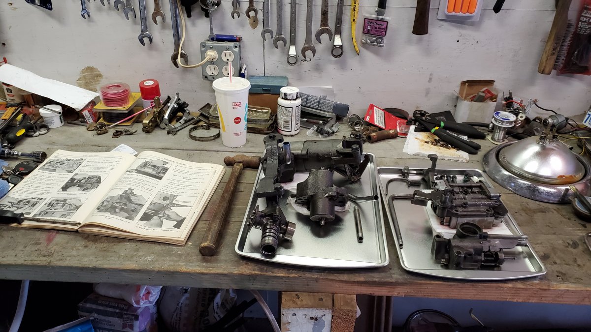

    Next thing you will need is a sturdy workbench. The one running down the side of my garage is heavy-duty enough but it has a base that prevents the wheels of my engine crane going under it, and as such stopped my from lifting it up. I didn't fancy putting my back out for a lump of iron so built a little workbench from some old wooden shelves I had.
    Nice height to work at, easy to reach all around and not too small that the gearbox cannot be rolled over without too much fear of it falling off.

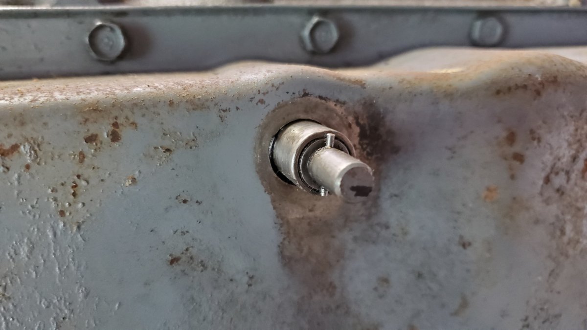

    The side pan has two levers- gear selection and throttle modulator arm. I had marked the position with Sharpie but noted afterward that I did not need to as they are both keyed for position with teeth.
    Side pan off. The lower bolts do not have star washers- they have copper sealing rings. Don't lose them, thye like to get stuck to the pan instead of coming away with the bolts. What we are looking at here is the valve block on the left, some pipework, the end of the governor and the reverse gear lock-out mechanism.
    There is a specific order to remove all these parts. the manual says "remove pipe"- that's what it means. All the pipes are just a push-fit.

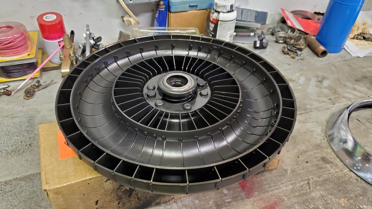

    At this point I decided to remove the torus because it's heavy and bulky and made turning the gearbox upside-down to remove the lower pan almost impossible- note that in the manual the gearbox spends most of its' time upside-down.
    There's an 1 1/4" nut on the end of the driven shaft. It should be done up to 50lb/ft, mine was finger-tight but had been saved from undoing by the lock-washer. I bent the lock-washer carefully back and undid the nut. The driven torus then just pulls off the shaft. The silver bit in the center is the oil pressure relief valve. Make sure it moves freely.
    Circlip pliers time. The driving torus is secured in place by quite a large circlip. Remove that and it pulls off the splines.
    Ditto the drive housing. That left the 3 shafts poking out. Note the dribble of oil. It had been leaking for a while.
    One thing that did make me smile was the clutch-pack style sprung shock absorber in the back of the drive housing. Note that all three of those parts on the bench rotate independently. The big bowl part actually brings the turning force in from the engine, and directly to the first gear set. The output of the first gear set then goes forwards to the turn the inner torus, which turns the outer torus. that turning force is then sent to the second gear set and from there out (via the reverse gear set) to the rear axle.
    That design means that, in first gear, the torus is spinning more slowly than the engine- and at 375 RPM idle is turning about 220RPM which is not fast enough to drive the car forward or make it creep. My guess is the designers didn't want the automatic gearbox to be too alien to people who has never before experienced one. So, on the flat you can simply engage Dr at idle and the engine takes up a bit of load but the car does not move. Pressing the gas then brings the revs up sufficiently to propel the car forwards- the result is a very very smooth take-up and launch.

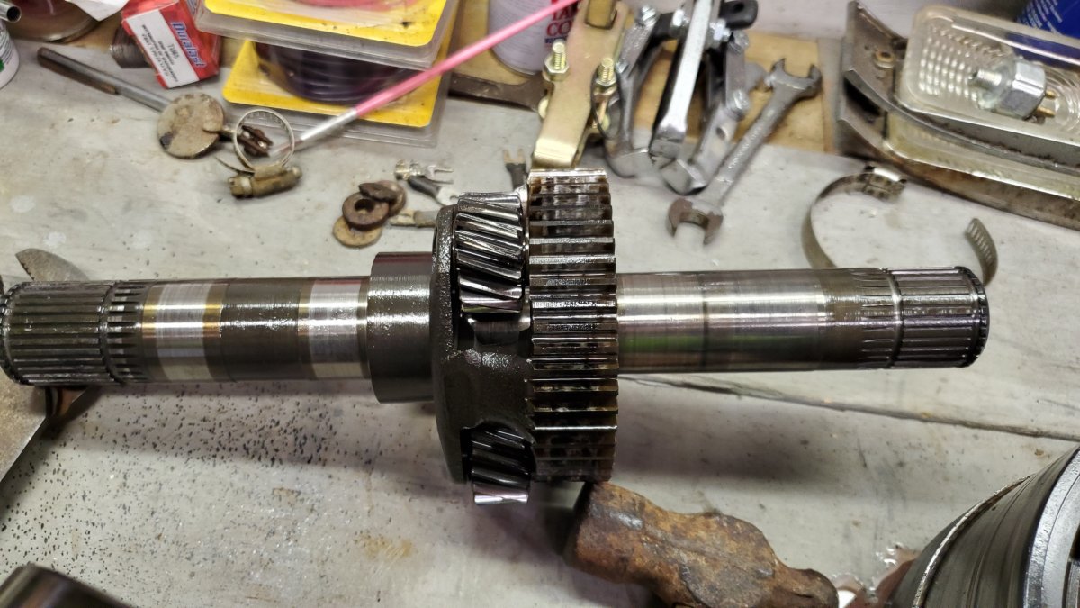

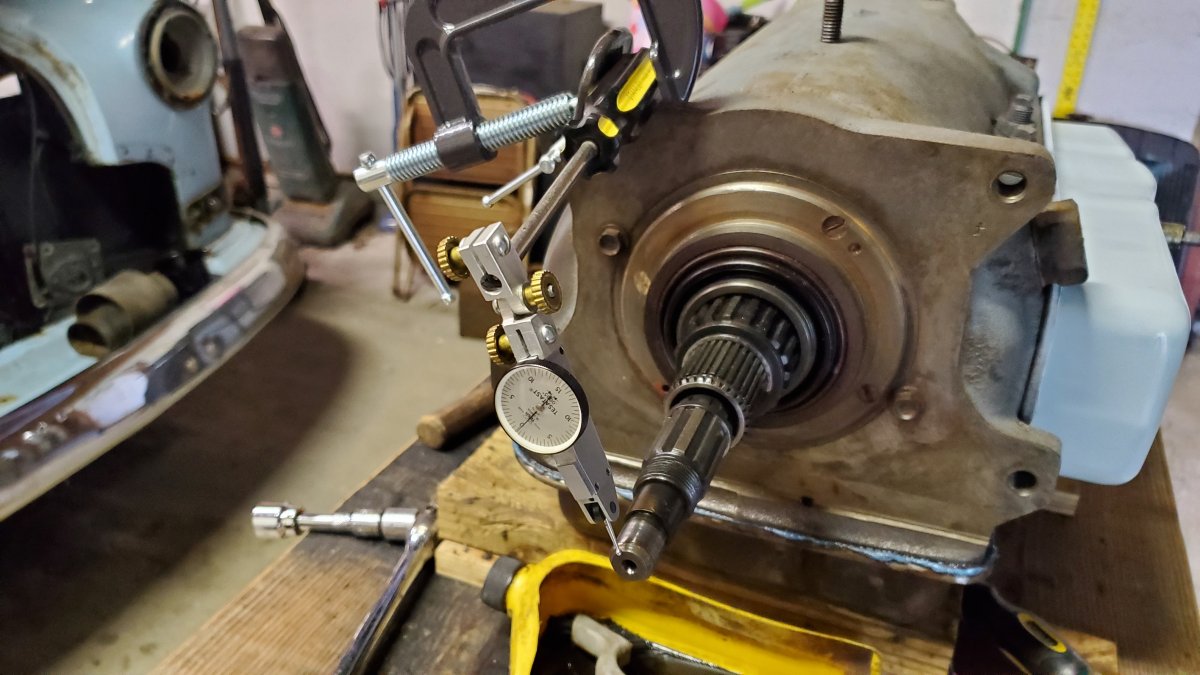

    Before you go any further, make sure you have your copy of this. This is not a gearbox to dive into blind.
    First, I used some clamps and stuff to hold my dial gauge in place to measure the end-float on the driven shaft. It wasn't actually too bad, just over-spec at 15 thou'.

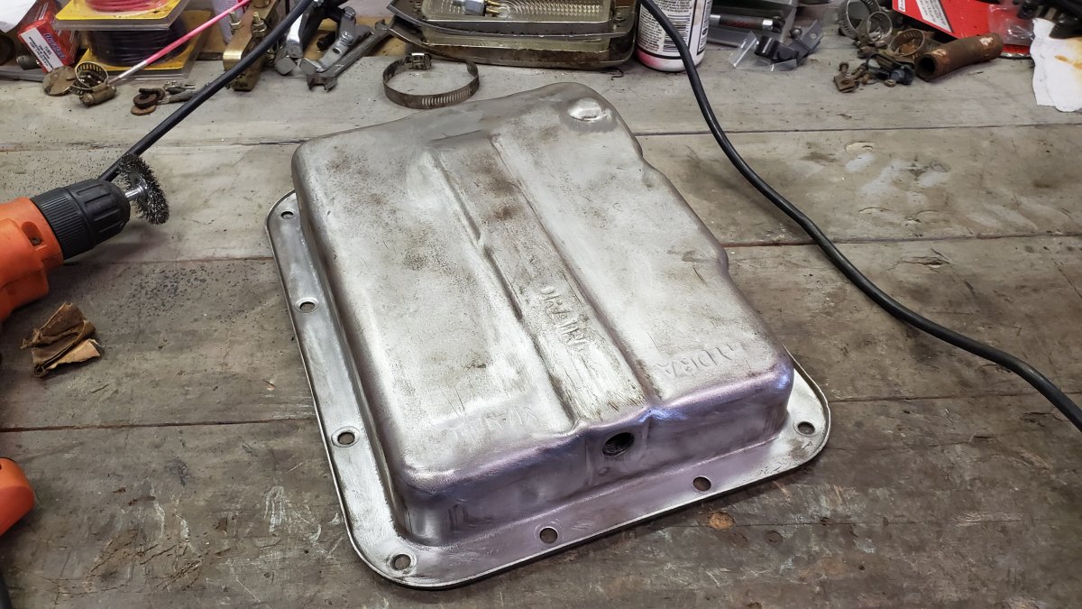

    I pulled the lower pan off. Note the excess blue sealant all over it- provided courtesy of the last person who'd been inside the gearbox. Remember the nice bright red, clean looking fluid? That belied the real state of the contents. That smelled badly burned, too.
    Carefully rinsed out with gasoline, the gritty texture is revealed. Black sooty friction material I can deal with, metal shavings less so. If you look carefully, in the middle you can see a round globule of metal. Yes, that's a melted globule, not just shavings. The inside of this gearbox has been white-hot. That's not a good thing.

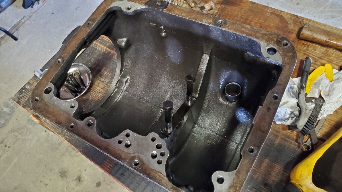

    I cleaned it all thoroughly. That represented about a tables**** and a half of metal shavings. I also took to the sealing faces with my DA (orbital) sander, with a 220 grit pad on. Where the bolts are tightened down (usually over-tightened) it bends the metal up and makes high spots. The result is that even with a new gasket there is potential for leaks. Sanding the high points off helps the new gasket seal.

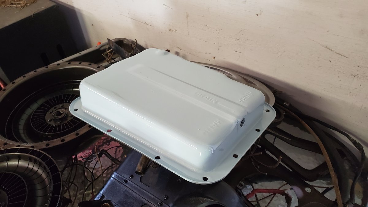

    Why stop there? Cleaned the exterior surfaces.
    Painted. The original color of the gearbox appears to be battleship gray. I picked a very pale blue.

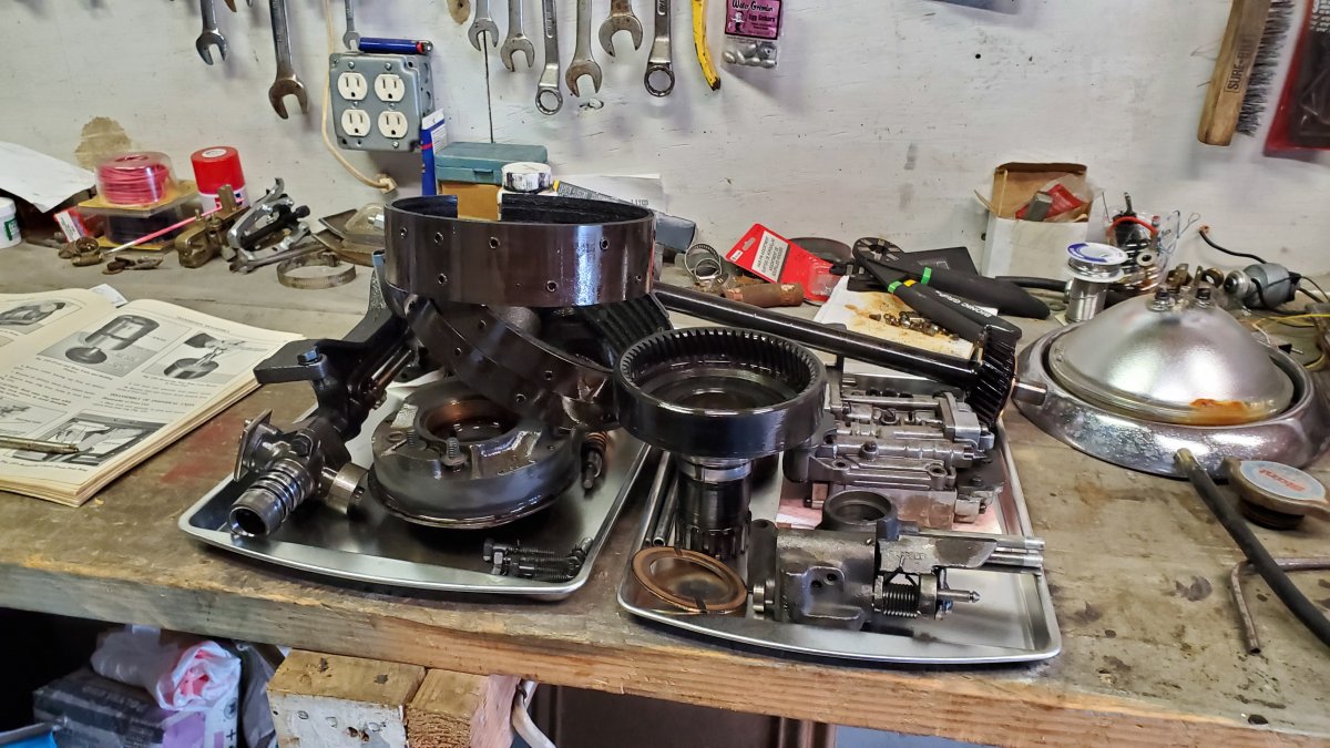

    Carefully cleaned all that up and started following the manual's procedure for tear-down. Visible in the top there, nearest is the front band servo, then the larger one on its' side is the rear band servo. The pipe with the blue sealant(*) on is the rear pump pick-up pipe, the one running at a diagonal to the front servo is the rear pump pressure feed.
    *Please do not be tempted to do this. Ever.
    After slackening the adjustment bolts off, the servos just unbolt and can be set to the side. It is a remarkably modular design for its' age. The valve block lifts out, the rear pump and governor ***embly all unbolt and pull out.
    Make sure you have lots of space to put everything. There are a LOT of bits.
    The drums are now visible, the oil pump (right) undoes and pulls out. the tailshaft/reverse gear set comes out after the bolts around the back of the rear drum are undone. Zip-Loc bags and a Sharpie for the bolts. Once the tailshaft has been taken off and the driveshaft/planet gears have been removed there's nothing to stop the drum falling apart. The manual recommends a special tool, a piece of metal bent into an L and a hole drilled through is not hard to make, it uses one of the bolts to hold the clutches in place.
    Yeah, even more parts than before.
    The drums are held in with a main-bearing-cap style clamp which has bent-over securing tabs. Empty case there still weighs a good 40 lbs or so. I cleaned everything down with gasoline. Do not use cotton shop towels or paper- those all shred and leave little bits of lint stuck to the sharp parts of the casting and will eventually get into the hydraulics. I recommend old teeshirt style cotton.
    As with a lot of this gearbox, the two drums are held onto the drive shaft with circlips. I pulled them apart and the central bearing/fluid delivery sleeve made a clicking noise pulling off. One of the rings was broken (pictured), the rest were melted into the steel of the fluid delivery sleeve.
    That did however represent all of the component parts removed from the case.

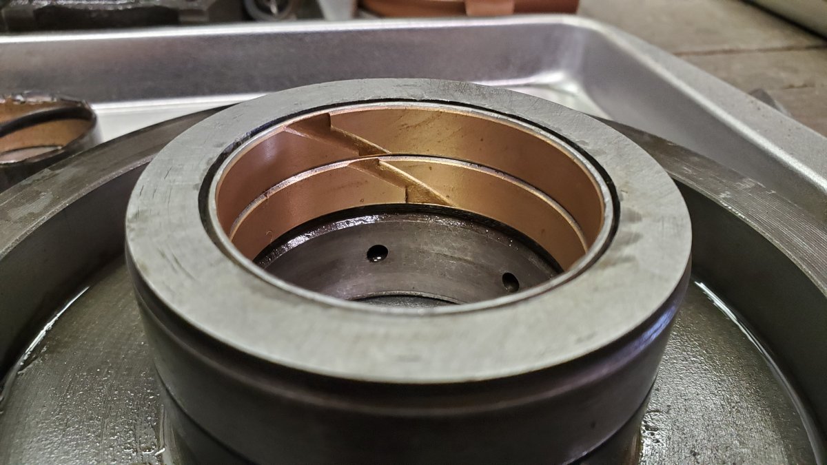

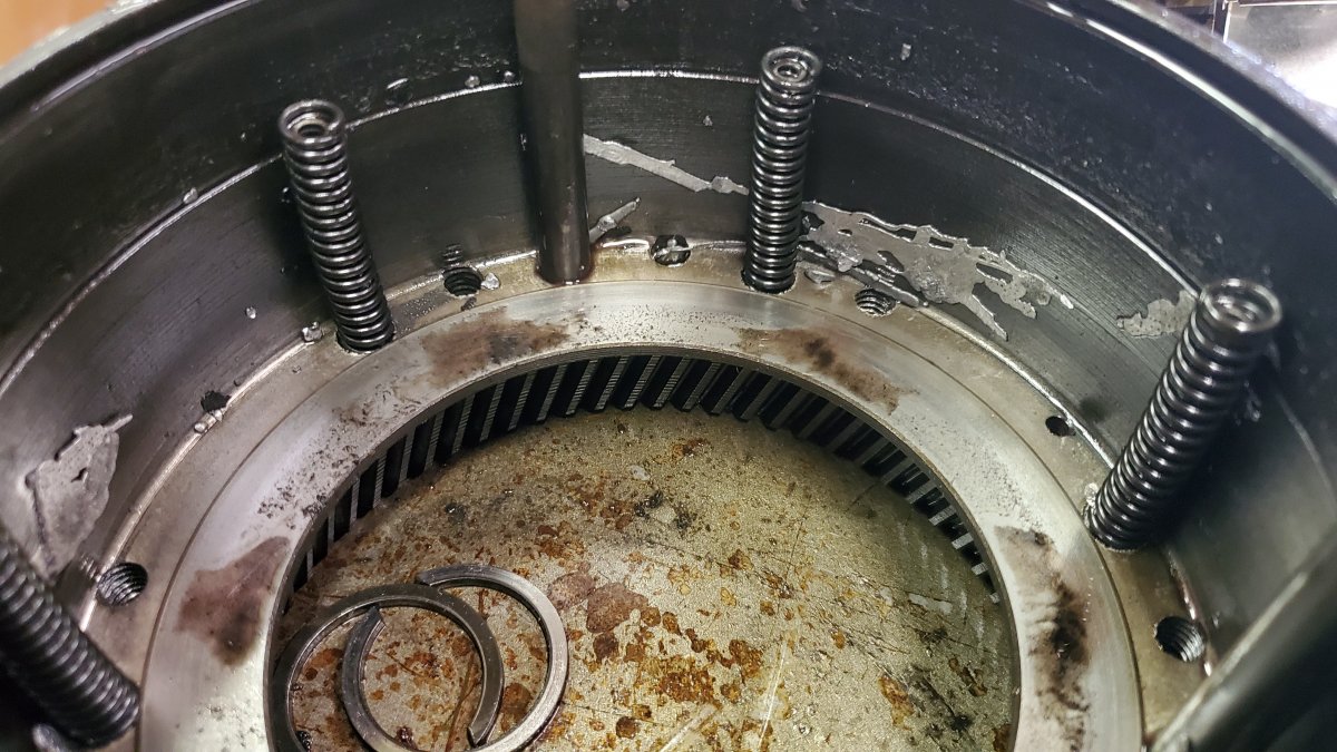

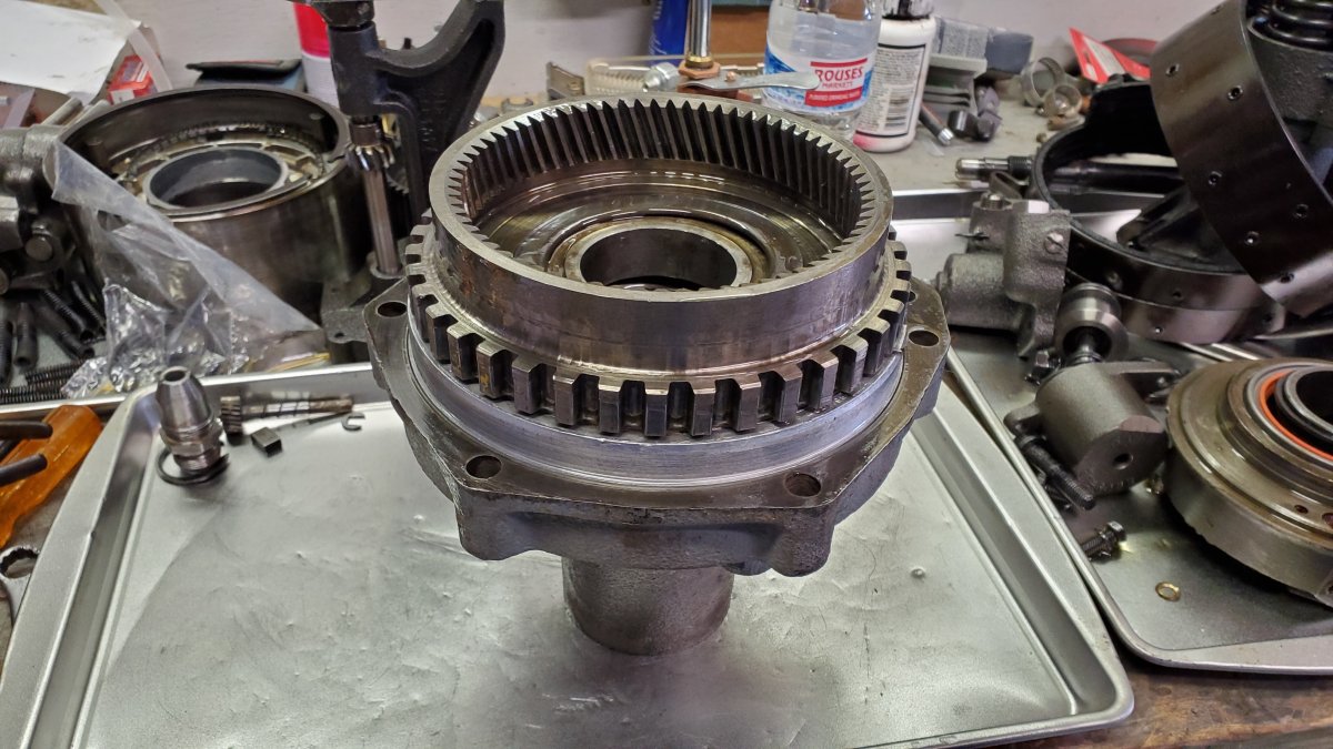

    This here is the "fluid delivery sleeve". It serves a few purposes.
    First and foremost, it is bolted into the main bearing style brace in the gearbox case. That is drilled with 2 oil p***ages from the valve block. Each one goes to a drum, to fill the center up, move the annular piston and apply the clutch.
    Second, it supports the rear drum on one edge.
    Third, it supports the driven shaft from the torus.

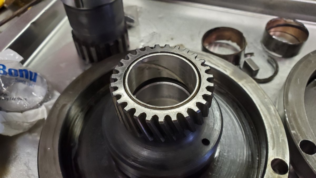

    As you can see, it was very badly scored where the bearing had failed and had allowed the drum to contact. This had melted the oil control rings in place, also.
    That there is the bearing that scored the end up so badly. You can see also where the section that should only have the rings touching was rubbing too.
    Luckily the shaft that runs through the center is made from incredibly hard steel and had survived intact. The planet gears were also all good on their bearings.

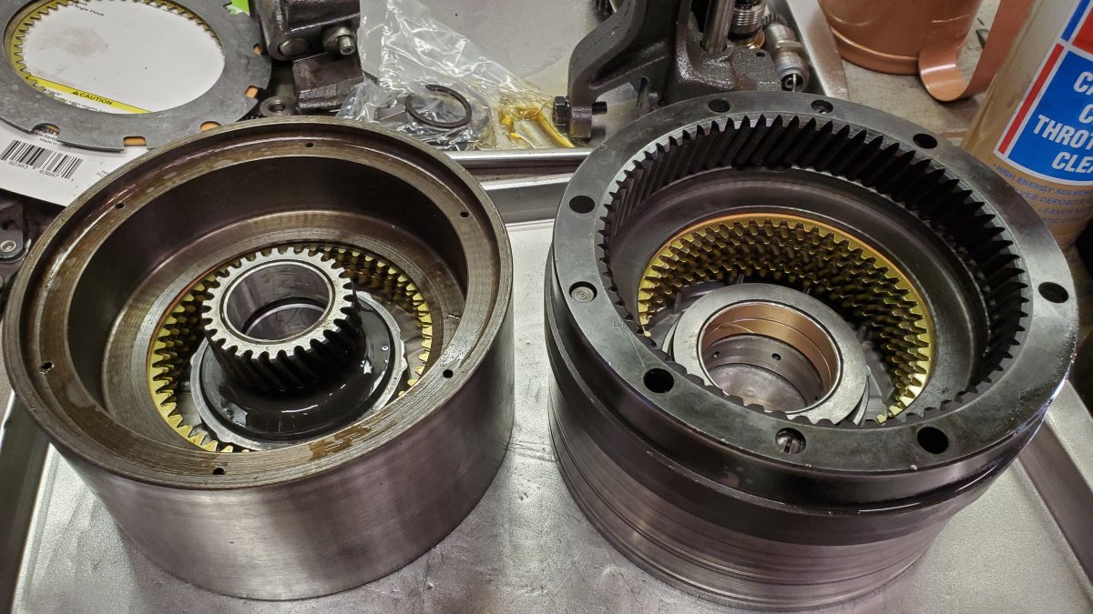

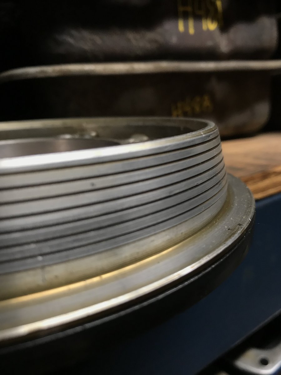

    The drums themselves are fairly straightforward in design; a sliding annular piston is held in place inside the drum. Interleaved steel plates, half of which are plain steel (the "steels"), half with a special coating on (the "frictions"). The steels are notched on their outside edge, which line up with pegs on the exterior of the drum and rotate with it. The frictions have teeth on their inner edge which mesh with the sun gear. The planets of that sun gear mesh with teeth on the drum outer.
    The planets are normally free to rotate, and the action of the sun gear having fewer teeth than the ring means as it rotates, there is a reduction ratio across it. If the clutches are engaged, the planets cannot rotate and the input then rotates at the same speed as the output (direct drive).
    The clutch packs had been slipping badly, most likely due to low oil pressure because the system was leaking past the rings. The seals for the piston were also brittle, meaning they will have been leaking badly also.
    This slipping caused a lot of heat, and that had burned all the friction material off and then everything inside became metal on metal, which is a recipe for disaster. You can see that the oil has carbonized onto that steel (above), and that there are areas of bluing of the steel so it's been at least 1000 degrees F.
    That excess heat began to soften and destroy the bearings.
    Because everything is nested, one bearing failing deep inside the gearbox affects the alignment of the rest of the shafts- that then puts it all out and things rapidly go downhill from there.

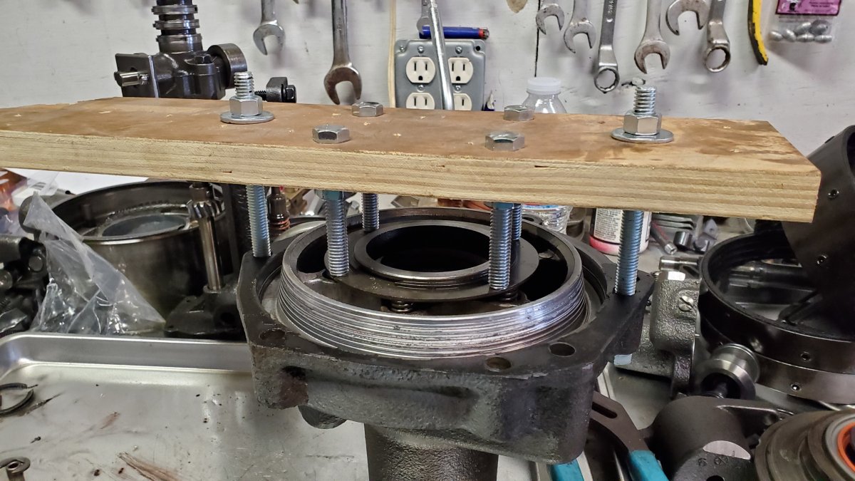

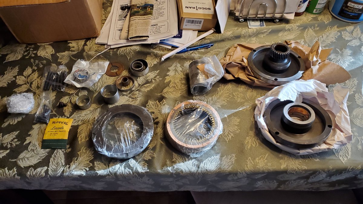

    Earlier I had made mention that if you planned on taking a Hydra-Matic apart, to completely dis***emble it and perform a complete inspection.
    Reason being, you get to find little gems like this. That's the front servo primary return spring. It and the servo boost rely on that spring providing tension, which, in a broken state it couldn't.

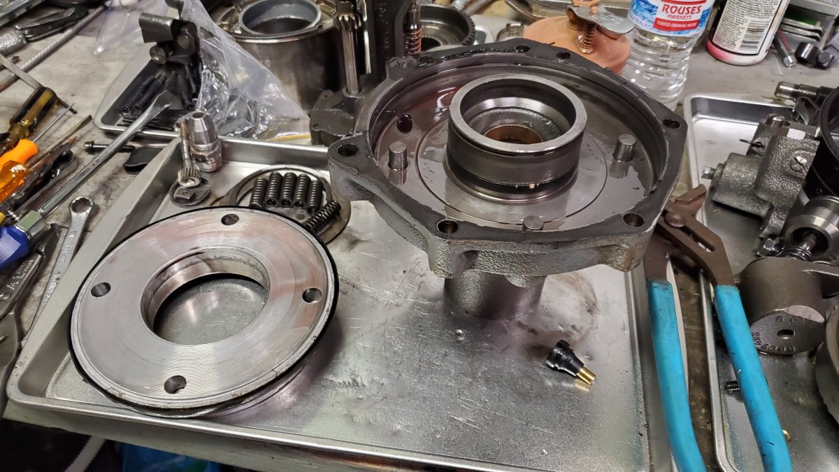

    Next up, I started with one of the very central core parts of the gearbox- the front oil pump. It is driven directly by the engine, and has integral pressure relief and external pressure regulation.
    The pressure relief was totally jammed with swarf, so that was freed up (little gray circle bottom center of the right hand part) and the pressure regulator was getting stuck in the bore also. The pump itself wasn't in bad shape so I prised the old seal out and removed the oil control rings.
    Circlip pliers ahoy. They got a good workout doing this gearbox.
    I used the old seal as a drift to knock the new one in place. All nice and centralized.
    Note that the screws were so tight I had to buy a bigger screwdriver to undo them, ideally I could have done with a rattle gun to free them off.
    I redid them back up to factory torque, 20lb/ft.
    Finally, one of the shuttle valves from the front servo- shows how much swarf had been pumped around the system and found its way into absolutely everything. Burned up friction material gets all up into the valves also and causes them to become sticky and makes the gearbox a lot more lumpy than it needs to be. Given that the design allows for 2 gears to be selected simultaneously (one of the things the later TH350 cannot physically do) and that'll happen if the 2-3 or 3-4 valves get sticky, it's a good idea to take it all apart and ensure the hydraulics are spotless.

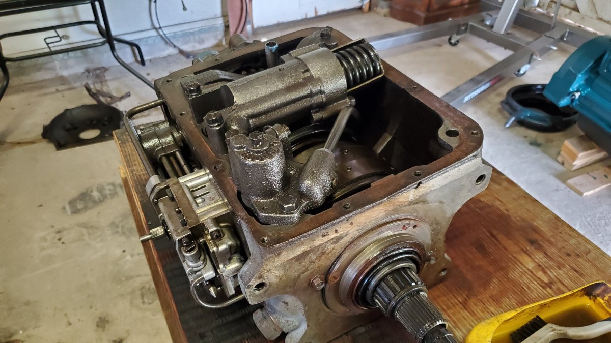

    Next up on the operating table- rear band servo. Note the large spring on the left hand side- that is there to hold the 3rd gear band on when the engine is off and the gearbox has no oil pressure. This is to work with reverse, as said previously to engage 2 gears at once and lock the gearbox up to park.
    In normal operation the servo is held off with oil pressure, the spring working as an ***ist.
    Thankfully the designers had a bit of foresight. They made the bolts long enough to take a good portion of the tension off the spring before running out of threads.
    Several pistons inside, springs and valves. There's a rapid release valve in the base of the secondary piston- a little spring steel flap with a hole in (fast flow one way,needs slow flow the other) to be clean underneath. It forms part of the system to gently apply the band under light throttle.
    Even more metal shavings. All flushed through. This servo is fairly simple. The metal shavings has gotten in even under the piston ring.
    After a bit of a fight holding the spring down with a woodworking C clamp, it's all re***embled with no more particles inside.
    Phil

    You can see the plate that the tailshaft is sitting on there- there's a set of bolts that hold it to the rear drum. Undo those and the rear retainer bolts and the entire ***embly lifts out. First, undo the speedometer drive and set it aside. The main shaft has a circlip holding it in (surprise, surprise!) then it pulls out.
    And the rear main bearing. Or rather, what was left of it. There's the source of some of the molten metal globules in the oil pan, then.
    This is the cone of the reverse gear piston. The face there has a helix cut into it but, with the heat and steel chunks that got between the faces, the alloy melted slightly.
    For comparison, a good cone. I ran a pointed tool through the helix, removing the swarf and rough edges. It qualified for "good enough to go back in". It's not used often (only when reverse is engaged) and only slips if reverse is engaged when the car is still moving forward. Granted, the manual states you don't have to be at a complete halt to engage reverse but really it helps to prevent wear if you do.
    The piston is spring loaded and sits hard up against a circlip. The spring load needs to be taken off before you can take it apart. I made whatever Special Tool number the manual called for from six bolts and some nuts and wood.
    The manual states that you may need to free the piston up with some compressed air. So, I made a little tool to convert the Schrader valve fitting to a runner seal that goes over the hole the fluid would go to move the piston.
    It took a fair bit to get it to shift because the seal was so perished and leaked badly.
    Sure enough, the innards were full of swarf. Flushed all that out and removed all the old seals, which just fell apart.
    Next up, put a decent edge on a cold chisel because...
    ...out come the old bearings, carefully to not damage the metal they sit in. Most are a C shaped piece, rather than a solid ring. Finding the join makes it easier to break the bearing out.
    Fitted brand new seals, the center one fits in easily but the one on the piston itself gets caught up attempting to push it in because it gets stuck against the lip the circlip nests against.
    20190817_144111.jpg I ended up cutting up some sections of this plastic sheet (actually it was part of an old Cone Of Shame from when my dog was spayed) which held the lip of the seal in past the step of the bore allowing it to push in without damaging the seal any. The original dealer tool was a ring that was the same diameter of the lip. Oh well, they didn't have one when I asked.
    The funky wooden clamp pushed it all down together again, new seals that don't leak at all!
    Next!
    Phil

  16. PhilA
    Joined: Sep 6, 2018
    Posts: 2,151
    PhilA
    The servos have metal sealing rings. The swarf had gotten in behind them, but they were in good condition.
    Look carefully top right, the piston sitting on it's end, that's got a chrome ring sitting in there.
    The annular pistons for the clutches have rubber seals.
    I made a shopping list at Fatsco (www.fatsco.net), who come highly recommended for anything Hydra-Matic, old and new.
    Phil
  17. PhilA
    Joined: Sep 6, 2018
    Posts: 2,151
    PhilA
    Finally, we reach the reason the gearbox was taken apart previously.
    This circular wavy washer spring. You see half of the old one in position- it would appear that previously this spring fractured and got caught in the ring gear, locking it solid. That's gotta have been interesting when that let go...
    Phil

  28. PhilA
    Joined: Sep 6, 2018
    Posts: 2,151
    PhilA
    Herein began the rebuild. There are a couple of bearings that are unavailable, but in this case a pair of more modern ones side by side fit perfectly. Just take care to line up the oil channels when fitting them.
    Similar fittings- one thing I will stress early on with pictures of bearings- you may find buying some dry ice and sitting the new bearings in it for a while a help, to shrink the bearings down. One absolute MUST is to ensure none of the bearings sit proud, as this WILL screw up the endfloat measurement, which is critical.
    Ugh, more melted metal. The guts of this drum were obliterated. The springs had also been very hot and as such had annealed and lost a lot of their spring. I ordered replacements. Cleaned all of that out thoroughly.
    Brand new friction material. Note that the rings need to be soaked in hydraulic oil before being fitted- these pictures were for the magic of television (and mostly so I could take pictures without getting oil all over my camera), they all got stripped down and oiled.
    Interleaved steel and friction plates. Next up, before putting the top on, take the center and get all the friction plates aligned. For this you need to channel your inner safe-cracker because it feels like turning a safe dial back and forth to locate it through each set of plates.
    Note also that the 8-cyl version of the gearbox has a few modifications compared to the 6-cyl, one of which is more friction rings in the clutches. The other is a change to the pressure regulator valve set.
    Two drums with new clutches and new bearings. Quite satisfying. Also the friction material is compatible with DEXRON-III oil (forget not that DEXRON is a friction modifier, the original oil had some different characteristics).
    Don't forget the circlip! It's buried way down in the center of the drum.
    The oil rings on the fluid delivery sleeve have little clasping fingers. Take care not to break them, they're brittle.
    The manual states there's a special tool to squeeze the rings so they'll slide inside the drums. Twisted wire is a right fiddle and causes a lot of cursing but it does work.
    Another circlip and the Special Tool that holds the drum together. Nearing readiness to re***emble into the case...
    Phil
