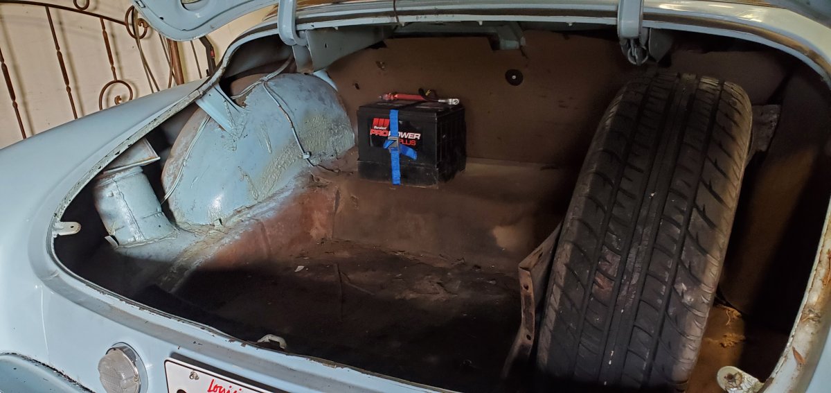

    Completed hard lines for the brakes. Adjusted rear shoes and e-brake.
    Found out why the new brake hose seemed a little short- the lh side of the axle wasn't located on the centering peg and was only done up with 3 nuts, no lockwashers. Remedied that problem.
    Battery now has a new home in the trunk.
    ... Which has tidied the engine compartment up nicely.
    Phil

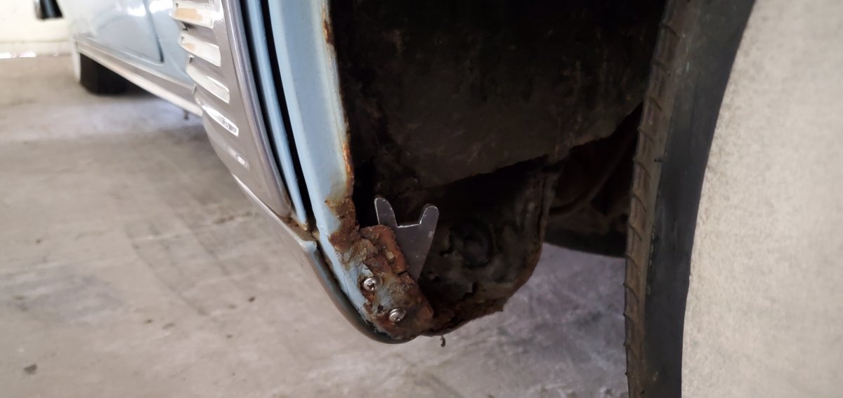

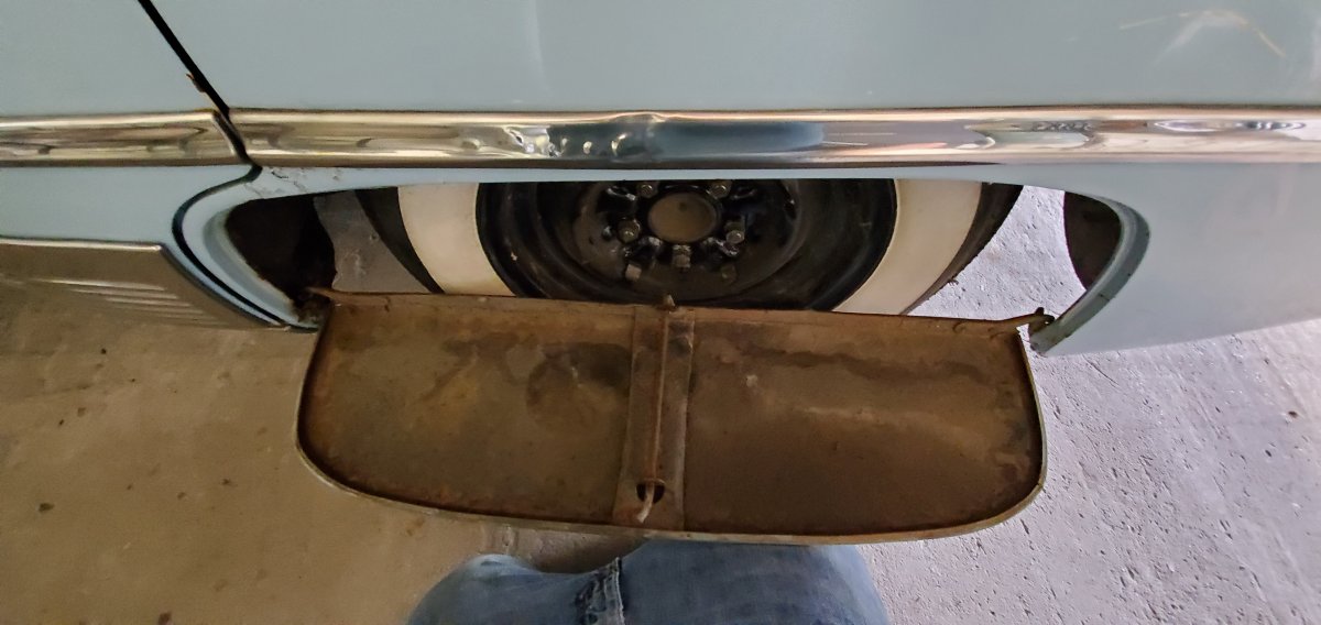

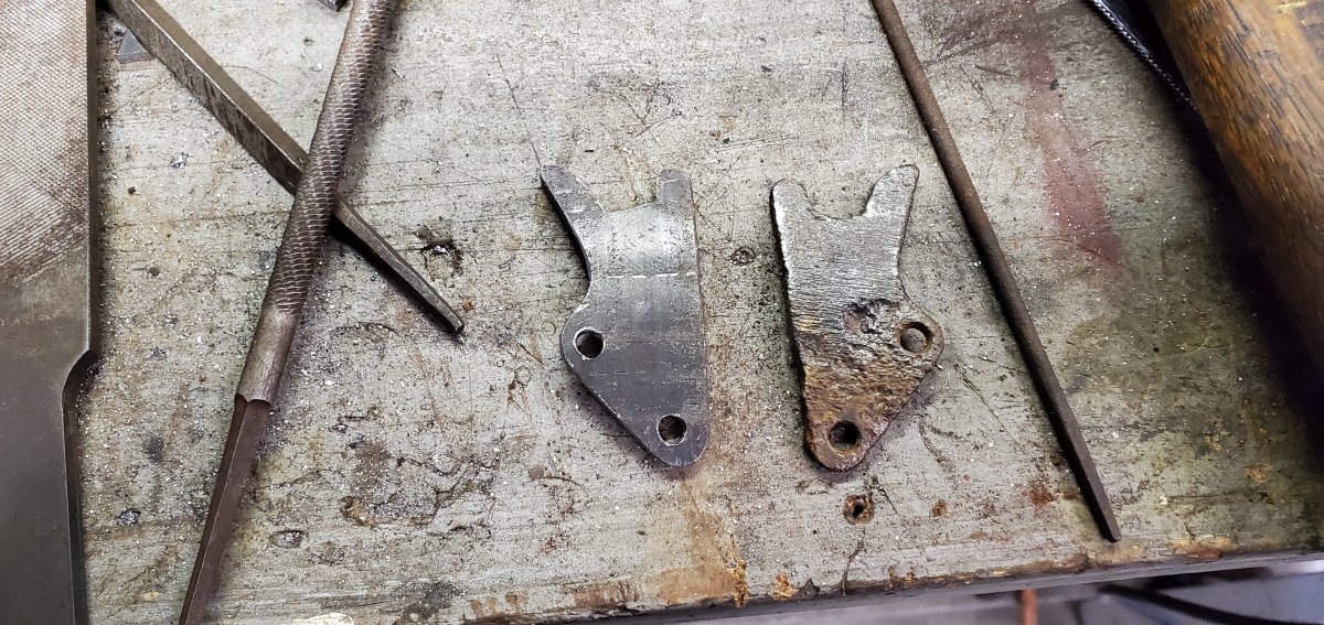

    Little bit of metalwork today. I was missing a spat bracket on the driver's side, and didn't fancy losing the spat while driving. Copied the p***enger side one.
    Screwed into place.
    Spat then locates securely and locks up.
    Another item off the list. It doesn't rattle when I shut the door now!
    Phil

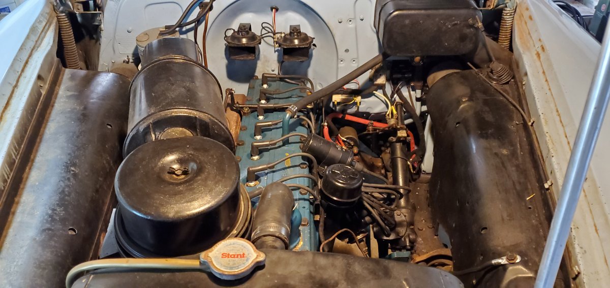

    Went out to the car at lunch. Now it's cold I had a chance to inspect a few things.
    Oil is nasty, needs to be changed. Short runs up the street and idling in the garage has contaminated it as to be expected.
    It's otherwise holding coolant, oil, atf.
    Oil pressure warning light sender is DoA. Wiring is good (pull the wire off the sender, light goes out).
    Fuel pump needs a rebuild.
    Need to get a flywheel stone guard.
    Going to do a coolant change this weekend, get some antifreeze in it. Got a couple bottles of concentrate and a bunch of gallon jugs of distilled water to go in.
    Overall really quite happy, it covered nearly 100 miles yesterday with only a few hiccups (mostly cutting out due to having to sit in traffic and the fuel boiling in the pipe before the pump- could see it drawing bubbles into the bowl).
    Needs a tune up, the timing is "kinda right", needs setting accurately.
    Noted from driving, people say these are slow cars, but I find it can hustle along with traffic just fine.
    Speedometer is a little optimistic, it reads about 5 over.
    50mph cruise, all to temperature (it holds 180-185 nicely) oil pressure reads 20psi, drops to about 10 at idle.
    Brakes are bedding in nicely.
    Exhaust needs slight adjustment, it's knocking on the hole in the frame it goes through.
    Higher ratio final drive would be a significant improvement.
