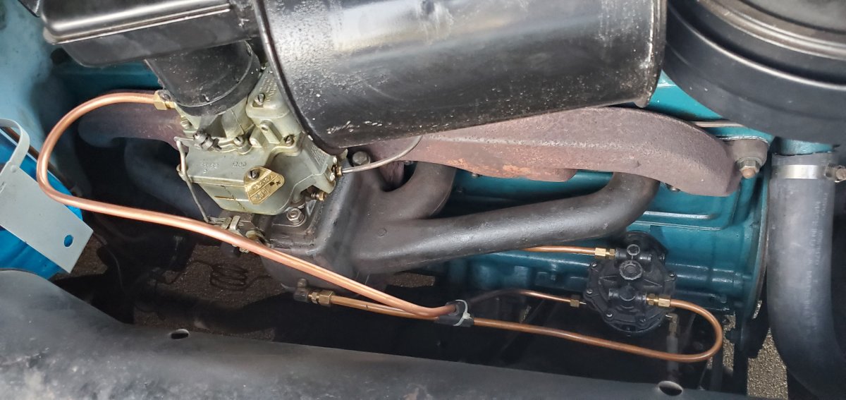

    Today, I almost completed the list.
    Coolant changed, now 50/50 antifreeze and distilled water
    Manifold and heat riser gaskets replaced
    Fuel pump tightened
    Hard fuel lines replaced. Steel line to carburetor was cracked
    Rubber fuel lines replaced with marine grade fuel pipe
    Air filter gauze oiled and dish filled
    Throttle pump needs looking at
    Phil

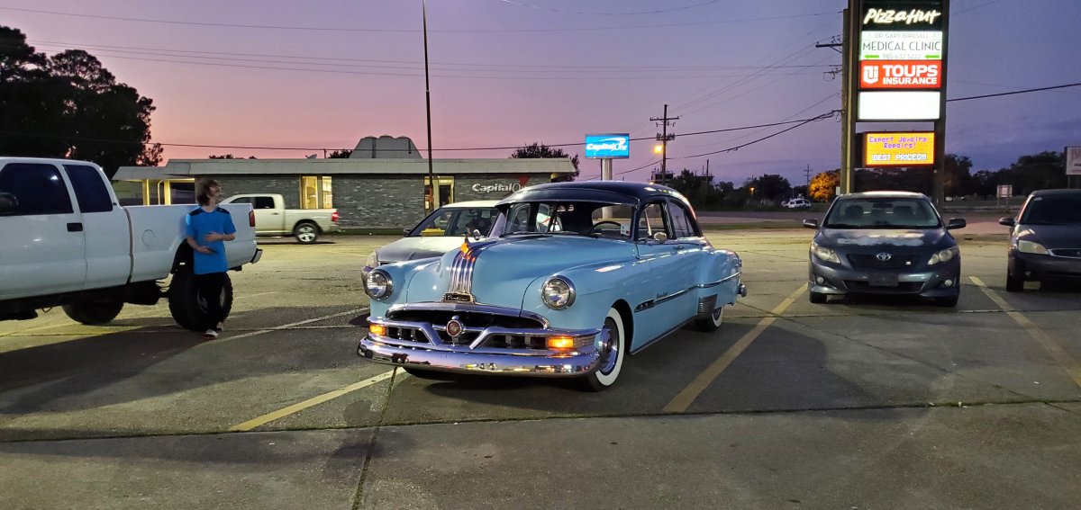

    Figured I'd share a quick drive to the milkshake stand and back.
    Couple things need addressing (bands are toast and squeak on uptake until the oil's gotten around but that's an engine-out so it can wait, exhaust needs a couple more supports to stop clunks and bangs underneath as it swings).
    Other than that, pretty happy with a nice old cruiser to go places in.
    Phil

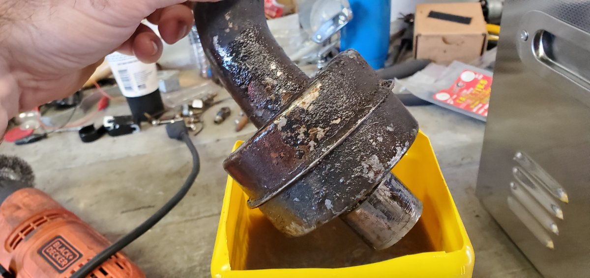

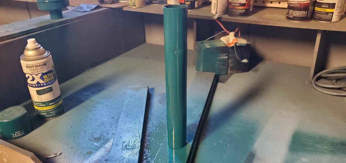

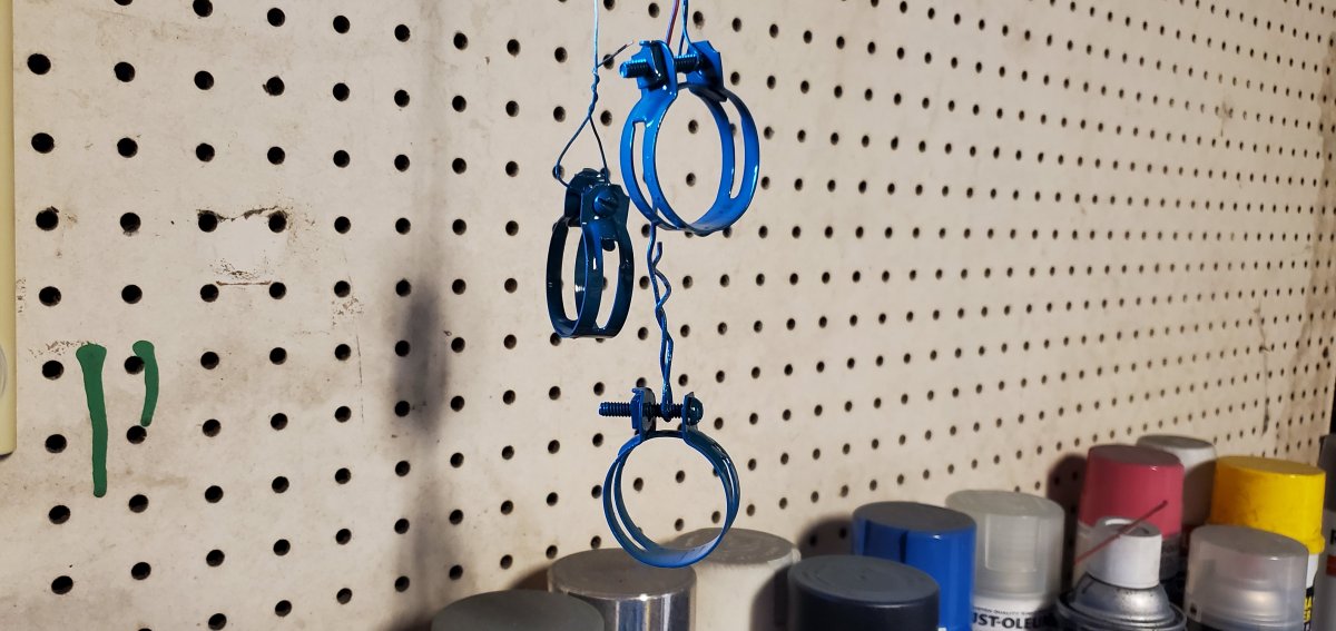

    Crank case ventilation tube arrived today in the mail. Dirty but otherwise in good shape.
    Stuck it in the ultrasonic bath, in gasoline to clean it both inside and outside.
    Cleaned up nicely.
    ... as did the down tube ...
    ...and the clamps.
    It's missing the lower bracket, but that's just a piece of flat bar that clamps onto the lower tube and bolts to the engine.
    Paint is drying now, that can go on tomorrow. Discovered also that there should be a standoff clamp for the exhaust downpipe, to steady it at the engine end. That's missing, too.
    I'm wondering if the garage that did the work just threw it all away...
