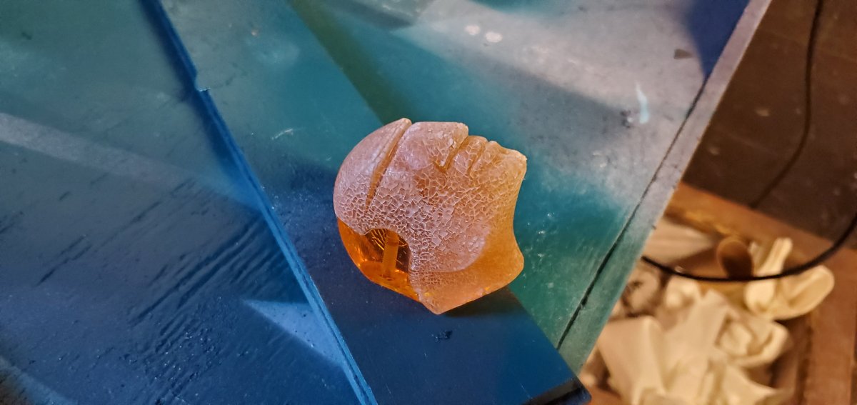

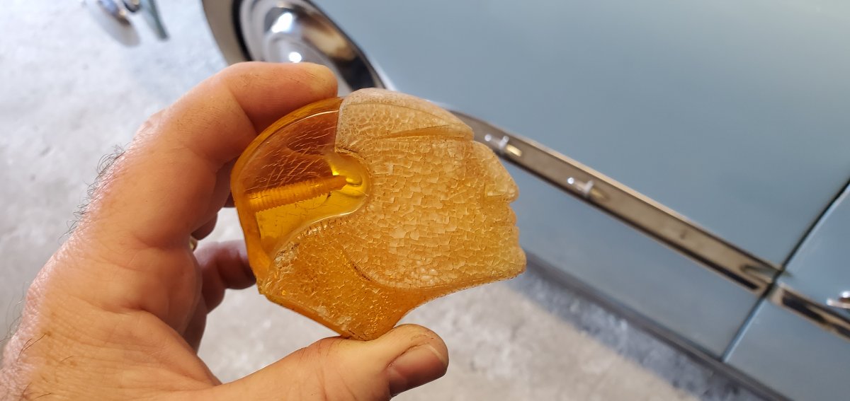

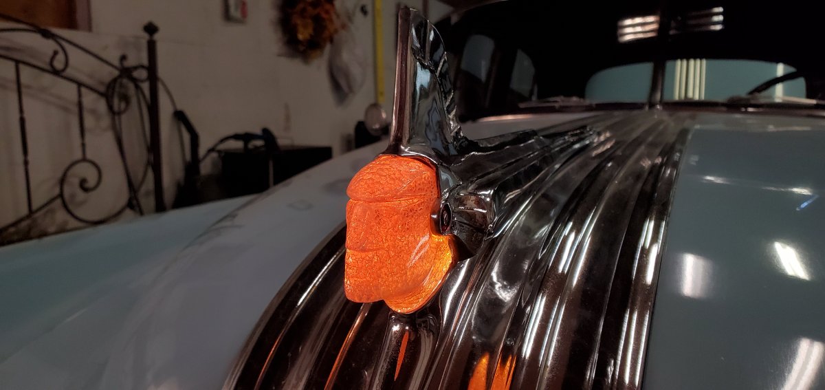

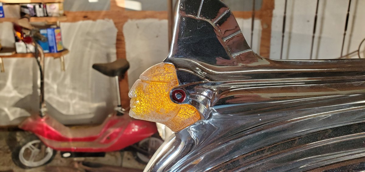

  2. I've decent luck semi-repairing sun-baked crazed plastic like that by using heavily-thinned clear lacquer. The paint is generally too thick to 'wick' into the cracks, thinning it at about 10% paint, 90% thinner and dipping it will help, allowing some 'soak time' for it to penetrate. Heating the part to about150 degrees before dipping also helps. If you've already painted it, soak it in straight thinner first to remove as much of the paint as possible. It's impossible to eliminate the cracking if it's really deep, but this can make it less obvious.
    brEad, loudbang and PhilA like this.
  3. PhilA
    Joined: Sep 6, 2018
    Posts: 2,107
    PhilA
    The cracks are a little deep to do that, and the okay is quite heavily discolored from the sun. Fine surface crazing absolutely I could see that working but this is beyond any real redemption. Close up, there are some chunks of plastic missing, even.
    Phil
    brEad and loudbang like this.
  4. stuart in mn
    Joined: Nov 22, 2007
    Posts: 2,788
    stuart in mn
    Reproduction hood ornament inserts are available from California Pontiac Restoration (CPR) but they do cost $86.25....even with the crazing, yours still looks pretty presentable. http://www.pontiacparts.net/Body/default.htm
    kidcampbell71, loudbang and PhilA like this.
  5. PhilA
    Joined: Sep 6, 2018
    Posts: 2,107
    PhilA
    I had seen them, and am going to budget for an insert and a new front grille badge next year.

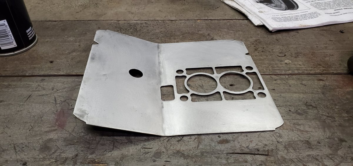

    Carburetor heat shield arrived.
    Cleaned it down.
    Gave it a coat of paint (silver underneath).
    Phil

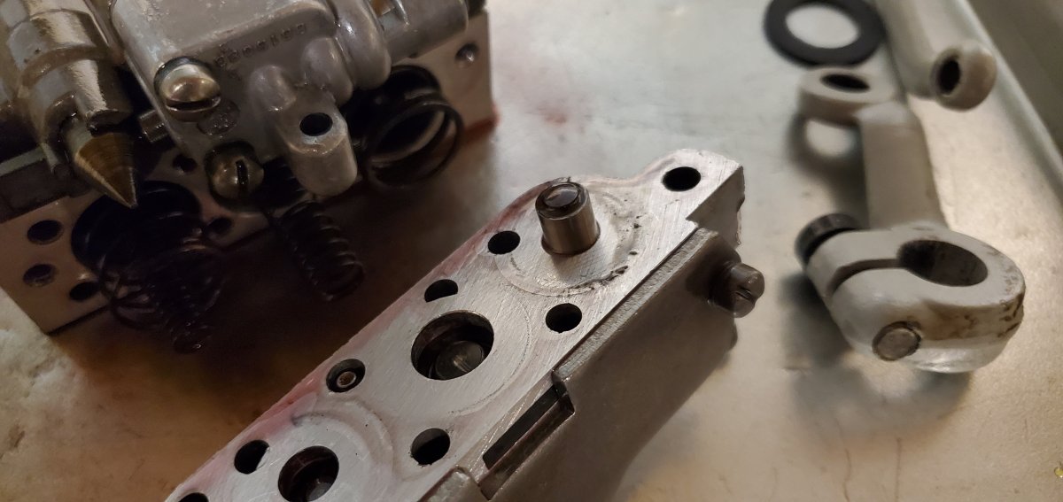

    Tonight's task, pull the main valves out, inspect operation, clean and remedy. The manual states the valves are in good working order if they fall to the top and bottom of their bores under their own weight.
    The block above is the piece that pushes back against the governor speed control and makes the gear changes later the harder you push on the throttle.
    That got cleaned thoroughly and some very fine grit paper to take the burrs off. The slides now fall out under their own weight.
    Main valves were dirty, and the outer two were not exactly free moving. They were a little easy to get hung up before and that didn't improve with dirt.
    I pulled it all out and cleaned it down, found a couple of small nicks, which I very carefully took the edge off. They all move better now.
    Re***embled it all and now it's ready to go back together.

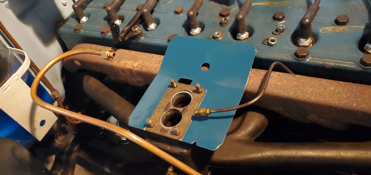

    Tonight saw re***embly.
    Amidst the biggest rain storm we've had in months, I set about putting everything back together.
    Centered the fluid sleeve, torqued down and set the reverse piston spring stop to 1/2".
    Torqued down the valve block evenly (6lb/ft), and the side pan (12lb/ft).
    With it all back together, I took the carb off to install the heat shield.
    Finally, all back together, on the floor again and awaiting being filled up with transmission fluid (on the to-go-get list still).

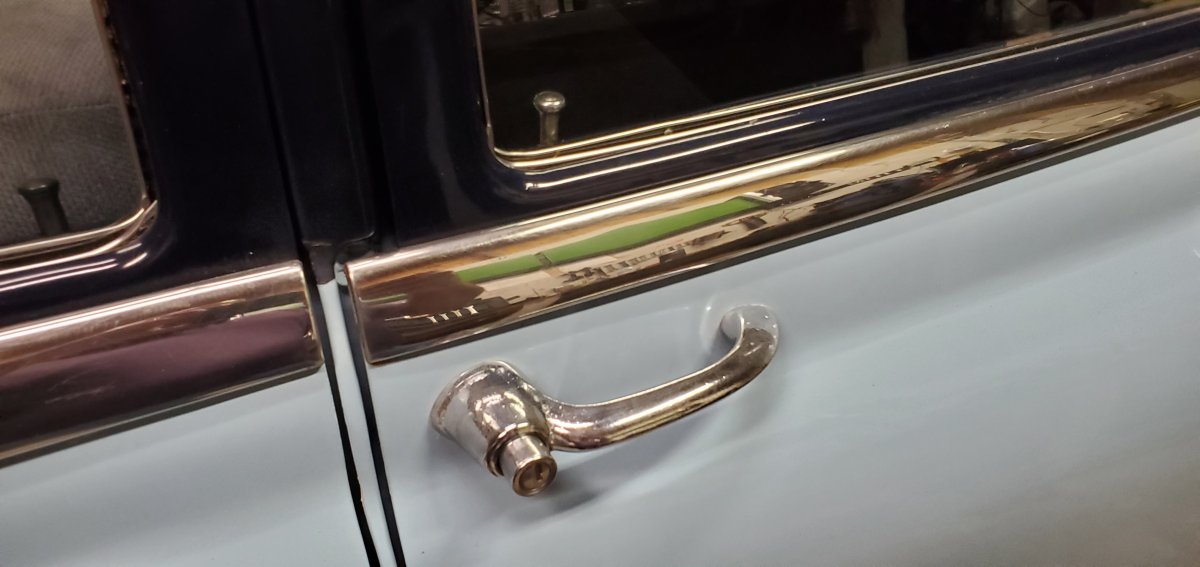

    I took the p***enger door handle off because the key had stopped operating the lock. Reason? The anti-rattle O-ring had fallen apart and the ****on was sat too far out, and as such the key mechanism wasn't reaching.
    New O-ring.
    All cleaned and back together again, tested operational. That's better.
