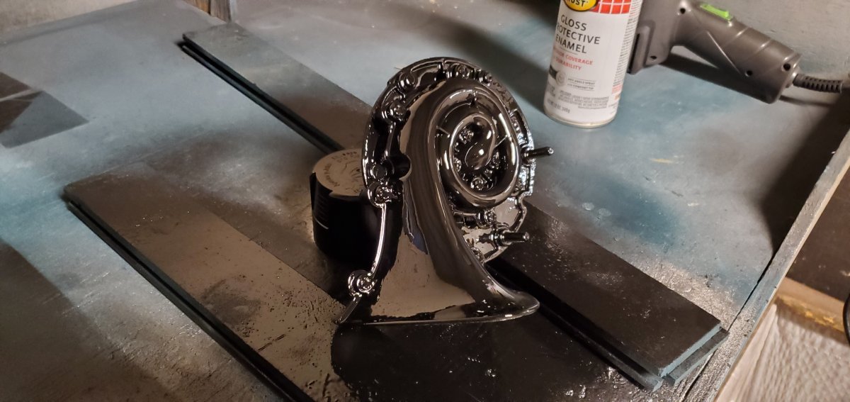

  24. PhilA
    Joined: Sep 6, 2018
    Posts: 2,112
    PhilA
    Took an hour out tonight to do noisy things.
    120 grit to get rid of the rust.
    Clean enough to see and then beat out the dents.
    220 grit to finish.
    Finally, first coat of black.
    Phil

  26. PhilA
    Joined: Sep 6, 2018
    Posts: 2,112
    PhilA
    It's a really specialized type of paint, really expensive, imported, made from..
    Wait no
    Rust-Oleum black enamel. $7 from the hardware store.
    I like enamel for jobs like this, it lays on well enough straight out of the can for non-bodywork (slight orange peel) shiny, but rubs down very well with fine grit and polish if you want it a little more smooth.
    It's not a bad black; it's not the deepest ever but it's what I call respectable. You just gotta watch it- it's 66 out here at the moment and about 70% rH- I lay a coat on then give it as gentle waft of hot air from my heat gun to get it to form a skin and seal, which tightens it up a little and stops it from sagging, as enamel is quite runny stuff.
    Good prep, lots of coats and patience, with 600 grit paper between each coat to keep it flat.
    Phil
