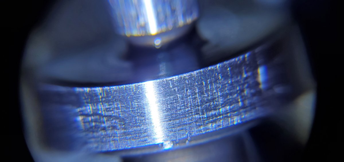

    Hopefully it don't come back when real warm. Nice magnified picture too!

    Well.
    It's not perfect, it's certainly better than it was. First still sticks slightly on random occasions but 3-4 is much better, and 2-3 is less lumpy.
    I think it'll come out again, I was being cautious not to hit the thing too hard and have it not seal.
    Phil

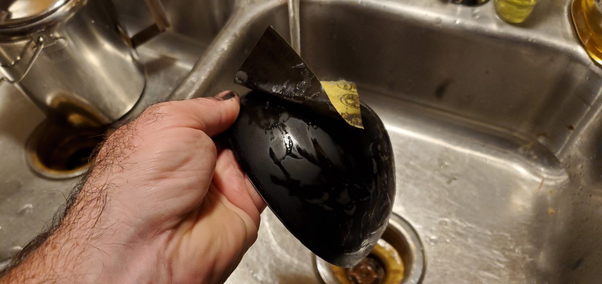

    The paint on the horn lid had dried enough to work with abrasives, so last night I decided to flat it back. It's shiny but far from smooth straight out of the can.
    Dish soap, a dab of water and start with 600-grit paper, gently caressing the surface with the soap acting as a lubricant and surfactant.
    First p***, dried off. You can see the high spots are flatted but the low points still remain gloss. More work required.
    That's a bit better. Sanded down to a uniform texture.
    Repeat but with a finer grade of paper (1500). That'll work as a key and is a nicely flat surface to continue on from. It's a bit cool to be spraying paint but judicious application of heat gun will help that.
    I'll put another coat on and that can harden and I'll repeat the above process. It may take another coat after that depending on how thick it goes on (enamel goes on relatively thick considering how well it flows). It's important to flat the paint back between coats as it goes on thin enough to echo the surface it's sitting on; the effects of orange peel will be doubled if a low point sits in a dimple, making final surface prep more difficult.
    Small items like this are quite nice to work with to create a good paint finish, even just by hand.
    Phil

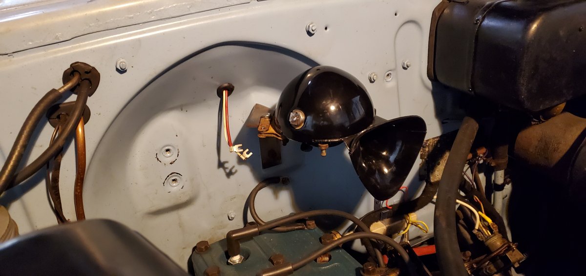

    Started work on the horn brackets, which is involving removing rivets and all manner of drills and stuff. (Aka I didn't take many photos).
    Made a hood prop though because previously I would hold the hood up higher (the springs are tired) using one of the bolt heads to hold it in place. I wasn't happy with that so I took a sleeve shank bolt from my Tin Of Random Nuts And Bolts and adjusted it to suit.
    Sawed the head off, made two recessed pieces at the bottom that a 7/16" wrench holds and cleaned it up nice.
    It replaced one of the panel bolts.
    The hood prop can't now slip out. Significantly more "parked at a show with the hood up" friendly, which does happen because people are interested in looking at a straight-eight, funnily. You can elbow it and it doesn't shift.
    Phil

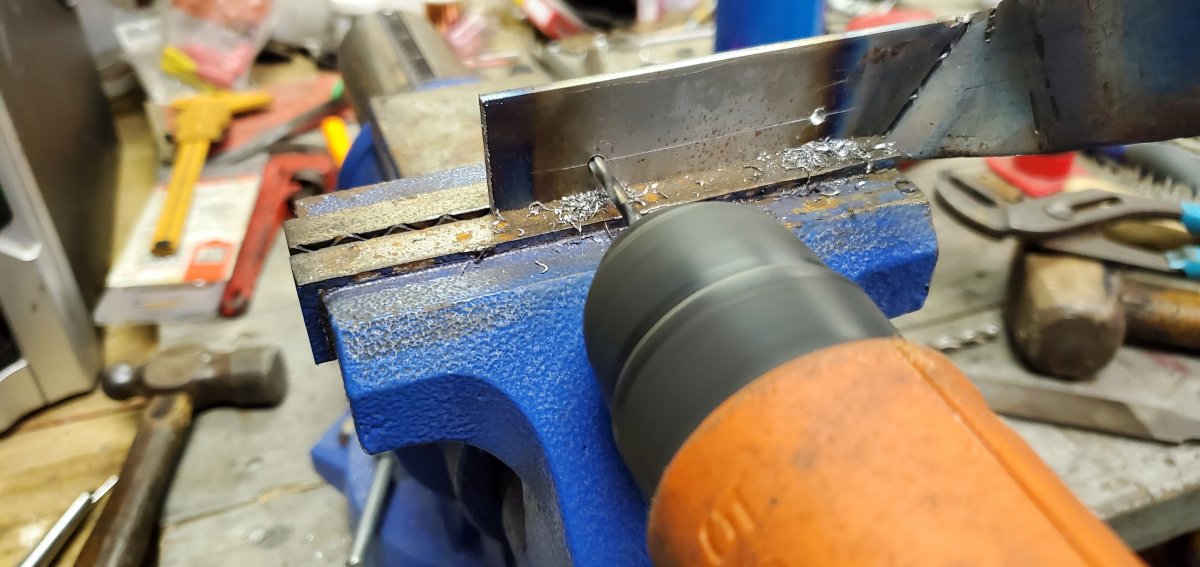

    I bought some steel and started playing with hammers and fire.
    Bent a bracket up to shape.
    More fun, got it all drilled out.
    Stuck it in place and discovered that measuring in that space is difficult and I'd made it about 3/4" too short.
    It did at least prove that most of it was correct, the angles and such so I'll redo that and get the new horn mounted in.
    Phil

    Well, that looks just fine and dandy.
    They're loud, too.
    Phil

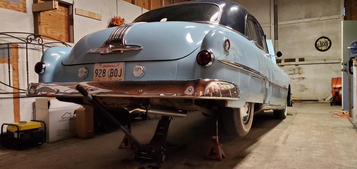

    Tonight's position. Greased the prop uj's and eyeballed the axle, which is going to get a bottle of stop leak/shut-up-treacle dumped into it tomorrow, which will have to do until it gets a rebuild.
    Oil change, brake adjustment tomorrow morning.

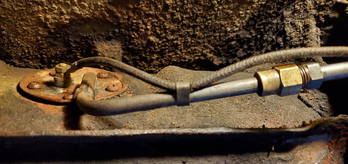

    Yuck. Sender unit was leaking. At least, I think that's the sender unit under that blob of dirt.
    Better. Turns out it was loose. Tightened it up a little, we'll see if it continues to leak.
    Phil

    Oil changed, suspension greased, brakes adjusted, rear axle topped up, fuel tank not leaking.
    Ready to go!
