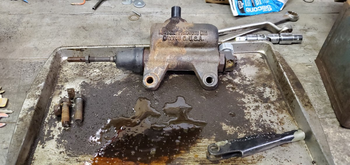

    Went out tonight to fix a couple electrical contacts and saw the brake master had barfed all the brake fluid all over the floor and now the service brakes are inop.
    I'm glad it decided to do that in the garage and not on the highway.
    I'll pull it off and inspect the bore and seals and see what needs doing. Hopefully just seals.

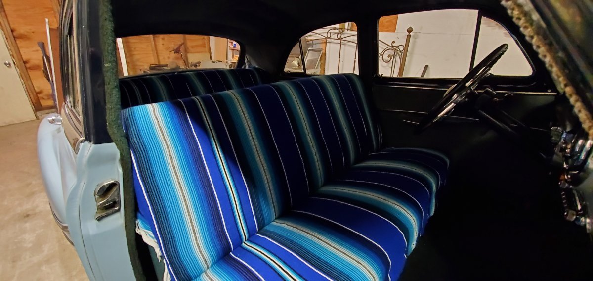

    Wanted a break tonight, and it's moderately cool out (55), so I grabbed my safety pins and went to the garage.
    Pinned the blanket so it won't try take off like it did when I had the windows open.
    Then I looked at the ash tray, which was covered in surface rust and dirt.
    I pulled that out and took the rust and dirt off with a br*** brush, then polished it up.
    I then unscrewed the frame and did the same. Surprisingly, behind the vinyl is the original seat backing!
    I also cleaned the grab rope escutcheons up. I need to make a new grab rope.
    It's a big old car, really. I then turned my attention to the front- the front ash tray handle would always come off when pulled so I found a new screw for it, cleaned and lubricated the runners. Now it pulls out easily.
    I also lubricated the glove box hinges and that pops open like it should when you push the ****on now. This is good because the first thing p***engers do is get in, touch the "Pontiac Eight" script badge, then pull on the ash tray handle. I don't know why, but everybody gravitates towards it.
    Little things, onward and upward.

  22. PhilA
    Joined: Sep 6, 2018
    Posts: 2,107
    PhilA
    Shiny new things arrived in the mail today.
    Phil
  23. PhilA
    Joined: Sep 6, 2018
    Posts: 2,107
    PhilA
    Old one's off. Gotta clean up the fittings that go back on now.
    Phil
  24. PhilA
    Joined: Sep 6, 2018
    Posts: 2,107
    PhilA
    The bits that don't come with the new one, which need to be recycled.
    Threads in the br*** aren't great, which ****s.
    Phil
  25. PhilA
    Joined: Sep 6, 2018
    Posts: 2,107
    PhilA
    New master ***embled on the bench.
    Wiggle wiggle wrench wrench clip adjust.
    Set the pedal height (4 3/8" from toe-board) which stops the cylinder bottoming out and pushing the seal past the fluid inlet and also keeps the pedal at a sensible height in relation to the gas pedal.
    All unions tightened up.
    Next up, shoe readjustment and then fill/bleed.
    Phil

  30. Chief 64
    Joined: Dec 10, 2010
    Posts: 303
    Chief 64
    Phil,
    I am still really enjoying your thread!!
    I chased a similar brake issue on my 1953 Pontiac. It turned out to be the washer on the master cylinder push rod was installed backwards. You can read about it here.
    https://www.jalopyjournal.com/forum...l-4-brakes-lock-up-after-short-drive.1073811/. I fought that issue for weeks until I found it. I was diving around with an infrared thermometer to check wheel temps to find which wheel(s) were causing issue. When it happened I had to wait an hour for pressure to bleed down or loosen a line to relieve pressure. If the washer is backwards it won’t let the pressure out after you brake and it slowly builds up until brakes drag or lock up.
