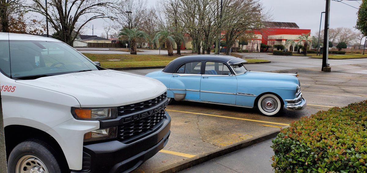

    Out and about today, adding a few miles. Backed the rear right brake off a notch and that seems to have solved it for now.
    A cold start to today, making clouds!
    Drove to work, first time in the office in a while but stalled projects call for some attention.
    Then to the grocery store afterwards. Heater is not bad, not great but at least it works! It's funny to stand back at that distance and watch people's reactions to the car. Some people crane their neck, grab their phone and take a photo, other people wave and smile. Many are totally indifferent because it's just an old car.
    It's also filthy!
    The exhaust downpipe to manifold join sounds like it's leaking so that's on the to-do list now. Everything else is either leaking or weeping with the cold. Blowby is noticeably worse in the cold until it's warmed up properly.
    All part of the fun!
    Phil
