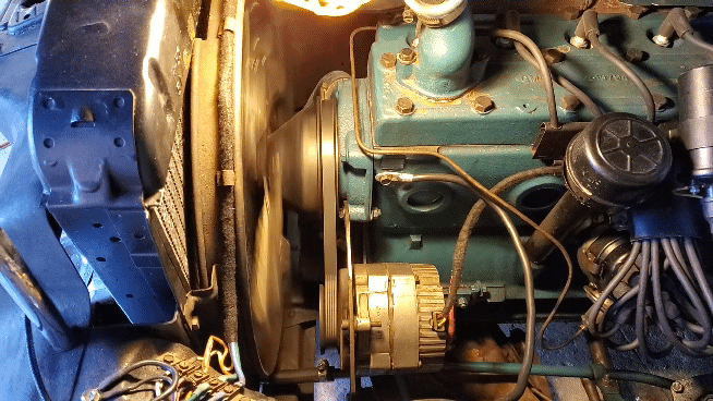

  15. PhilA
    Joined: Sep 6, 2018
    Posts: 2,107
    PhilA
    Today, alternator bracket. I added a quarter inch of adjustment because the pulley needed to be fully squared up.
    Correct fan belt fitted now, which doesn't slip, get a much better charge now.
    I got a replacement under hood light, that was missing courtesy of a previous owner. Rewired it because the wires were falling apart.
    Mounts up to the original holes. This is the 1952 model, the 1951 doesn't have a cover over the bulb; this one is nicely sealed in a gl*** enclosure.
    Lights up when you pull the hood open. Happy with that now.

  22. PhilA
    Joined: Sep 6, 2018
    Posts: 2,107
    PhilA
    ...and now, today, it's making a godawful noise.
    Ran out of time to investigate, it's either the belt, the water pump or the alternator.
    Phil
  23. PhilA
    Joined: Sep 6, 2018
    Posts: 2,107
    PhilA
    Alternator bracket had pulled out of line.
    Took it all apart again tonight and tried to get it to sit true. Mostly successful, though I need to loosen it off and bring it forward a touch, that should get it lined up better.
    The alternator has seen better days though; a replacement is on the horizon for sure. I can't get the pulley off the shaft, someone's mashed the threads up. I'll get a rebuilt one with a 2.5" pulley on which should help with idle charging.
    Phil
  24. PhilA
    Joined: Sep 6, 2018
    Posts: 2,107
    PhilA
    I think that's about as good as it's gonna get.
    Belt makes a schwiep noise every time the area by the print goes over a pulley. It's quiet when I rev the engine then it VVVVvvvwwweeeee on overrun.
    Perplexing.
    Phil

  26. PhilA
    Joined: Sep 6, 2018
    Posts: 2,107
    PhilA
    I spent the afternoon fiddling with the alternator bracket. I redid the roll pins and adjusted the angle it all sits at.
    It's running true now (the angles of the pulley looking slightly off are an artifact of the camera lens and an optical illusion caused by the top bracket not being straight) so it's not making a hissing noise any more but it still whines.
    I think I'm going to swap it for a belt that doesn't have the cooling grooves in the bottom, that should remedy that.
    Slightly more positive cosmetic thing- adjusted the hood stops so the grille lines up again.
    Phil

  29. fyrffytr1
    Joined: Dec 20, 2016
    Posts: 1,719
    fyrffytr1
    You might try spraying the belt with a couple shots of WD-40 while it is running. If it quiets down the belt is the problem, if not it is one of the driven components.
  30. The belt cross section you have may not be compatible with both pulleys... there are different bely/groove configurations. One size does not fit all. Check the nomenclature of the original Pontiac water pump belt vs the alternator belt (if you know its origin). There are several power-transmission supplier websites that give cross section dimensions.
