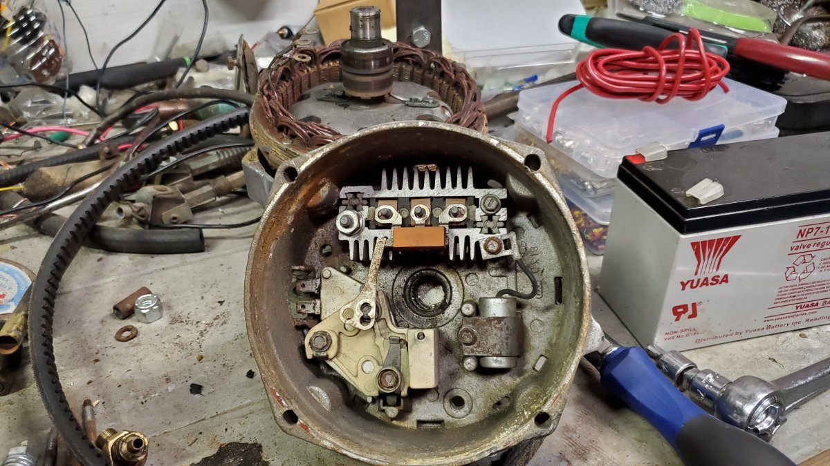

    I had to put in my learning hat- simple things but I hadn't ever taken the time to find out how an alternator actually works.
    The Delco 10SI is a fairly straightforward, run-of-the-mill internally regulated alternator. I can see why it's favored, it's a well designed, compact unit. I tested mine and it was just about putting out some voltage (went from 12.4V to 13.2V when revving the engine) but not the correct 14.4 and certainly not at low RPM. The no-charge light also wouldn't go off.
    So, apart it came.
    The end consists of a few modular pieces. Bottom left, the voltage regulator.
    The orange piece is named "The Diode Trio".
    The black and silver finned part is the bridge rectifier.
    The round can is a capacitor.
    Snagged from the Delco manual above, how is all connected up.
    So, moving a conductor though a magnetic field so it experiences varying magnetic flux will generate an electric current in the conductor. The alternator has a set of windings (the conductor) and a rotating magnetic field created by p***ing an electric current through a conductor (field).
    The alternator increases and decreases the current p***ing through the field winding to increase or decrease the amount of magnetic flux the stator winding experiences. This will increase or decrease the output voltage. The output is 3-phase AC, so is p***ed through the bridge rectifier to turn it into DC. The capacitor is there to absorb any stray spikes of voltage or high frequency noise.
    The output of the stator is also brought out through 3 diodes to make half-wave DC and that is fed into the voltage regulator to allow it to determine how much the alternator is putting out. It also has a sense wire that's connected to the battery to determine the difference between the output and the battery (and it will increase it decrease the current in the field accordingly) to ensure it floats to 14.4V under all running conditions.
    Well, the diode trio went bad. So only a little bit of the voltage the field was generating was making it to the regulator and so it was not raising the voltage in the field to create the correct output voltage.

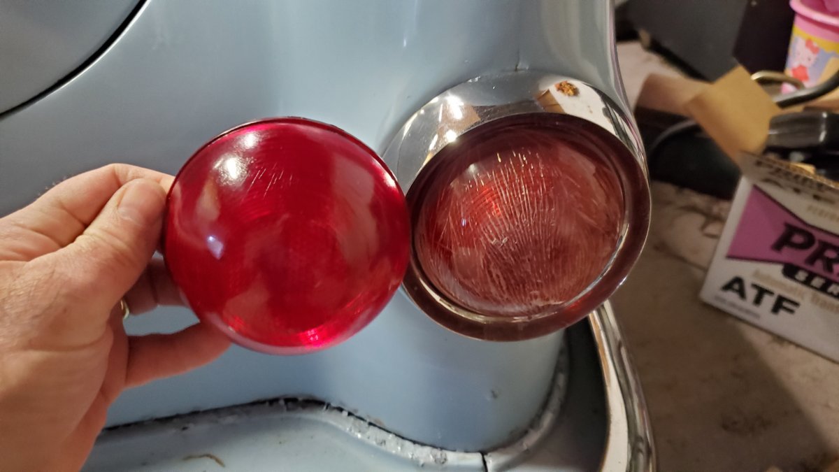

    Tried to cheer up one of the tail lenses. Both are all sun-crazed. Not perfect but it's a reasonable ten-footer.

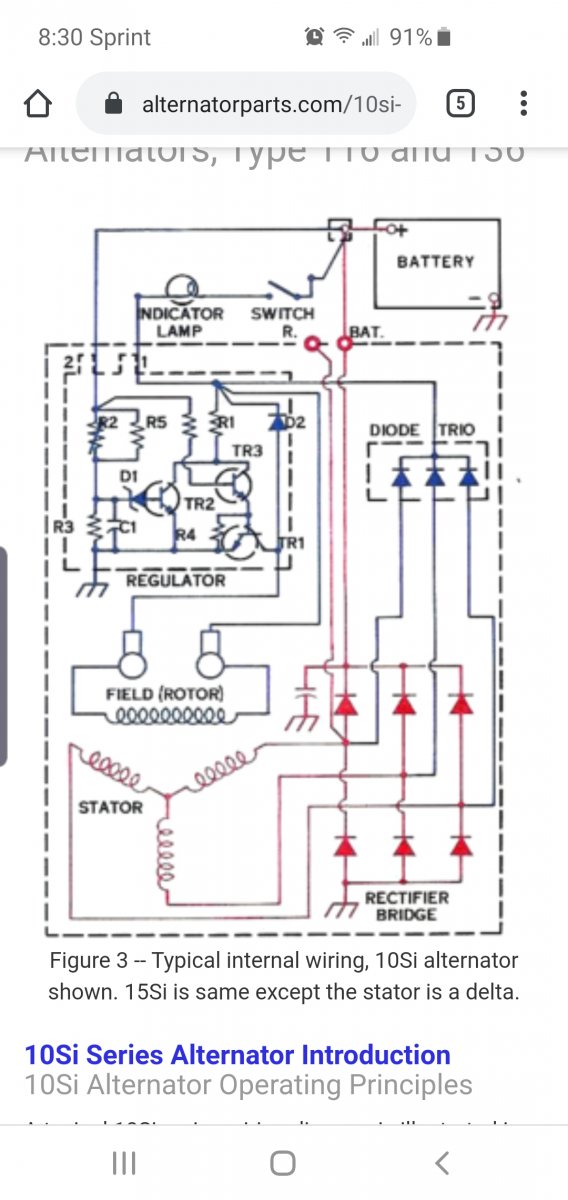

    I think you can get all the parts here.
    https://alternatorparts.com/

    Phil, would you be so kind as to tell us how you "cheered up" the tail light lens. It looks good enough for what I and many others would like, a nice driver!

    Just a little bit of industry light and magic.
    https://www.tamiyausa.com/shop/spray-ts-plastics/ts-74-clear-red/
    Clear red lacquer. Despite saying it is for plastics, it adheres well to metal too.
    Polishes up nicely, that on the wheel trim was straight out of the can before it had time to fully harden. It also brings back a little red to the lens, mine have faded badly and are orange-ish-white.
