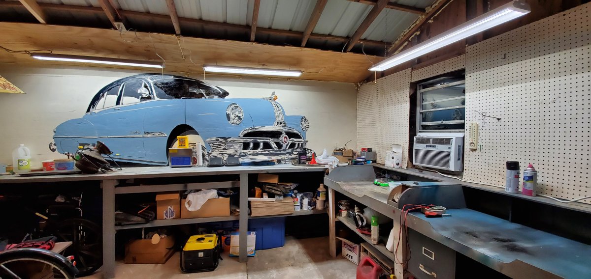

    Busy day yesterday.
    I cleared the last of the hurricane debris (leaves and twigs and junk) out of the workshop, ran some new hard line wires and a couple switches.
    Now the lights are switched independently from outside (good to prevent attracting bugs) and the ceiling fan is on its own switch (again good because I can leave it on with the lights off now to boost the air conditioner).
    New lights also over the benches. It's getting back to being a nice place to work in. Still need to get some ply to put up on the inside of the roof and add a little insulation but it's getting there.
    Phil
  11. loudbang
    Posts: 40,346
    Jeezze you had me going for awhile I had forgotten about the mural and I thought you had made it levitate some how. :eek:

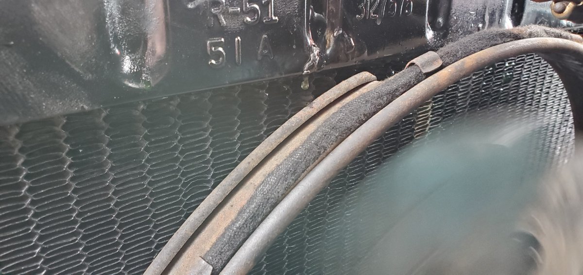

  18. PhilA
    Joined: Sep 6, 2018
    Posts: 2,104
    PhilA
    Had an hour of free time tonight so hit up the garage. It's getting warm outside, plus fog. Interesting combination.
    Something's missing from the front of the car in this picture.
    Ah, there it is. Heavy damn thing to be wrangling out with wet hands. You can see where it's been leaking.
    I employed a little fire and an old wire brush.
    The old solder looks pretty mediocre so I'll get that cleaned up and some new solder on there.
    Cleaned up a few spots where the paint was bubbling off. Yup, a few fractures here too. I'll get those cleaned and repaired also.
    Phil
  19. PhilA
    Joined: Sep 6, 2018
    Posts: 2,104
    PhilA
    Really ugly but hopefully effective repair to the top seam. Pressure test with soapy water tomorrow if all goes well. It's loaded really heavily because I had to bend the seam out and dollop metal in because the old solder was fighting. I have a feeling it was silver soldered before and that doesn't like to mix with lead much.
    Phil
  20. PhilA
    Joined: Sep 6, 2018
    Posts: 2,104
    PhilA
    Tonight's toolkit: soapy water and an air line.
    Just like checking a tire, spray down, apply air pressure and check for bubbles.
    Repair the sections that are bubbling until they bubble no more. That's holding 7psi, there.
    Hopefully that'll last a little while. I'll paint it once it's dry tomorrow.
    Phil

  22. PhilA
    Joined: Sep 6, 2018
    Posts: 2,104
    PhilA
    It requires a very concentrated heat, my big butane flame wasn't any good, hence this small one. I can make a dot of heat about 0.5cm around with it, which is needed else the area tends to heat up too much and the solder all ******s off onto the floor in a fraction of a second. Plumber's flux helps get things to stick and I used regular 60/40 lead/tin solder.
    It does not stick if someone's used silver solder, at all. It'll just bead and fall away like a ball bearing if so. That's why I had to fold the seam open so it could be scrubbed with a steel brush to get it clean enough.
    (Seen here with sharpened screwdriver)
    Takes practice, grab an old sheet of br*** and try though. It's a useful skill.
    Heat the br***, once it starts to turn burgundy it's getting to be hot enough. Move the flame away, touch the solder. If it doesn't melt, a few more seconds of heat, hold flame back a few finger's width and touch solder. It should start to melt. Fan the flame side to side rapidly as the solder begins to melt, daub then twist your wrist to flick the flame away as soon as the solder pools. That all happens in maybe a half second to a second, maximum. Too much heat and the solder goes full liquid and will like gravity more than it likes sticking to the metal.
    Phil

  23. fyrffytr1
    Joined: Dec 20, 2016
    Posts: 1,656
    fyrffytr1
    I cheated on my radiator and used J B Weld to repair three small cracks in the tank. Not very pretty but it worked.
    PhilA and loudbang like this.

  25. goldmountain
    Joined: Jun 12, 2016
    Posts: 4,850
    goldmountain
    You need to solder onto clean metal. You are dealing with 70 years worth of scale build up.
    Sent from my SM-T350 using The H.A.M.B. mobile app
    loudbang and PhilA like this.
  26. BJR
    Joined: Mar 11, 2005
    Posts: 11,248
    BJR
    The local radiator guy that I used to use before he died used to sand blast the area he was going to solder with a hand held small blaster. It cleaned the metal so the solder always stuck well.
  27. PhilA
    Joined: Sep 6, 2018
    Posts: 2,104
    PhilA
    It was scrubbed as well as I could with a steel brush, then blown out with an air line, fluxed and heated but it still decided to be difficult.
    I bought some smaller brushes and will have a go at doing it again.
    Phil
    loudbang and MUNDSTER like this.

  29. David Gersic
    Joined: Feb 15, 2015
    Posts: 2,812
    David Gersic
    from DeKalb, IL
    Maybe move up to a wire wheel on a Dremel to clean out the crack? Also a Scotchbrite pad on a Dremel to clean the area to bare metal might help.
