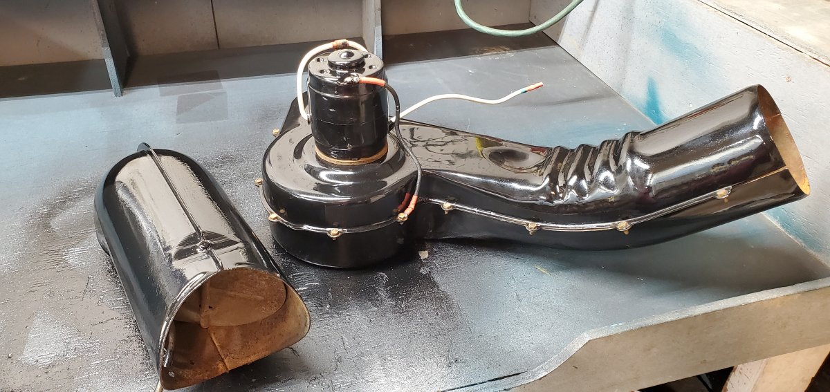

    Wiped the dirt off one side of the fan clamshell with a damp cloth. It came up looking nice.
    Knocked the old underseal off where it was still attached to the ducting.
    Wire wheel, cup brush...
    Looking more presentable and protected.
    I like gloss black.
    Phil

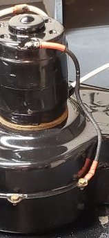

    Rewired, re***embled and now reinstalled in the car. It works.
    Old electrical guy here, had lots of ground problems... - Is this fan housing well grounded? Maybe another ground wire to a body ground.
    Looks great,
    Russ
  11. PhilA
    Joined: Sep 6, 2018
    Posts: 2,107
    PhilA
    It is, that is duplicate of the original wiring. The inner clamshell is very well bonded to the car, that brings the rear housing of the motor (which is the shortest ground point and also because the motor is mounted on rubber) to a well grounded location.

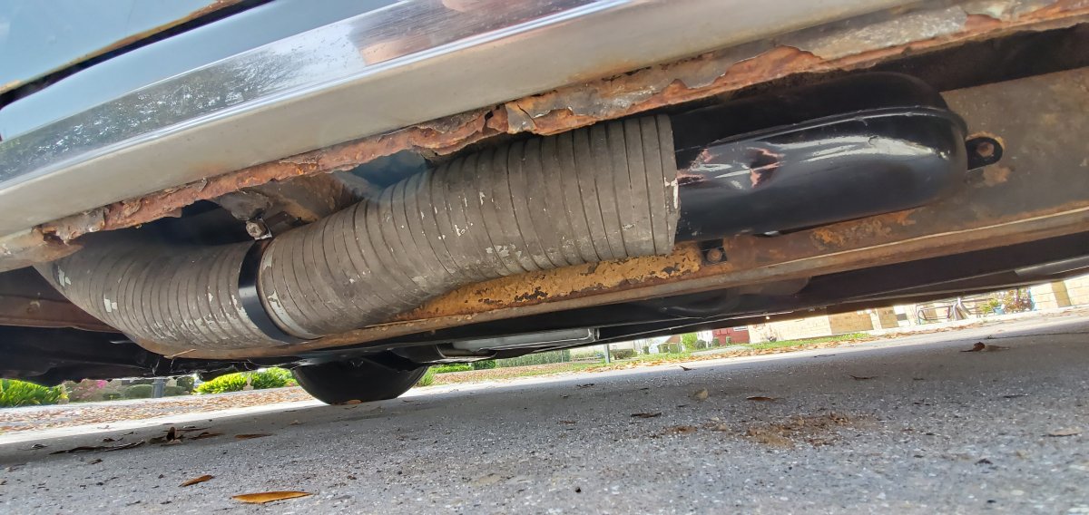

    Fan intake pipe, up in the wheel well.
    Floor heater duct and pipe. I had to lower the car down onto a jack stand under the pipe to bend it to the correct shape- it was a few inches out of line and I couldn't tighten the bracket.
    Finally, the fan. Best picture of it, all tucked away down the back of the engine compartment.
    Phil
