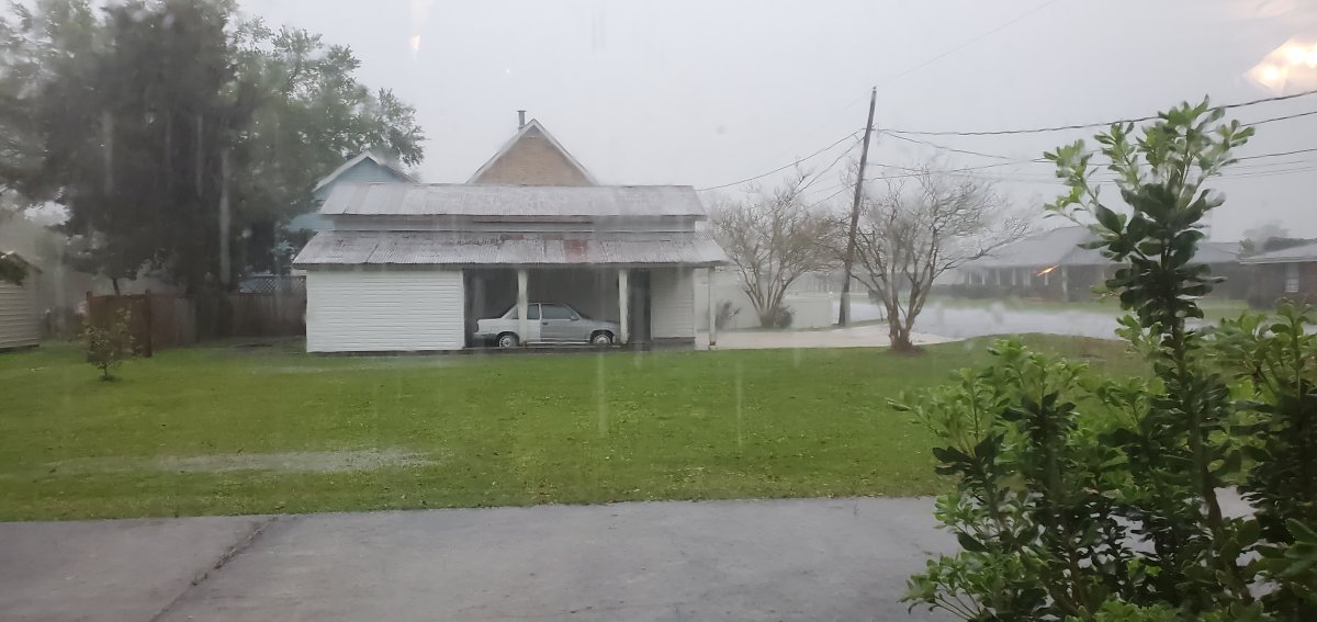

    Yesterday afternoon it started to rain- first time in a couple months.
    Then it continued.
    And continued
    And it's still going this morning
    Found a couple of leaks in the garage since the storm. One there and the other is conveniently leaking right into the electrics.
    Forecast says this should be stopped by tomorrow, maybe.

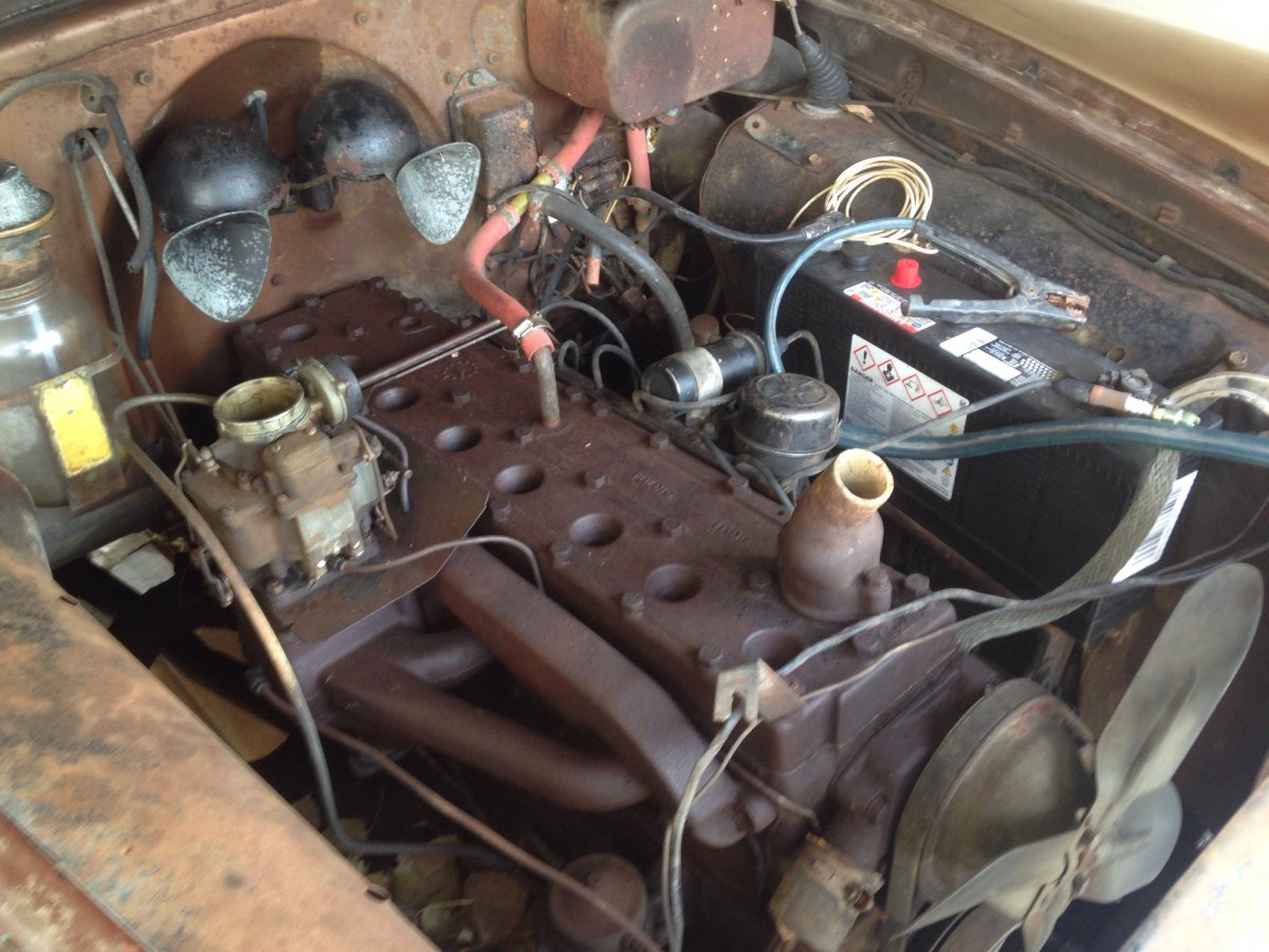

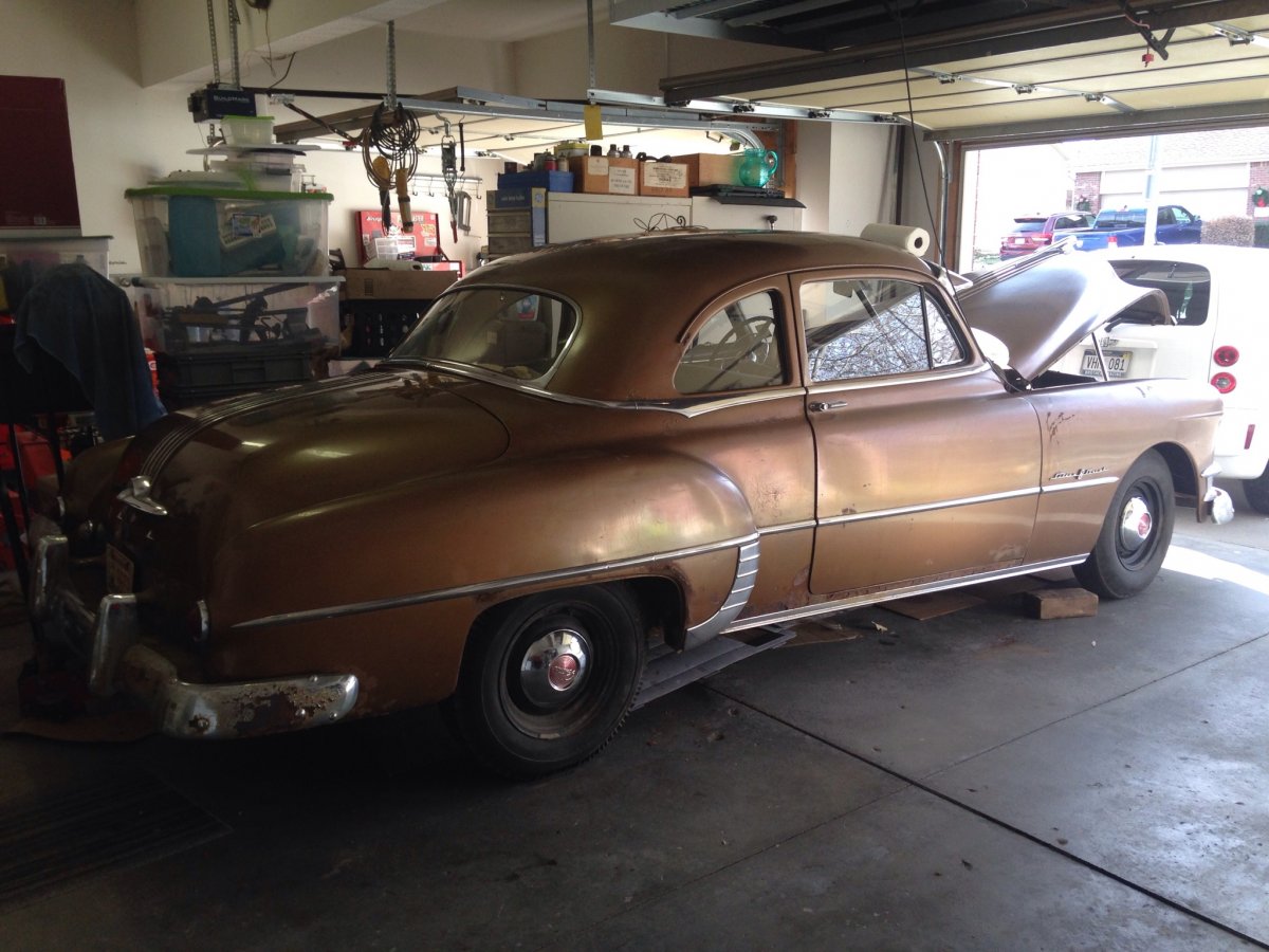

    I lit off the engine again in my 50 coupe this afternoon. It appears the straight 8 isn't going to miraculously heal itself. Damn! 50pont12_2020.jpg 50pontengine.jpg

    Shame, but at least it's a simple enough engine to work on. You'll have it running well in no time at all.
