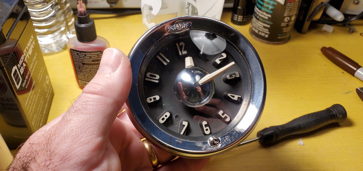

    So, I said I would attempt to repair the non functional clock from Nik's car because it's a nice feature of the center of the dash and I like having a clock, particularly one that works...
    First order of work, take it apart, check the coil (good), check the points (bad), clean the points and test.
    Then a jolly good clean.
    Pull the (frankly nasty) old paint off the hands,
    And put a new coat on. That's drying overnight and can go back together tomorrow.
    Next fun part- the fast/slow mechanism is missing a gear and the adjuster knob is sheared off. That's gonna be fun to fix!
    Phil
