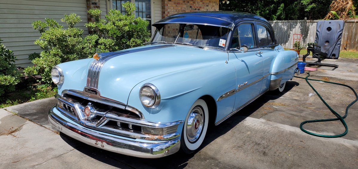

    Haven’t tried yet but I don’t expect my cars window seals to handle a garden hose unfortunately. Got any leaks?

    Uh. Yes? It leaks like a sieve. I just take care where I'm putting the water on it!

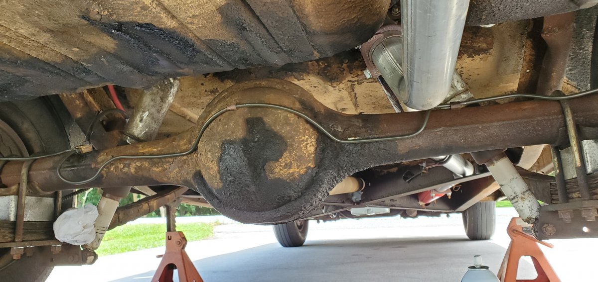

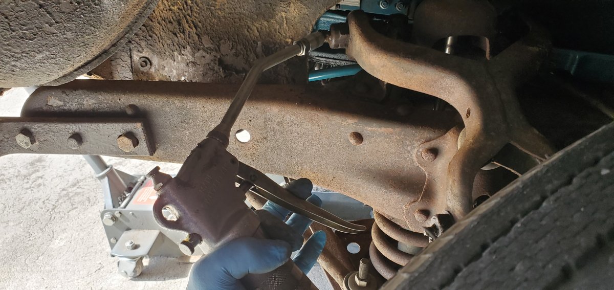

    All the way up in the air.
    Click, click. That's better. Doesn't take much to screw up brake adjustment on these.

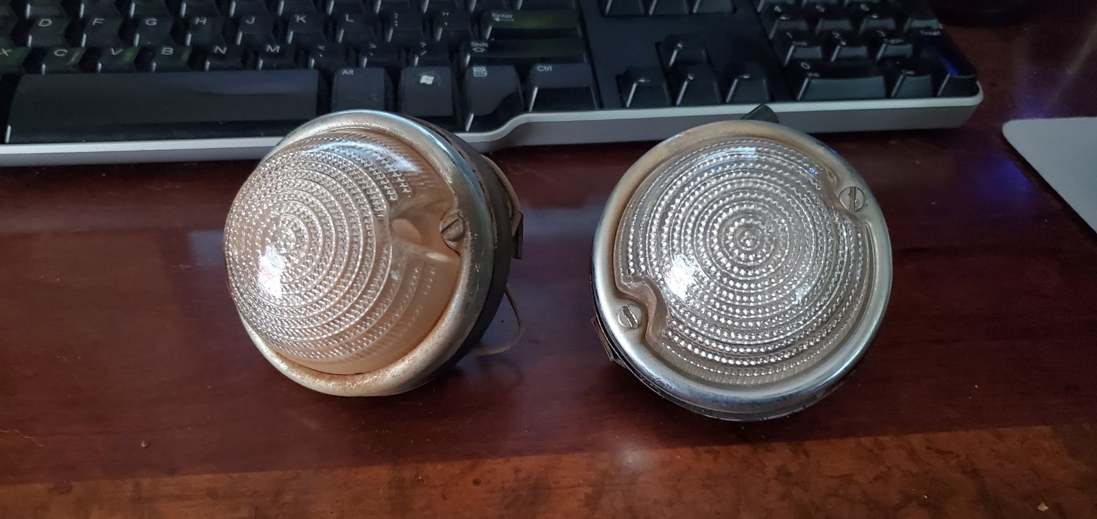

    However, today an unexpected box from our very own @302GMC! Reversing lights!
    Thank you!

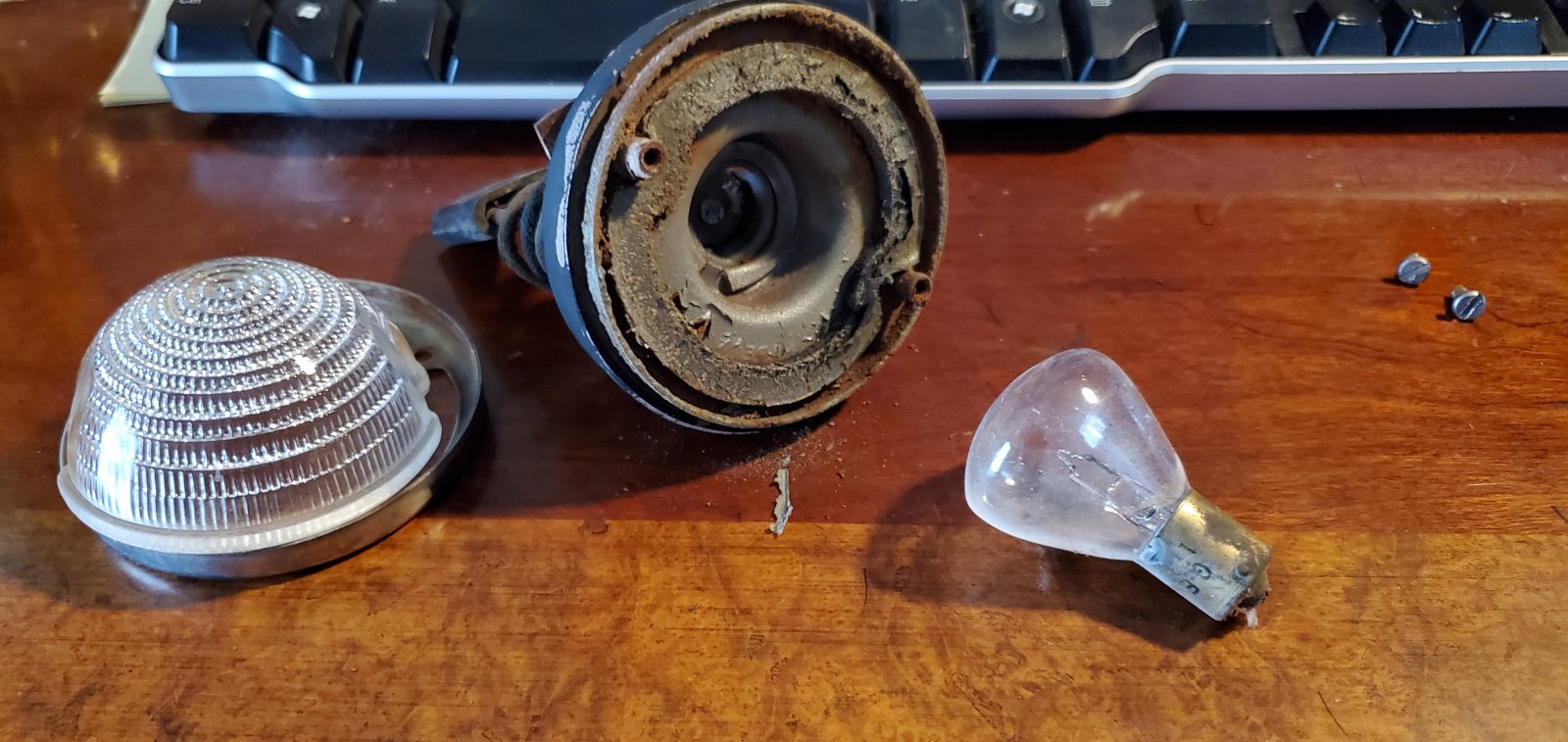

    I managed to pull the lights apart without shearing anything, they both had an old style bulb in (both blown) and are in really very good shape, just in need of a clean.
    Whizzed the rust off and gave a coat of paint. That's drying now, I'll see about fitting them afterwards.
    Phil
