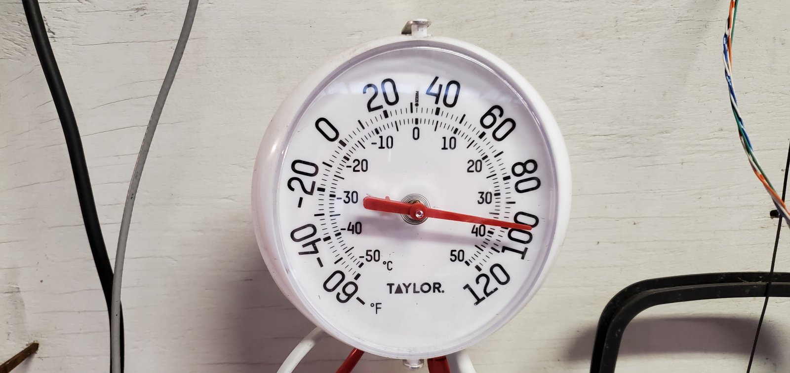

    PhilA
    I tell you this, it really doesn't like this temperature.
    Went test drive again and got an old fashioned cherry coke (with chunks of cherries in!). Ice cold drink on a day like today is appreciated...
    Phil

    Agreed- it's definitely a heat vs. oil issue- the main line pressure remains a stable 60psi in forward gears even when it's misbehaving. I have actually been trying different oils, currently have a higher weight "high mileage" right now which is a little better.
    However, it still does it from cold occasionally.
    Pushing my foot down on the gas briefly while in 4th (to the 4-3 stop but not forcing the shift) before coming to a halt seems to make it cycle correctly down through the gears and not get hung up. After that, it'll change up sequentially (rather than the 1-3-4 jump it likes to do).
    I think that the valve block doesn't bleed enough fluid to keep it cool, and the soaked heat just adds up, coupled with the fact the valve block is (let's face it) very worn.
    Admittedly, in 35 degree weather it behaved very well, compared to today's 100 degree, but overall today it's improved and I've solved 2 of the 3 issues it had, and improved on one.
