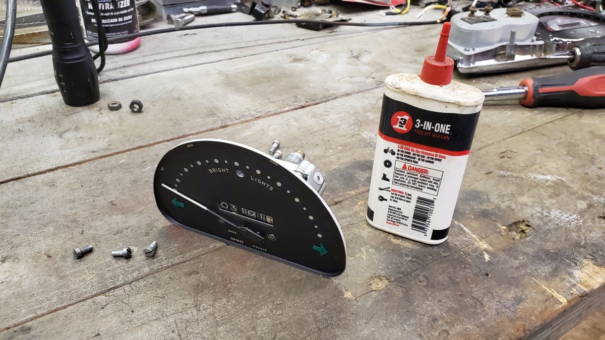

    PhilA
    The tenths click over accurately, I took it to the back of the street and back a few times, which is a measured known distance. That part is good, it's got the correct drive gear and the correct height tires.
    The needle just over-reads a lot.

  5. vtwhead
    Joined: Oct 20, 2008
    Posts: 5,304
    vtwhead
    dunno but maybe the spring is weak and letting the needle be driven quicker. :(
    PhilA and loudbang like this.
  6. PhilA
    Joined: Sep 6, 2018
    Posts: 2,106
    PhilA
    I'm thinking that may be the case, or it's slipped.
    I'm going to pull it apart and see.
    Phil
    mrspeedyt, chryslerfan55 and loudbang like this.
  7. PhilA
    Joined: Sep 6, 2018
    Posts: 2,106
    PhilA
    I see why!
    I must have nudged the needle when I had it apart, it's catching on the backplate.
    Phil
    mrspeedyt and loudbang like this.

  10. PhilA
    Joined: Sep 6, 2018
    Posts: 2,106
    PhilA
    I know why, thinking about it. The speedometer drive cable has a bit of a twist to it and the needle used to wobble- it's being flicked and it's not totally free to move so it's hitting the "peak" value of the wobble.
    Freeing the needle up should help. Won't help the wobble but eh. I can live with that.
    Phil

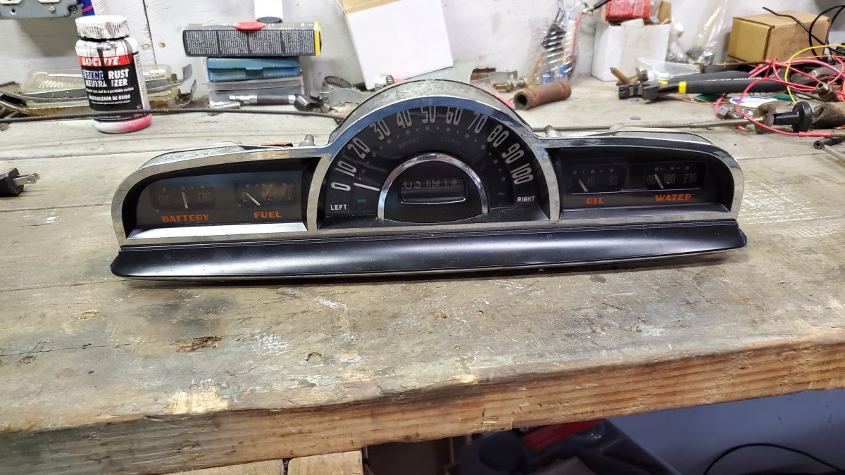

  13. PhilA
    Joined: Sep 6, 2018
    Posts: 2,106
    PhilA
    Dashboard out again. I'm getting used to doing it now.
    Out on the workbench, spun over with my electric drill and it's showing to not like to move at the lower end of the scale, below about 25-30.
    Pulled it apart further- the spindle just needed more oil. I had put some on a while back but was very sparing and don't think it had quite enough to get in the bearing fully. Now it moves quite nicely.
    Re***embled and driven down the street, it reads reasonably well. Probably could do with fine adjustment but that's for another day.
    Phil

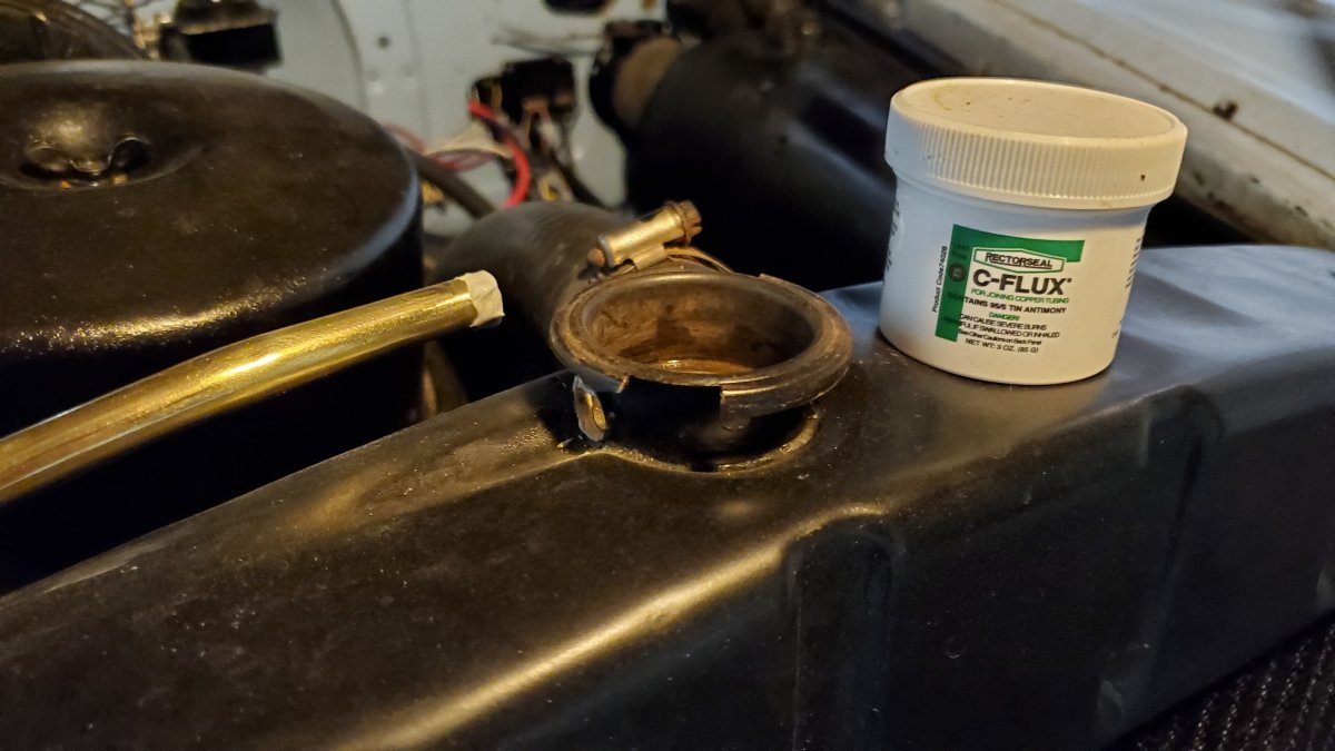

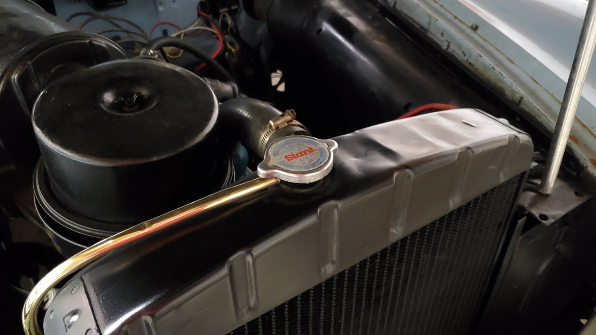

    Tonight, a few minutes spent in the garage. Took a piece of co**** sandpaper and cleaned the hole the overflow tube fits in and the tube itself.
    All back to clean shiny metal. Very important it's clean.
    Application of plumber's flux ***ists in cleaning the joint thoroughly. ***embled the parts.
    Fine concentrated butane flame to heat up the joint until the flux bubbles away.
    Then, remove flame and sweat the 60/40 solder in.
    The radiator cap was grubby. Cleaned it up also.
    Blah blah clean and shiny. Also functional. Boring? I guess, but I'm on low-budget stuff until the end of the week.

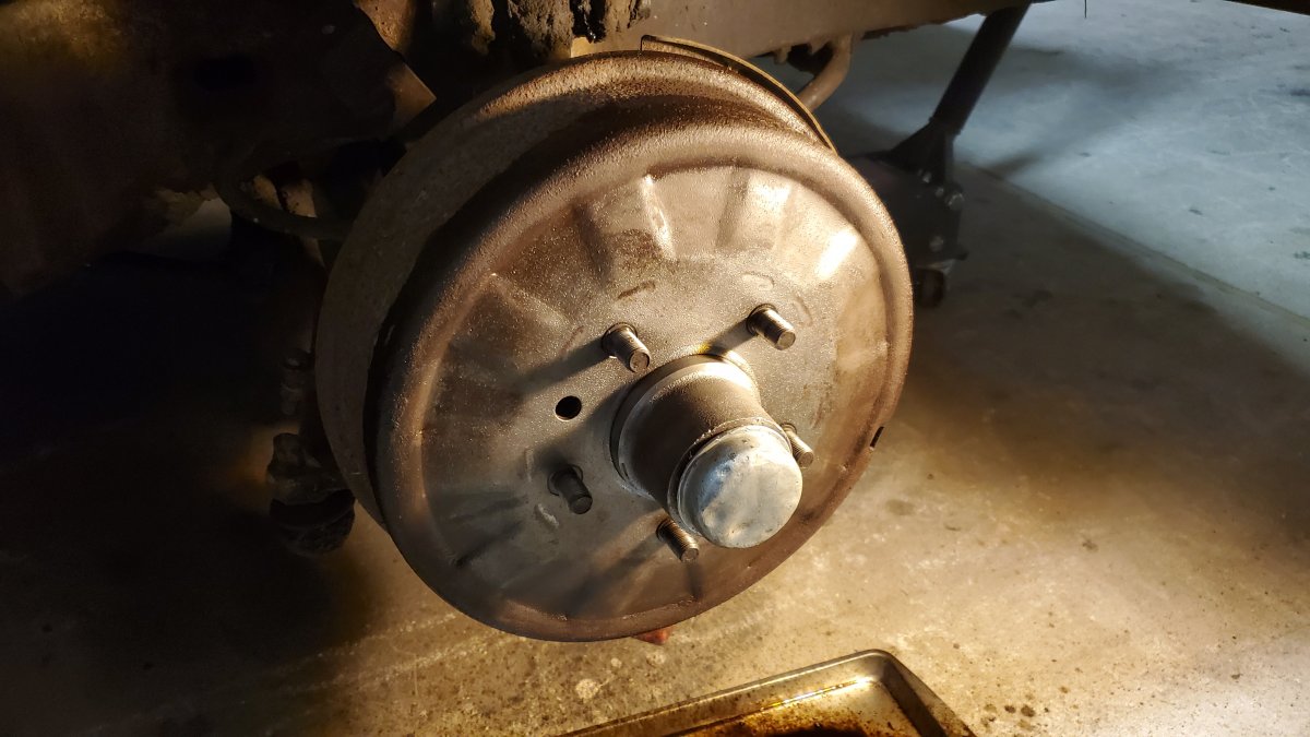

  15. PhilA
    Joined: Sep 6, 2018
    Posts: 2,106

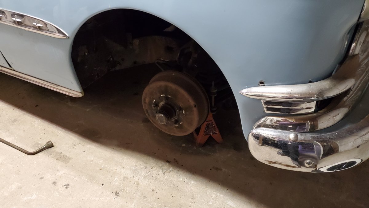

    PhilA
    Tonight's task, only a small one. Jack car up, inspect brake.
    There's a lot of grease and **** all over and the hub looks like the drum fits over it rather than being an integral part.
    However, it doesn't want to shift.
    Does the drum come off separate to the hub? Manual is glib "remove brakes", gee thanks.
    Phil
  16. PhilA
    Joined: Sep 6, 2018
    Posts: 2,106
    PhilA
    Ok. Fronts are integral and sit on the stub axle.
    Rears come off independently and slide over the studs.
    Phil

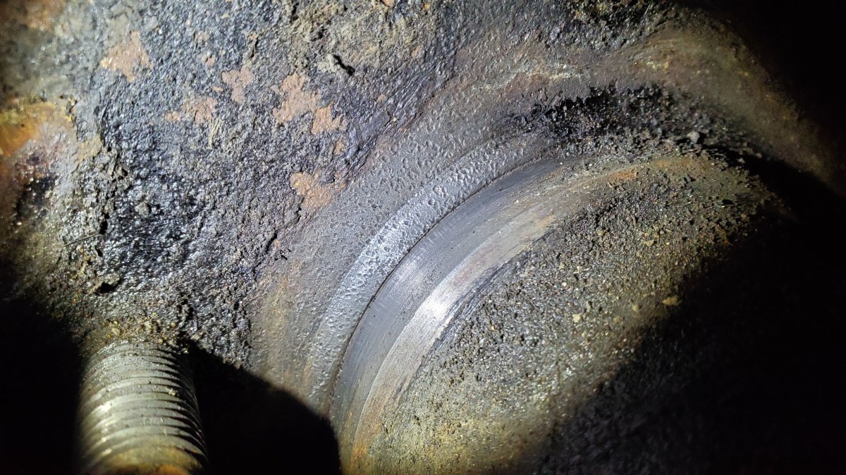

  17. treb11
    Joined: Jan 21, 2006
    Posts: 4,126
    treb11
    If the front drums are reluctant to come off, there is a lip worn into the drum that the shoes are hanging on. Reach into the backing plate from behind and slacken the adjuster to pull the shoes inward.
    Sent from my SM-G965U using The H.A.M.B. mobile app
    loudbang and PhilA like this.
  18. PhilA
    Joined: Sep 6, 2018
    Posts: 2,106
    PhilA
    A very helpful reminder, yes. I'm used to sixties cars onward, this is the first vehicle I've owned with drum brakes up front. I've had to back shoes off before in very worn rear brakes but the fronts on this are going to have taken a beating, I'm sure. I may have to get them turned a little because this one catches at 12 and 6 o'clock and is free at 3 and 9.
    Not hugely but enough to let me know it's not quite true.
    Phil
  19. goldmountain
    Joined: Jun 12, 2016
    Posts: 4,853
    goldmountain
    I would take off the big spindle nut and pull the drum with the hub attached. You do plan on cleaning and repacking the wheel bearings?
    Sent from my SM-T350 using The H.A.M.B. mobile app

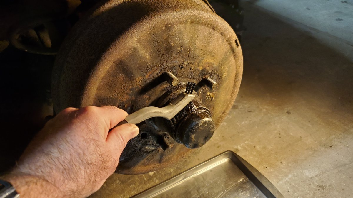

    Thirty minutes tonight after everything else done. Better than nothing, I figured.
    Grabbed a brush and some gasoline and started cleaning up the front right brake in preparation to take the drum/hub ***embly off.
    When, in the history of never, has anybody just scrubbed at anything to do with wheels and brakes and it's come up clean?
    The mind boggles. I need to get a can of brake cleaner spray and some copper grease.

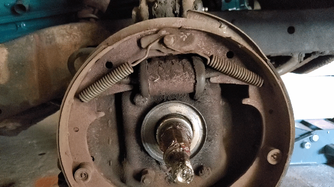

  25. PhilA
    Joined: Sep 6, 2018
    Posts: 2,106
    PhilA
    Just ordered a distributor cap and the diode trio for the alternator.
    The former is due Monday, the latter Wednesday. Hopefully that'll improve the running a little and might even make the alternator charge. We'll see.
    Weather's been a bit warm to do much in the garage, so a few minutes late in the evening swatting at *****ers hasn't been much fun recently. However, one of the kids is off to camp with the scouts for a few days so a quiet(er) weekend beckons.
    I want to see if both shoes move and if the adjusters are free. There doesn't look like too much friction material left on the shoes (but they do look to be worn evenly).
    Phil
  26. PhilA
    Joined: Sep 6, 2018
    Posts: 2,106
    PhilA
    Freed the leading shoe up and exercised the pistons a little. Lower adjuster isn't frozen solid either, which was a surprise.
    Phil
    y'sguy, mrspeedyt, Woogeroo and 5 others like this.

  29. PhilA
    Joined: Sep 6, 2018
    Posts: 2,106
    PhilA
    Bearings cleaned and repacked with fresh grease.
    Moving surfaces inside brakes given a light smear of funny brake grease.
    Put it all back together, discovered the large locknut on the top adjuster is seized solid. Tried a bit of heat, no joy. Gonna apply PB to the threads and hope it clears. Between then I need a bigger 15/16" wrench.
    It's not a setback. I now know why that brake is really poor. That's a good thing and I can fix it.
    Phil
  30. PhilA
    Joined: Sep 6, 2018
    Posts: 2,106
    PhilA
    Borrowed a 15/16" 1/2" drive impact socket from my neighbor and managed to liberate the locknut.
    Cleaned it up
    Painted it black
    Also, with another not inconsiderably large force, freed up the top anchor adjuster. It now can be set with a regular 7/8" wrench, and allows for the leading shoe to be set in place and the trailing to be tweaked to give 0.015" clearance.
    Waiting for the nut to dry. I might make the special tool spatula thing to turn the lower adjuster with, will be easier than doing it with a screwdriver.
    Phil
