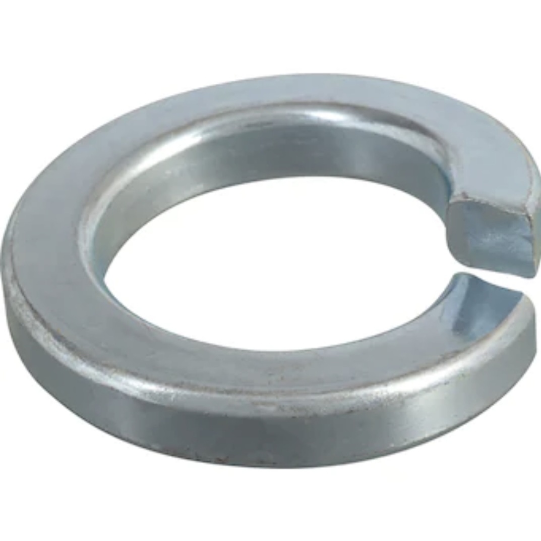

  23. PhilA
    Joined: Sep 6, 2018
    Posts: 2,107
    PhilA
    Food for thought.
    A discussion elsewhere on this topic has made me think. The screws that fell out were fitted with this type of washer.
    I'm told though that split ring lock-washers apparently "do nothing".
    GM fitted them. (Well, Carter did). If they aren't at least beneficial, I would like to say they'd save the nickel and leave them off?
    Phil
    bchctybob and Stogy like this.
  24. Stogy
    Joined: Feb 10, 2007
    Posts: 27,207
    Stogy
    I forgot it's a Straight 8...split ring lock washers that's all I'm using on the Ole Hotrod...I find some newer lock washers are oversize to the stud or thread dia. I do periodically run a screwdriver over them to check if they need more torque...They do lose their spring after several uses...so if they are flat or near to...in the s**** they go and I replace them...perhaps a little Loc***e on the Threads but not the permanent, it might be the blue...with red being the serious aka permanent one. I don't use any Loc***e myself...maybe the gasket settled with heat and cooling and the screws came lose...
    bchctybob and PhilA like this.
  25. PhilA
    Joined: Sep 6, 2018
    Posts: 2,107
    PhilA
    Quite possibly, they are holding two parts together that are made from dissimilar metals so there's a coefficient of expansion at play.
    Stogy likes this.

  27. Stogy
    Posts: 27,207
    Stogy
    Knowing my Hotrod is what I often reference in its primitive makeup as a horse drawn wagon with an engine I often do walk arounds touching components to find anything loose because it does happen...
    I was just thinking you could actually run a Screw that protrudes the other side and put a lock washer and nut for extra security after torquing it from the top.
    If the surface underneath is not flat...no to that...I'm pretty sure that's never going to happen again as those will be the point of focus going forward...
    It runs better too...great!
    v8flat44 and PhilA like this.
  28. PhilA
    Joined: Sep 6, 2018
    Posts: 2,107
    PhilA
    I just gave them all a little more in the way of lubs-fut than I did before. Hopefully they stay put. Just one to keep an eye on- mostly because of the fact I had dismantled it...
    Phil
    brEad and Bruce A Lyke like this.
