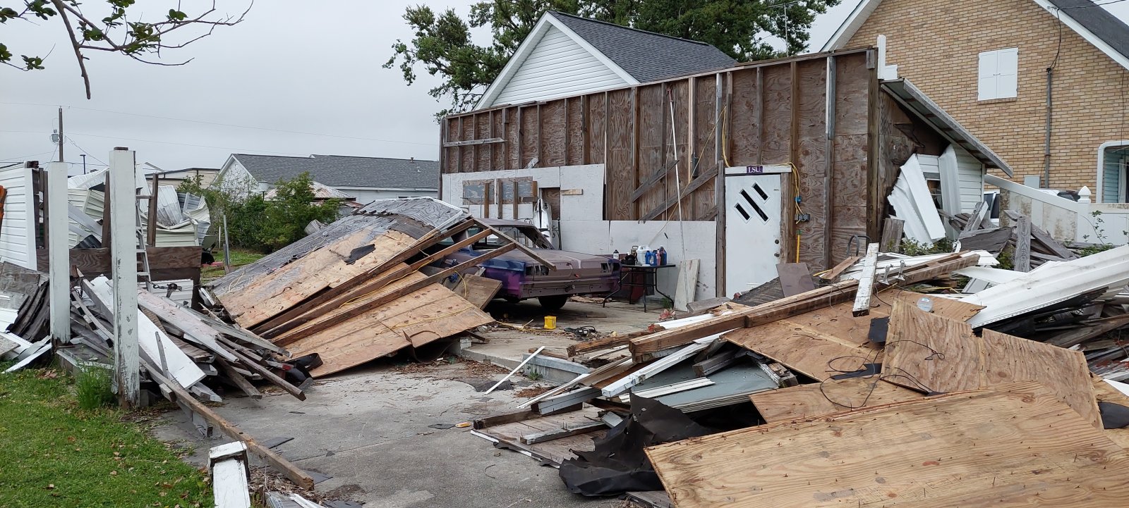

  10. Holy*****, man, you took a HIT! Hope you managed to save the mural.
    Stogy and PhilA like this.

  12. PhilA
    Joined: Sep 6, 2018
    Posts: 2,104
    PhilA
    Tornado. The mural survived, it's behind the door in the workshop, the only part of the building still standing.
    I need to pull it all down and start over, the remaining parts are all twisted.

  14. PhilA
    Joined: Sep 6, 2018
    Posts: 2,104
    PhilA
    Hey. It is what it is. Pick yourself up, dust yourself off and start fixing up.
