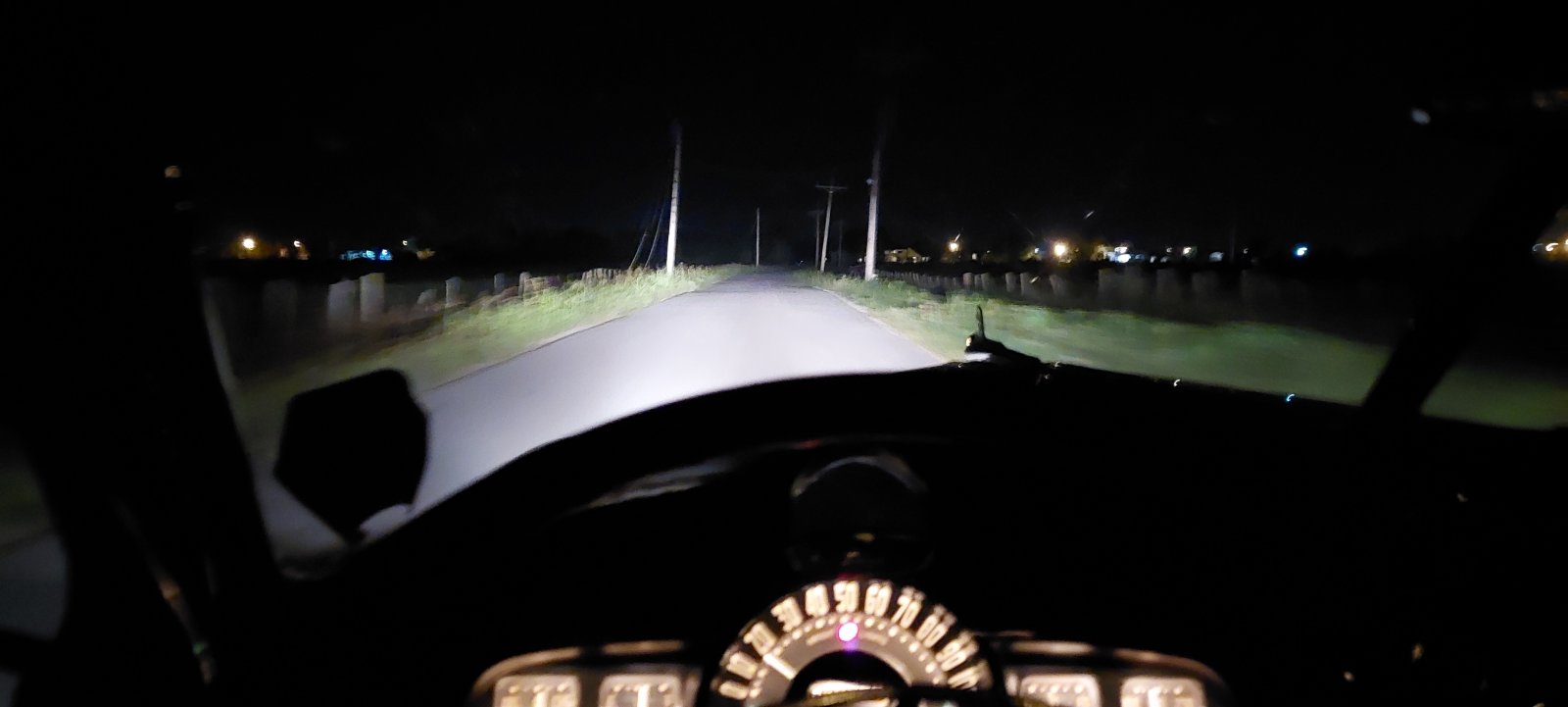

    Wife, dog and I went get milkshakes this evening, which was most pleasant.
    Tonight it's rather cool (by standards down here, at least) so I decided to go properly set up my headlight aim.
    I head out down the only quiet, unlit road around here which is way out in the sticks.
    I set up the lights, put the trim back on. Twist the key, push the starter and it just cranks with no fire.
    Try again and it rapidly slows, the headlights getting real dim. Shut everything off, pulled the fuel pump switch. I hear the pump spin fast then load down- I guess the float bowl evaporated off. Tried the starter again, churning slowly then one pot fires, then again... suddenly it fires into life. I give it a few good kicks of the pedal to make sure it damn well knew it needed to stay running, then dropped it into gear and head home.
    New battery time, methinks.
    Phil

  14. v8flat44
    Joined: Nov 13, 2017
    Posts: 1,211
    v8flat44
    Phil, love "the night ride" pic. Love the dash. Oh, and times two on what tubman said. Keep on keeping on.
    PhilA and Bruce A Lyke like this.

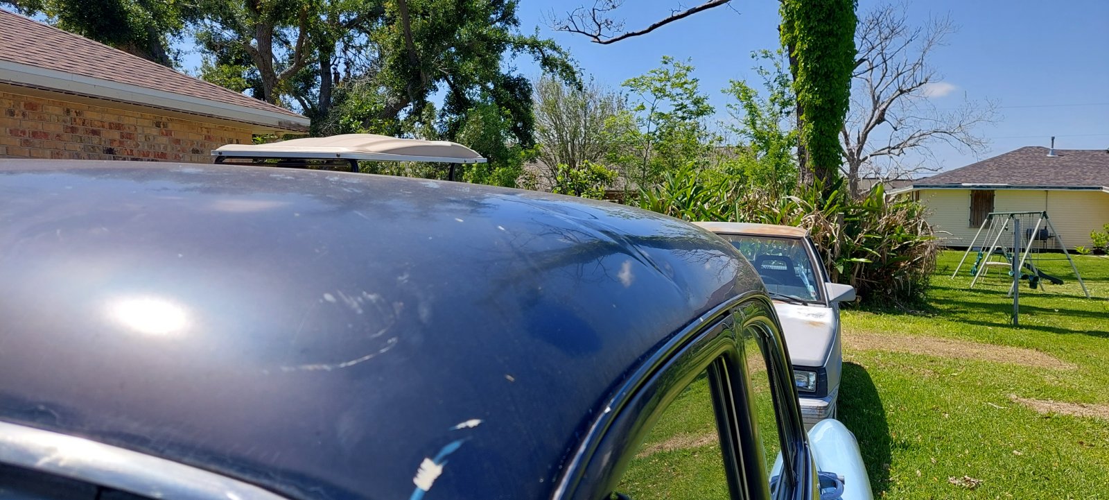

  22. Have you checked out a 'paintless dent repair' outfit? I don't know how much success they'd have with the early steel, but it could possibly save the paint. My local guy here has worked near-miracles on my late model DD a few times.
    PhilA likes this.
  23. PhilA
    Joined: Sep 6, 2018
    Posts: 2,107
    PhilA
    I was considering it but the paint is way gone already; really the car needs painting again.
    I may see, because the roof has some creases. If they cannot, I'll buy myself a pin welding jig and slide-hammer the dents out.
    Phil
