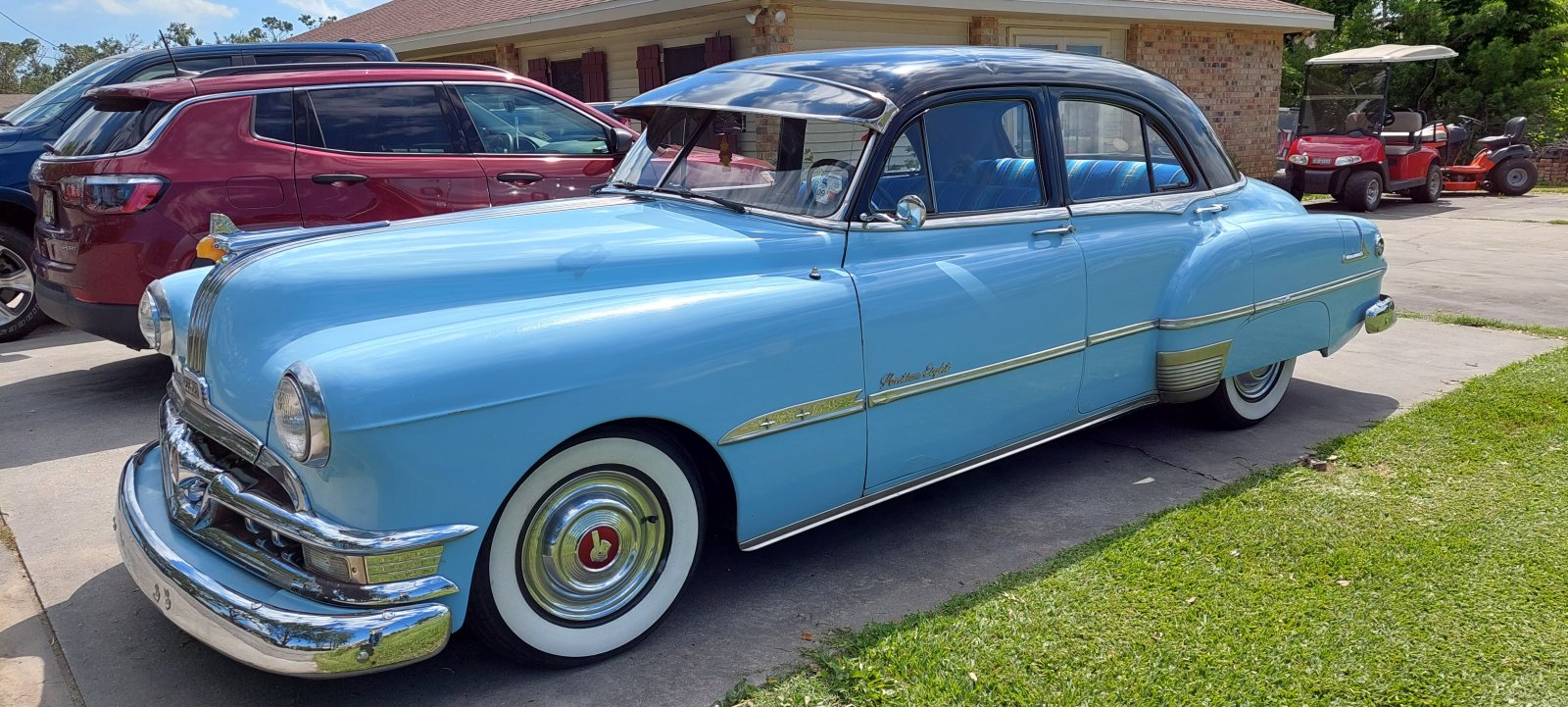

    Divided opinion time!
    Refitted the sun visor.
    Phil

    I'll bet opinions will heavily favor the visor!

  11. 51pontiac

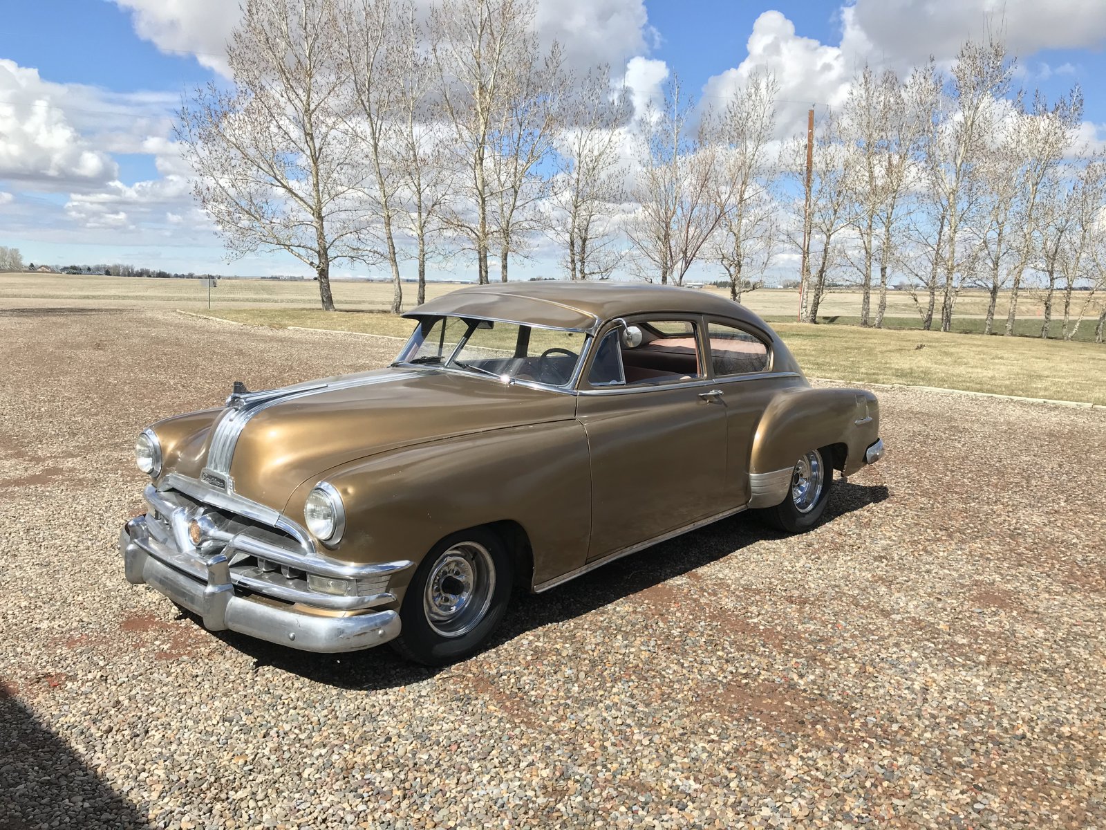

    This should tell you my vote…your car is looking good! 60C83389-1BBE-4245-85E6-8FDDD31C3AF6.jpeg

    PhilA
    Yours too.
    Though, yours has quite the different look; if I'm not mistaken, those are '54 front fenders which have a really sweet shape to the wheel arch.

  13. 51pontiac
    Joined: Jun 12, 2009
    Posts: 502
    51pontiac
    from Alberta
    My car is a Canadian version called a Fleetleader Deluxe.. basically a Chev Fleetline D0370B26-DBD2-4F86-BA78-3026B27AE6D2.jpeg EBFAB7F2-DBB7-424D-9F7F-E4B16E20C6FA.jpeg EC67530F-EEDE-49A8-9D91-6131C2B96679.jpeg that had originally had a flathead 6 and the Pontiac trim. That makes it easy to get suspension parts etc. I actually put a Chev fender on the one side when I first built it in the early 70’s to replace a banged up original…only required a few holes drilled for trim.
