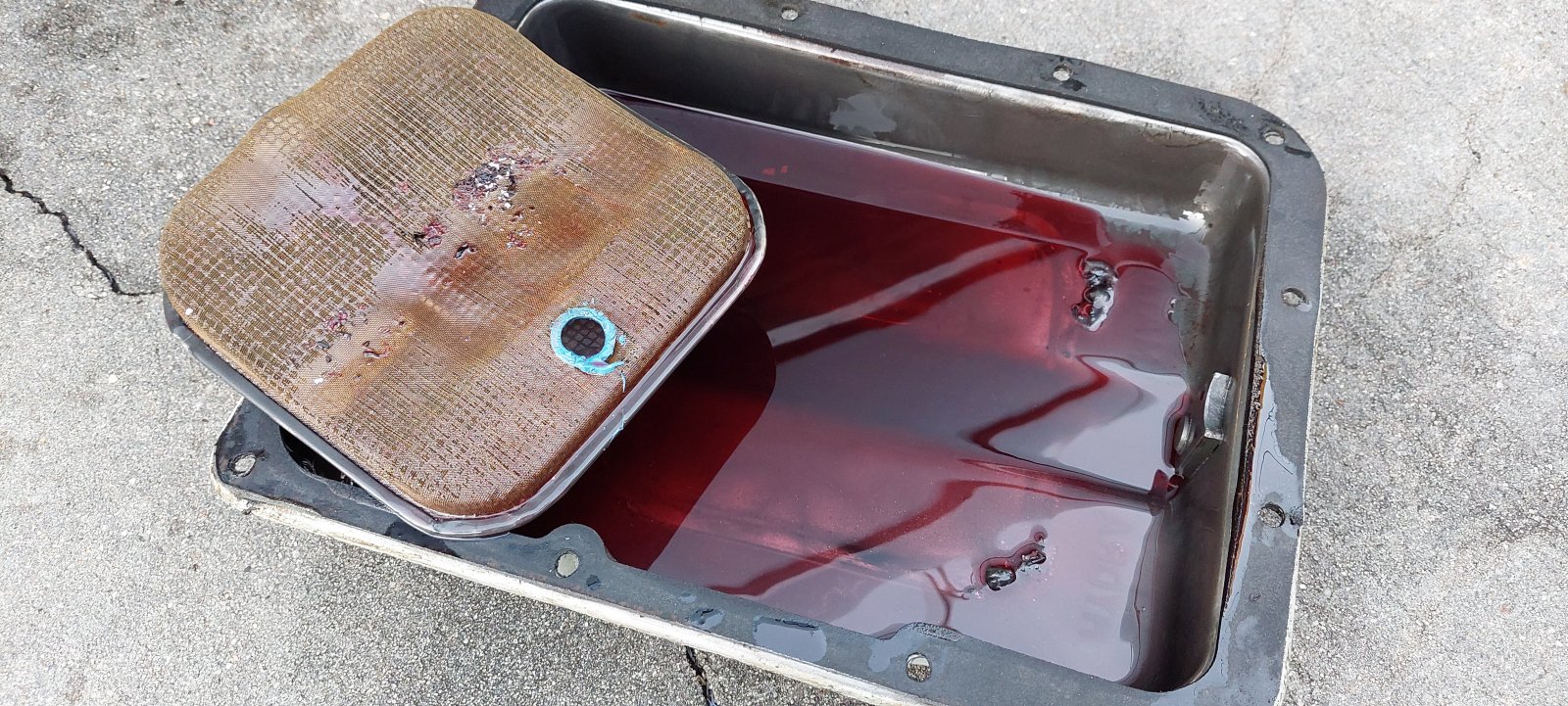

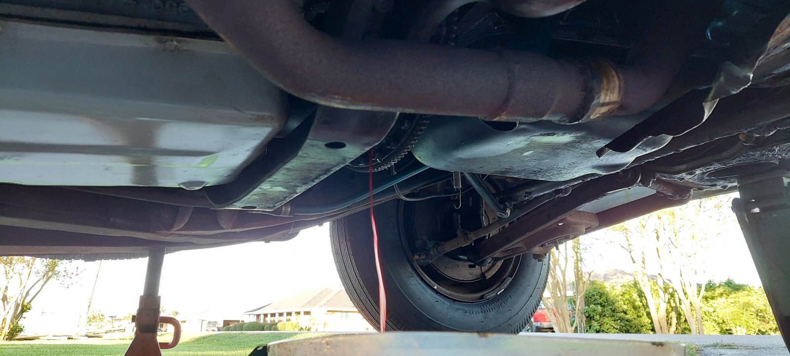

    Pleasant morning, so again the car****umed the position.
    Greased everything up whilst it was up, then started stripping the gearbox down.
    Loosened a few bolts and the valve block fell off.
    Poked about, decided to just polish the heck out of the moving parts.
    Clank, all back together.
    Result? Still doing the same thing so bah. It's driveable but awkward when it's hot.
    Pulled the serapes out and washed them.
    Next up, valve job.

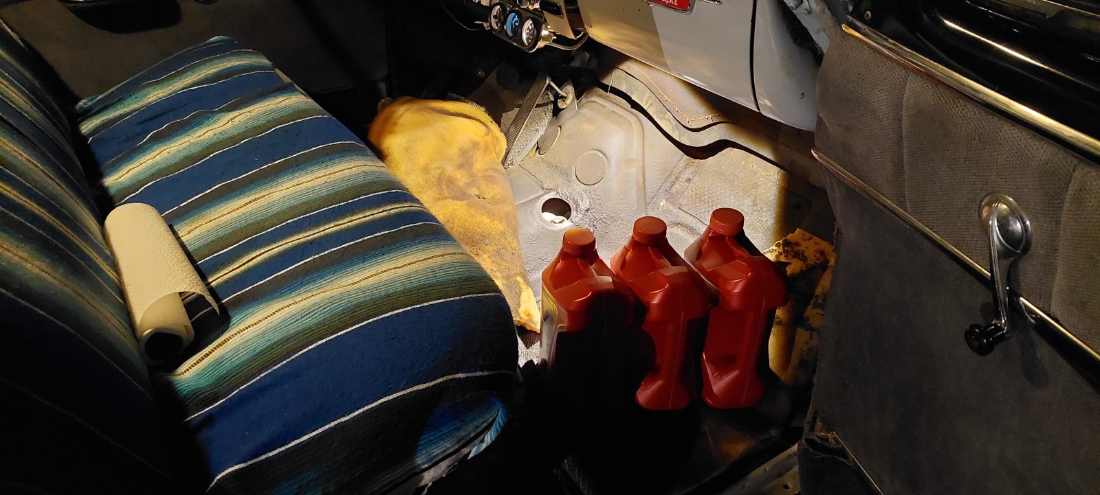

    Yeah. Wanted something with better hot-temp characteristics, it's about 20 weight so that's good.
    The replacement pressure regulator arrived. This one still has the black coating on the regulator plug; mine was worn to streaks and silver.
    It *seems* to be okay. I'll have to give it a thorough test later today.
