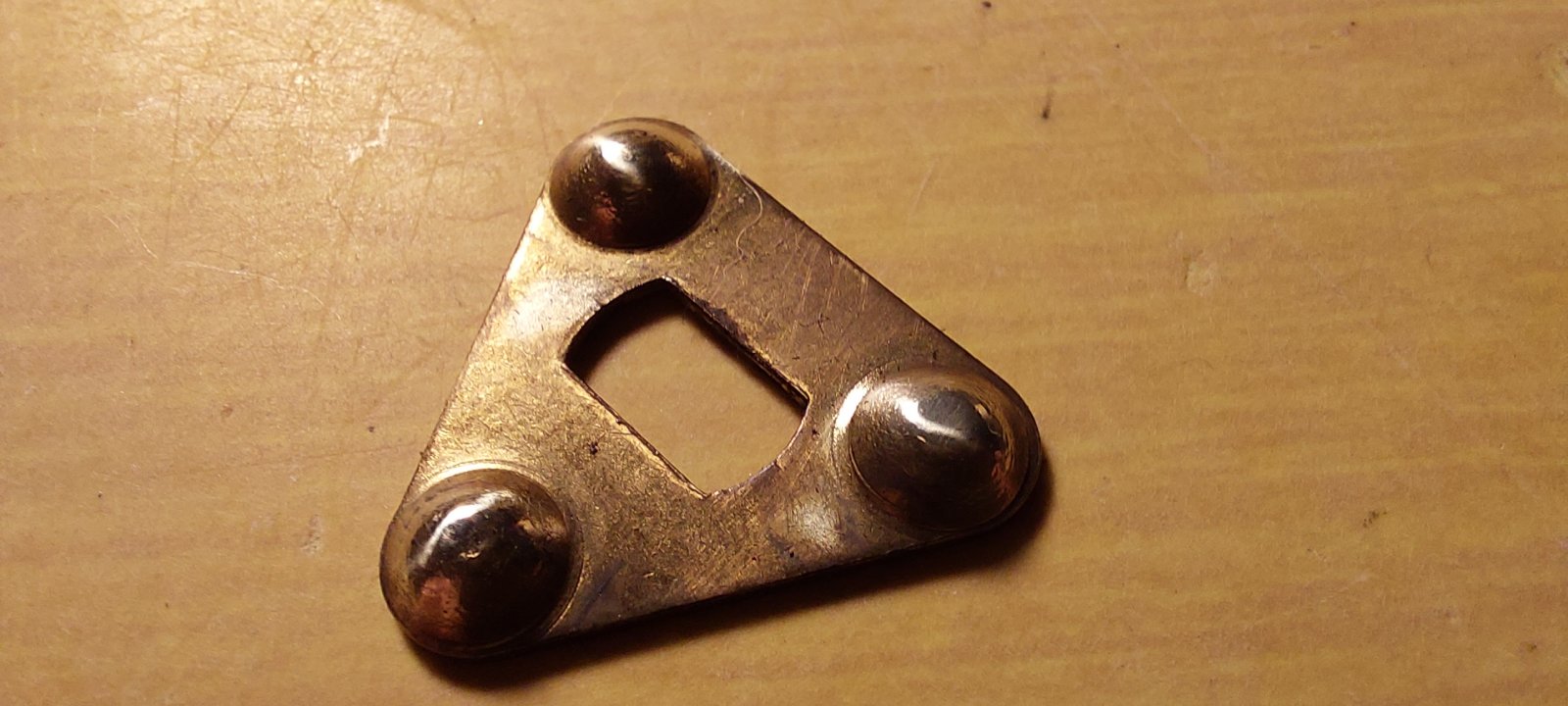

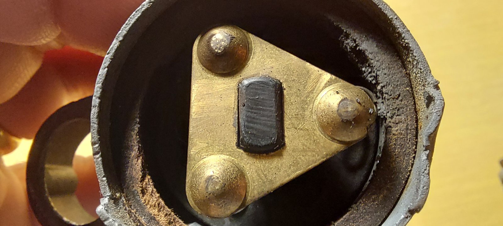

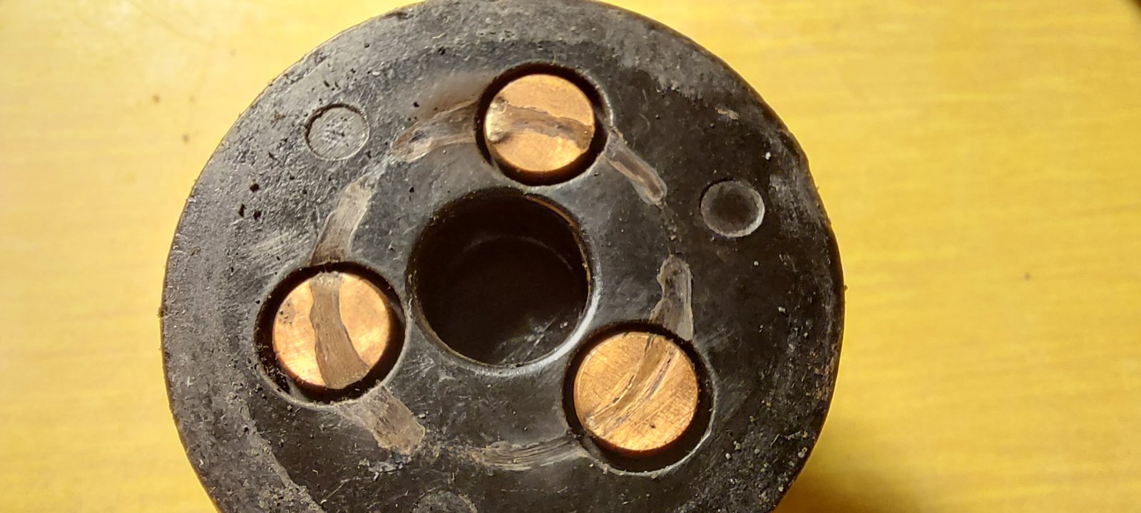

  7. PhilA
    Joined: Sep 6, 2018
    Posts: 2,107
    PhilA
    No, but I did repair it.
    The terminals were burned and dirty.
    The slider was not great either.
    Zealous application of cleaning and polishing compounds led to a suitable contact surface again.
    A little bit of dielectric grease to help prevent it going bad again.
    Now, no matter where in the arc that is "on", the switch provides good contact.
    Hopefully that'll make it run better for a while yet.
    Phil
